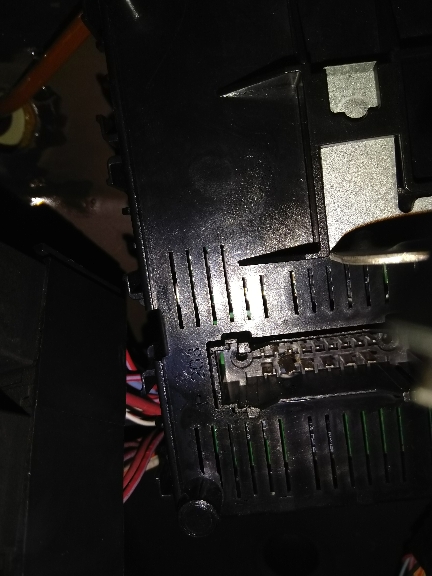

So I have an issue where only my right indicator works and flashes on the dash, if I try and indicate left my indicators don't light up, no light on the dash and no click of the relay(also doesn't work with hazard lights on, only right indicators do) any idea what this could be other than maybe the relay? and is the relay part of the uch? Thanks.

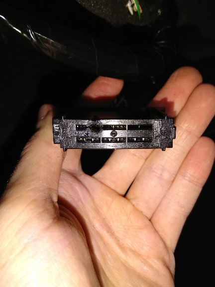

As an update for anyone who may come across the thread and has this issue, double check the connectors going to the uch, turns out one of pins in mine must have had bad contact and then heating up and eventually causing worse contact, little cleanup and some new terminals and all is good.
