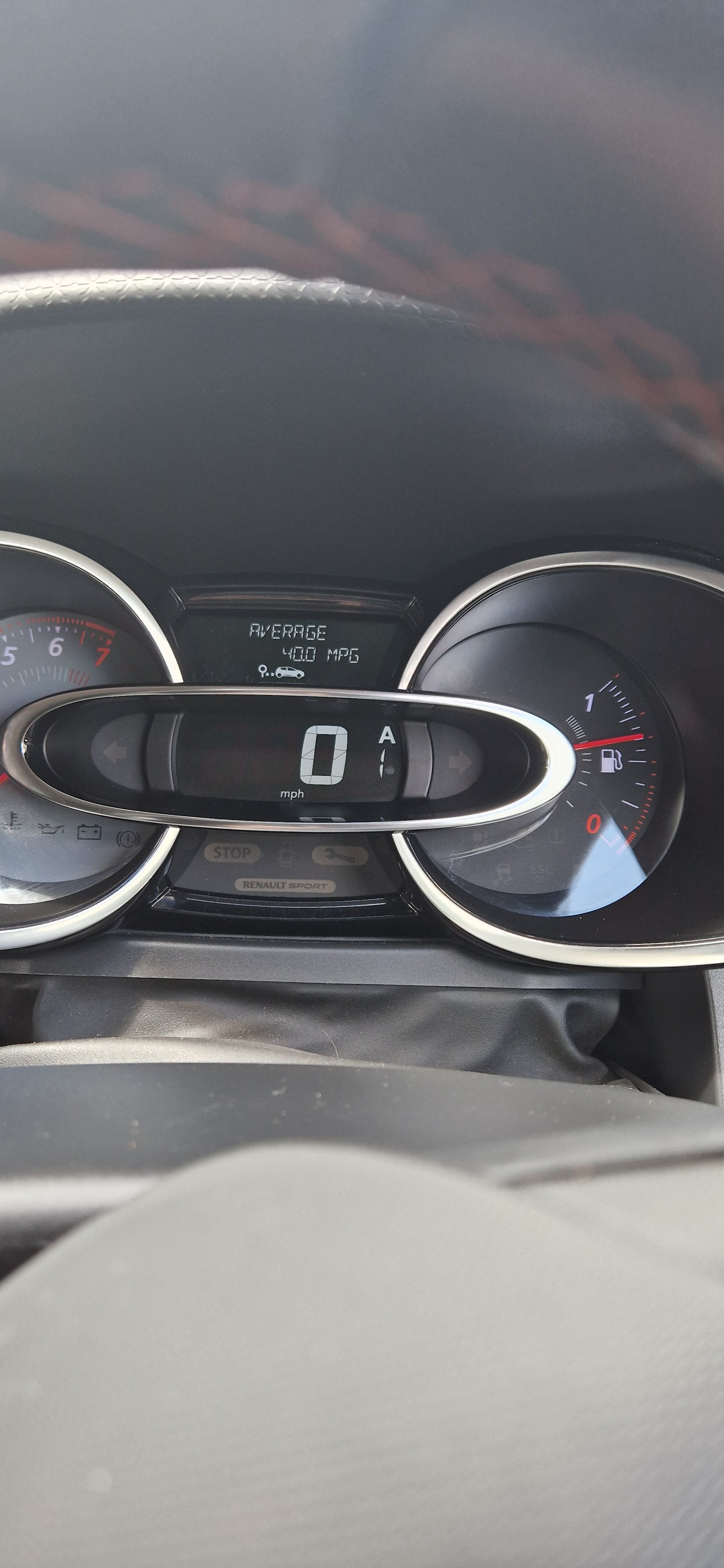

A comfy and uneventful drive home, enjoyed having cruise control and it averaged 40mpg on the dash. Gearbox seem ok, faster and smoother than the DSG in my fabia vrs. Seats are very comfy compared to the Boxster (which ill probably sell on) and it seems like a nice place to be. Defo needs a remap though. But first we will work through the car sorting any little niggles out. The bonnet has been slammed hard and dented, the wheels have brushed many curbs but generally its in good condition. Super nimble and pointy when you ask it for a quick change in directing and the wheel feels good in your hand. Definitely looking forward to tinkering on this one.

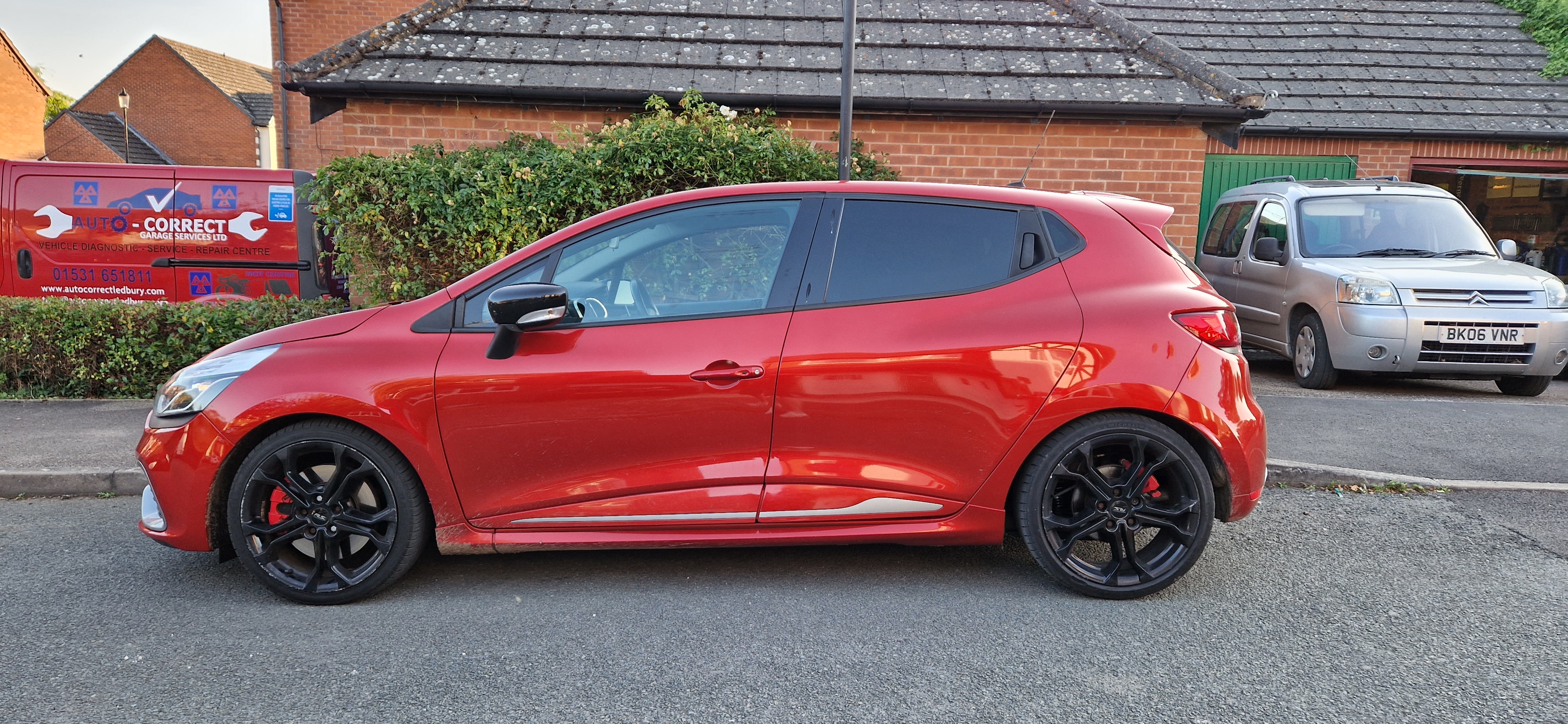

Introducing the Flame Red Clio 200 EDC (y)

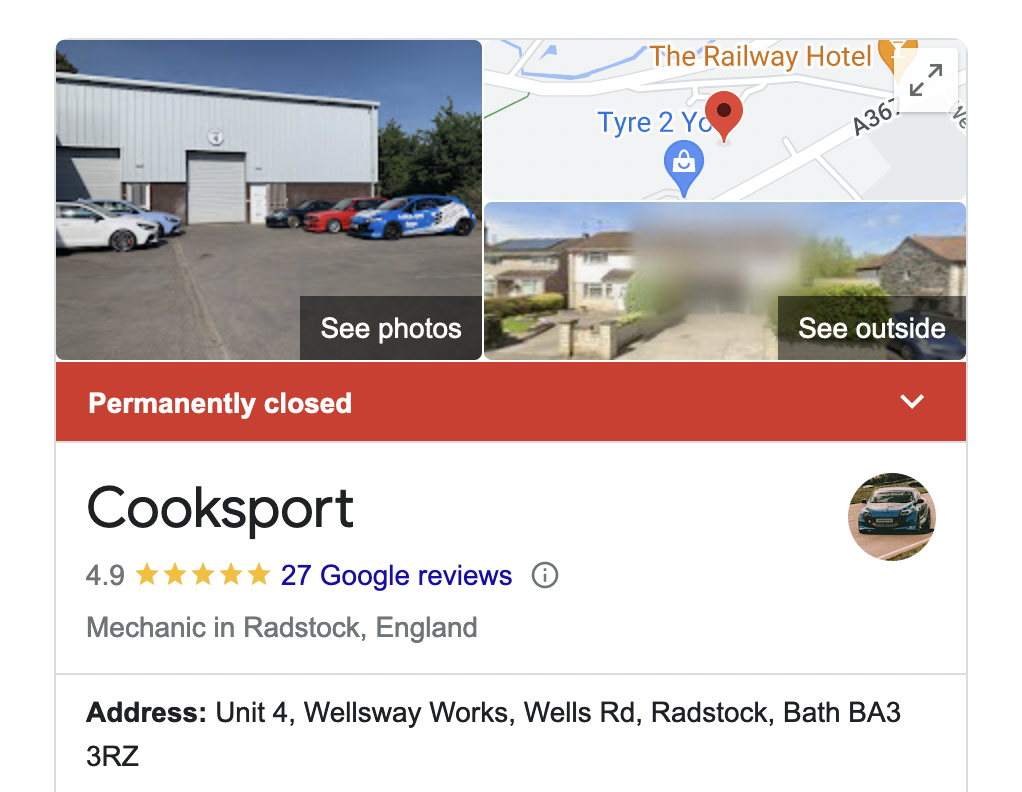

From what I’ve seen online, Cooksport are closing down so now is the time to buy them before they’re gone forever!
I noticed that just after I put an order in for some AST 5100.
They told me 3 weeks but after not hearing anything for 5 I got onto them. They came good so all was well in the end. They've been around a long time. Such a shame.

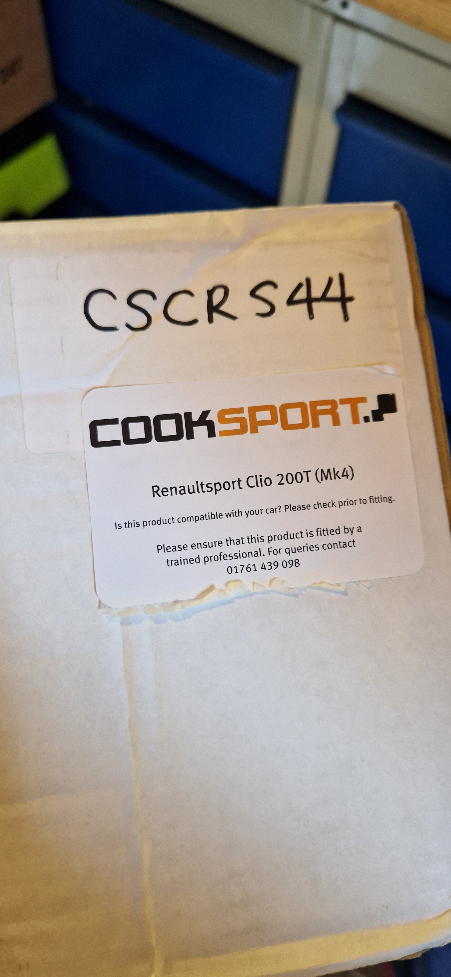

Cooksports on order

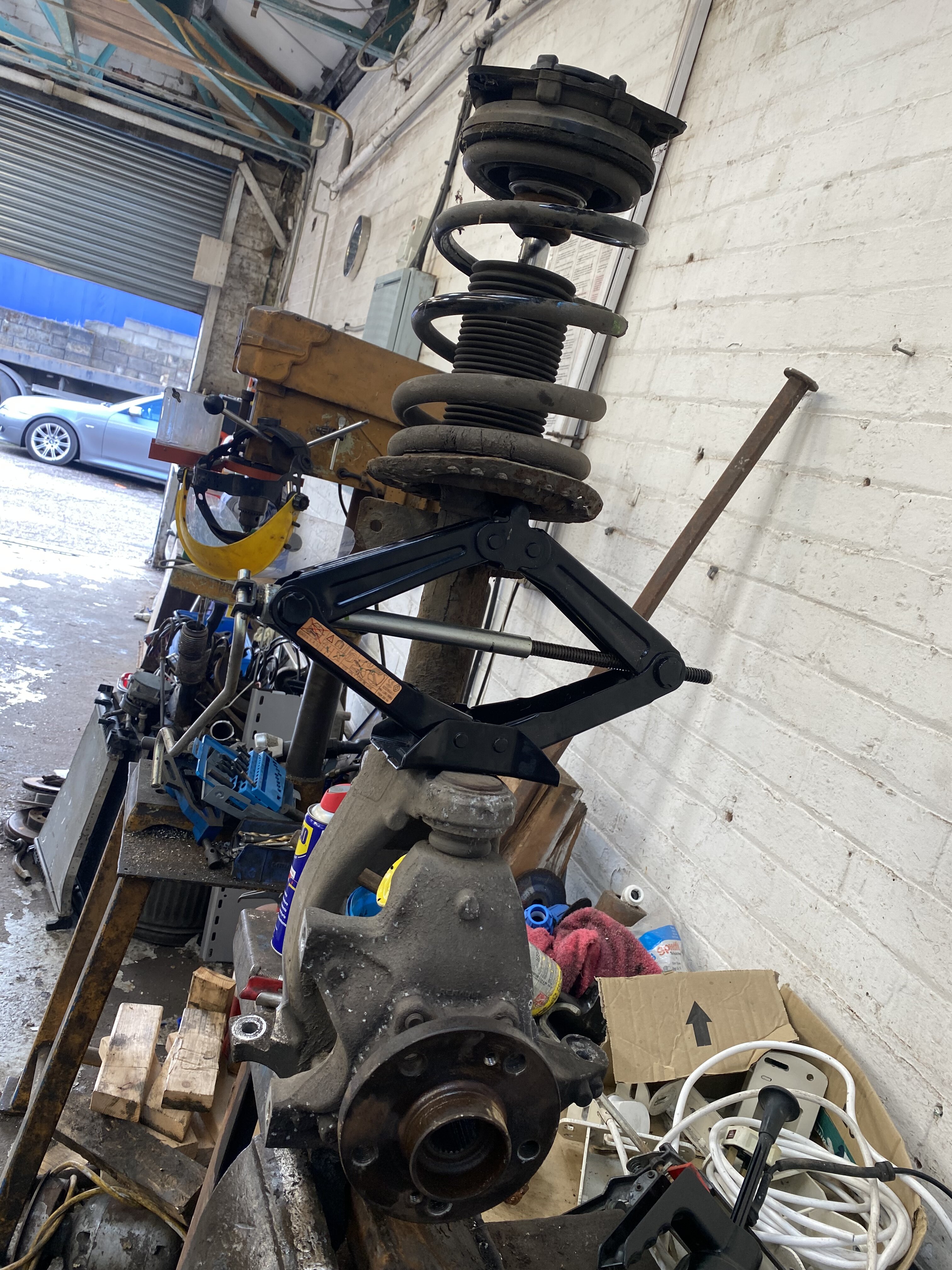

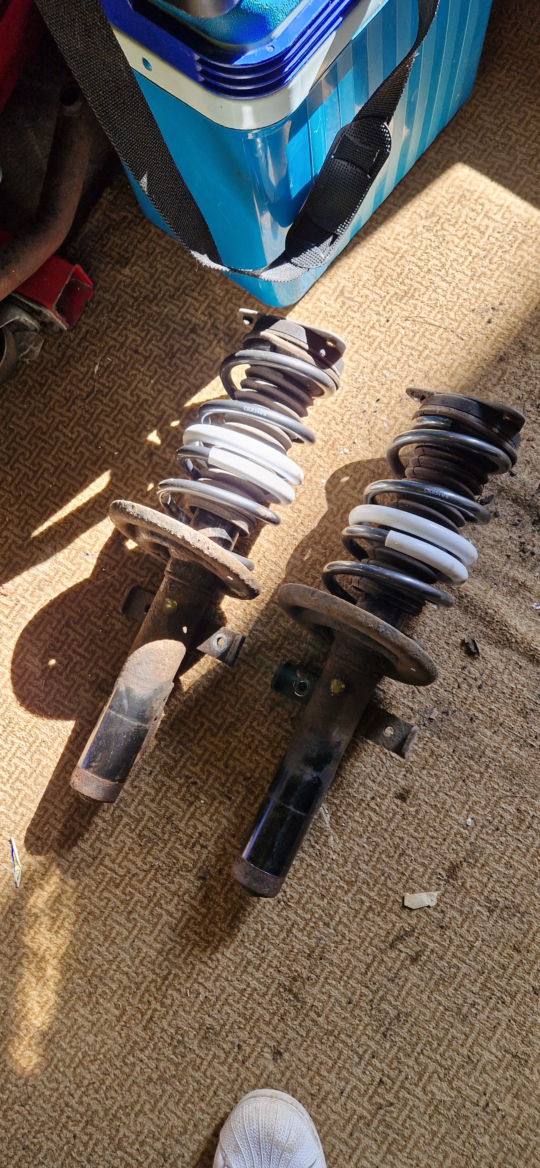

Next question, I've not even looked under there, are the shocks bolted to the hubs or do they have a slip joint into the hub?
They have a slip bolt so not like a 182 suspension. It’s a little tricky but I managed it easily enough once I got the hang of it.
Can't decide if that's a genius way or not!
The exterior of these has really grown on me, what are the seats like? My mums 0.9 mk4 had seats flatter than a spirit level!
If they’re anything like the 197’s, this is my preferred method.
Have be careful if the spring platform is rusty tho
There is enough movement in the hub downwards to make it relatively easy. I saw a method of putting a thin piece of metal in the gap, putting the bolt back in and tightening it to spread the gap.

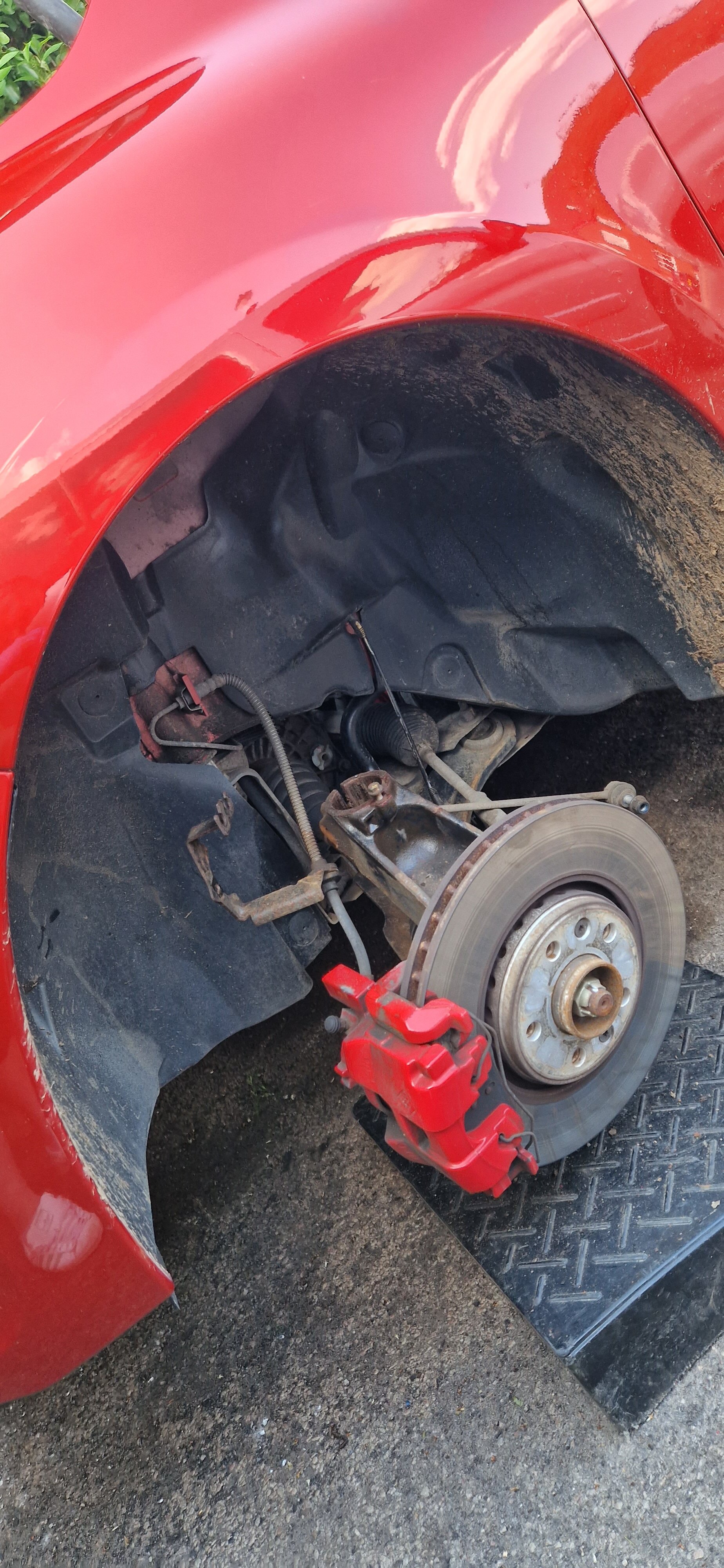

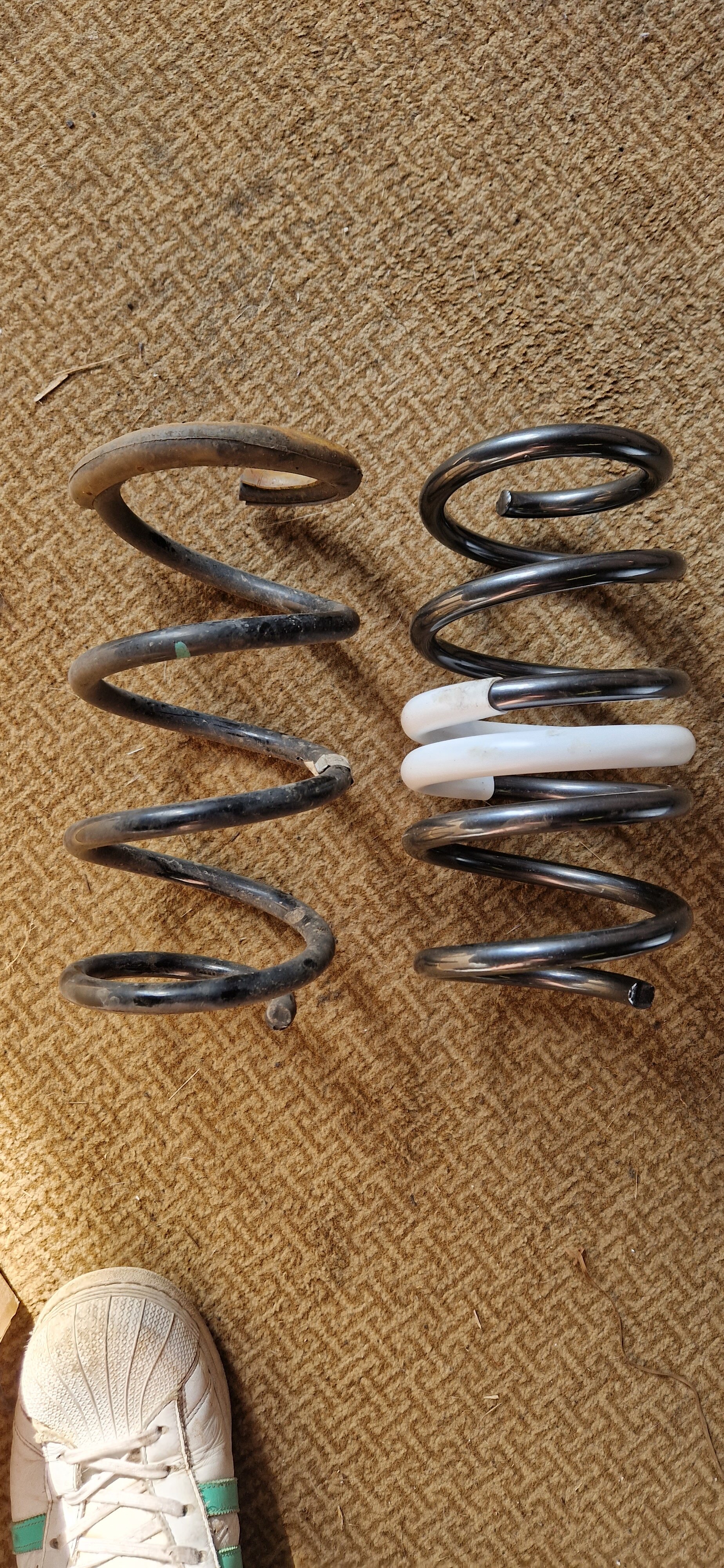

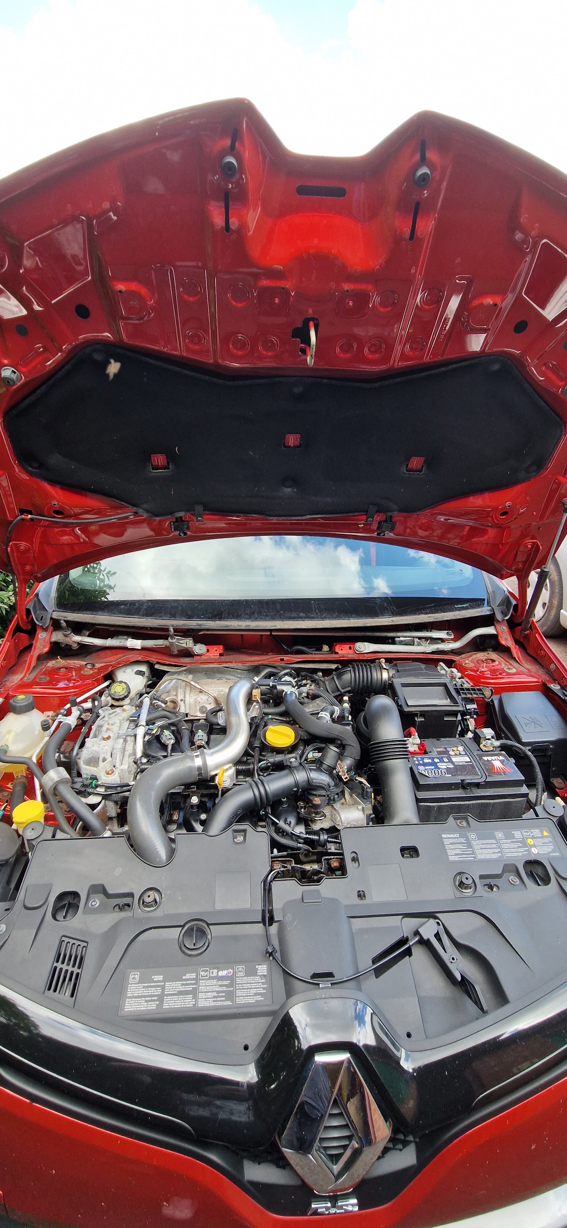

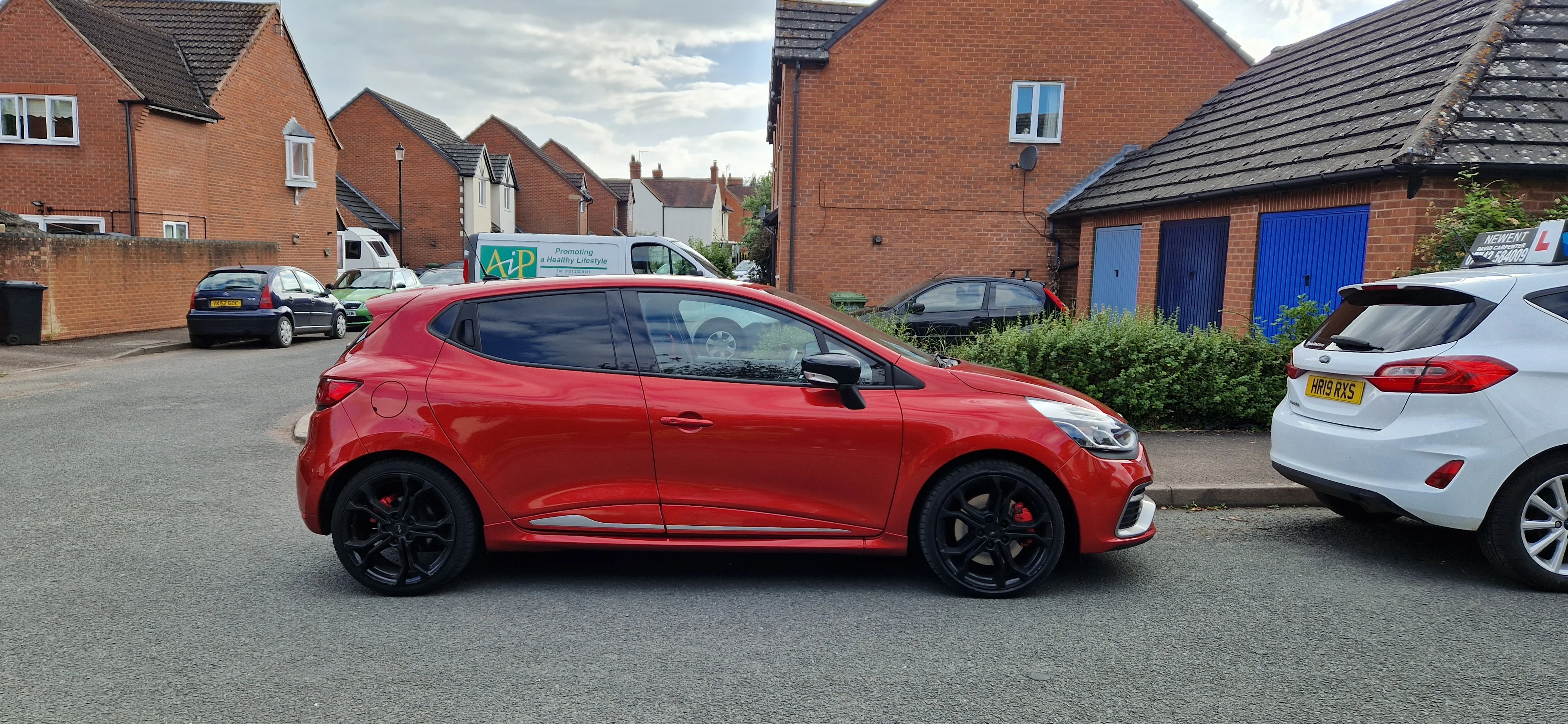

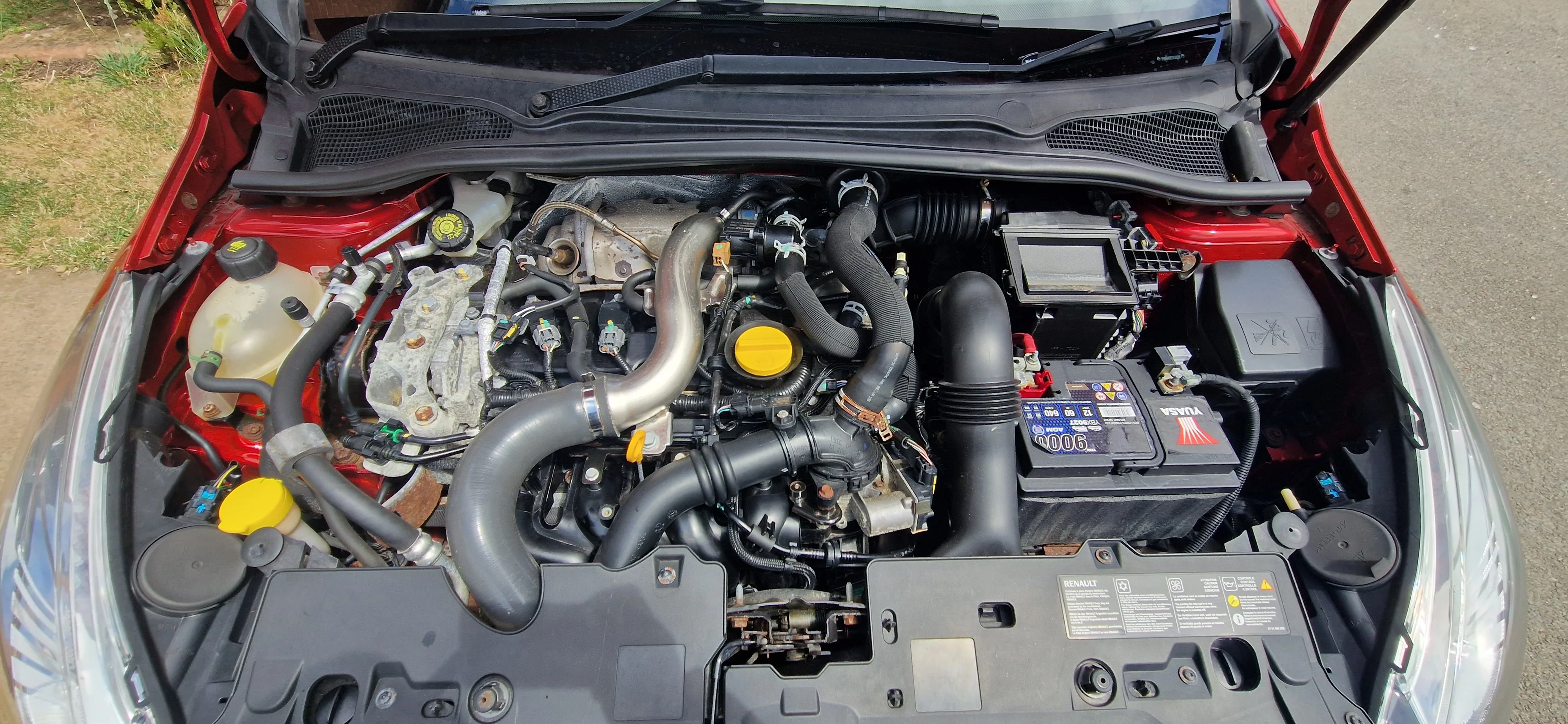

So it's been less than a week.... cooksport springs fitted this afternoon and the symposer thing blocked off. Fitting was easy as really, there's plenty of droop in the suspension and you don't even need to use spring clamps, win there. Its not been driven yet so I'll let it settle before booking in for alignment. Jez was poking around under the car and noticed it has a center box delete already too which was a nice find. I do have a rotational noise on the front right, I can't feel play but I think it's the wheel bearing. I'll keep an eye on it and get it swapped out soon. Hmm what's next....
Probably being dumb but what does blocking the symposer do, does it remove the artificial noise coming through into the cabin?
It removes some of the noise into the cabin, the fake induction noise, but has also been known to fix a noise from behind the dash.
I can vouch for the rear axle spacers from pure motorsport. Easy to fit and make a difference.

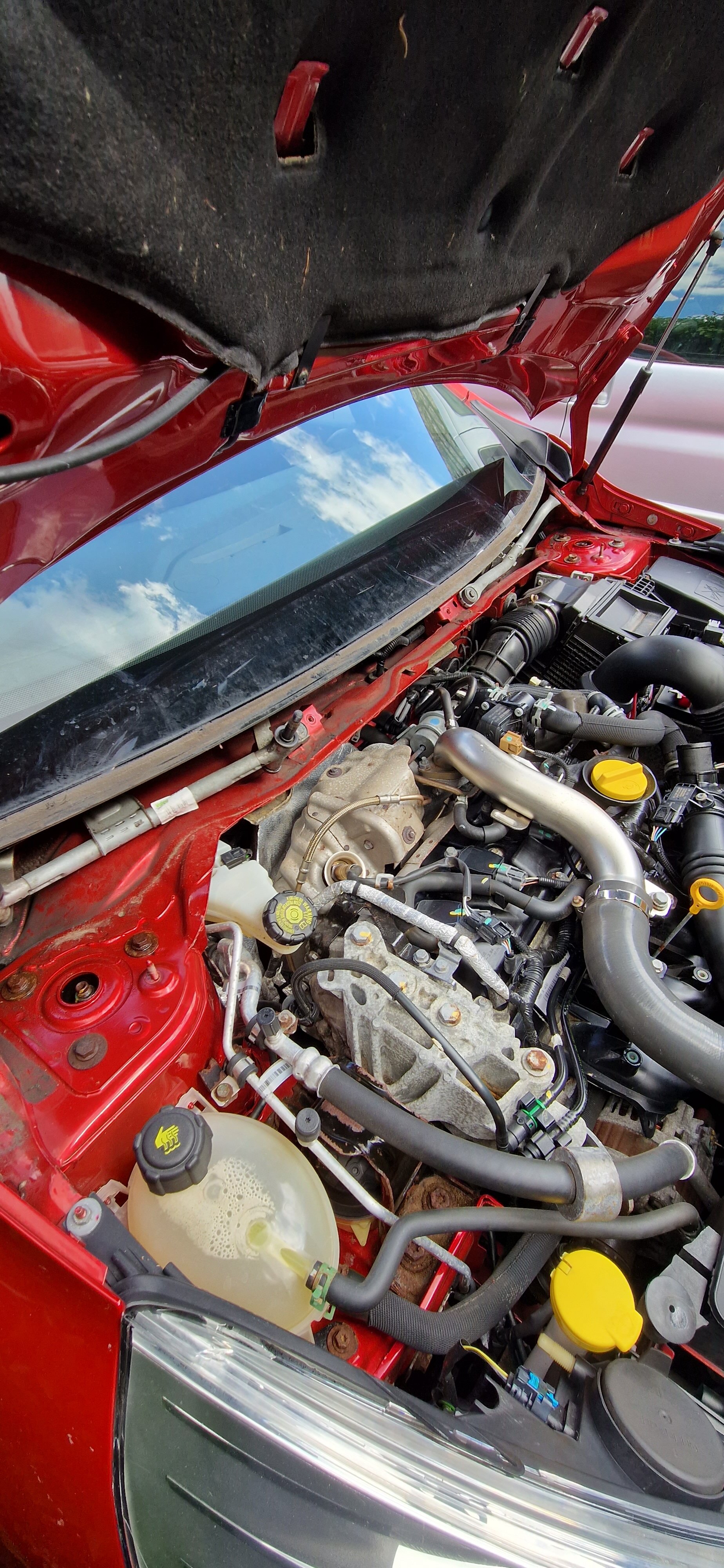

Its only a small unit, not sure why people put a blanking cap on it too tbh as it should be sealed off. It offends me being there though, I wonder if base cars have the panel without the hole for the symposer.
Also make sure you put a clamp around the bung on the intake pipe, there have been instances of them flying off and damaging the bonnet. (I say instances, I’ve read of 2 but wouldn’t want it happening!)
