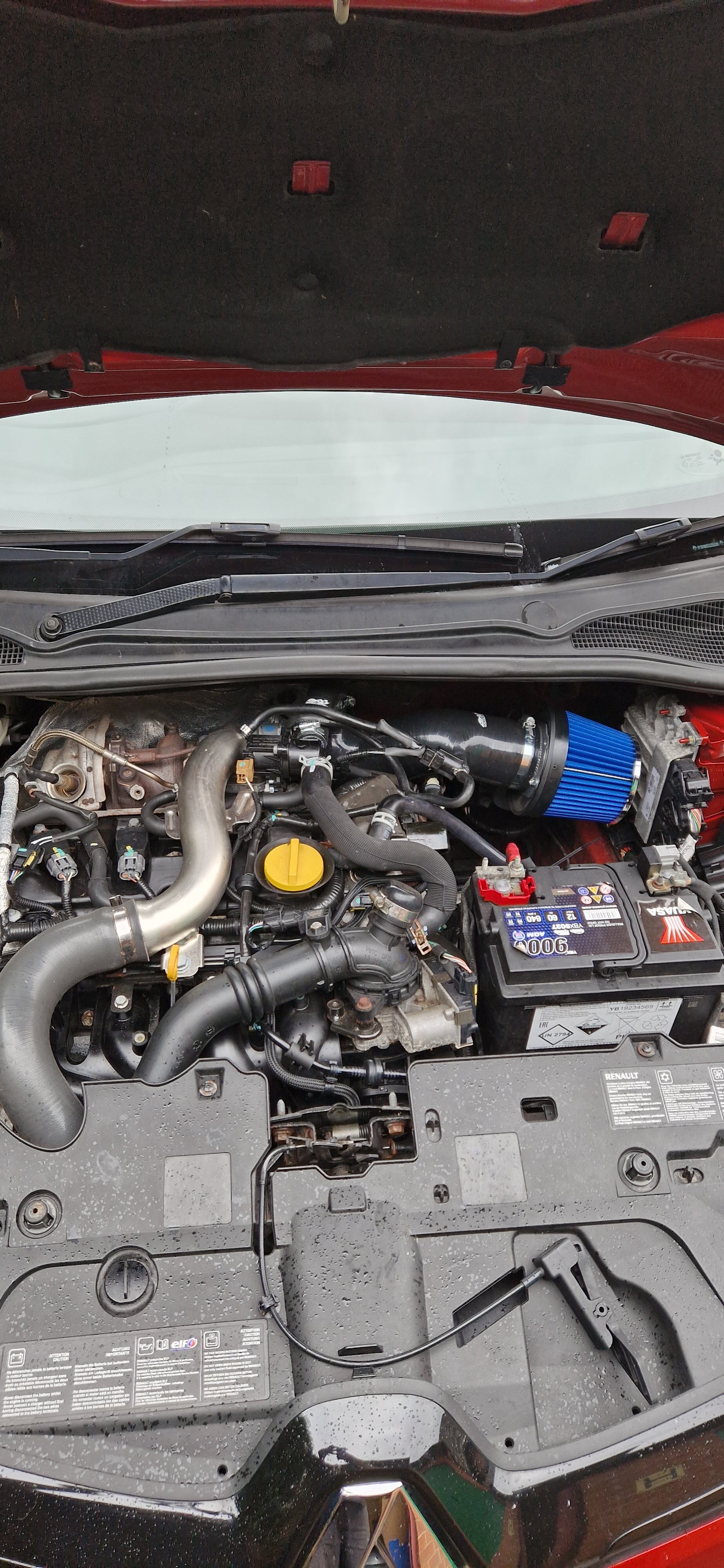

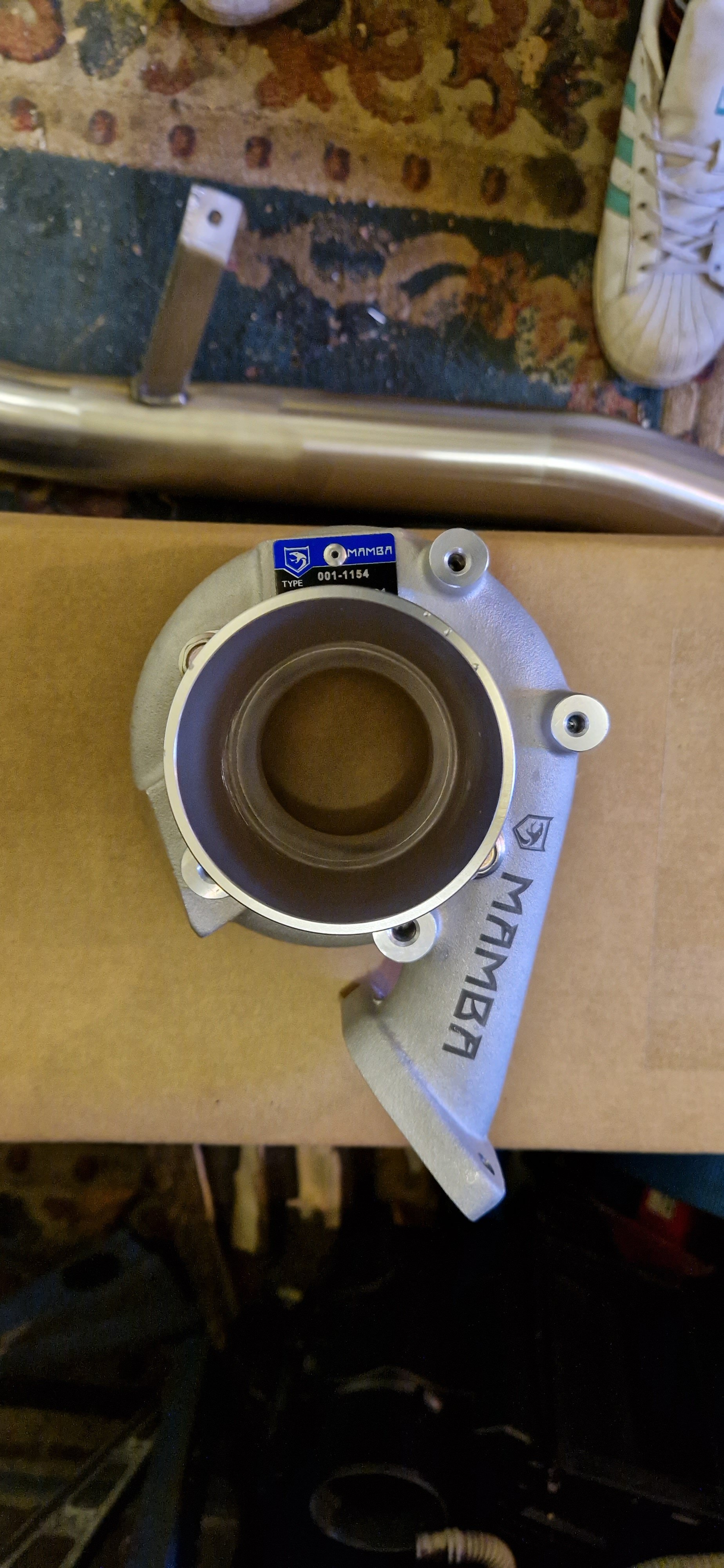

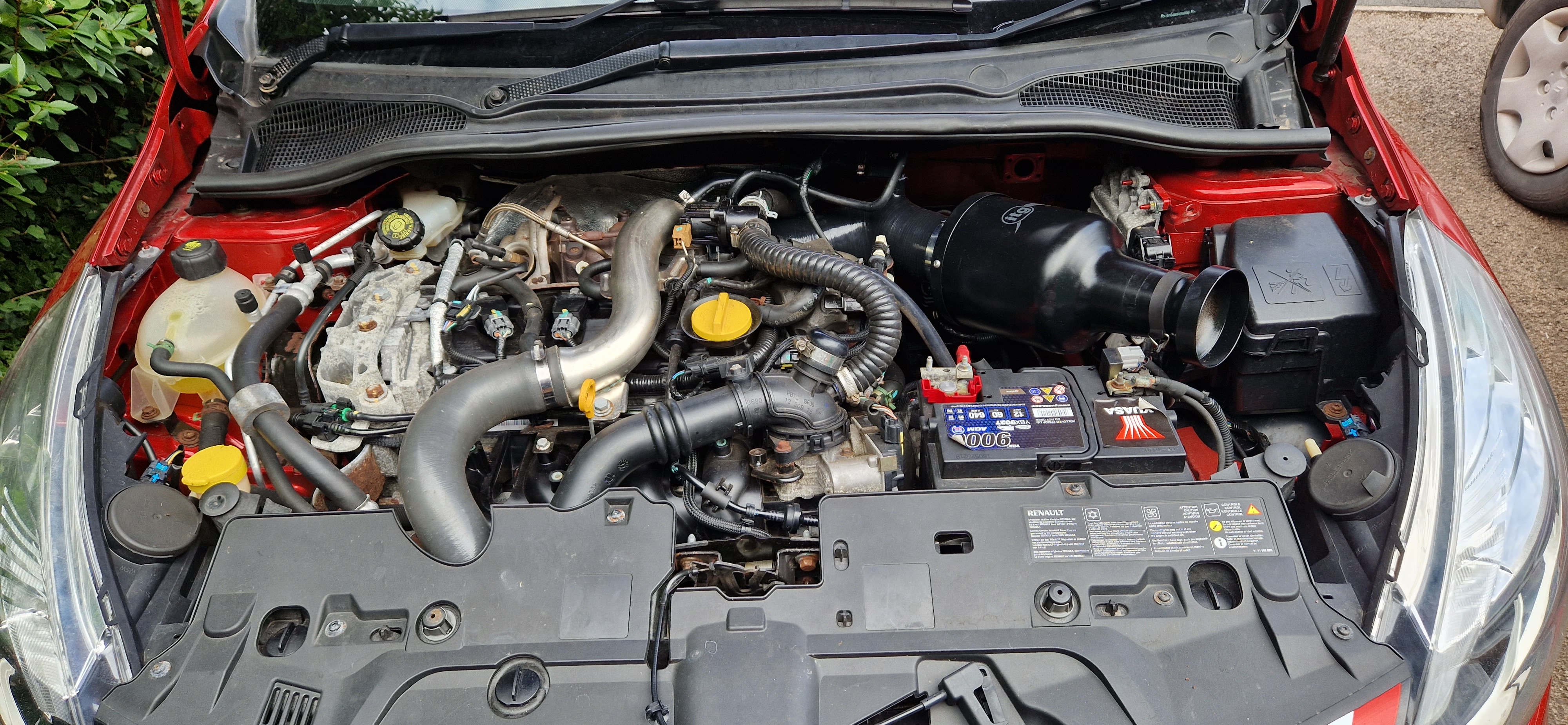

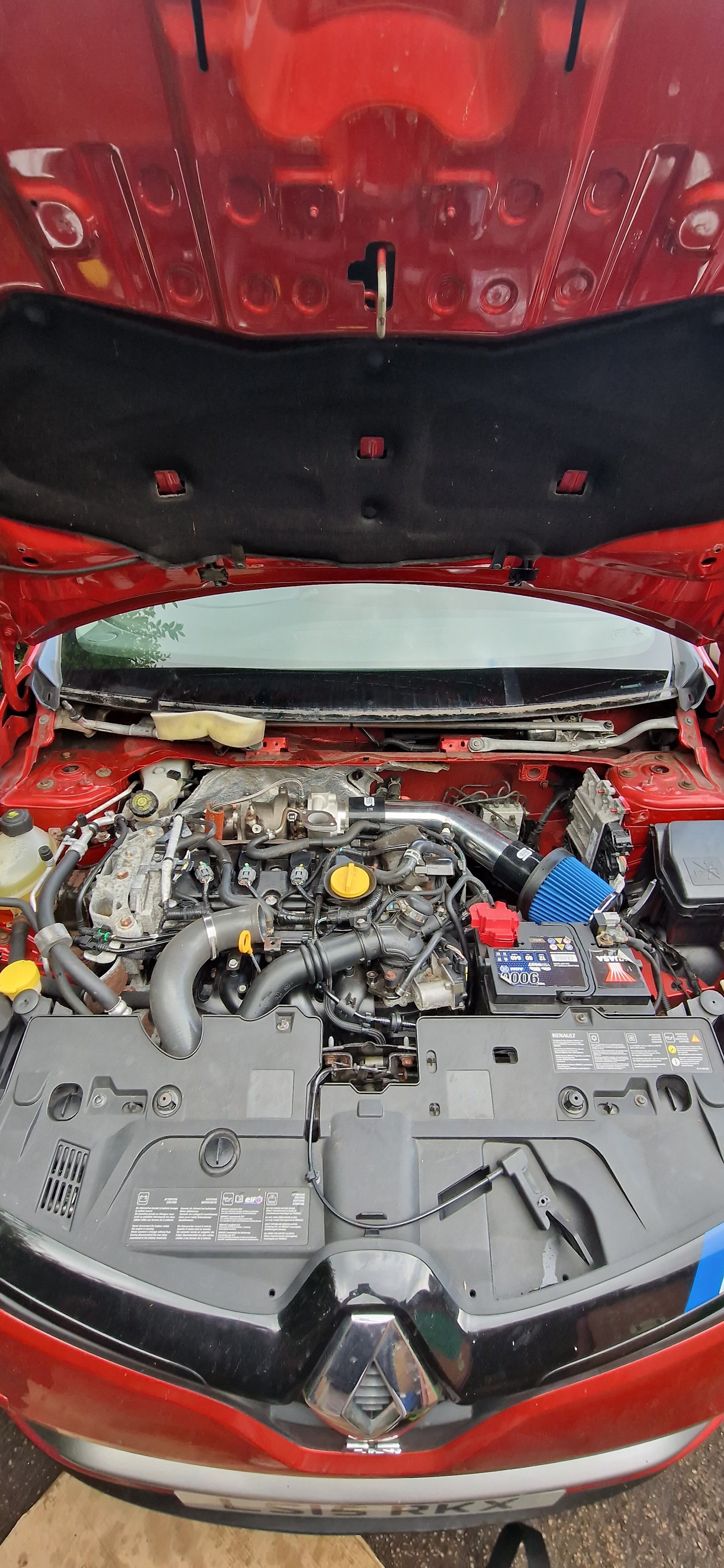

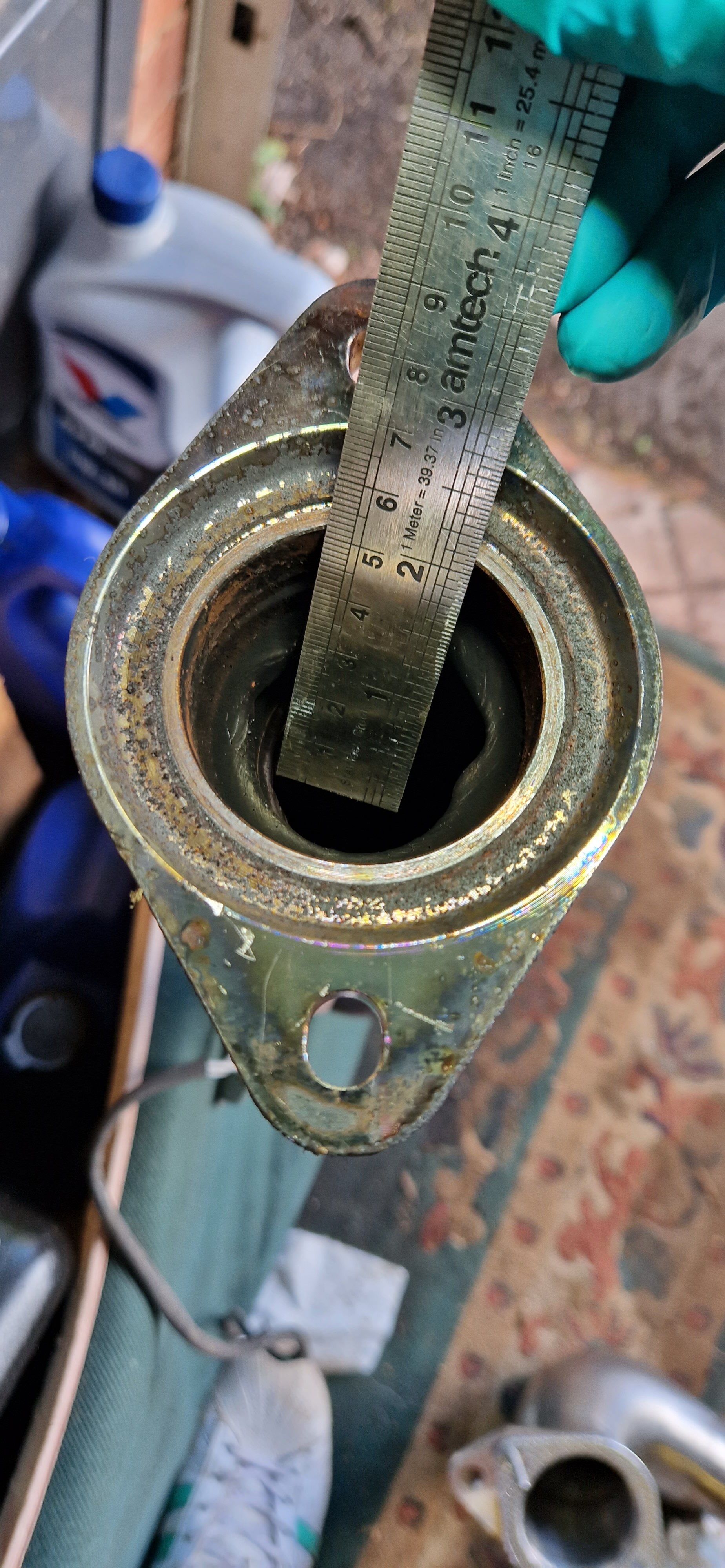

Wanted to get the 3 inch intake fitted today, a direct fit it was not...... its seems to be pretty common to swap out the 200 turbo intake pipe to the 220 item, so why not upgrade further, this has a tapered intake adapter and then a 3 inch pipe that is sold to fit in between the turbo and the stock airbox... I'm not sure this would actually be the case without some cutting. To get this all in i did have to swap in a spare air filter and remove the symposer completely (which required me to remove the scuttle) It should still yield some gains when i fit my big turbo but im not sure if those of you that are reading/watching would be willing to do this. The 220 intake and a ITG intake kit would be an easier fit.
Sounds exactly like what I put on mine, about 8 minutes after I took it off 😂
I kept the 220 elbow and k tec hose.
The gfb valve stayed as I couldn't be bothered putting the stock one back on.
Made zero difference come map 😭😂

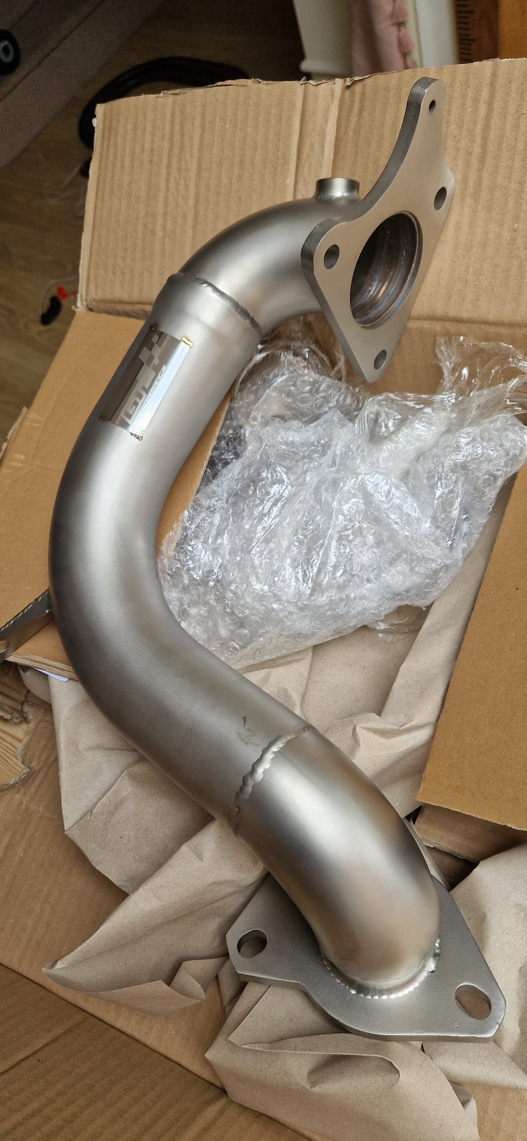

I had already purchased a GT performance front downpipe/decat, but I have decided to go one further, all in I guess. Its a 2.5inch decat pipe that tapers to fit the stock exhaust system but I feared it wouldn't be enough or I would find it to still be restrictive when mapping on the big turbo, so I've now placed an order for a 3 inch down pipe and front pipe from Ktec Racing.

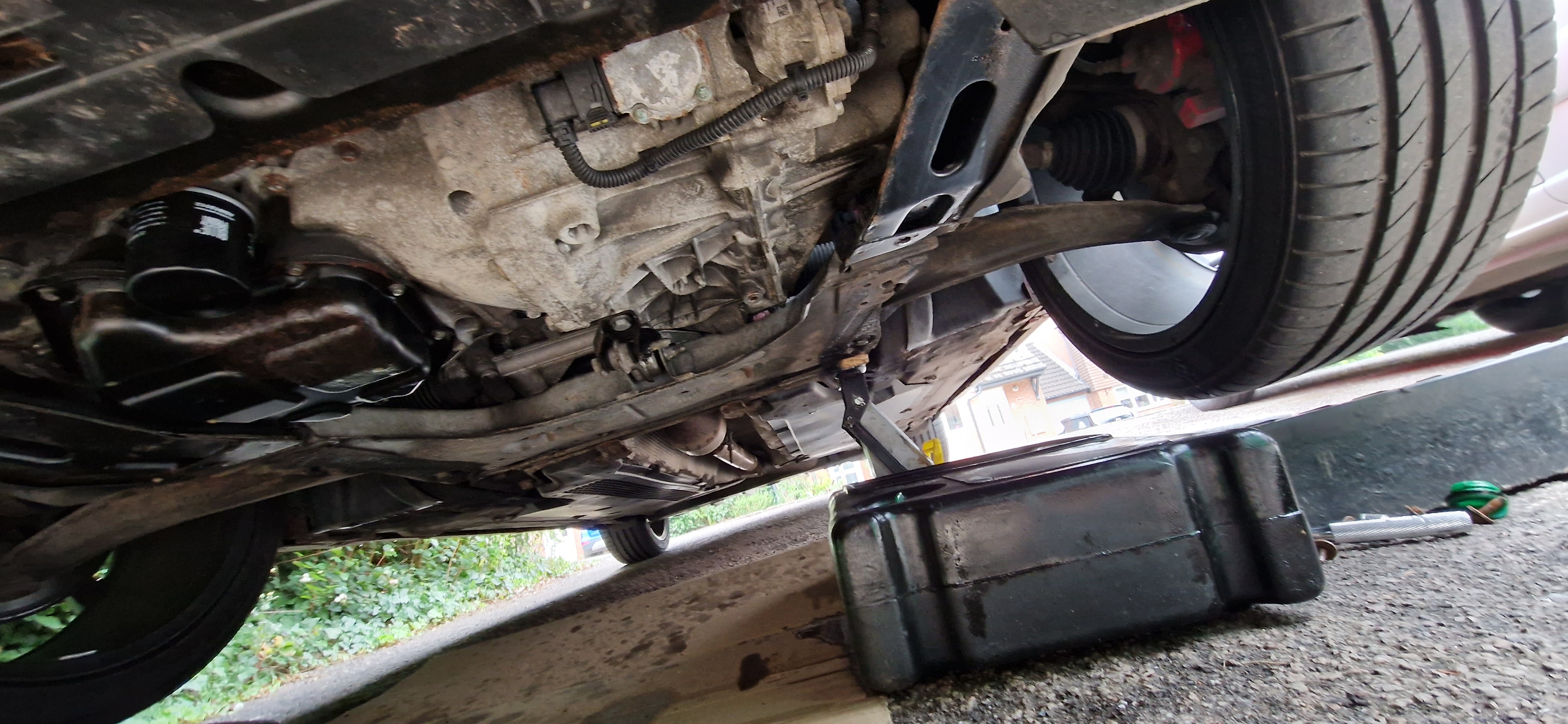

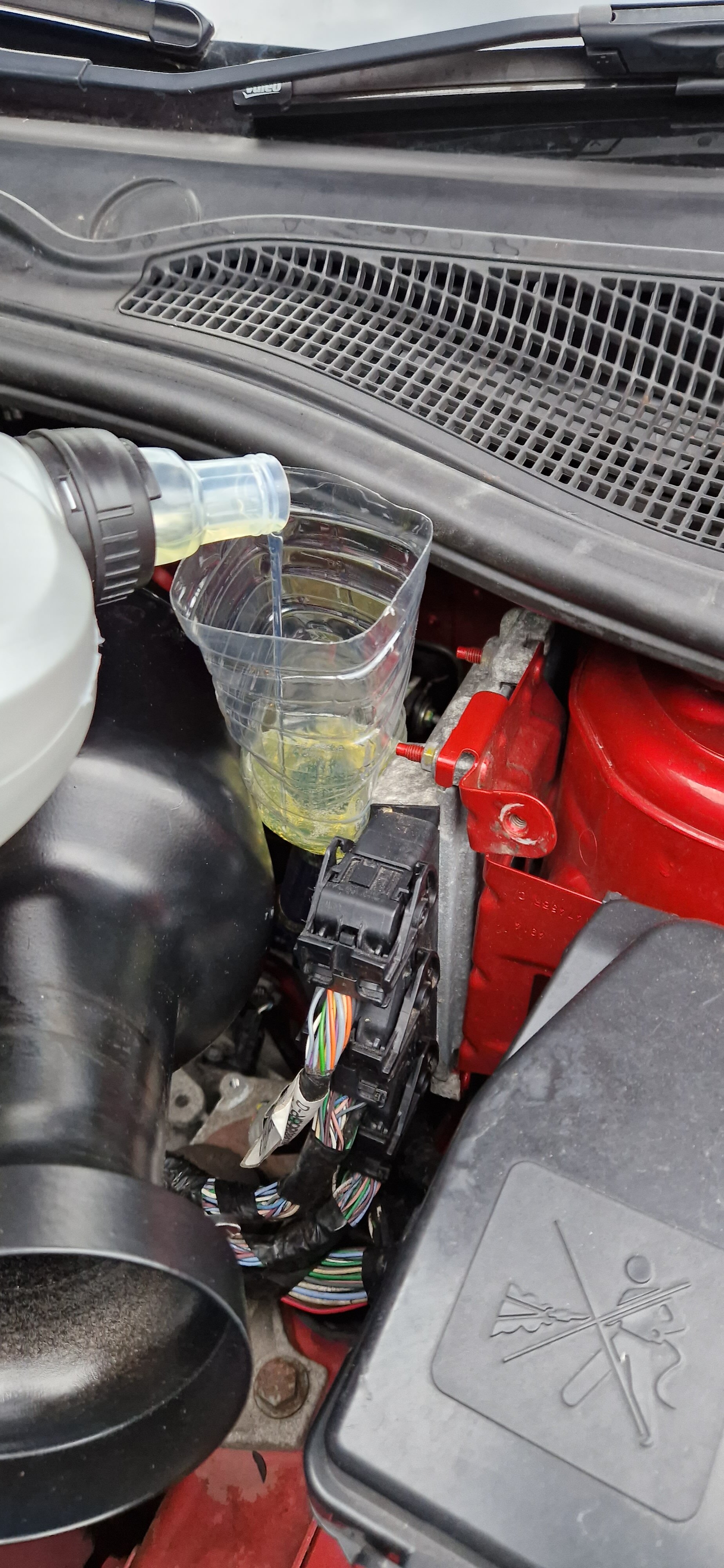

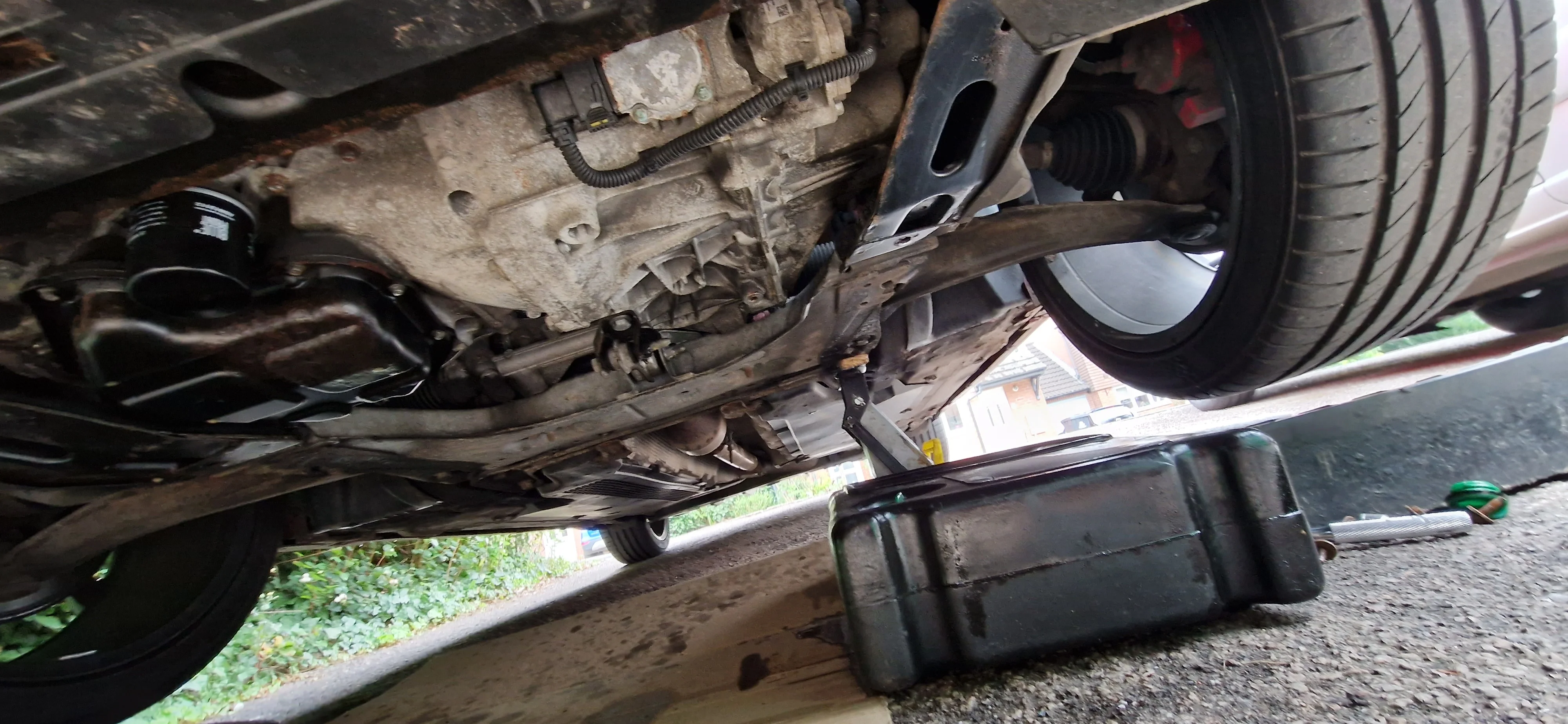

The car ticked over 95k this week, perfect time to give it a gearbox oil change. Easy to do (once you knock up a way to refill the box) much like the older Renault boxes you empty at the bottom using an 8mm hex key to remove the drain plug. Refill by removing a white wing nut (located just behind, and slightly above the pass side driveshaft) and popping in the tube from your chosen refiling container. To be fair the old stuff came out pretty clean, not sure what the book recommended oil change is but now I know its been done (y) From what I can find the box takes 1.7 ltrs, mine took 2 and it was starting to dribble back out so left it at that (y)

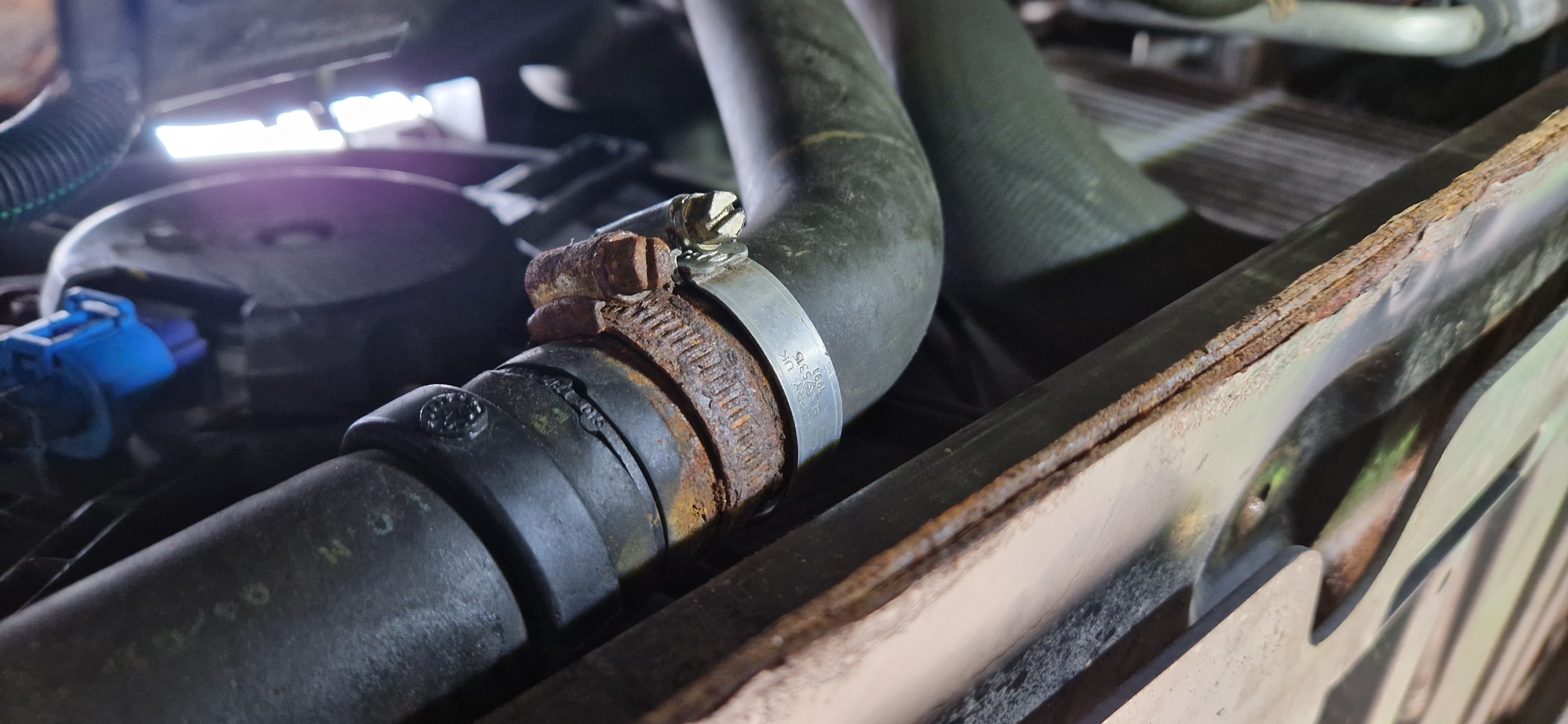

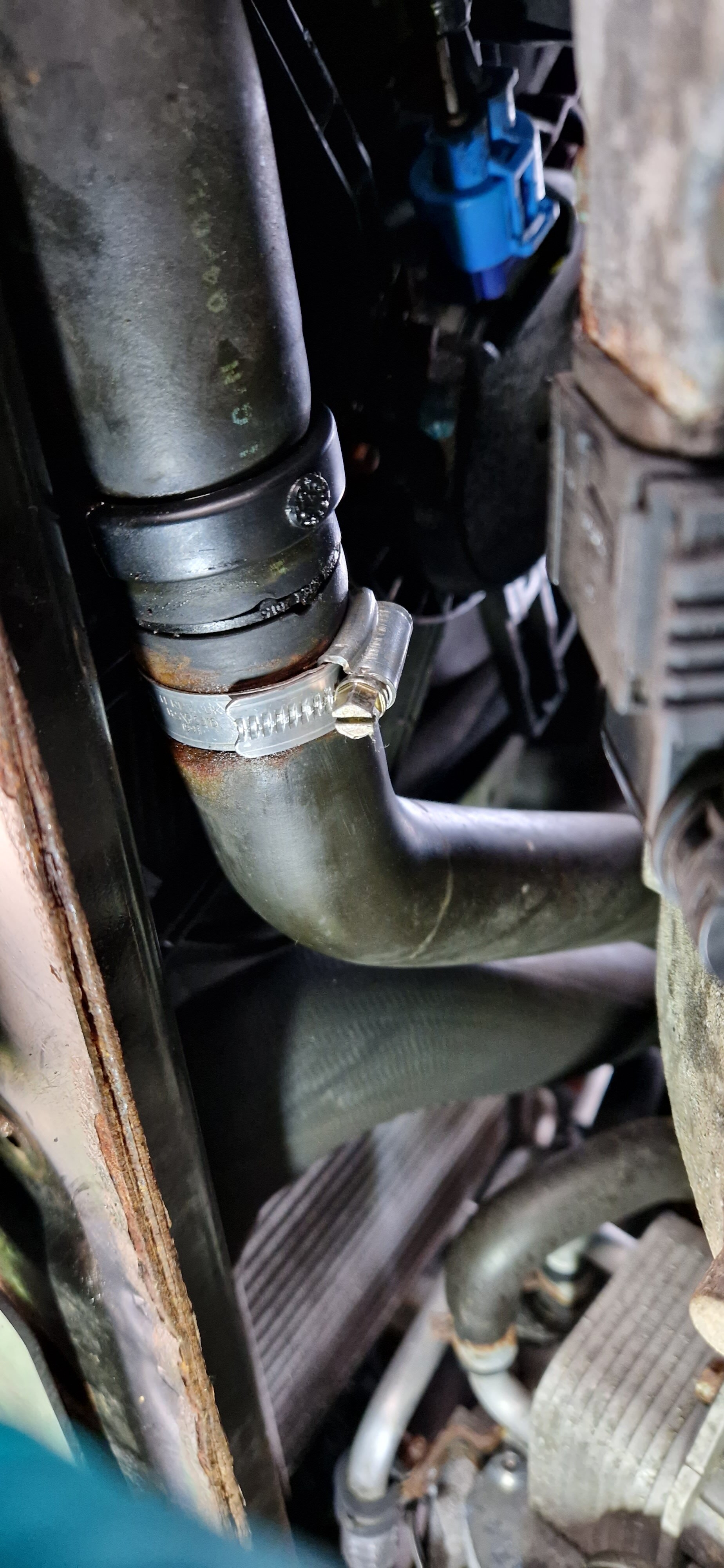

I had also read about a hose clamp that rots with age and can leave you stranded when the car dumps its coolant so whilst under the car i replaced that. Not sure if mine was original but there was certainly a very rusted clamp on the lower rad hose. Quickly whipped off and replaced though so another "issue" off the list.
Good progress mate. I too did my gearbox oil but the official line I’m sure is it’s sealed for life and doesn’t need changing. Although the oil isn’t cheap it’s worth doing for peace of mind.
Did you use motul dct oil?

I used a Millers oil from opie oils, funny stuff, looked like vegetable oil and didn't have the usual strong gearbox oil stink. Thanks its getting there, not so great in the flesh, pictures make it look better than it is :D
Genuine gearbox oil smells like salted caramel 😋
As Daz says, someone’s been there with a poor quality jubilee already!

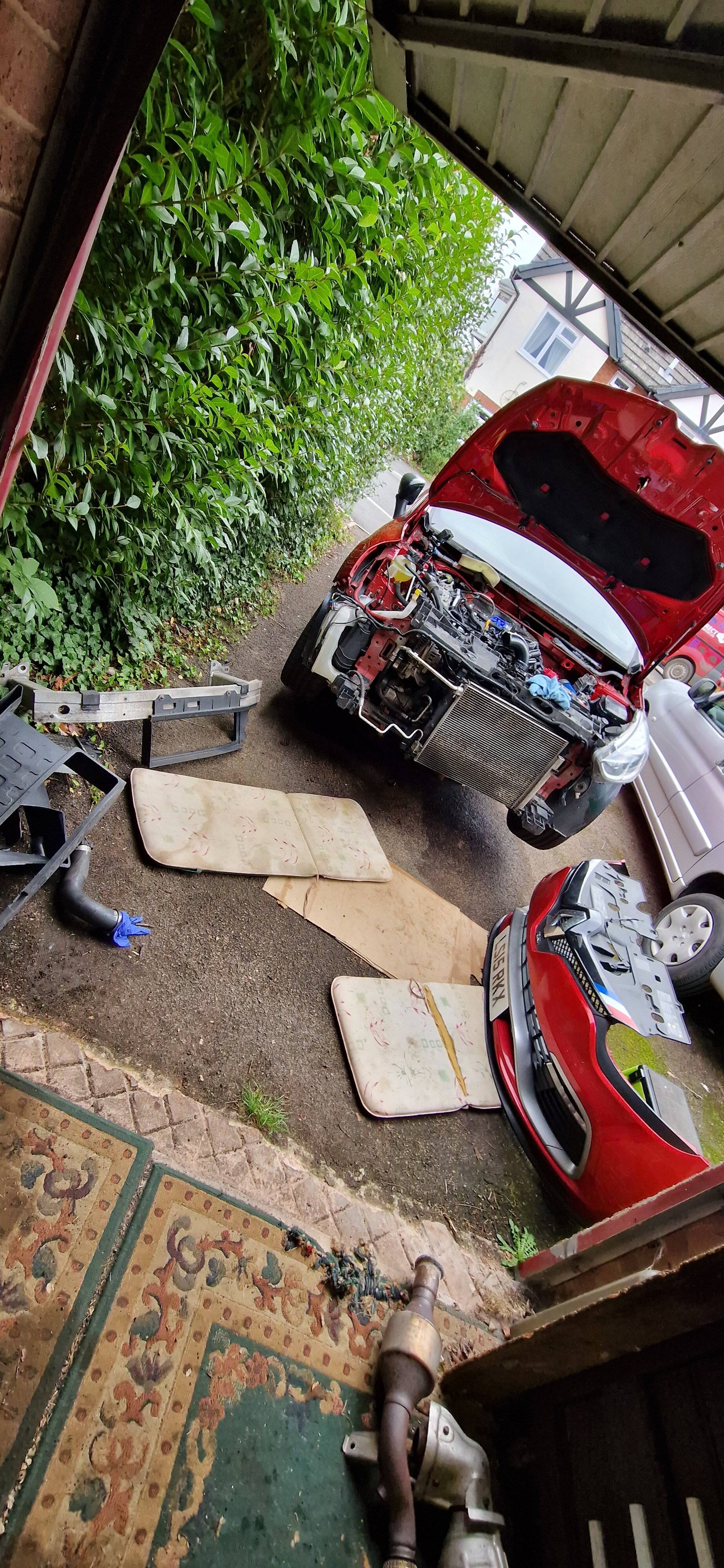

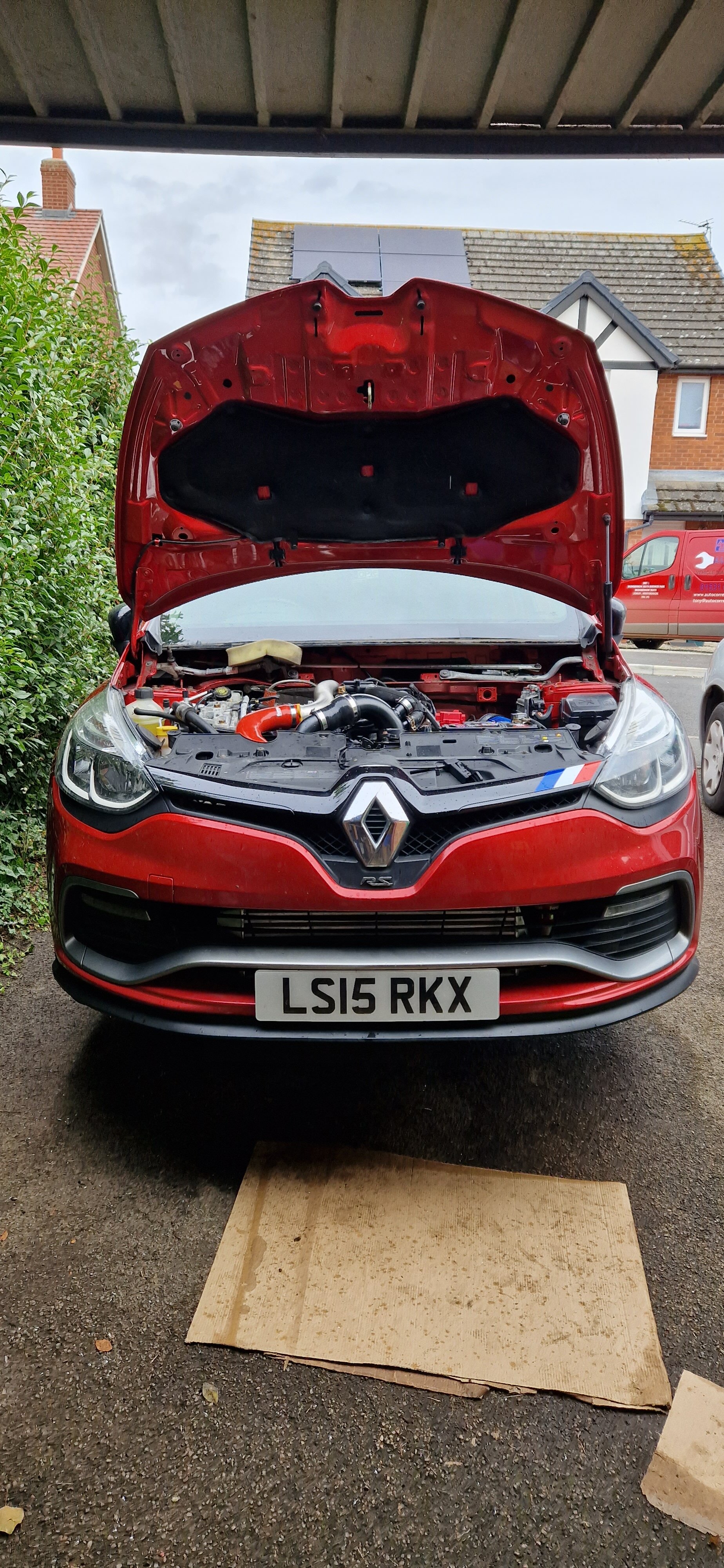

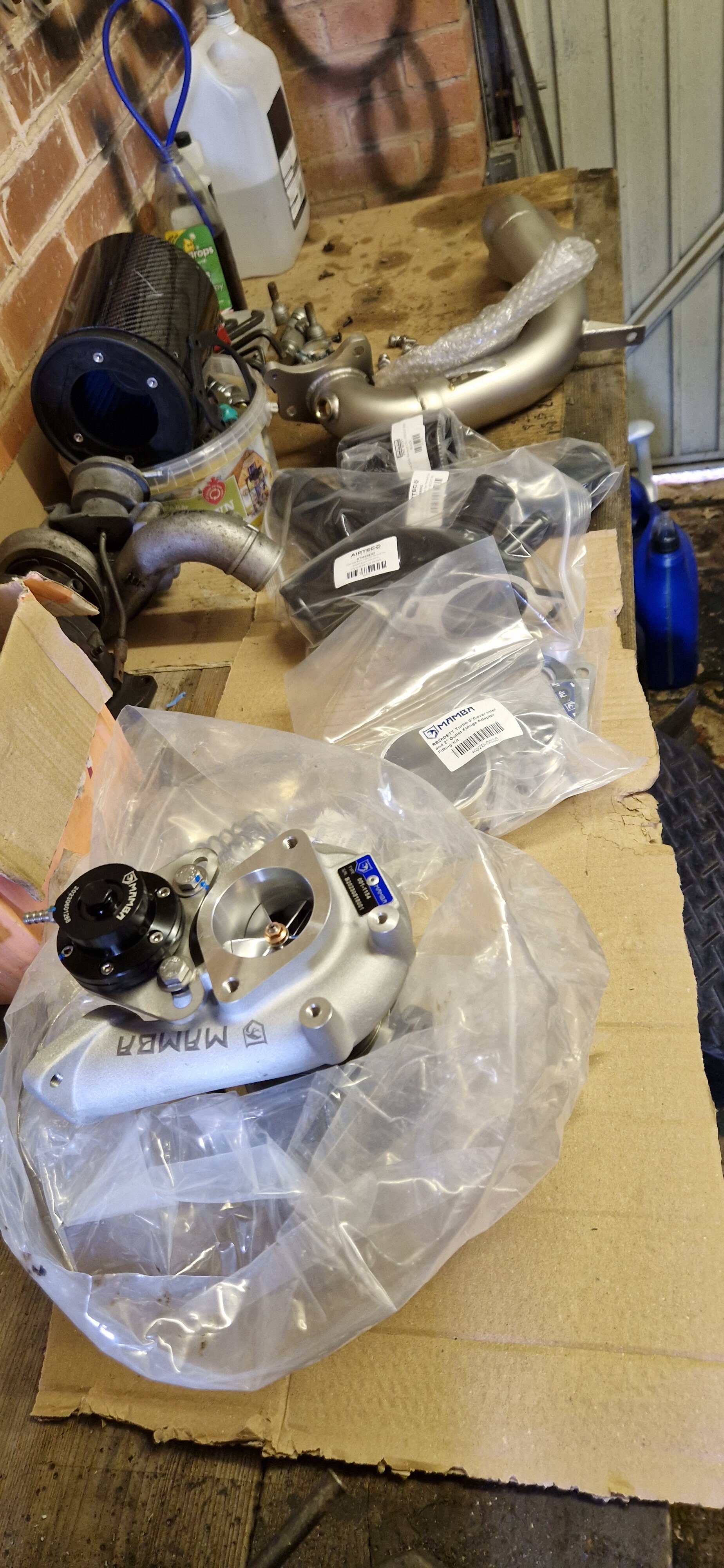

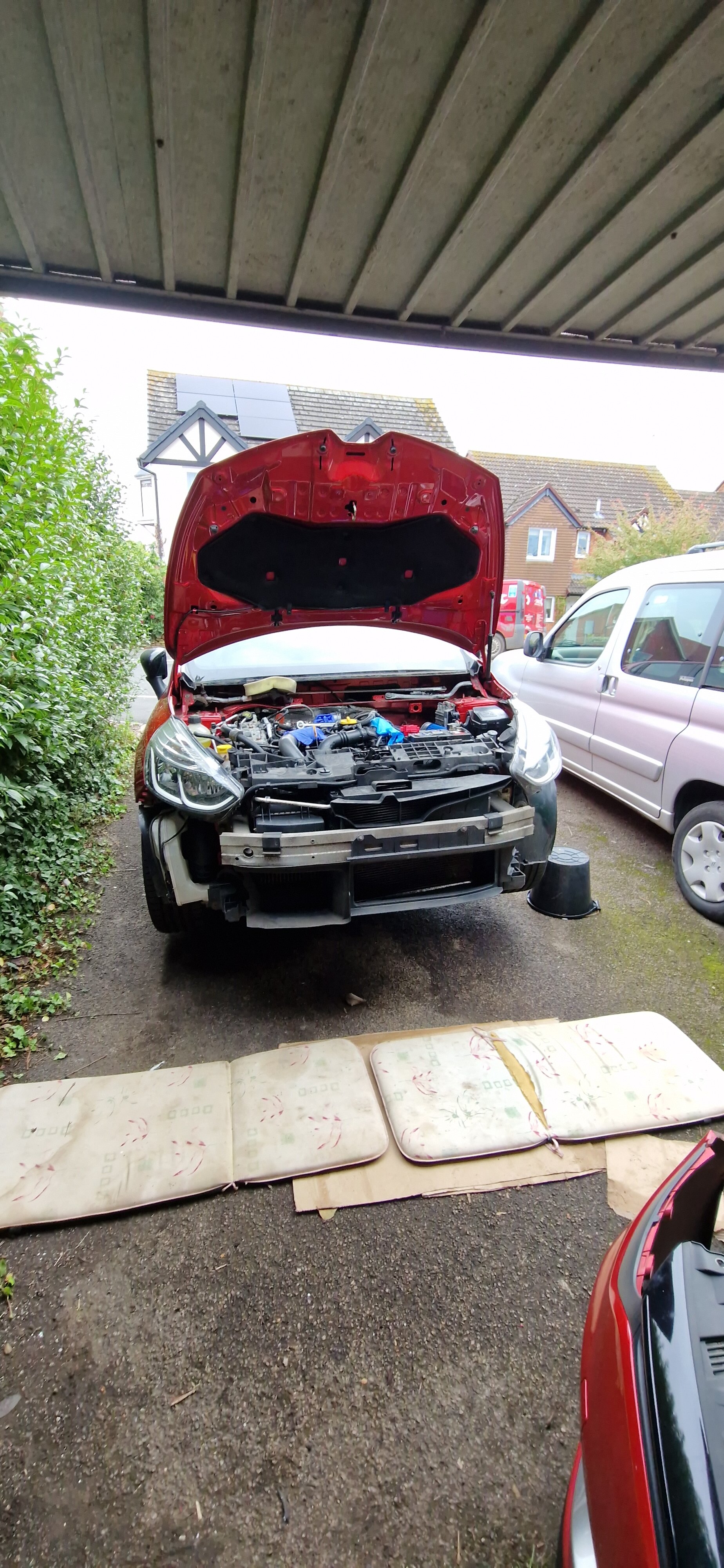

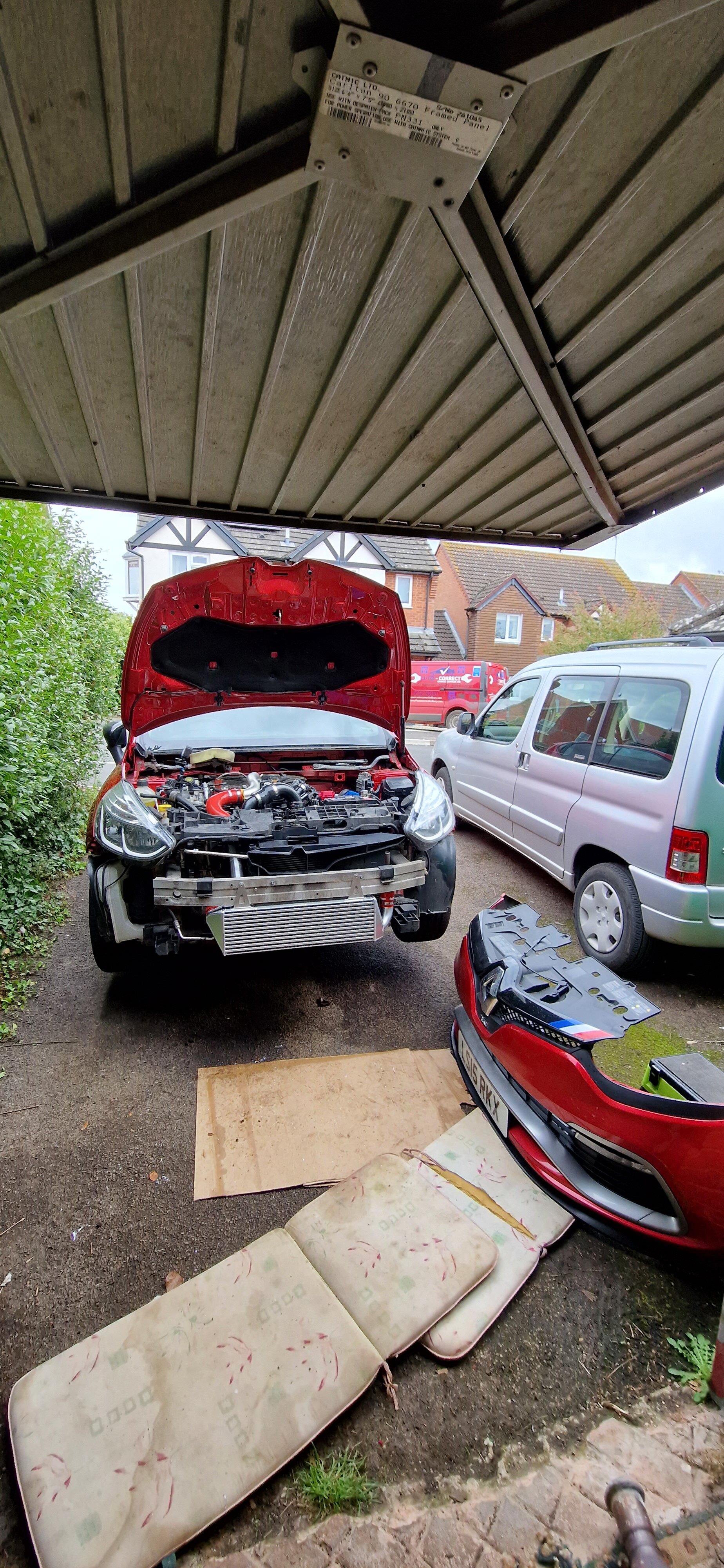

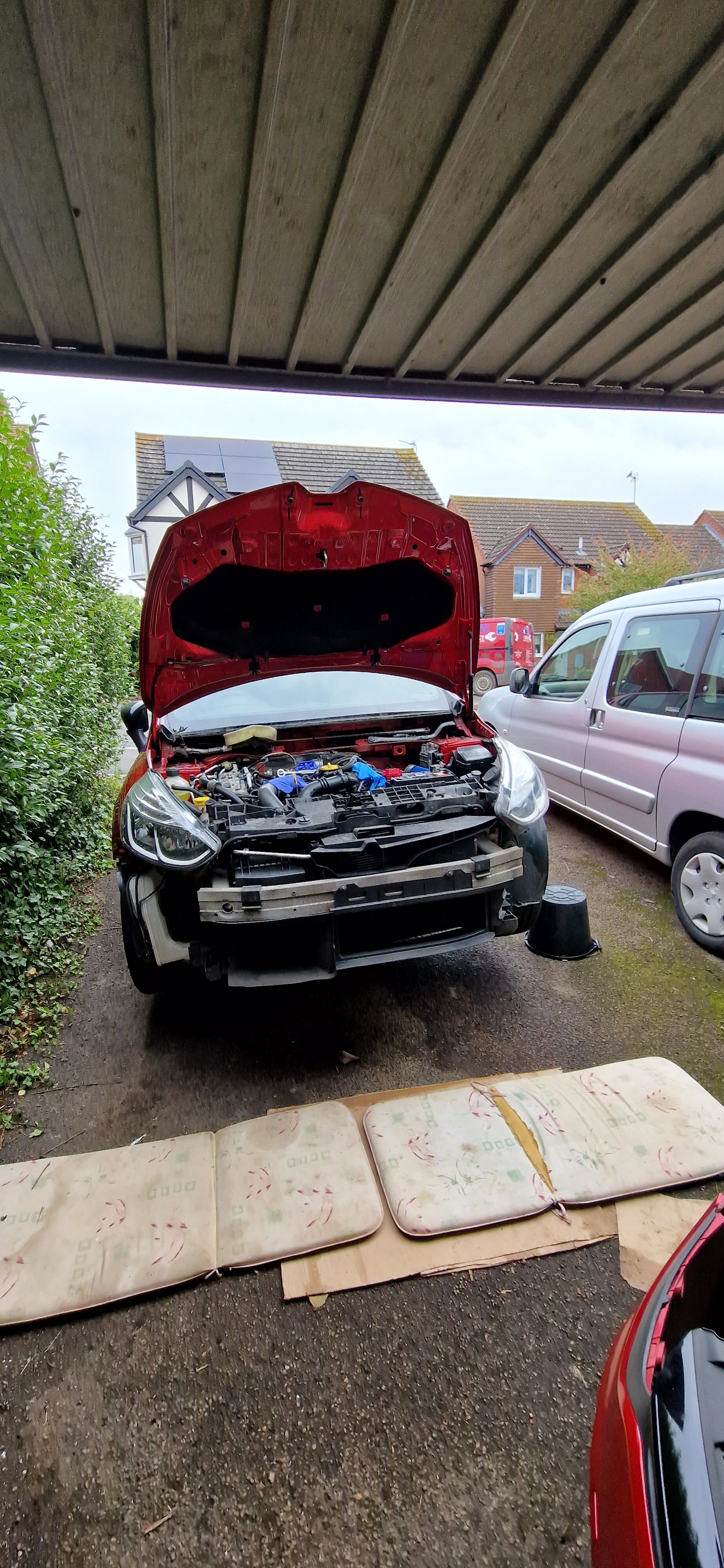

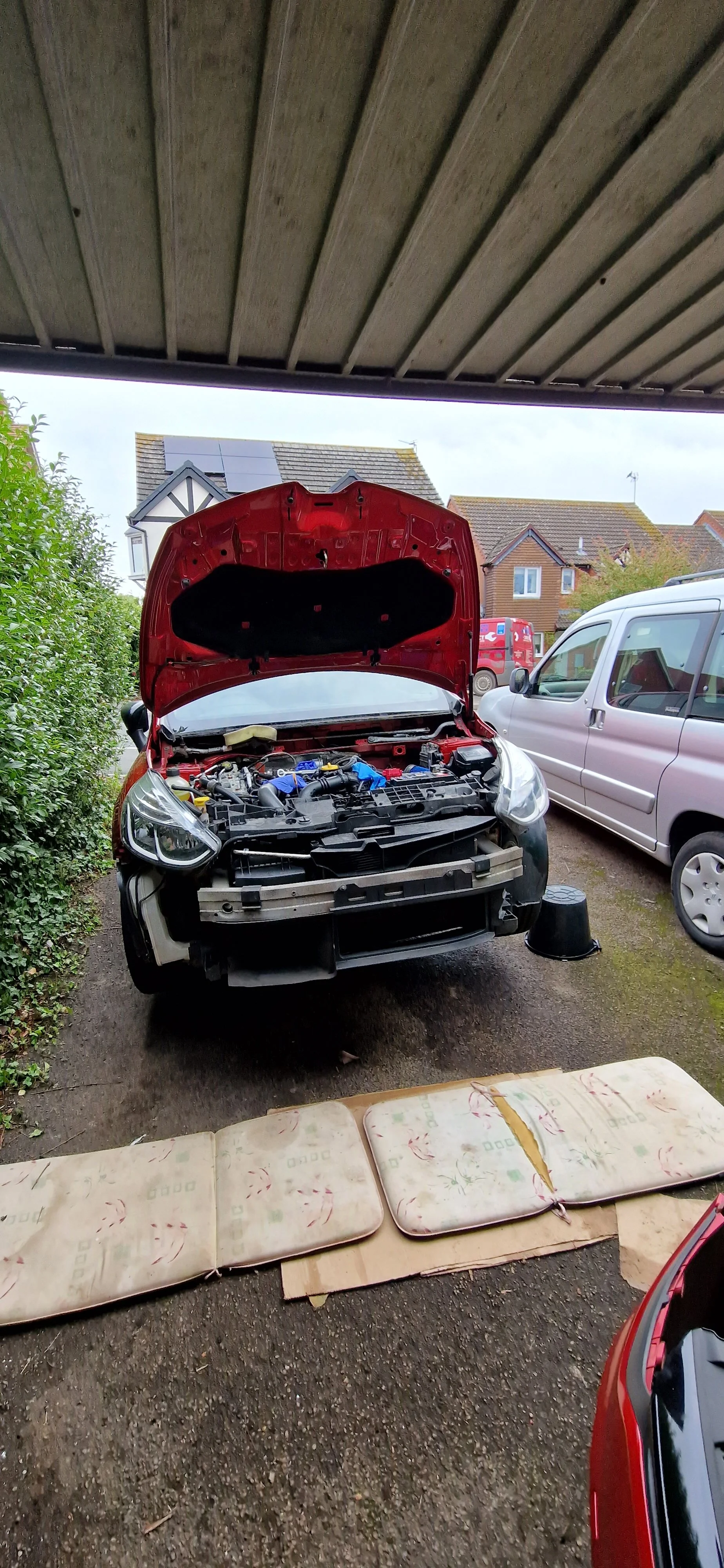

So I've been stockpiling parts for a while and this week I picked up a fmic kit. So I decided to book Friday (today) off work to make a start on all the upgrades.
I've tried to keep the camera rolling during it so ill knock up an update video soon. All has gone well so far, and its been fun swinging some tools (I changed job role 6 months ago and now don't get to do anything hands on).

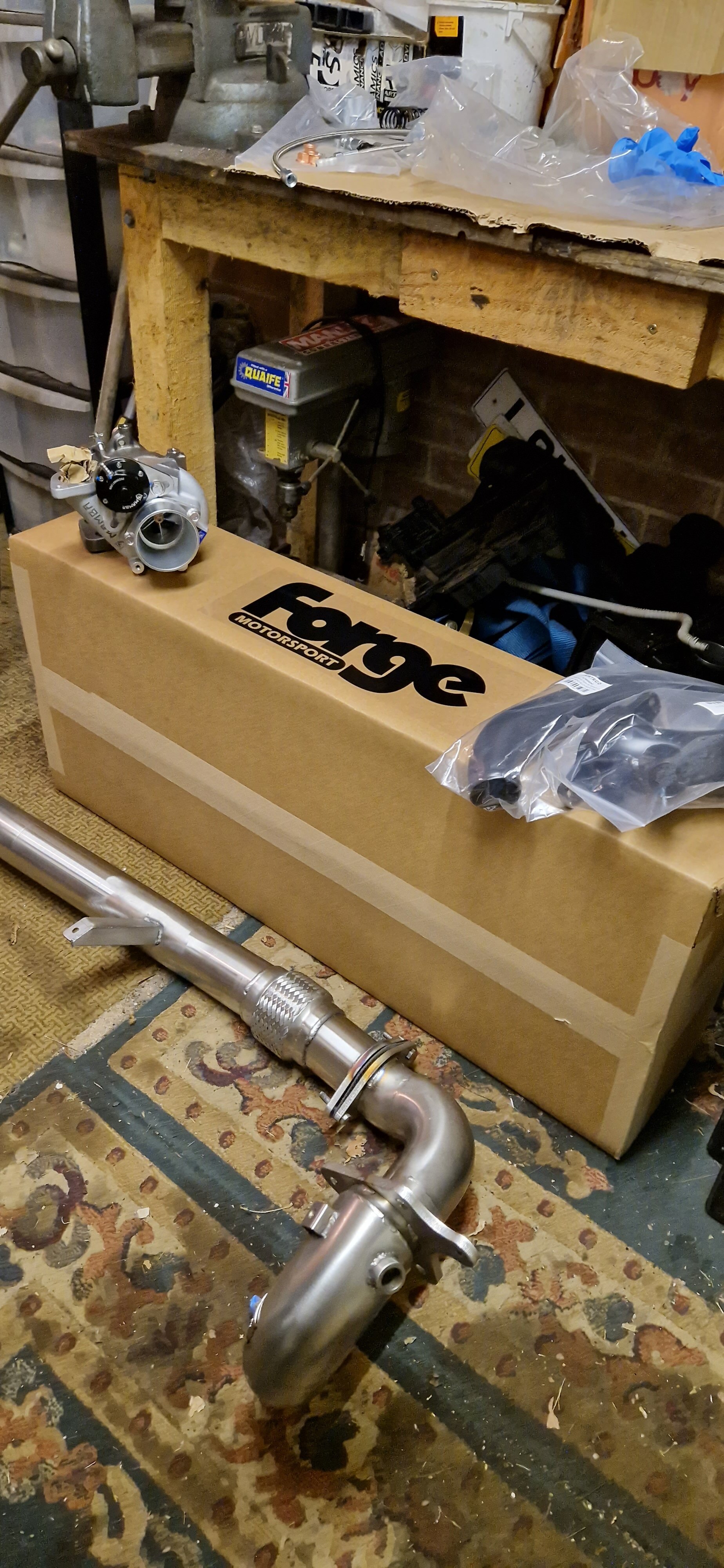

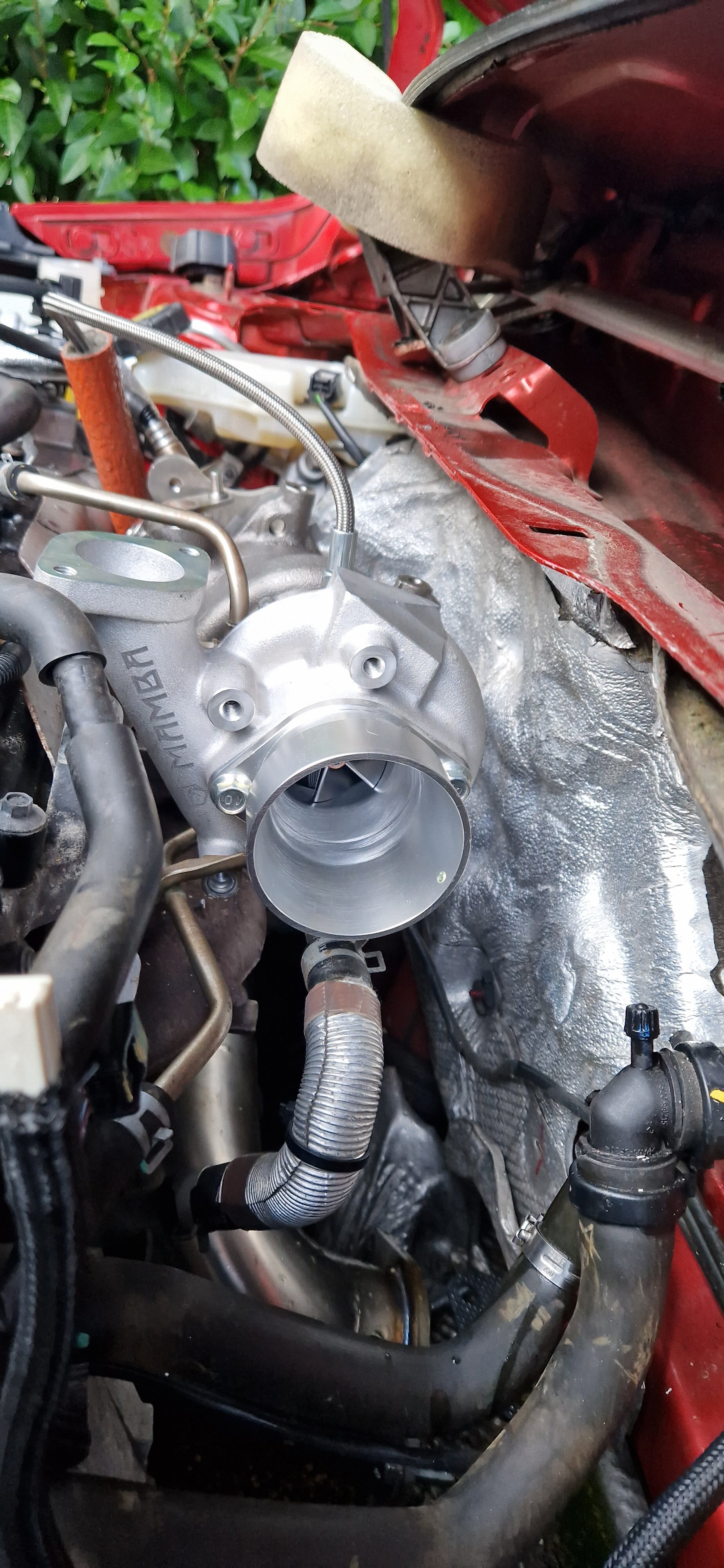

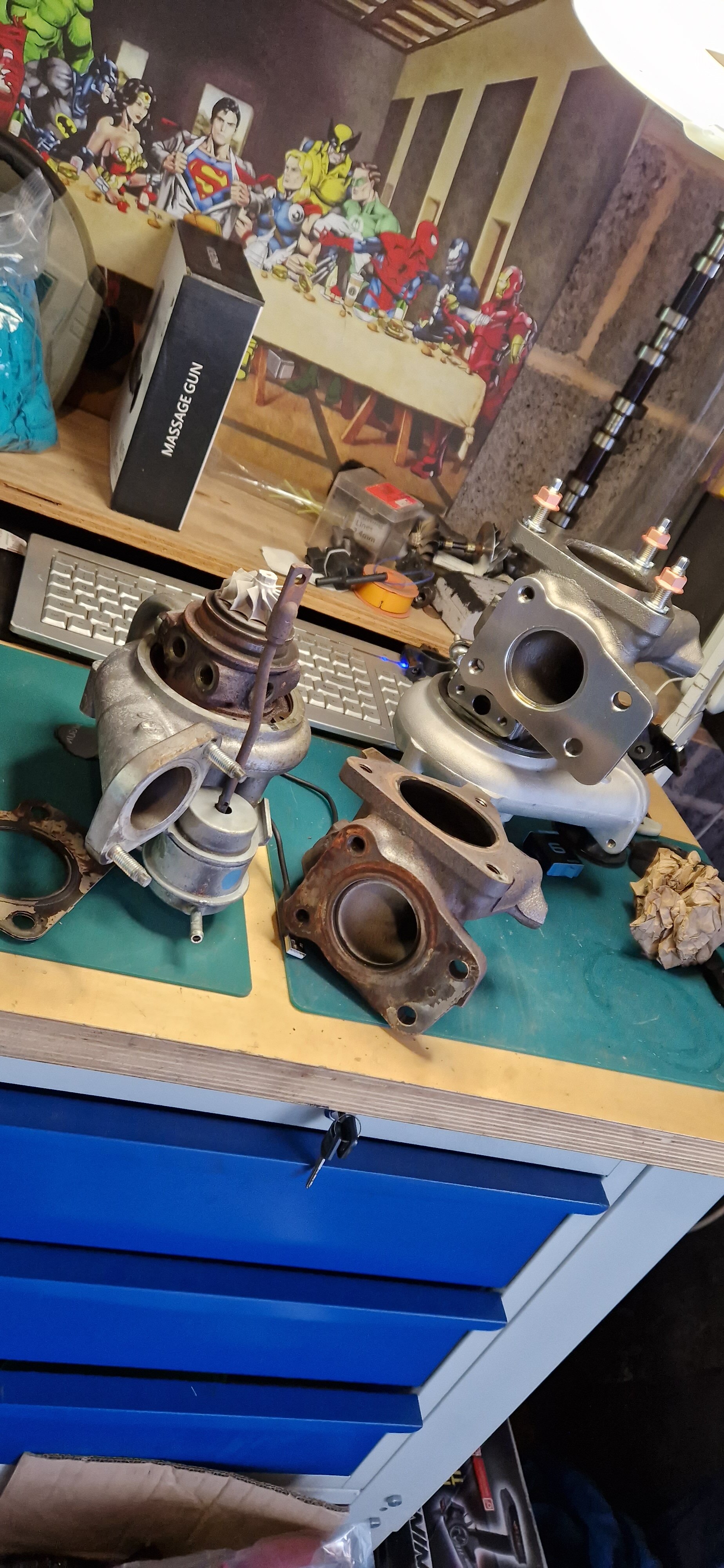

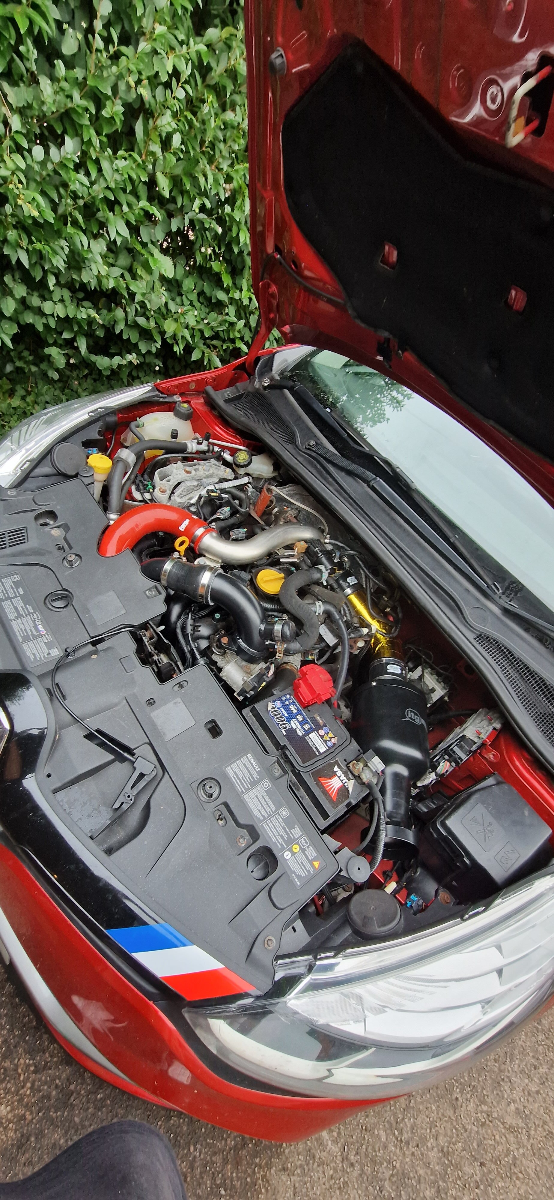

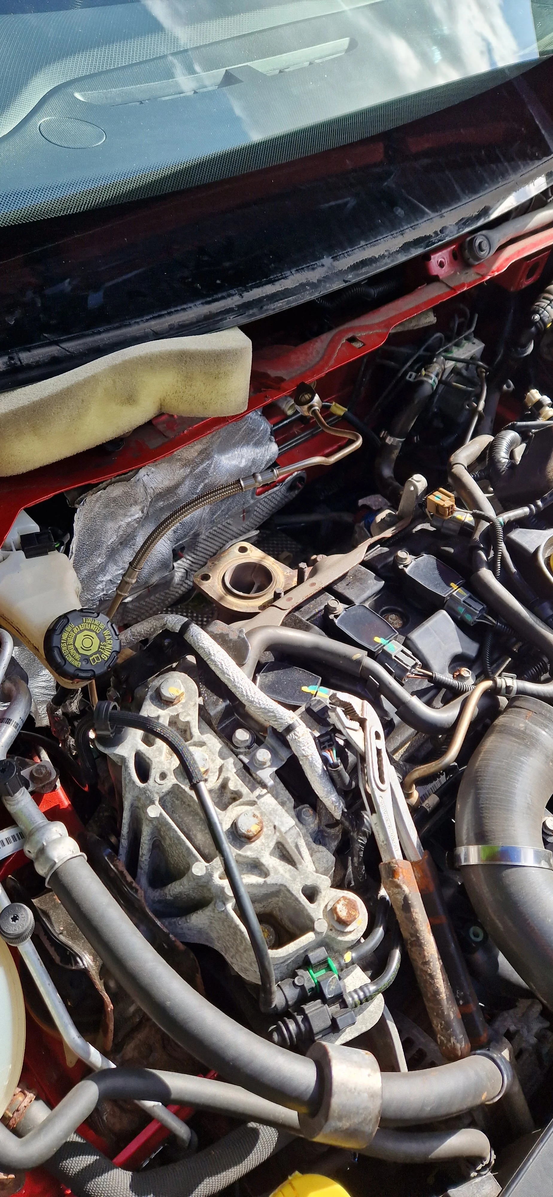

Anyway we went whole hog and started straight on the hybrid turbo and decats. Wasn't too hard to be fair, just takes time when you've not done the job before. What was a shock was how small the stock exhaust system actually is, at least the front half, it steps right down to just under 1.5 inch at the entrance to the flexi!!!!! The down pipe was a bit of a pig to get out but I was able to get it out in the engine bay as I had the turbo out of the way. Normally you would pull a driveshaft to drop it out of the bottom.

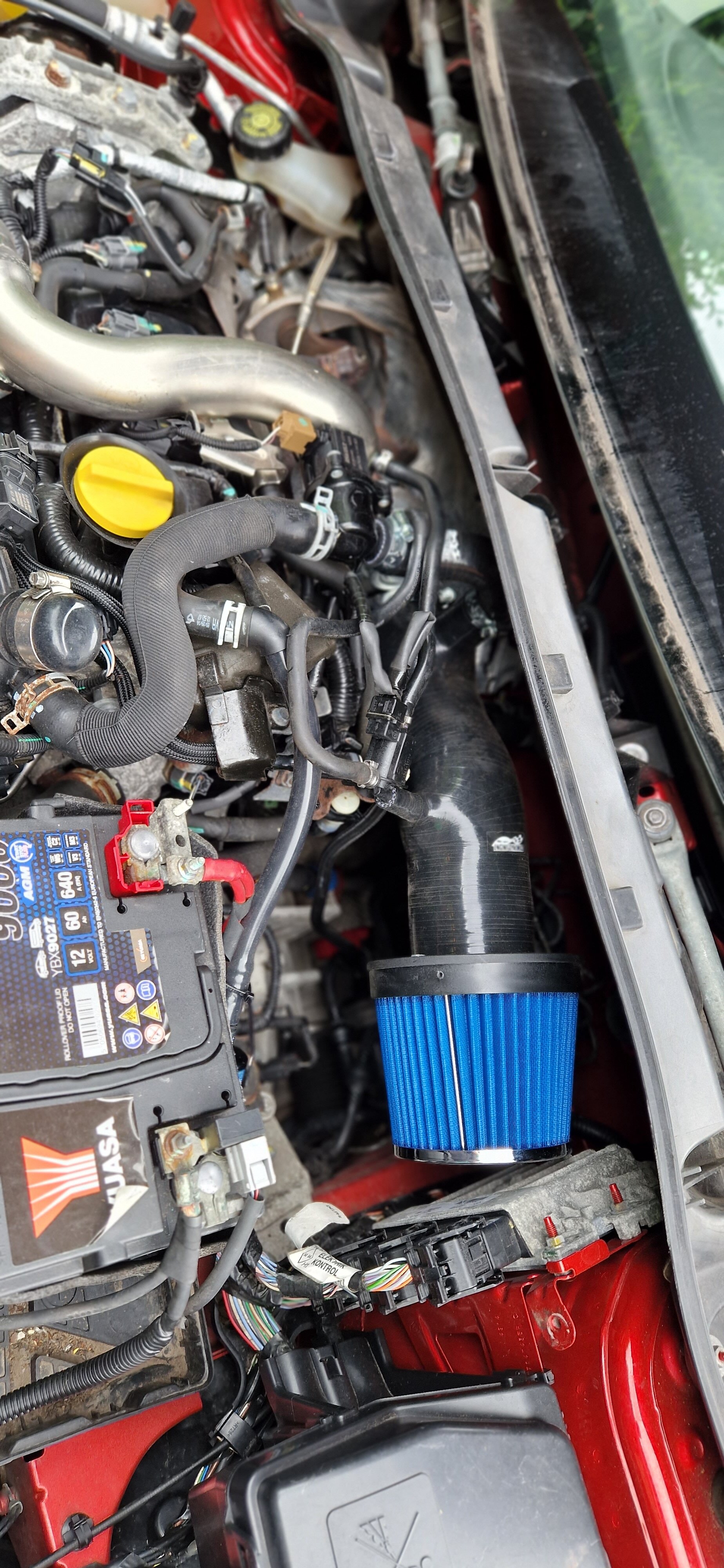

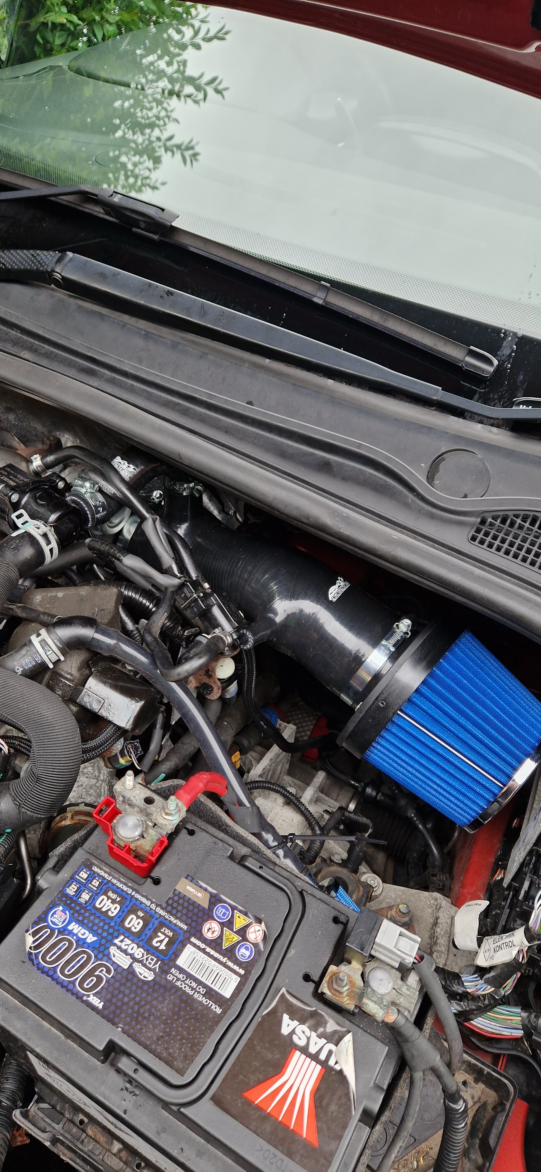

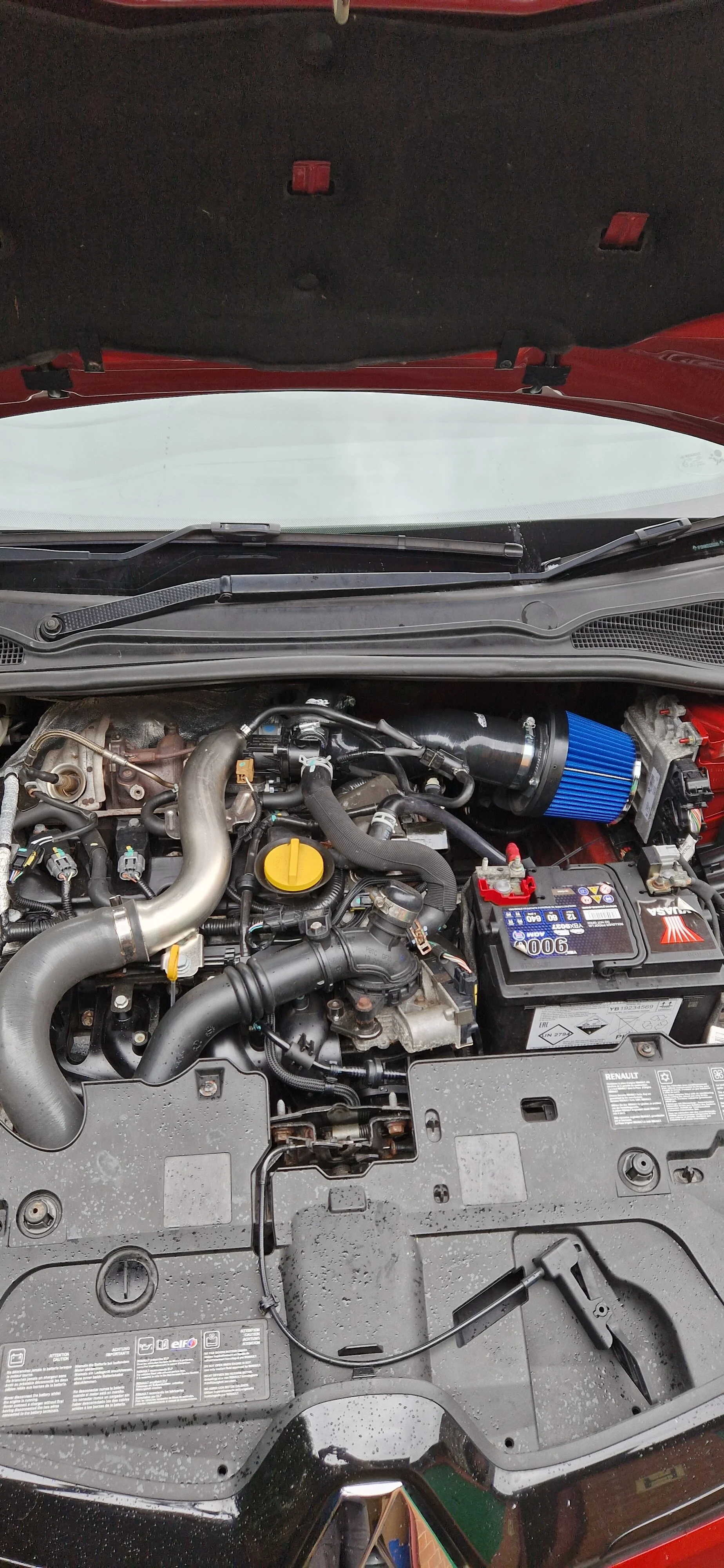

I port matched the turbo housing before fitting, the bigger inlet was too big for an oem intake pipe so ive used a tapered 3 inch adapter (same as the ED kit) but im making my own 3 inch intake pipe work (the ED kit was a bit pants tbh) not sure if I will go open filter or build it to work with the ITG.
The turbo and decats are now on and I have given it a test idle/warm up. No leaks so far. Will re torque everything in the morning and then work on refitting the engine bay pipework and then ill move onto the FMIC.
The plan is to get it up and running for a week to make sure all is good then book in with EFI parts for a map.
Here have a few pics, ill pop some more up tomorrow (y)

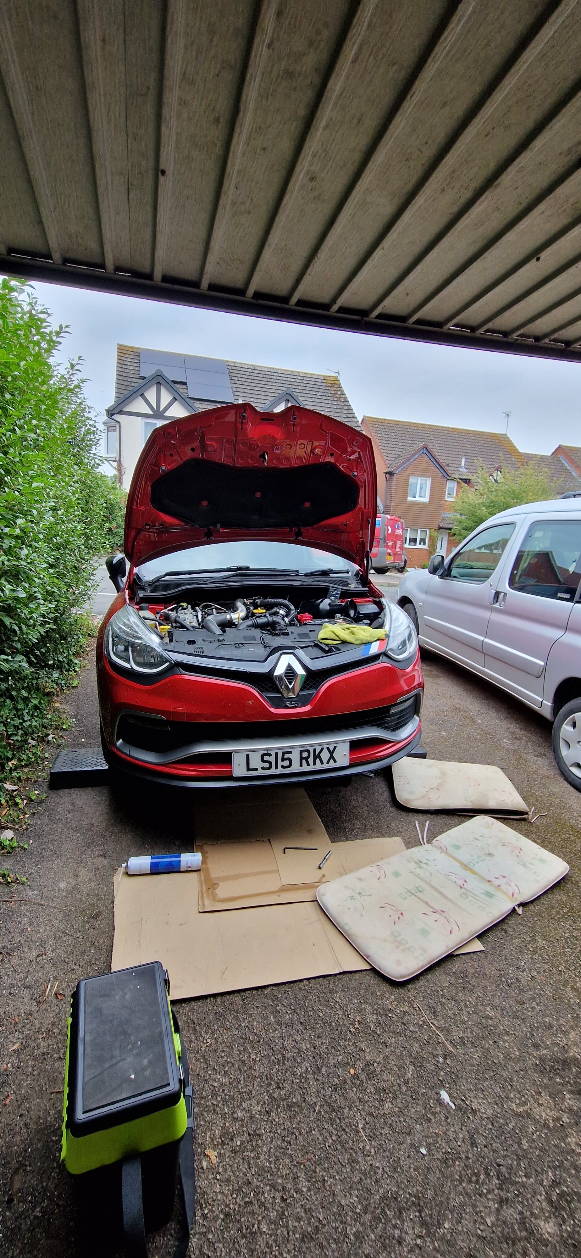

Day 2,
The plan was to finish the upgrades and wrap everything up, and bar the custom intake I want to make I think we are there. I do need a replacement exhaust clamp though.

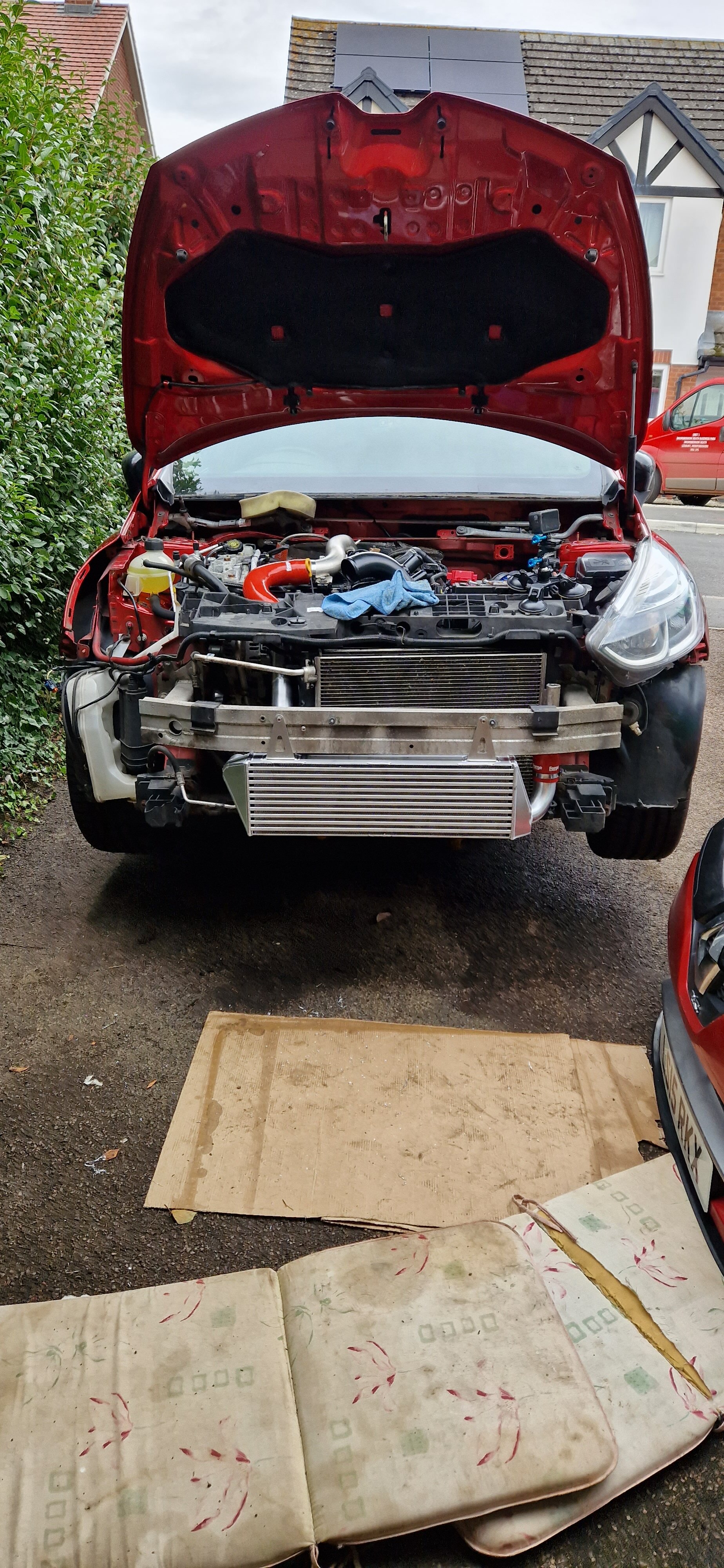

On with the Forge Motorsport FMIC kit. pretty decent kit, fits up nicely. I didn't fully follow the fitting guide (being lazy) but used it to point me in the right direction to remove everything, its pretty comprehensive. It came with all the clamps, fixings and a boost hoses to fit it on. The crash bar requires 3 7mm holes drilling in it but the guide shows you where to drill. It takes about 2 hours to get on if taking your time. Fits very well, only thing I may do is add some holes to the number plate plinth if decide to hit some track days.
Next up was the Airtec cold side boost pipes. Does what its supposed to do, replaces the plastic pipework. I need to take a look at a few pics but its not a perfect fit. I'm not sure if that's because I've fitted it to aftermarket hoses but the 2 pipes don't seem to line up very well and are up against the plastic slam panel, another little note, the hose clamps were showing signs of rust as I got them out of the packet. It'll do what I need it to do though.
Exhaust sounds nuts now, Ktec 3 inch down pipe and front pipe, mated to a mid box delete and the stock back box. Quite chavvy but I like it lol. Not given it a proper drive yet but definitely gives it some theatre now.
