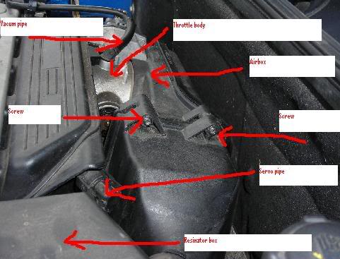

Got the filter through today.. Smaller than I thought
I only had a quick look just know when I got in from work, but is it possible just to pop off the top of the airbox? Doesnt seem to have any screws around it :s
  Megane dci 130
Remove the rubber band on the resinator box, pull that off the airbox. Then undo the two torx 20 screws at the top and swing the top downwards and out. Change filter then rebuild.
