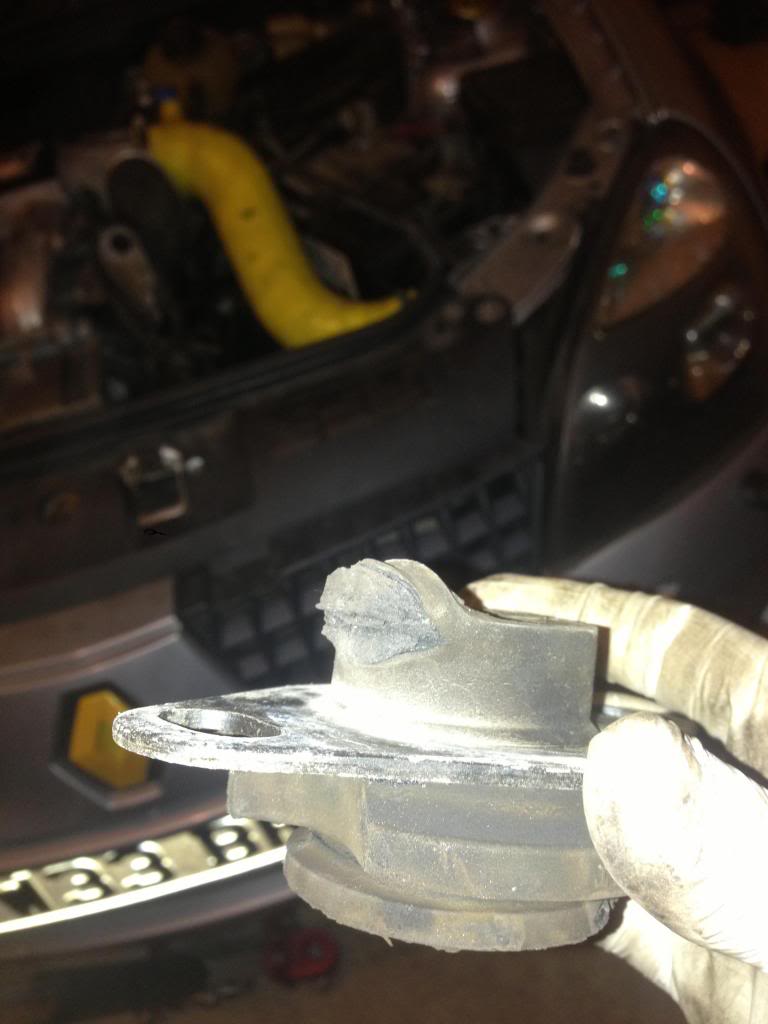

Mine does this on the NSF and its the top mount bearing. Bloody annoying!
Thanks for the reply, it's definitely coming from the strut area, but i wouldn't of thought there are many components that make up the strut top that would cause this?
You'd be surprised. The design is crap for a start. In my case the spacer/nut that tightens down on the top mount bearing locks out on the strut before its fully bedded down on the top mount bearing, therefore the bearing 'chatters' because of the gap (about 2mm)
Seems like poor tolerance on the manufacturing side by Renault as the other side is fine. Need to use a spacer to resolve it.

Genuine top mounts are the way to go but I still think its a bit hit and miss as to whether they rattle, even with the new spacer design they brought out last year.
I have had more issues with mine since I replaced them compared to the original top mounts. Mine currently sounds like the car is going to fall apart at any moment.

It goes shock/ spring/ spring cup/ bearing/ additional spacer/ rubber cup/ spacer nut. Then once on the car you put on the top cup and nut.
This is different to the knocking sound people got with the old design where a spacer went somewhere else.
The additional spacer is an M16 with 30mm external diameter and about 2mm thick.

So far I've replaced the OSF top mount, had the whole kit. This made no difference what so ever. Also tried the 'Washer fix', and also had no luck with this either.
As I didn't want to go cutting the body away like the old Renault fix suggested, I thought as an experiment, I'd cut some spare rubber pipe, and fit it around the top where the turret sits, and see if this changed the noise, or got rid of it completely...
Unfortunately, no change, the noise is still exactly the same, and happens under pretty well all conditions. Can be any speed, and on any steering angle :(

Also my other thought was the strut top mount bearing assembly again. I got a none genuine one from Euro car parts, as they're local, and know them pretty well. Has anyone experienced the none genuine ones to be any good? When it was originally replaced, I was certain that was the cause, as when it was removed from the car, you could move the whole bearing a couple of mm in any direction. However once the new one was on, this was also the case. I got in touch with my local Renault dealer, and they said the play is normal, until the weight is on the car. Can anyone else confirm this? I suppose the easy (but slightly long) way of checking would be to see what the NS one is like.

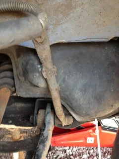

I had the same probably with my exhaust realigned it 2 or 3 times and it would clear for a while then it came back last night, only thing i could think of was a engine mount was away allowing the engine to move more causing the exhaust to split.
so got the car in the garage and checked the dog bone mount first that was fine the check the engine mount was fine but replaced it with the vibratech mount i had sitting anyway, then checked the gearbox mount and it was knackered

Wow, thanks for the reply mate. That doesn't look good at all. If I'm honest I haven't really even looked around the NS of the car, as I'm confident the noise is coming from the OS. However it's possible it could be causing something on the opposite side to knock. I'll certainly look into the gearbox mount some more.
Now it's been mentioned, I can get it to knock (different knock though) when it's in reverse, and you bring the clutch up with the handbrake still on. Was trying to get it to make the original noise, then a slightly different one happened lol.

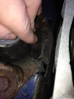

That little bit of rubber on the engine mount looks to be coming away, but when it's all back together it seems to be sandwiched.
Another thought was this cover, as when I tapped it slightly, it made quite a bad noise. Turned out it wasn't on quite right, and is missing some clips, so managed to cable tie it for now.

Decided to have a search on here, and found a thread about the ARB rubber's drying out under the wish bones. So covered these in WD40, took it for another run and... SILENCE :D.
So now I'm hoping I've found what it is, I've just got to go about replacing them. Would any one have any suggestions about which ones to go for? I'm thinking OEM with plenty of copper slip, but I may be wrong.
