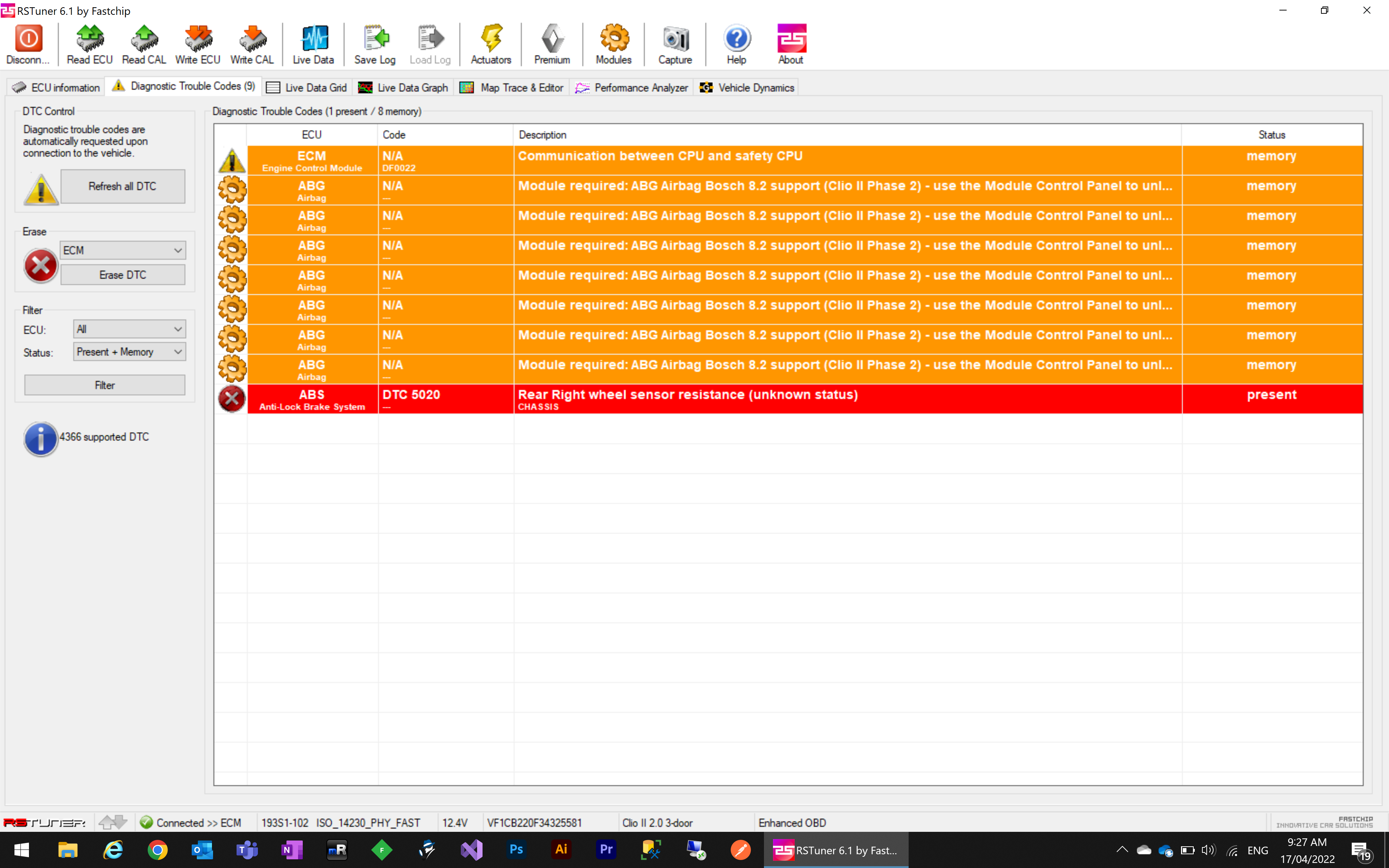

My ESP, SERV and ABS light came on this morning. Feeling a slight judder under breaking so seems like the ABS sensor.
I plugged it in and got the below error. I assume this is due to a faulty rear right ABS sensor?
If so, can somebody confirm this is the correct part for replacement?
https://www.onlinecarparts.co.uk/triscan-7659429.html
Thanks in advance,
STRBramley

Best place to buy is K-Tec racing as they sell the correct ABS sensor for the Trophy / Cup with ESP
  Bus Winker
Cheers mate, you don’t have a link do you? I’m searching on my phone but can’t find anything on the k-tec site. No worries if not, I can take a proper look later when I get home.
