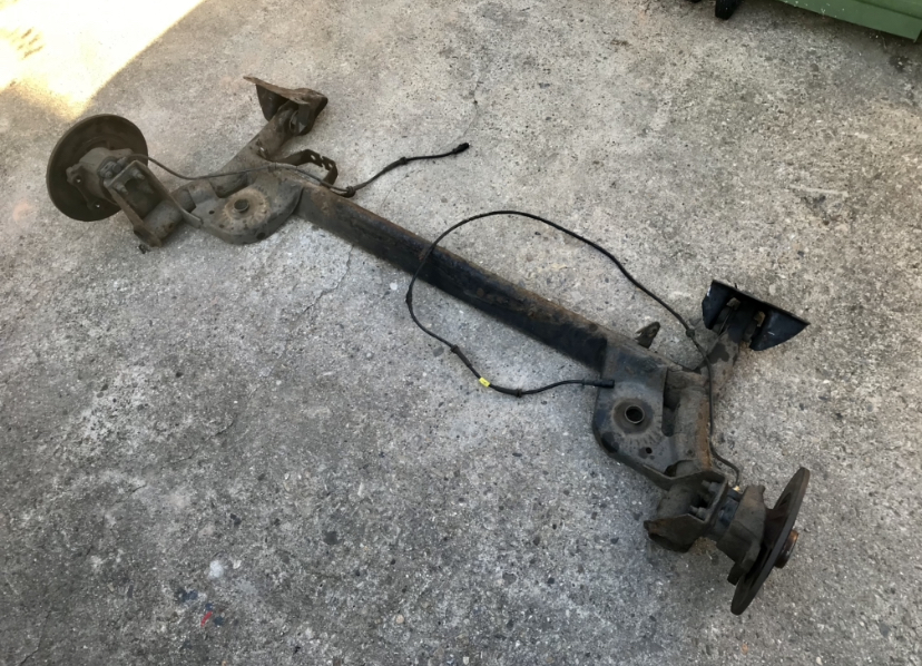

Here’s a picture of one of my old beams with sensors still in place. Might help you a bit. NSR (left) two male pins and the shorter of the two. OSR (right) female plug and much longer.
