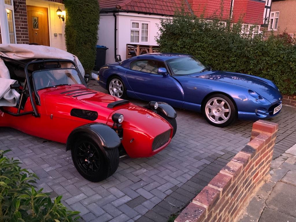

Before [mention]Daniel [/mention] has a coronary about me asking for detailing advice without a new car thread... see attached.
I fell out of love with the Westfield after a series of seemingly poor mechanic choices. Major works bring it up to spec oct19-dec19 only for them to c**k up coolant bleeding and it blew it’s head gasket. I had the “best in the business” out to resolve on my drive but it still wouldn’t restart. Then took it to “the best” Surrey based 7 specialist who disappeared for 13 weeks and finally it came home.
A brilliant car - mind bending at 6am on a Sunday without caffeine - but not right for me as the only fun toy.
With the arrival of my son 11 weeks ago, the standard mk6 golf was also becoming too small. So I opted to throw both out and welcome in a new breed. It’s just landed in Italy after a very easy export transaction.

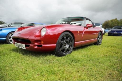

Tvr chimaera 400, 47k Miles, a few breathing modifications but importantly solid underneath + preventative maintenance done such as fuel and coolant lines, water pump etc.

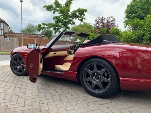

A few updates to the Tvr… I say a few;
- new Rl7 wheels wrapped in Michelin PS4 tyres
- new ACT intake
- new ACT cherry bomb exhaust
- Clive F y piece
- pre cats removed
- new throttle pot
- new throttle cable
- new injectors
- new coolant and heater pipes
- new fuel hoses
- plenum and rocker covers painted

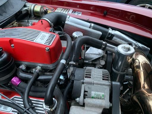

- Emerald and tune by Kits&Classics + new wiring/maps/other gubbins to update and ensure reliability
- New Nitron digressive suspension
- Mew lower wood veneer facias
- New radio
I also re-coloured the seats/leather interior and re proofed the hood.
It now goes, looks and sounds exactly as I wanted.
I need to give it a decent detail and fit the larger brakes I’ve just happened upon!

The emerald fit removes all coil/amp/dizzy and wiring, with standard fit Range Rover coil packs now hidden behind the plenum, so also a much cleaner engine bay.

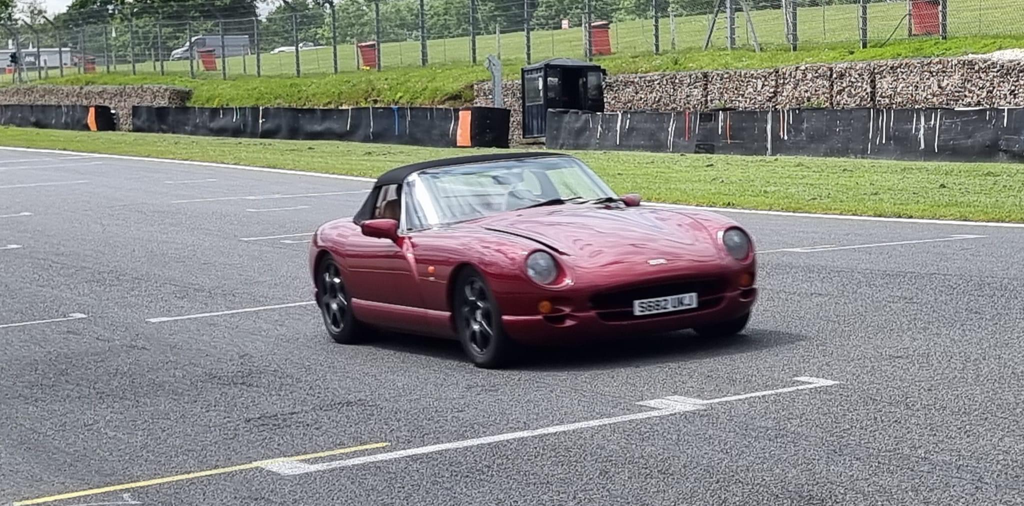

Coming up to four years in my ownership and it's not put a foot wrong. Still thoroughly enjoy it and haven't seen the need to chase more power with a larger engine or FI (but do have a turbo kit from the late great Eann Whalley if I change my mind). My first track day in it a few weeks ago was great fun. TVRCC day at Brands Hatch, so 45mins over in the morning early, breakfast en route and a day of blasting around with other owners.

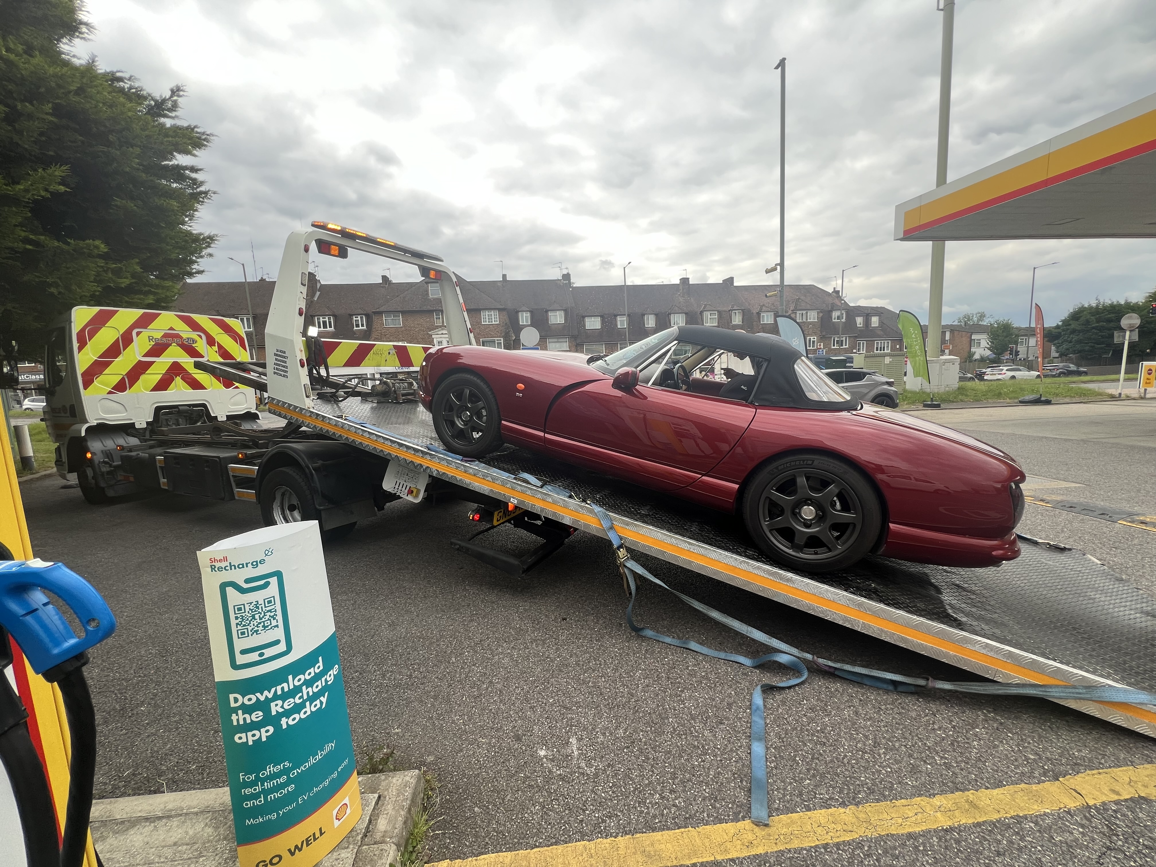

Next start and the same thing happened as I got to the Shell station locally to fill up, so called out the low loader! First time I've needed to use them and they were superb - I was "rescued" in 1/15mins and the car was delivered to my specialist half an hour later.

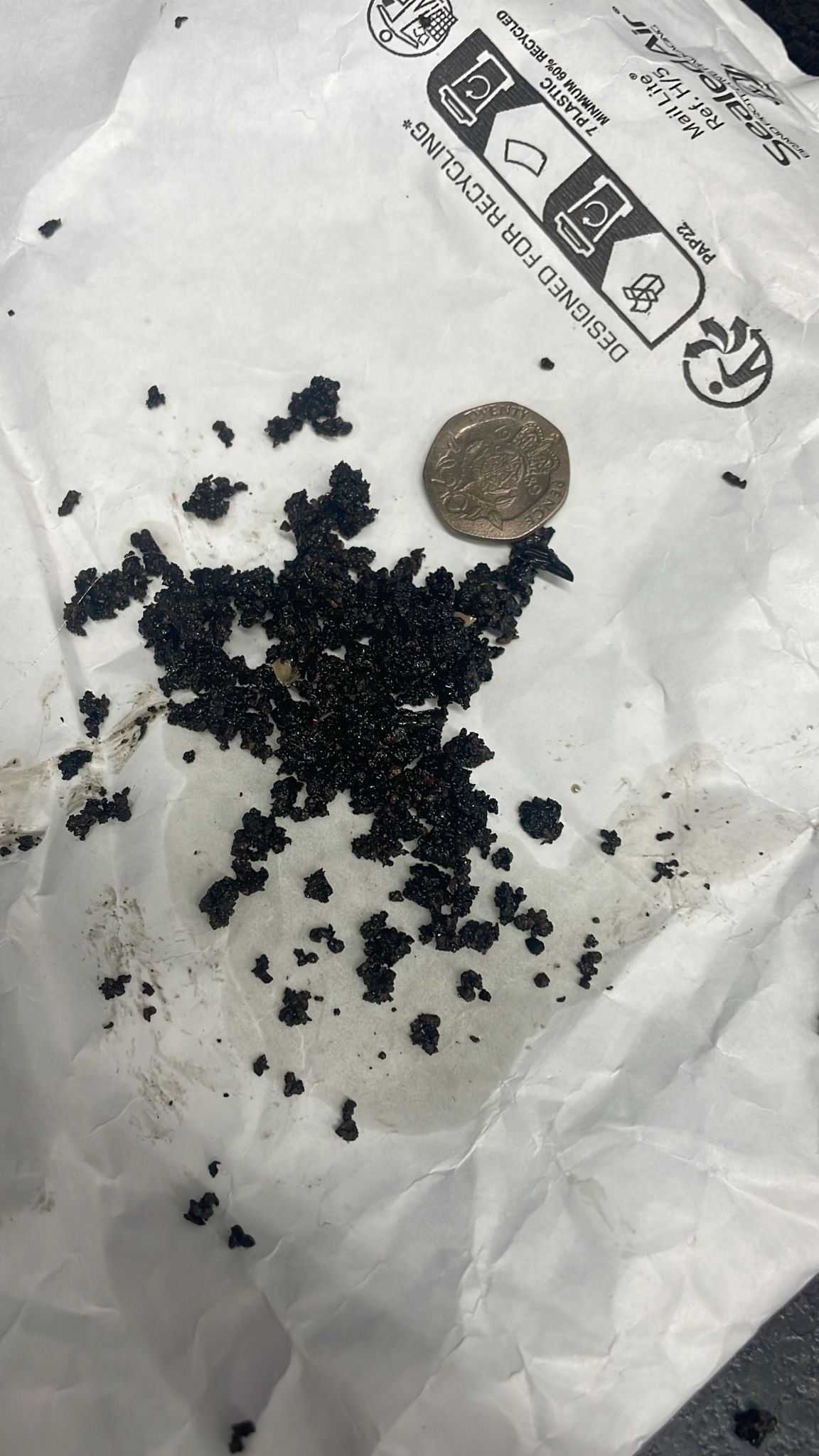

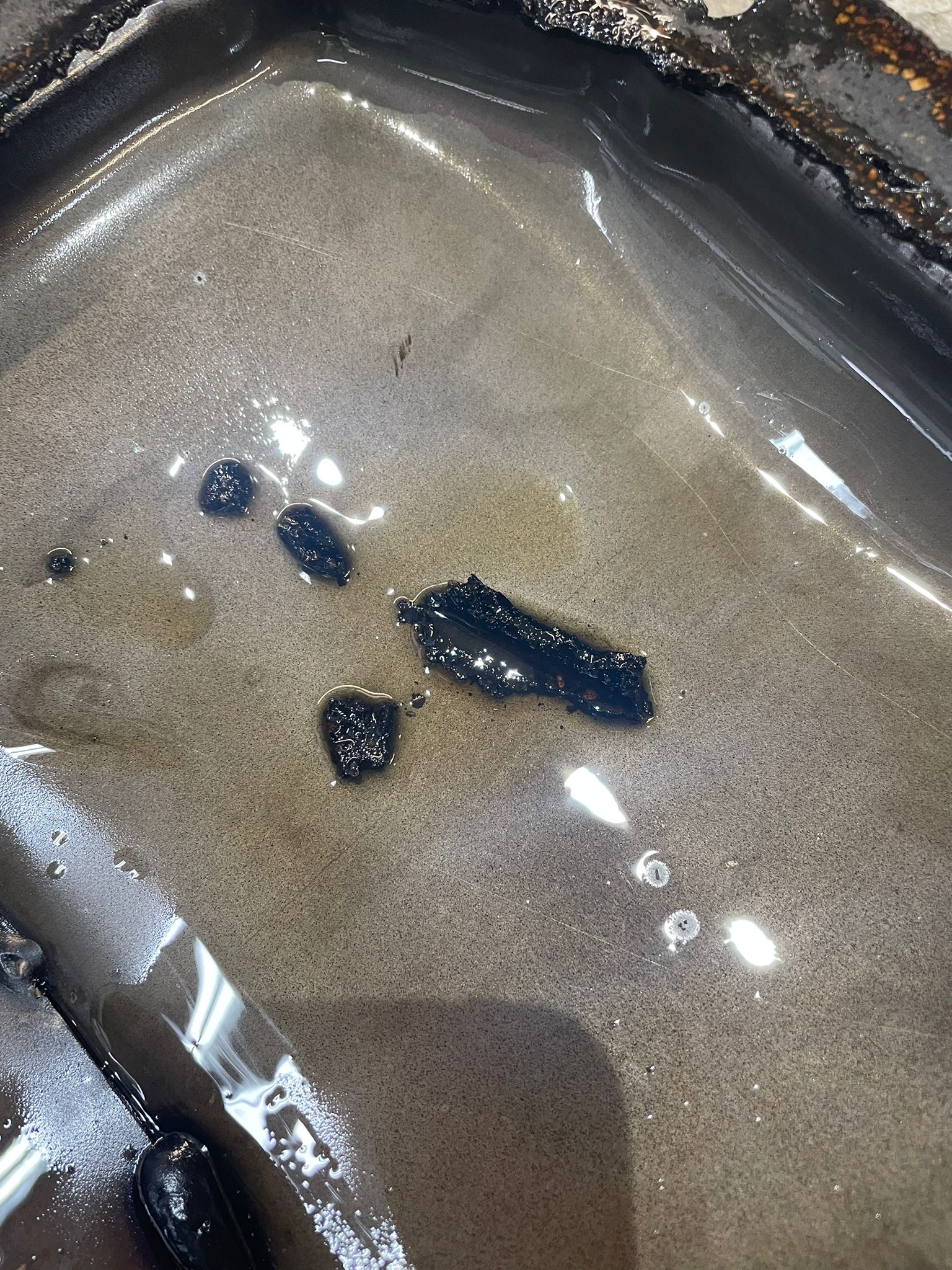

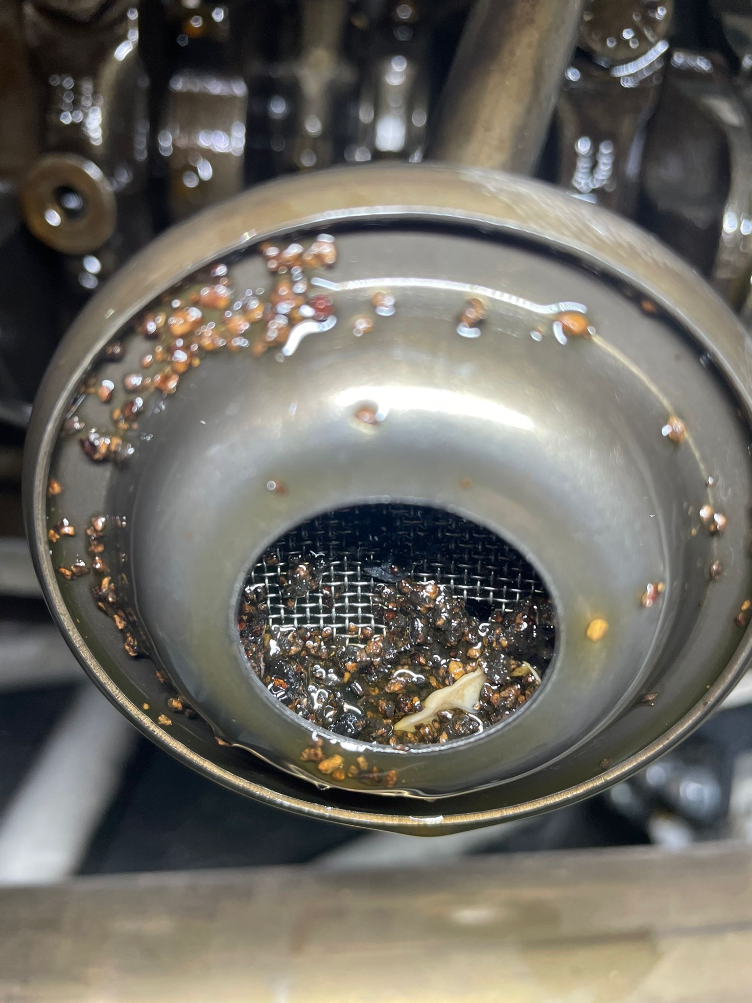

As soon as the car was unloaded we decided to see if a cool engine would perform the same magic as last time, i.e. start and run the correct pressure... sure enough, it did. Sump taken apart and we are shown the remains of an over sized sump gasket sloshing around and likely blocking the pickup pipe. Also looks like some instant gasket type material so clearly blocking the strainer when on track, leading to the low oil pressure.
A few other minor preventative maintenance bits done like changing out the spring in the pressure release valve, slight seep of oil from the valley gasket, slightly squeaky water pump so all changed.
