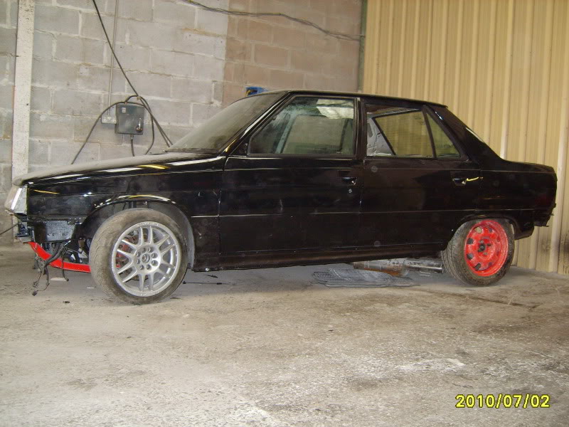

OZ F1 wheels ??
Car  RENAULT 9
I believe they are OZ F1 wheels but
the center bore on these is 68.1mm and the offset is ET37
also opposed to clio ones , these have holes for both 4x100
and 4x108
any ideas where i can get spigot rings for these to bring them down to 60.1mm
Halfords mate on pre-order about £1.99 or contact OZ yourself and ask for some to be made to the size you need.
I have a set of these as well, i assumed they are replicas because of the 2 size hub fitting. The adaptors with mine are plastic which I don't like the idea of. Are alloy adaptors available?
