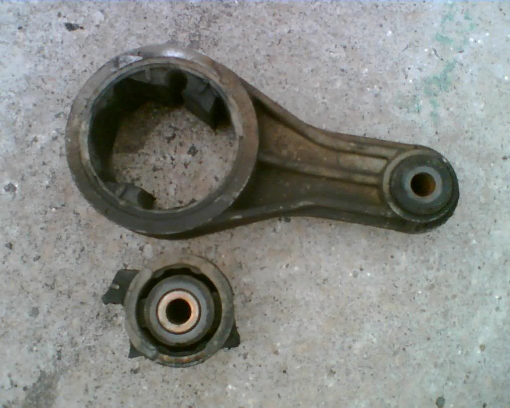

So she started as being a bit dodgy to drive, rusty arches, the engine bounced all over the shop, tracking & balancing not too clever & being waaaayy tooo low, had a lovely supersprint manifold fitted but a god awful, massive & chavtastic exhaust fitted :evil:
Cause of the engine bouncing all over the place
So replaced with a new 1 and eventually this

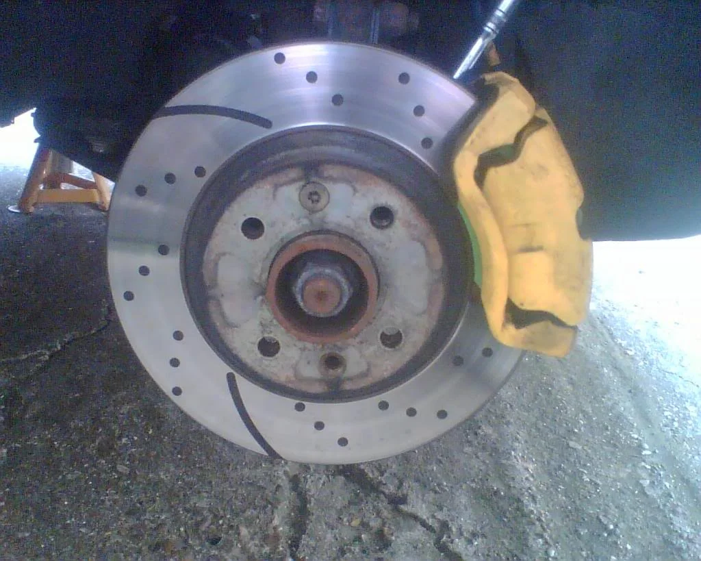

Next on the list was a complete overhaul of the braking system. So I got new discs & pads all round, a full set of goodrige brake hoses and some spanking new front calipers that I painted yellow 8)

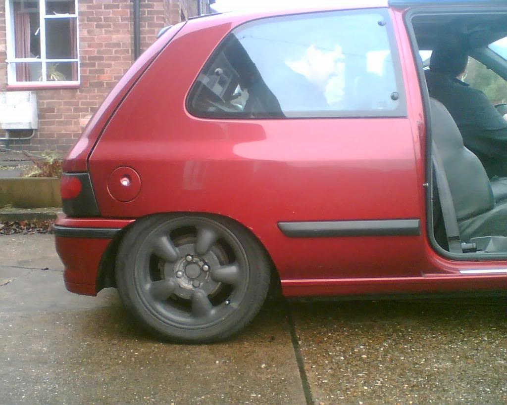

So on went brand new std front shocks with 30mm eibach springs, new wishbones, DeCarbon rear shocks from the clio cup race cars - great for some epic lift off oversteer action :twisted: brand new steering column, leather interior, much nicer steering wheel instead of the awful looking thing with the airbag in it, decent speakers (bought my own head unit) and the nice shiney gearknob & bits around it. Magnex exhaust & custom de-cat at the time it had to be custom made as the pipes I had didn't fit together with each other but I later discovered that the supersprint manifold & downpipe were williams fitment and not for the valver. Then there was the full set of samco hoses :D

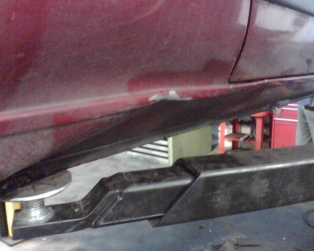

Bent drivers side sill

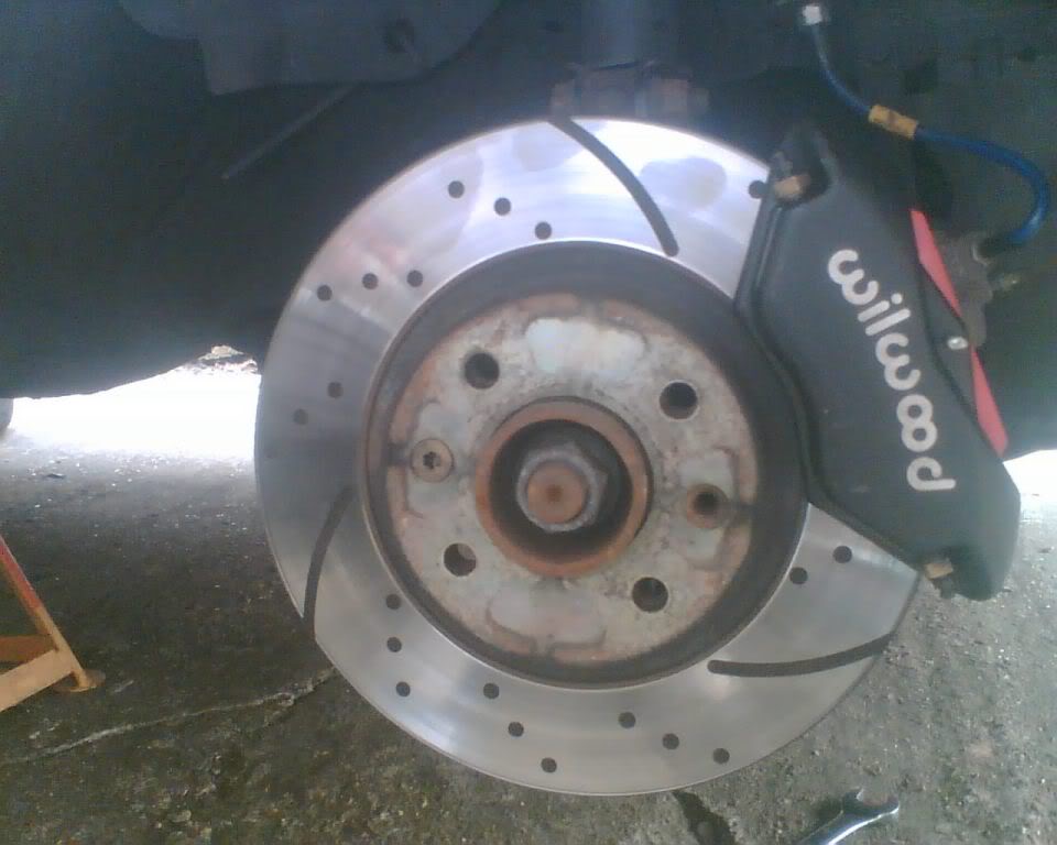

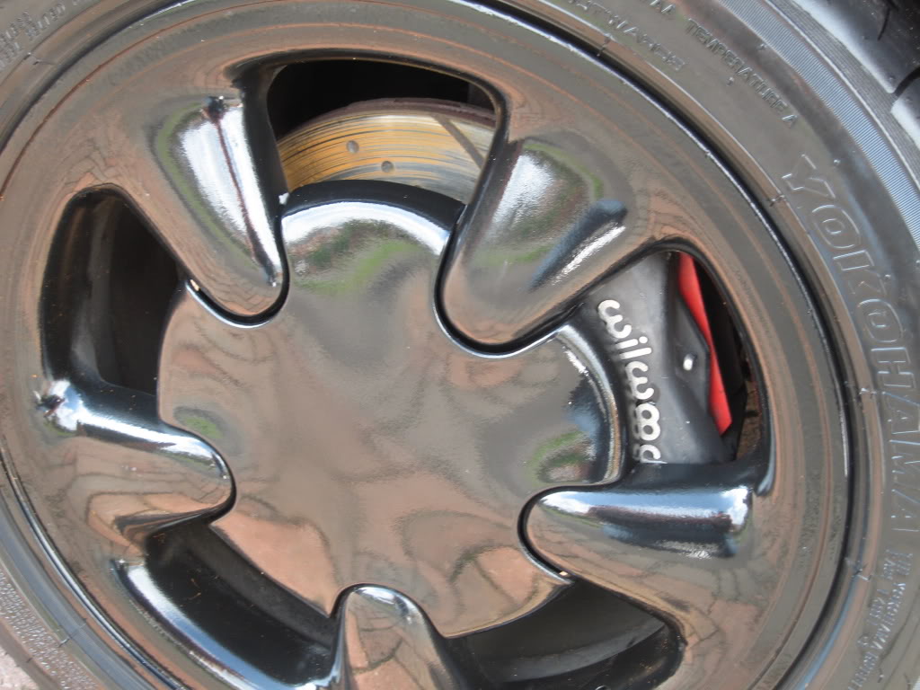

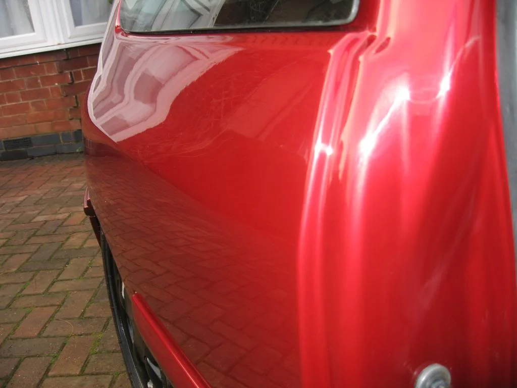

In the month following the bump I started buying parts, 1st was a rust free tailgate to replace my rotten 1 and in 1 big trip down south to 2 people I came home with a pair of rust free doors, ph1 wing mirrors, 2 cats that I later weighed in & made £80 profit :D magnecor HT leads, RSi side skirts and these beauties

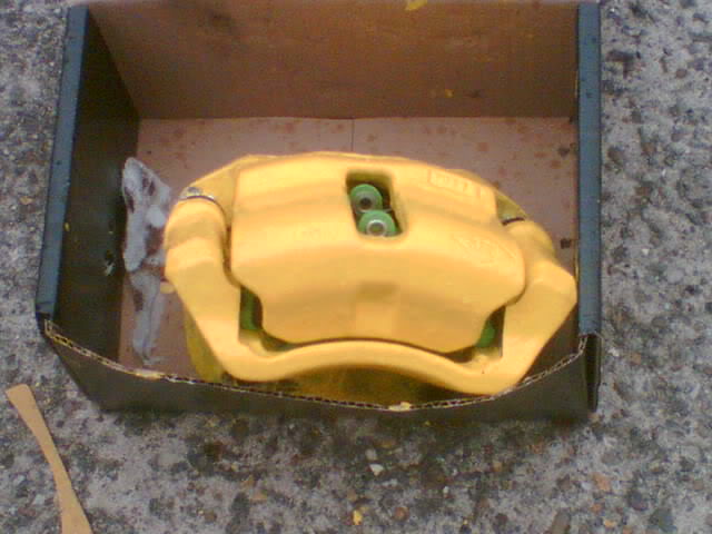

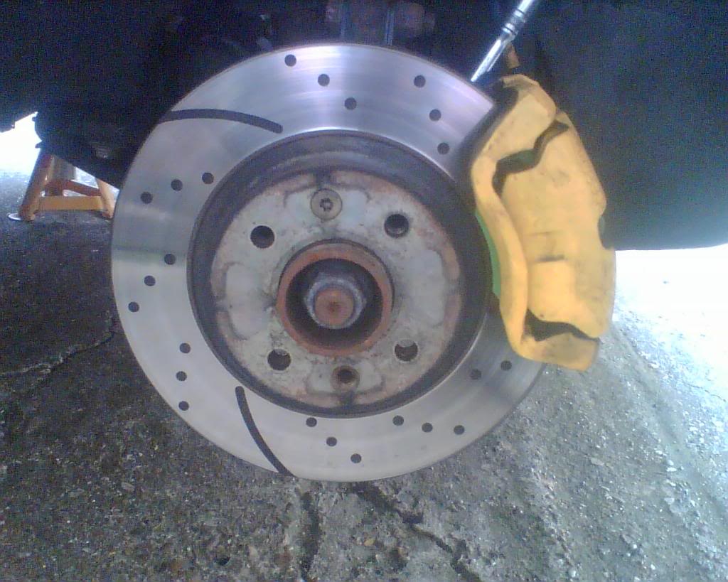

Wilwood Dynalite 4 pots :twisted: As you can see they got fitted straight away & I've loved them ever since
I also got from other people, a full set of wheels to refurb, new front & rear bumpers and a williams boot spoiler

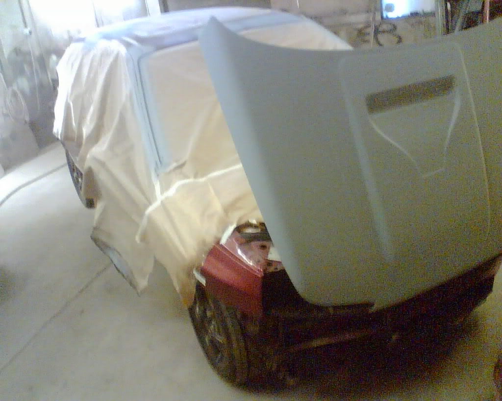

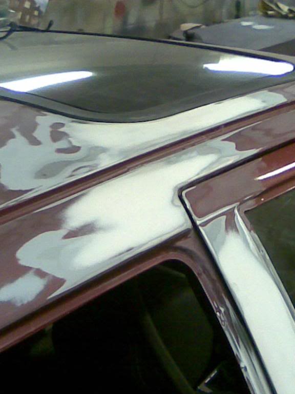

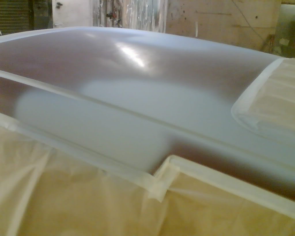

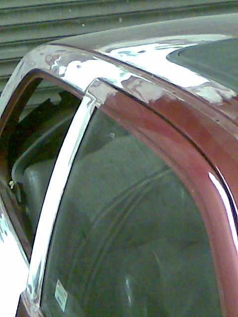

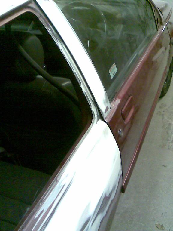

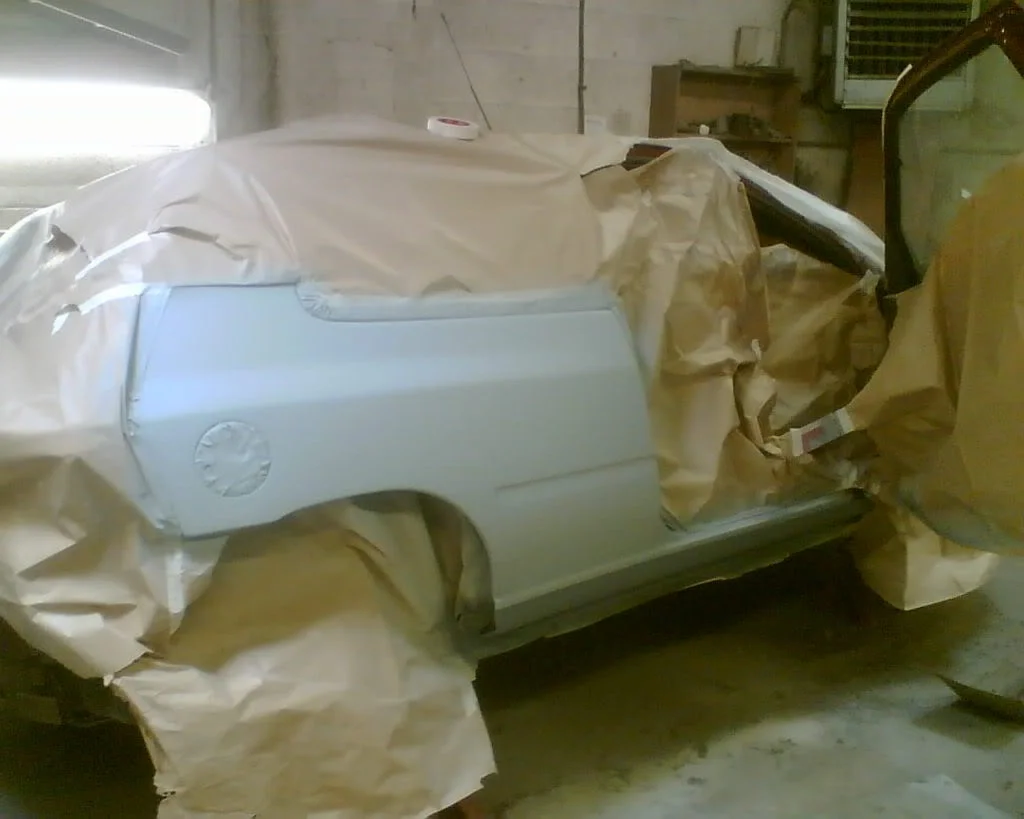

Then we come to the end of May & in she goes for the full respray

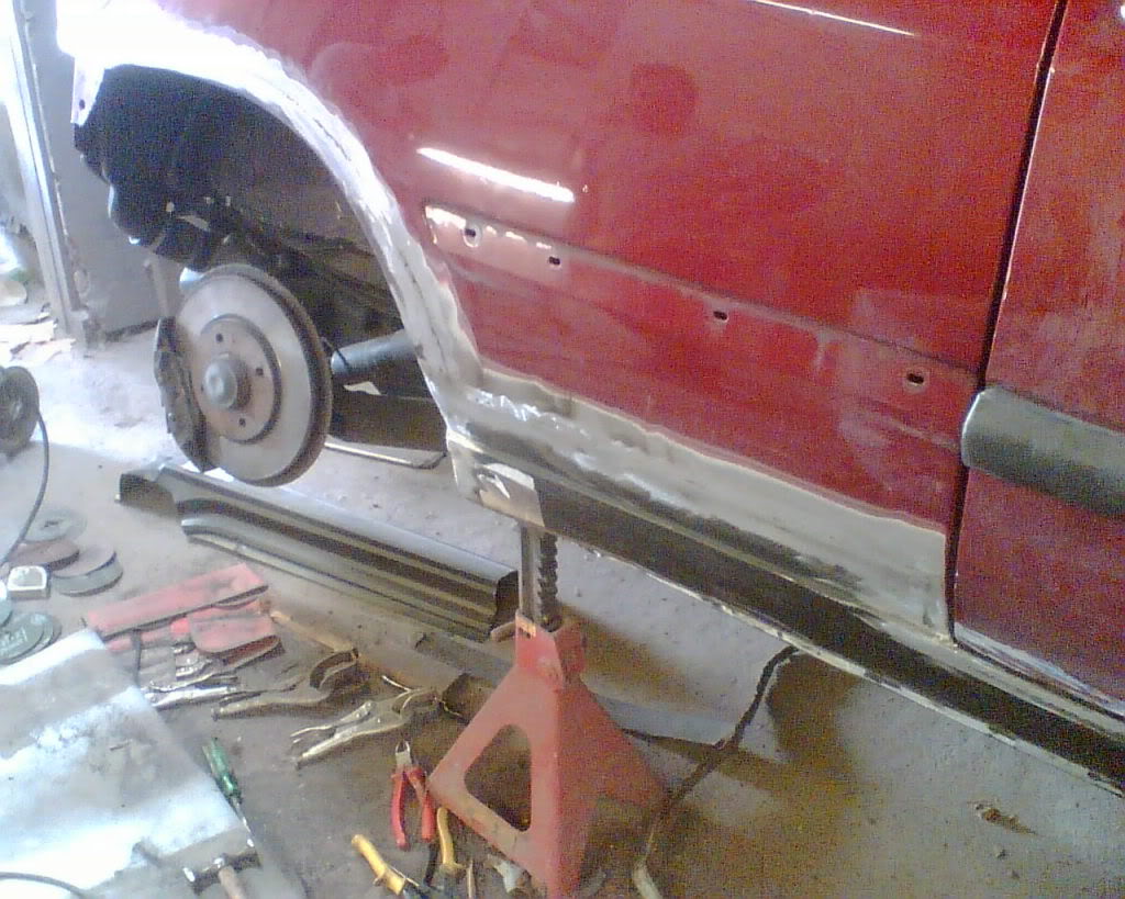

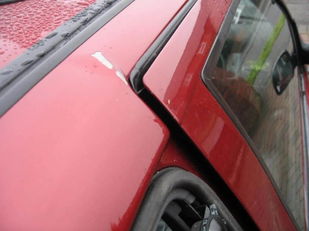

Old damaged sill & rusty arch cut out & new metal welded in

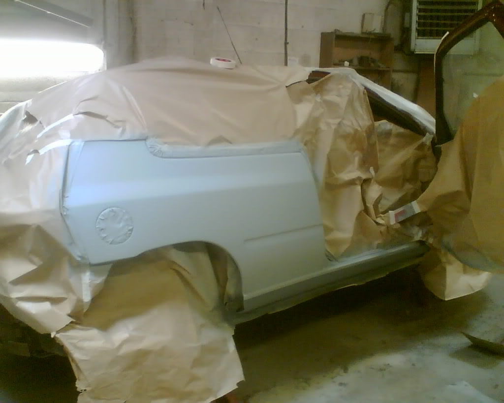

The battered N/S rear quarter chopped away & replaced with new metal
And she's coming together

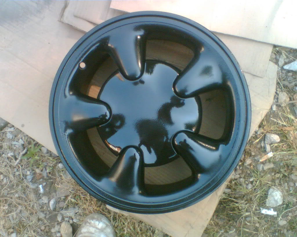

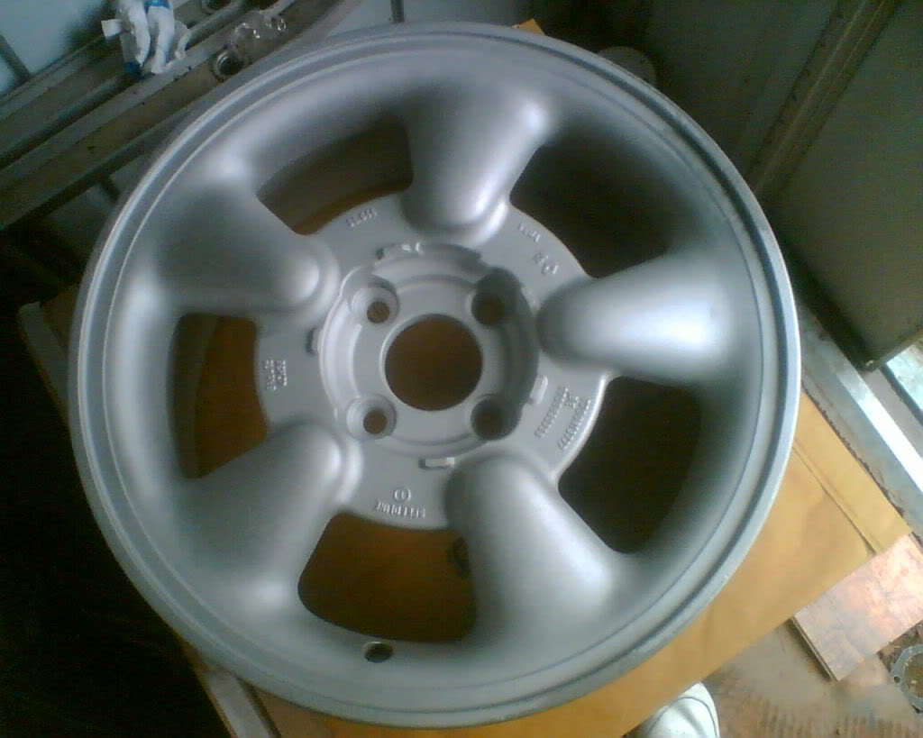

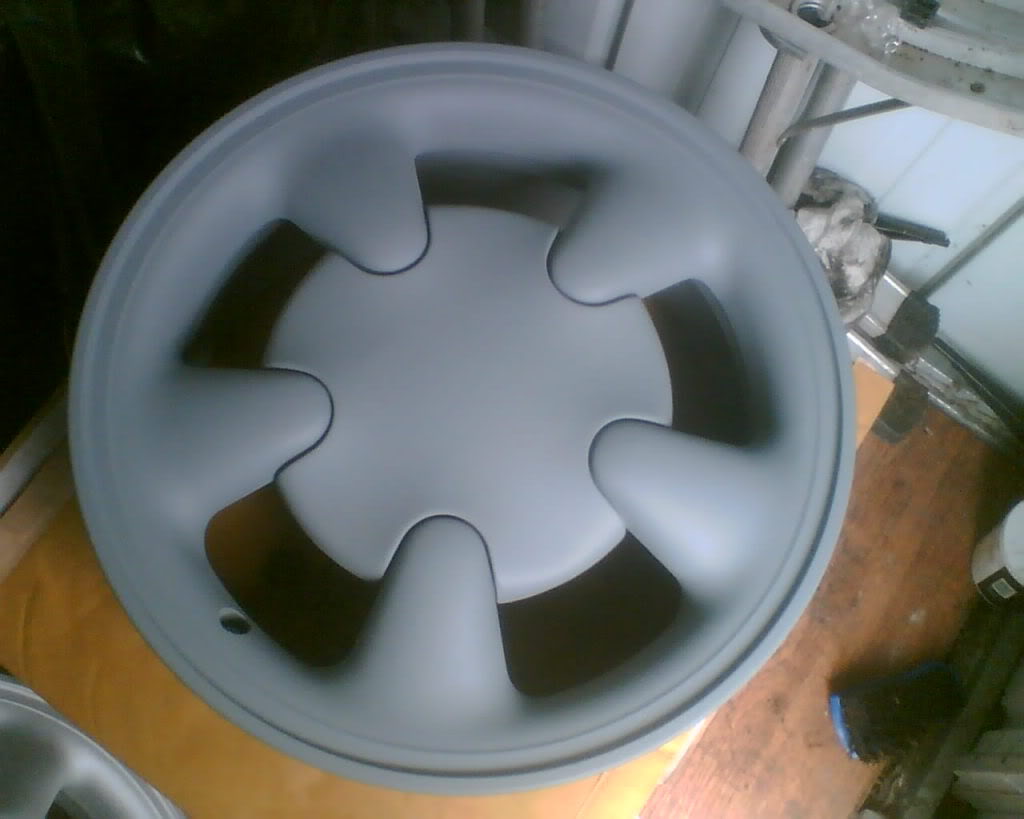

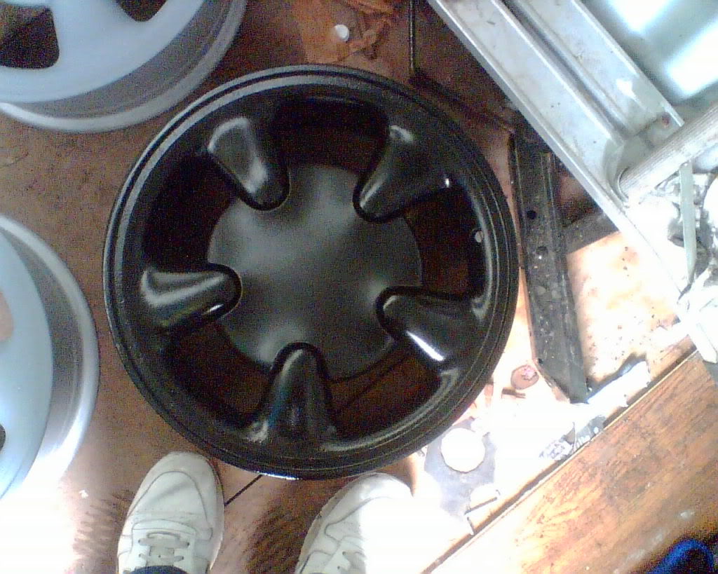

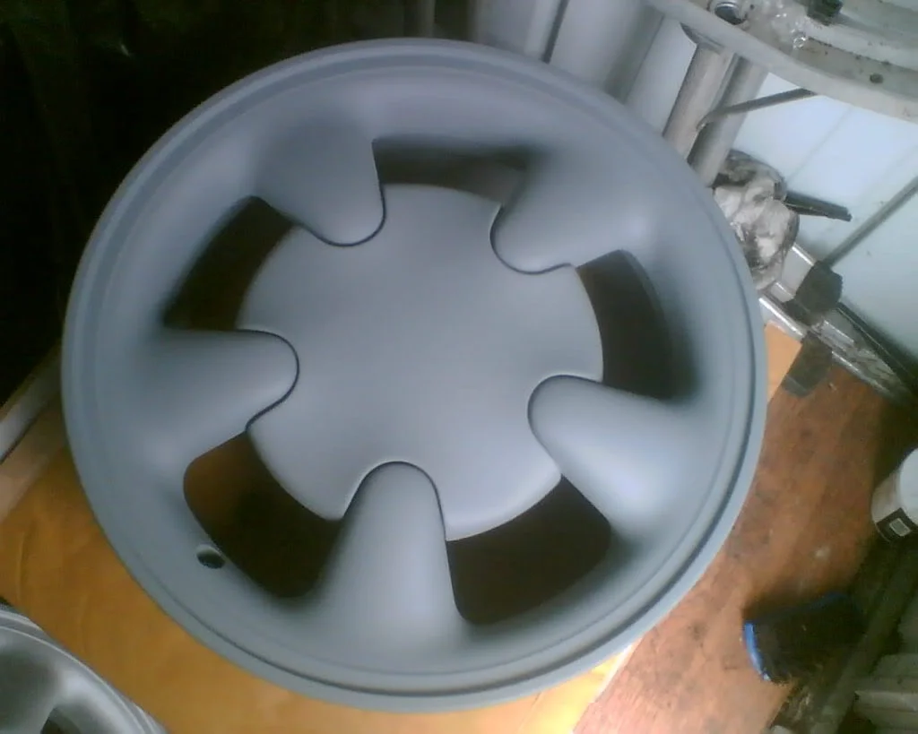

Here's some of the wheel that I refurbed myself while the car was being done
Then they were wrapped in fresh Yokohama Parada spec2 tyres

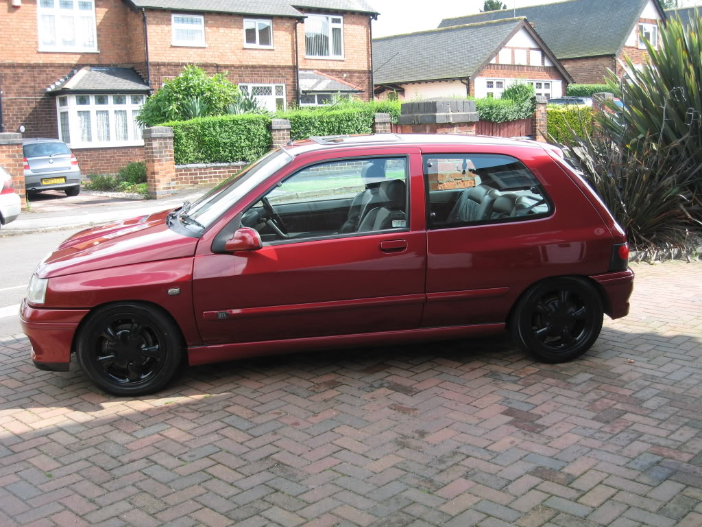

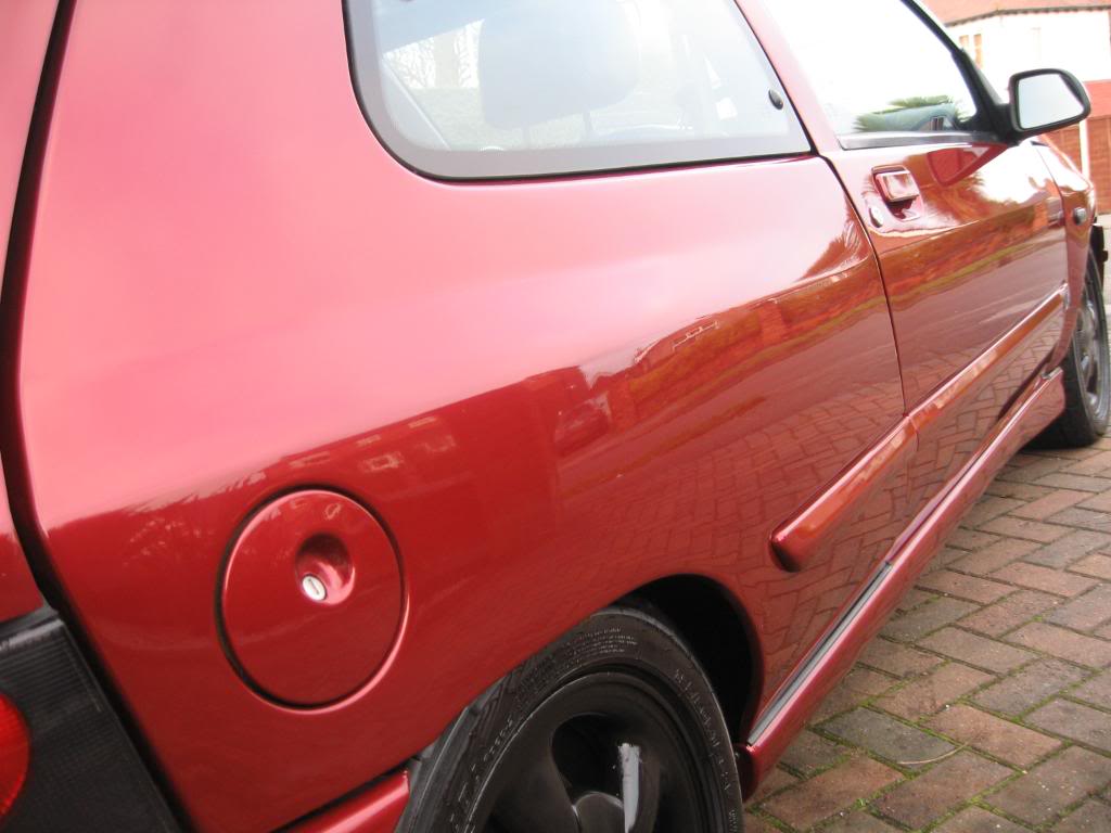

Then came the glorious day, Saturday 23rd August 2008, my car was ready & I picked her up :heart:

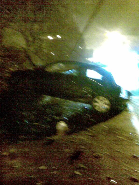

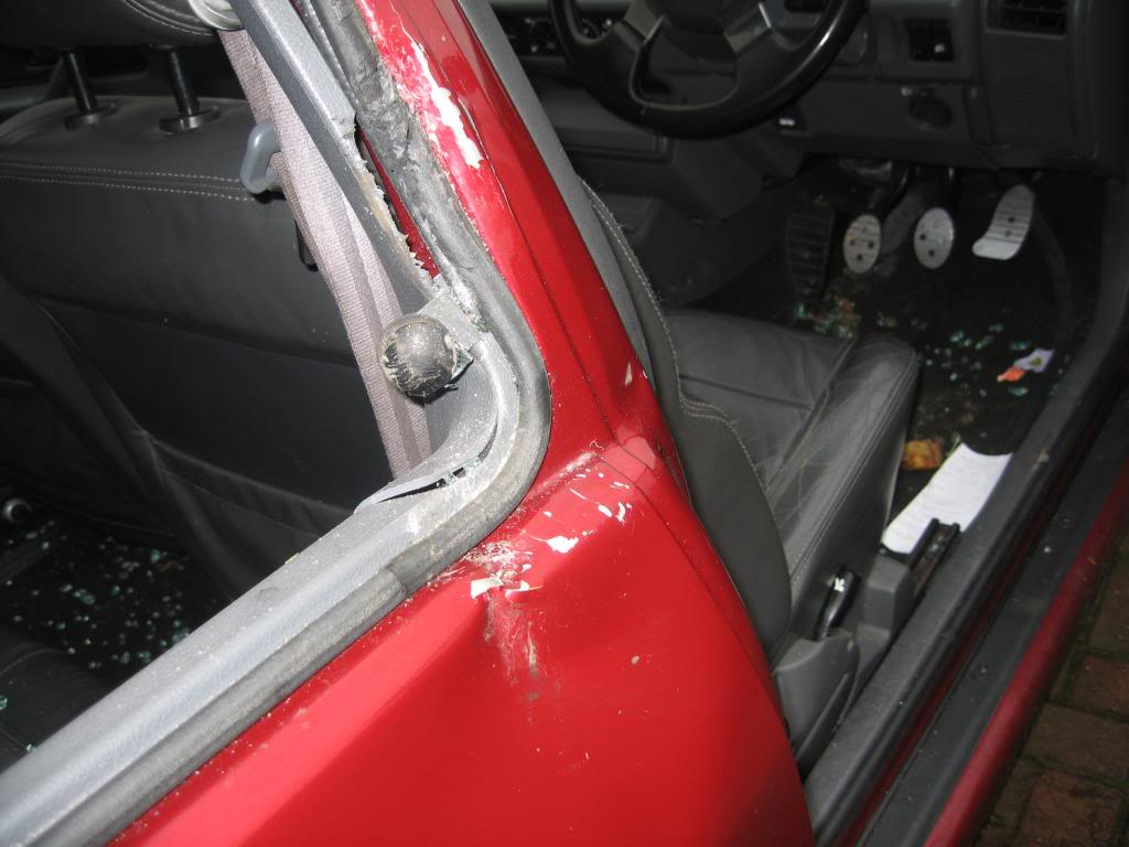

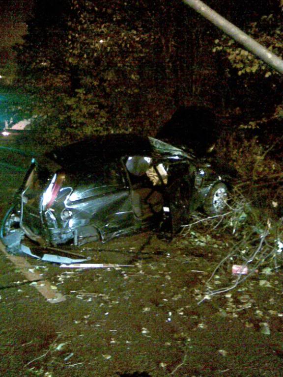

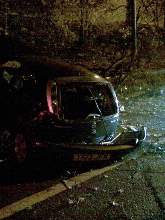

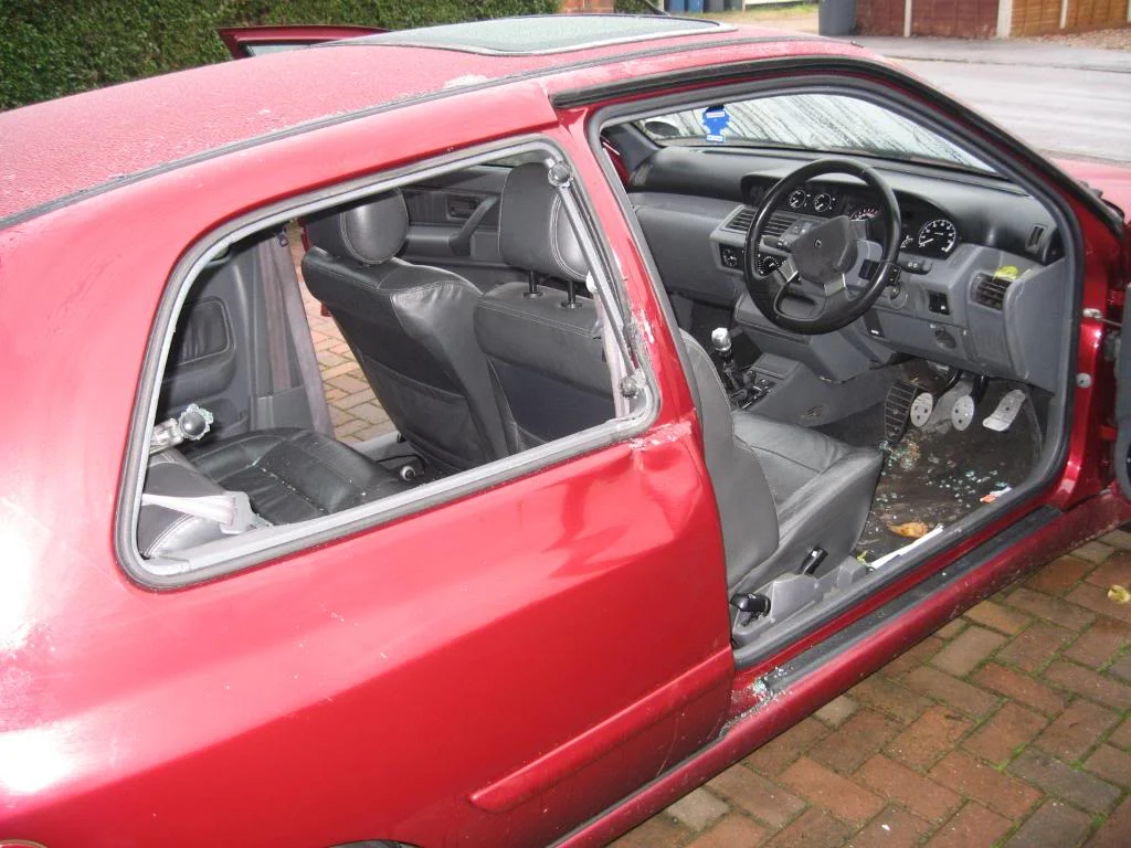

Just over 2 months since getting the car minty mint & exactly how I wanted it, disaster strikes. I got hit by this corsa that hit a kerb, flipped over a crash barrier off a dual carriageway & down 30 odd feet onto the downhill sliproad that I was on :affraid:
It's not very clear but the dual carriageway he came off is at the top of the picture moving towards the middle
He walked away from this with cuts & bruises :shock:

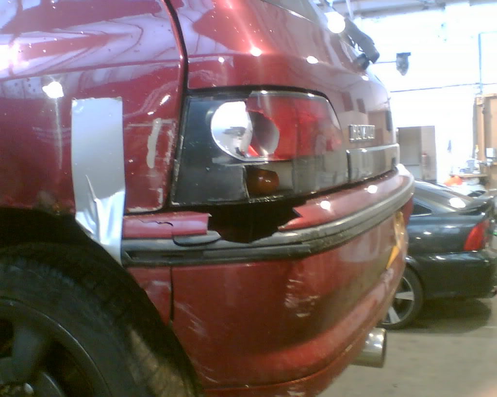

The damage done to my baby :cry:

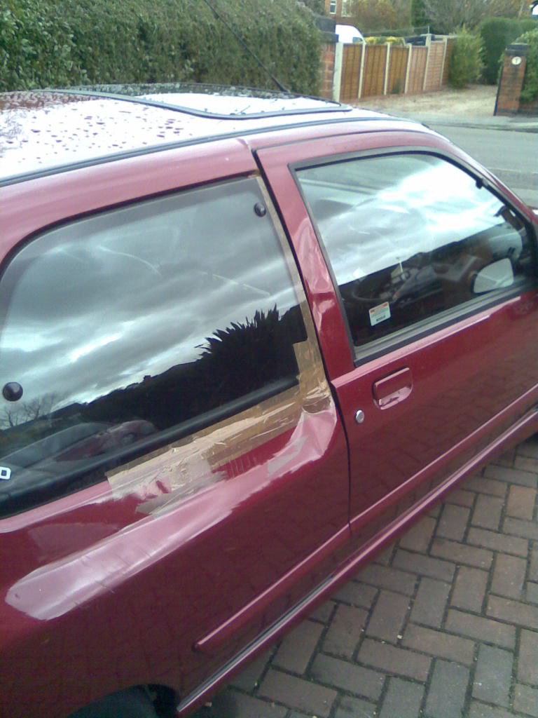

What happened was the rear axle of the corsa was ripped off & hit me in the back of the head via the B-Pillar which the impact also creased the roof

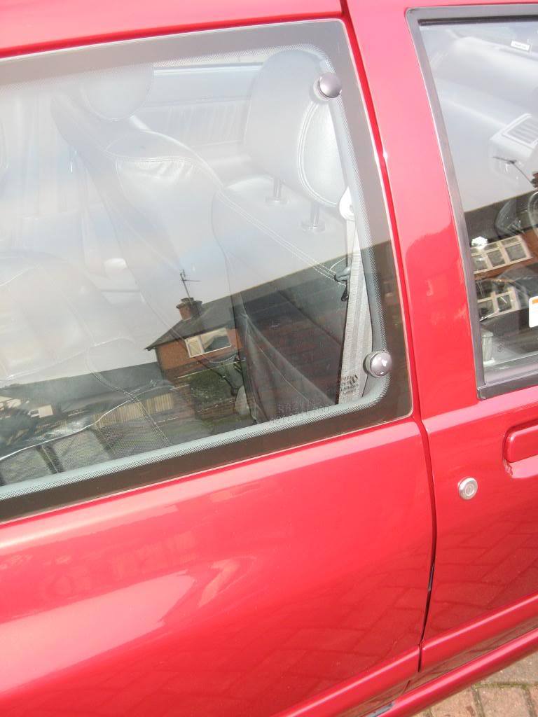

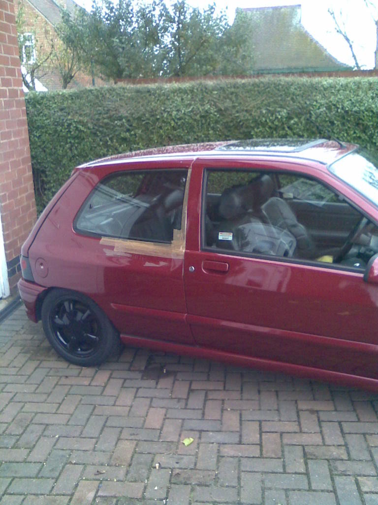

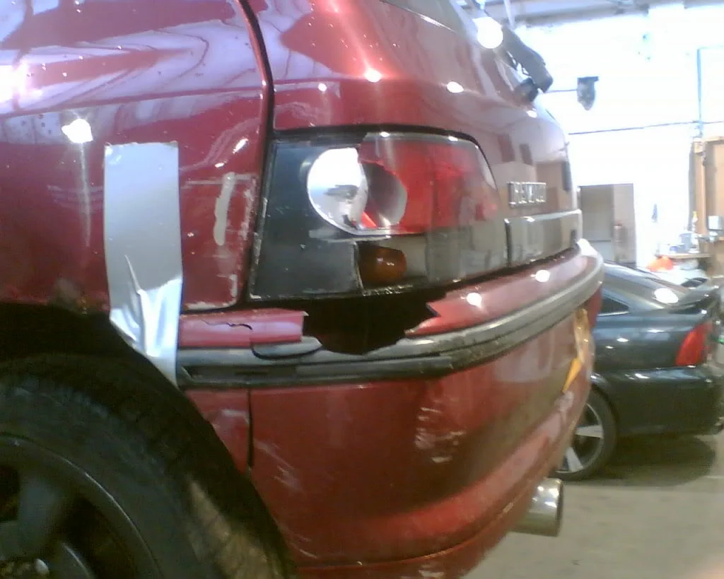

Patched up with spare window & parcel tape

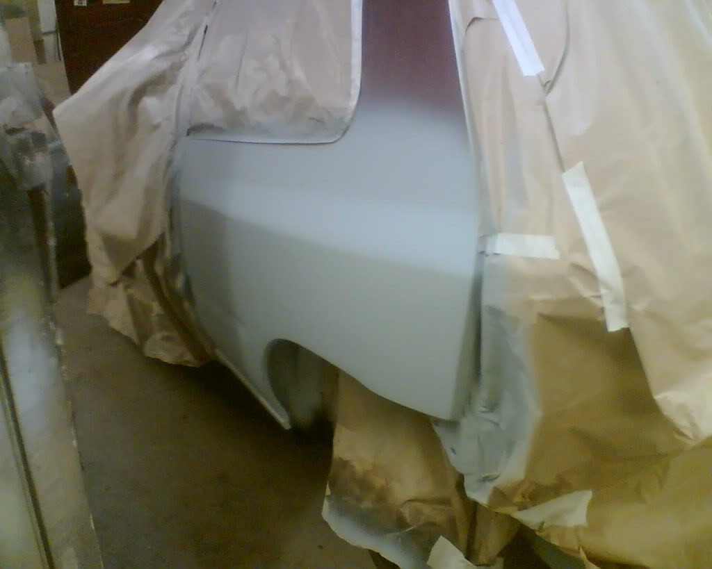

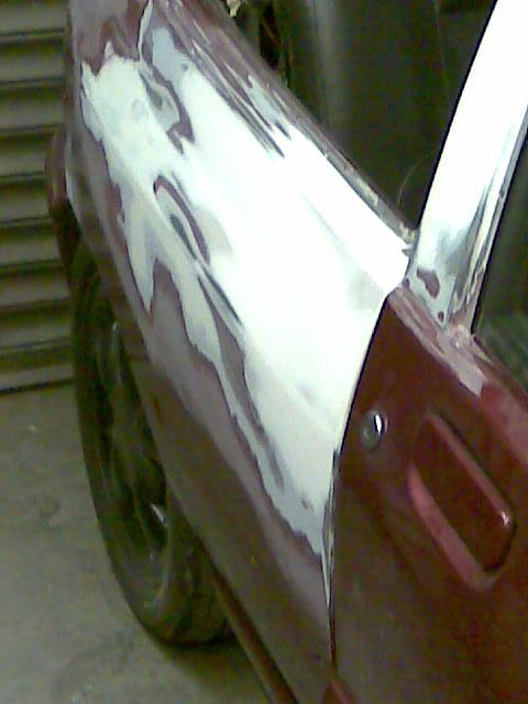

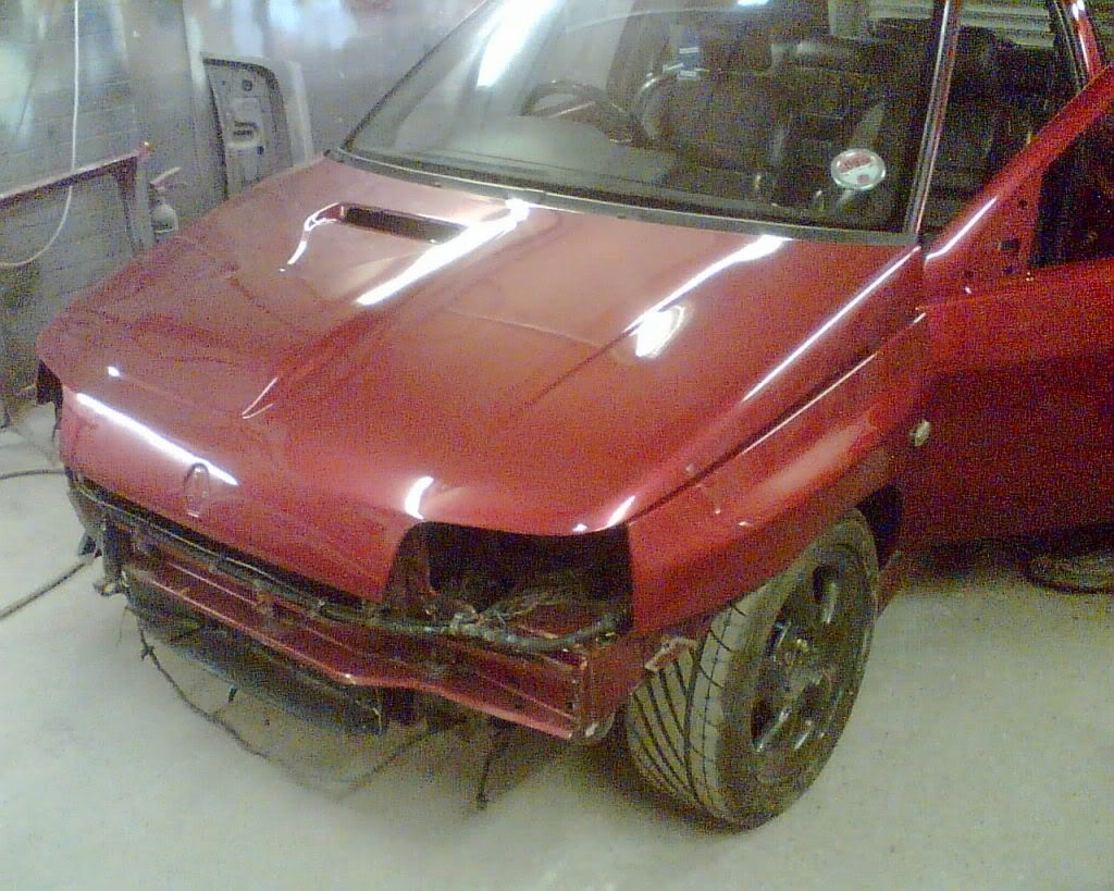

So back she goes to the bodyshop who sorted her 1st time round
And got her back on Christmas Eve :D

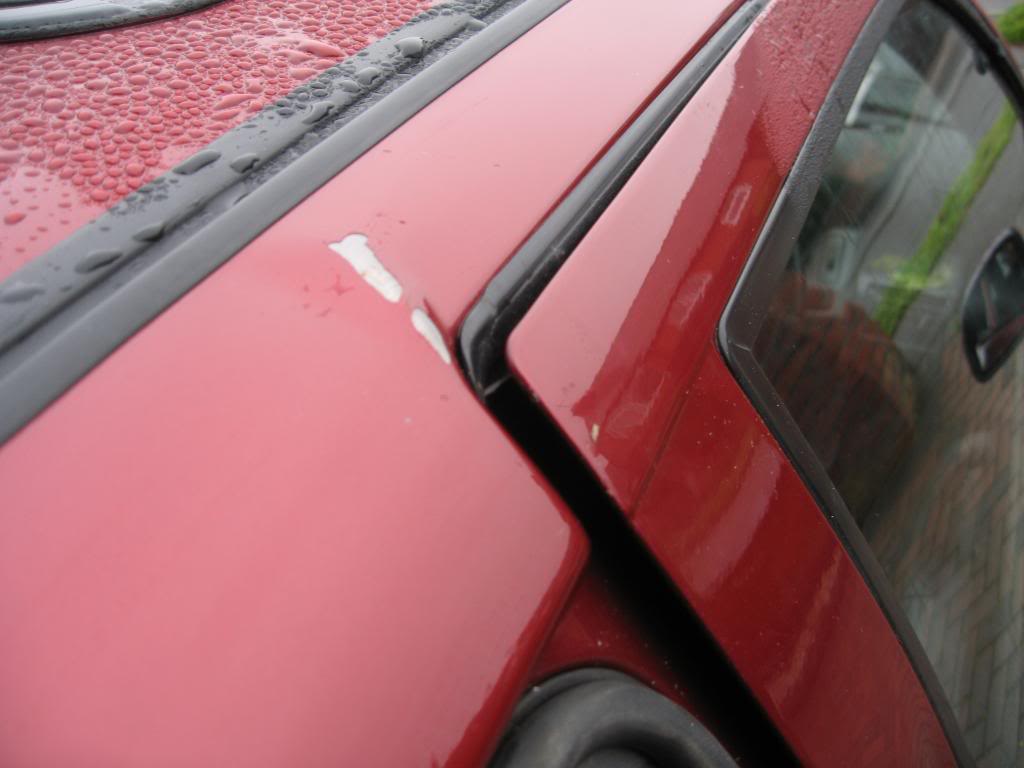

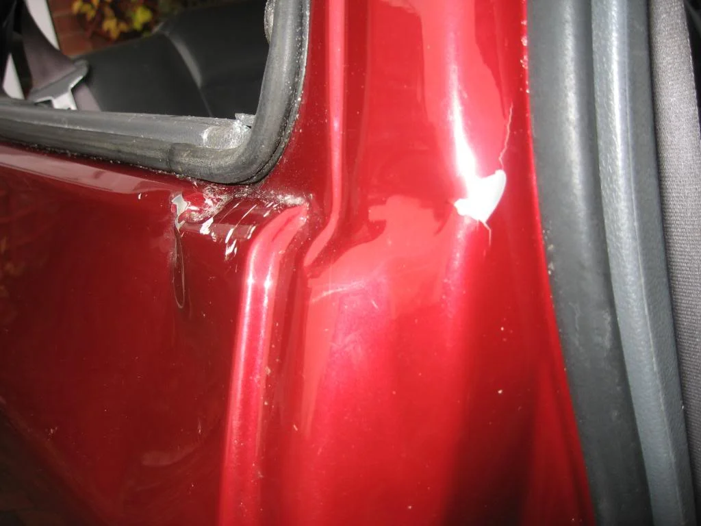

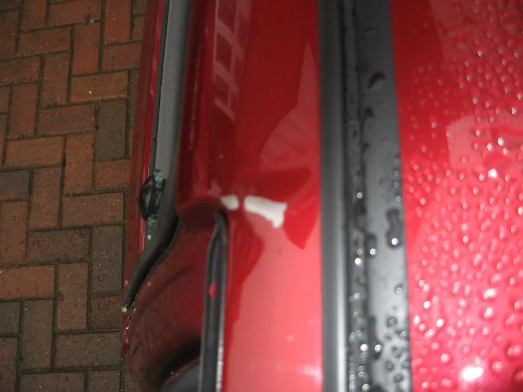

Some before & after pics of the damage & repair
The best Christmas present I ever got that year :D

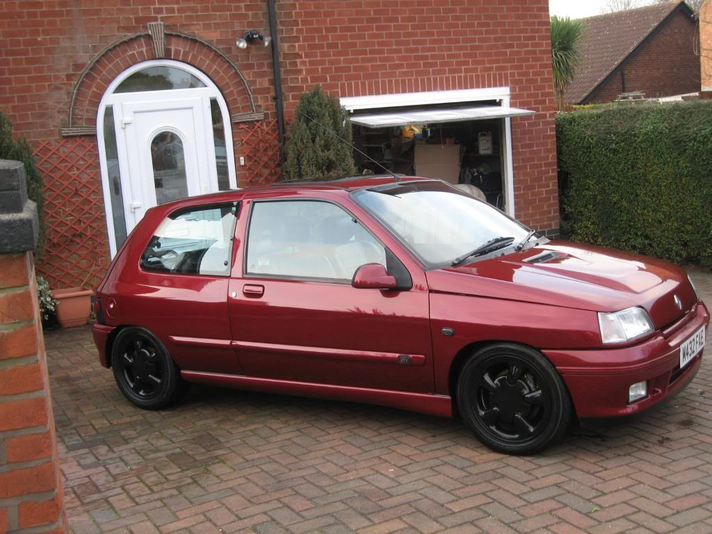

Here's a few pics from February of that year, on my driveway before the 1st problem of the year happened
Clutch cable failure :evil: after trying & failing to fix it I took it to the garage I used :oops: turns out it was that my clutch had died, so out she came for new clutch & I had the cam belt done while it was out

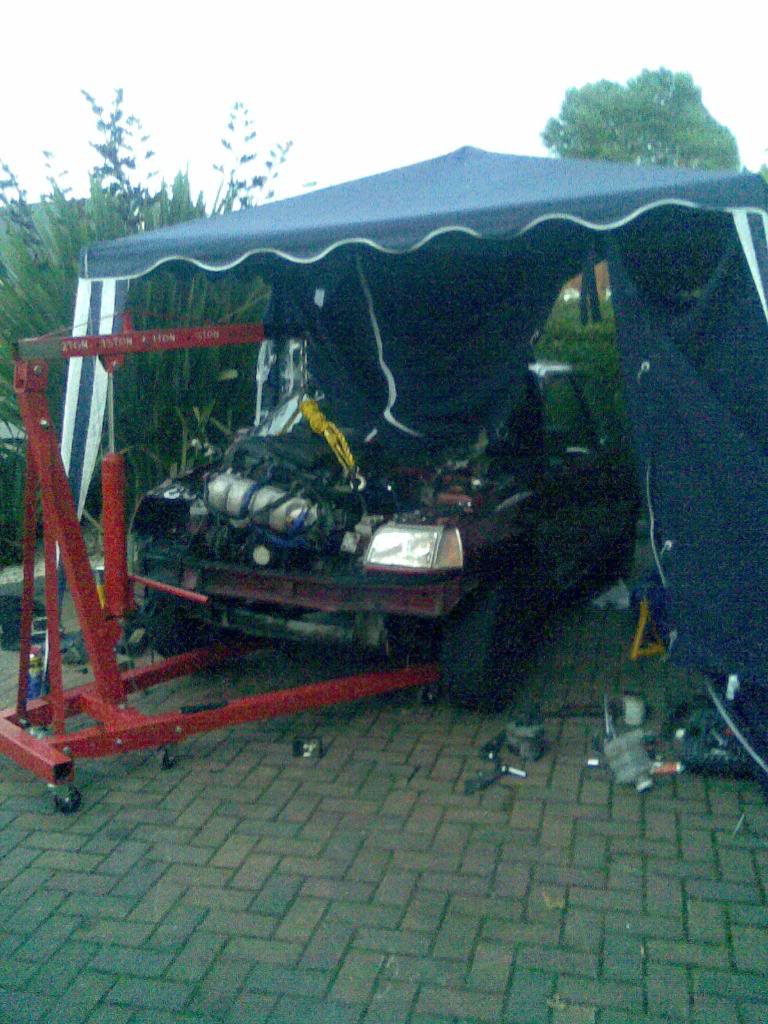

Got myself a good nights kip, decent breakfast - 4 weetabix :twisted: and got cracking with removing the engine

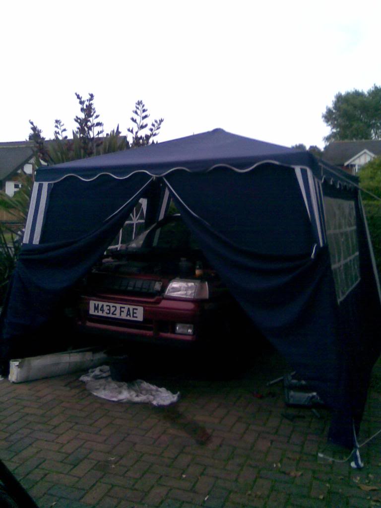

same scene just that the gazebo wasn't up as the weather was good :D

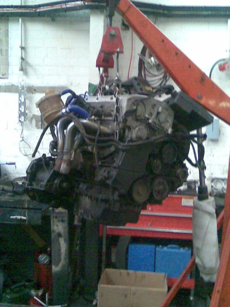

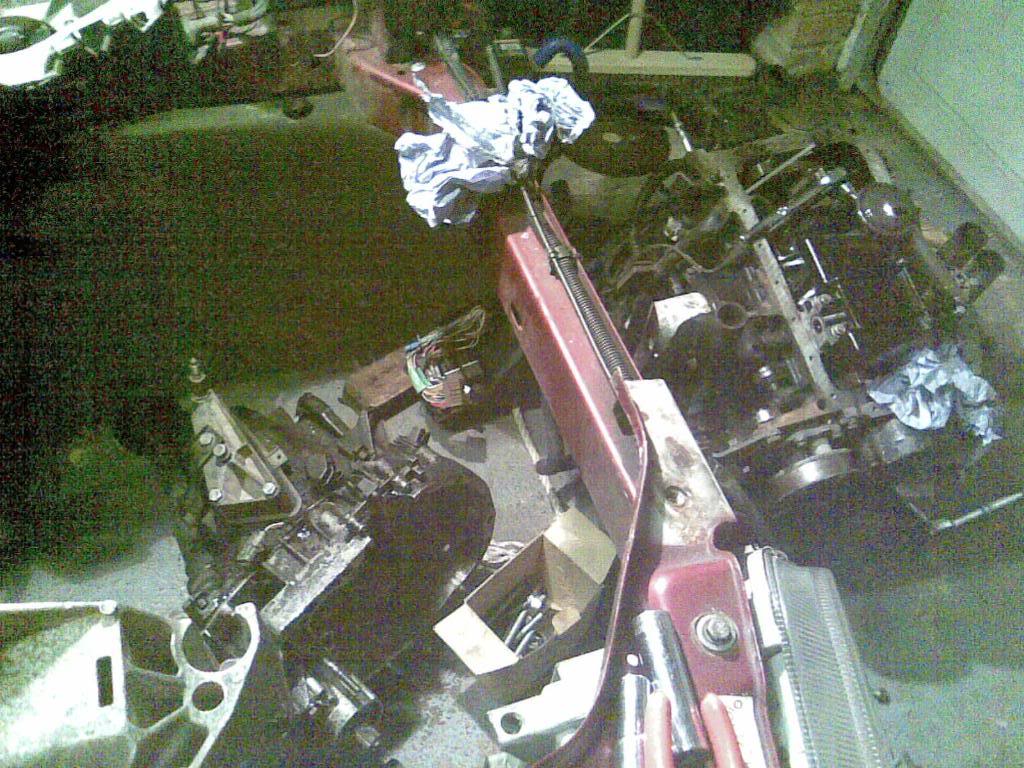

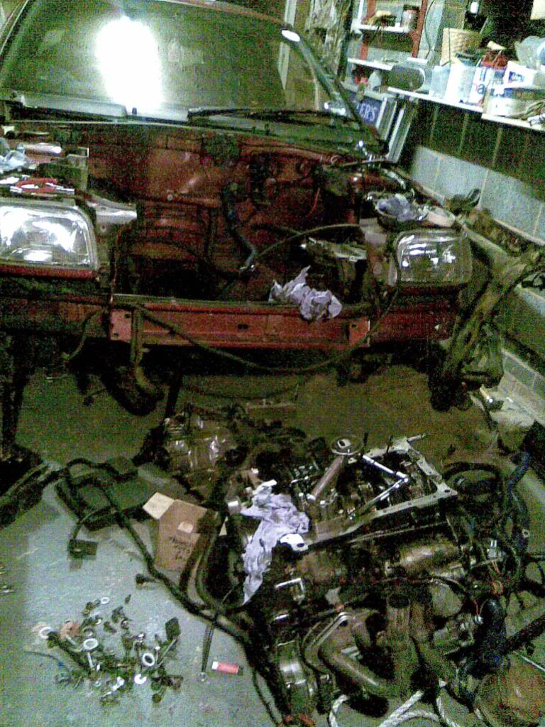

Managed to get the engine out in just over 3 hours (had a tea break) which I was well impressed with :D only 1 snag, I forgot to disconnect the speedo cable & completely f****ed it :oops: nevermind.
Got the box off along with the clutch, tidied up & waited for my other housemate to come home from work to take me back to GSF to get the right clutch.
Got to the shop & compared the clutch I removed to the new 1 they ordered in and they were completely different. The 1st clutch they gave me had a thicker friction plate and pressure plate, they reckon someone put that particular clutch in the wrong box.
So went home, put the glad rags back on & got on with putting it all back together. While I was at it I decided that the wiring loom looked a right mess so stripped all the old manky tape & plastic off and wrapped it up nice & neat with some fresh new electrical tape. Got it all ready to go back in & called it a night to go get pissed with my housemates.

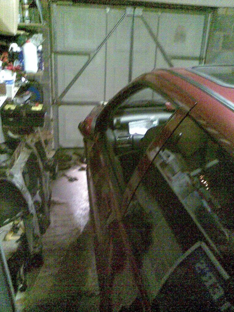

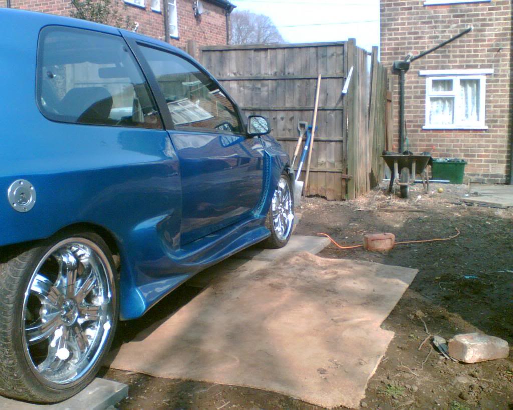

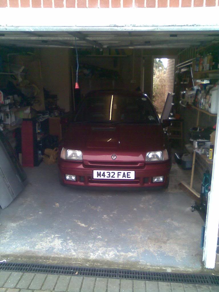

So next week the engine has to come out to be fixed :roll: Unfortunately I now have no protection from darkness & crap weather as I had to abandon the gazebo of love at Santa Pod :( So I got busy with a tape measure in a haphazard sort of way, to see if I could get my car into the garage and have room to work on it.

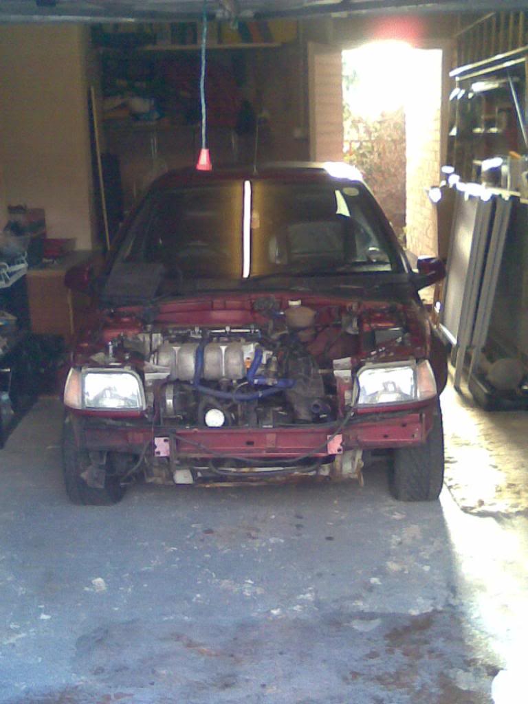

From the measurements it seemed possible so I set about clearing the garage of all the crap the me & my housemates dumped in there over the past year
This little lot was from NYE & taking it to the bottle bank was fun as it filled the front & back of my car from the floor to the roof
I would have pissed myself if I got stopped by the Po Po as the car fcukin stinks of beer :rasp:
Anyway, garage was cleared of all the crap and here's the result
:D
It does fit and although there's not much, there's enough room to get around & be able to work on it so the real fun begins on Thursday 4th March

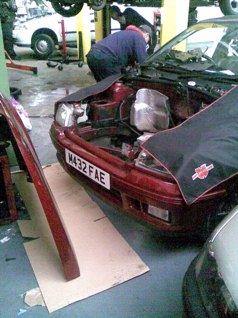

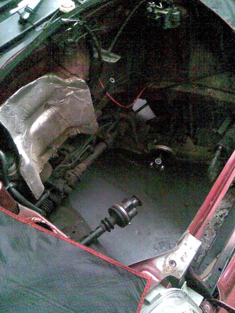

Just a quick post to show what I got up to last week, made a start on the thursday afternoon

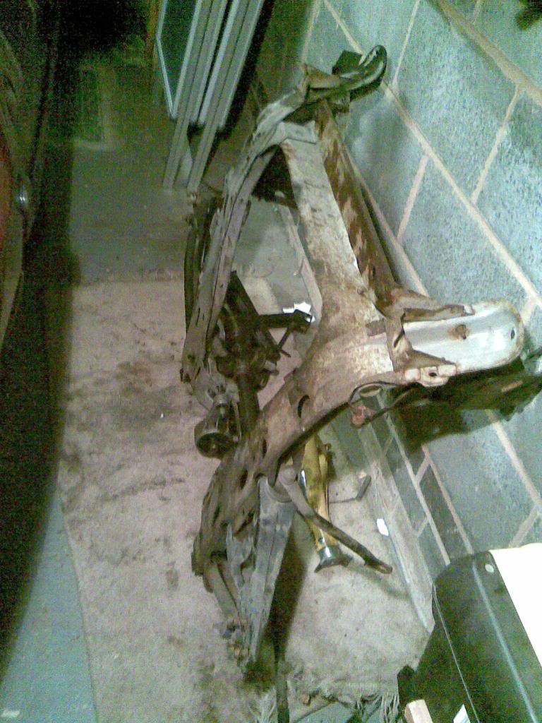

Subframe off to sort the bits on it later

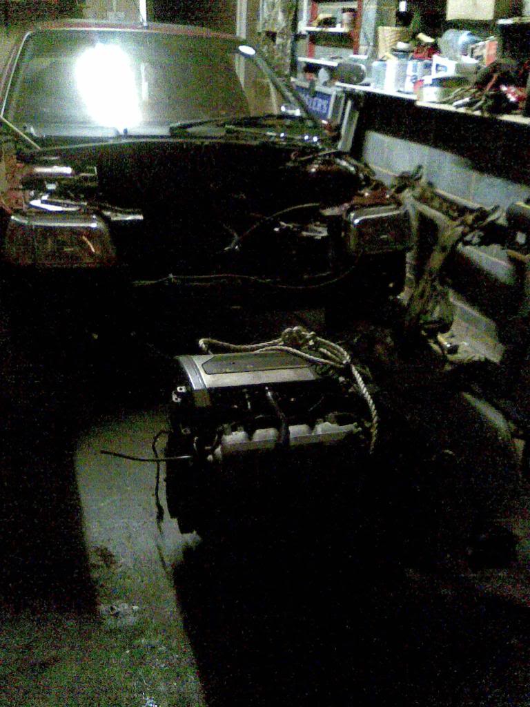

Engine out.....................again :rolleyes:
And how she was sat on thursday night

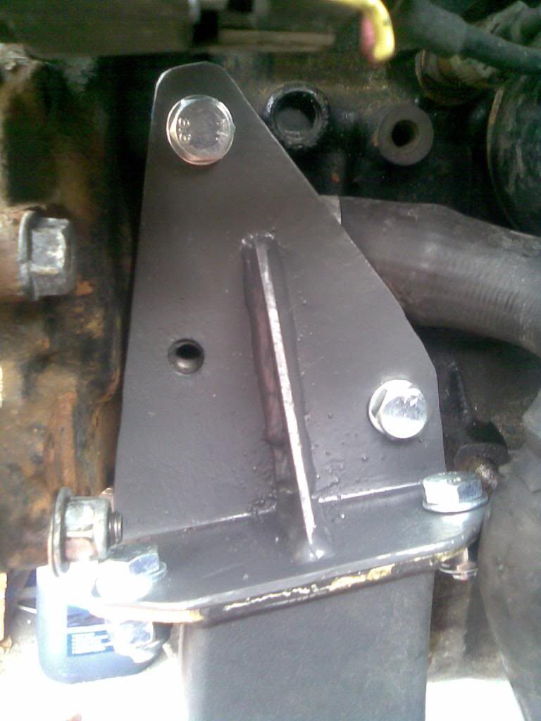

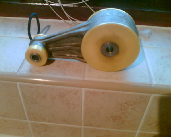

Fitted a lovely 5th engine mount, supplied by f0xy :cool:
Had to slightly modify that hole with a file but it fits spot on & it's all good :D Made an amazing difference to how the car drives, the engine is properly rock solid, the only downside is that it exposes french car interior build quality :rasp: but who really cares about that?
So the horrible leak is fixed and she's getting some new tyres and the tracking done next week :D

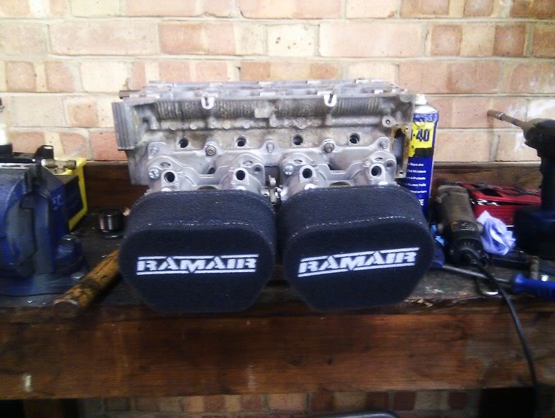

Now since all those fun & games, I added a few more goodies in preparation for my 1st ever track day at Castle Combe :cool:
I fitted some bucket seats, 3 point harnesses, 13 row oil cooler & some used R888's

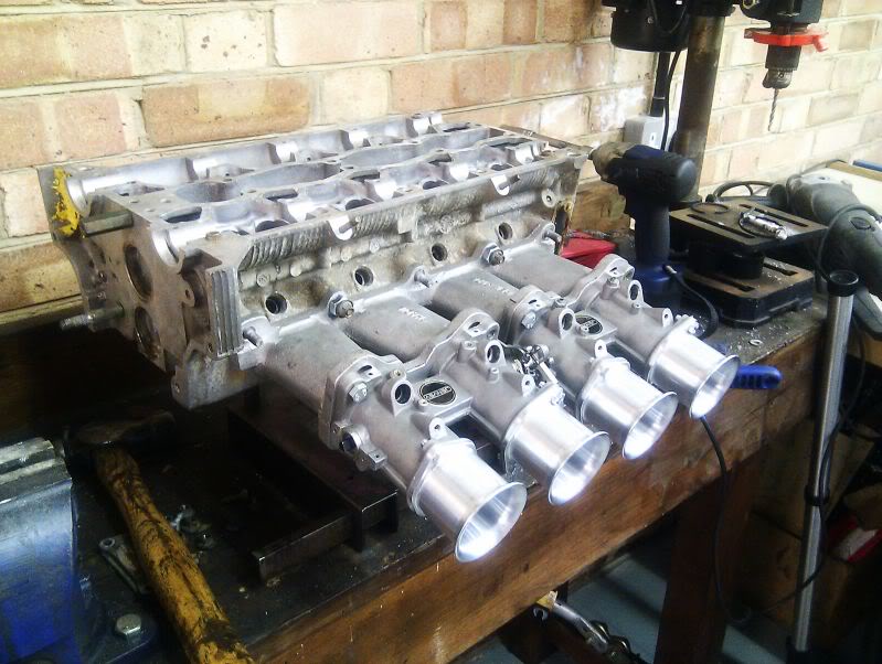

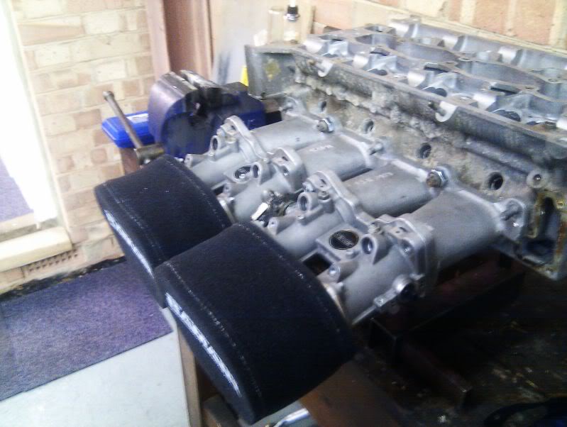

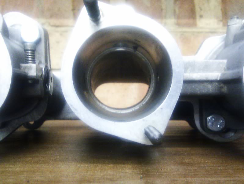

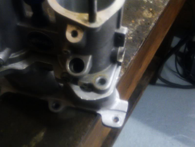

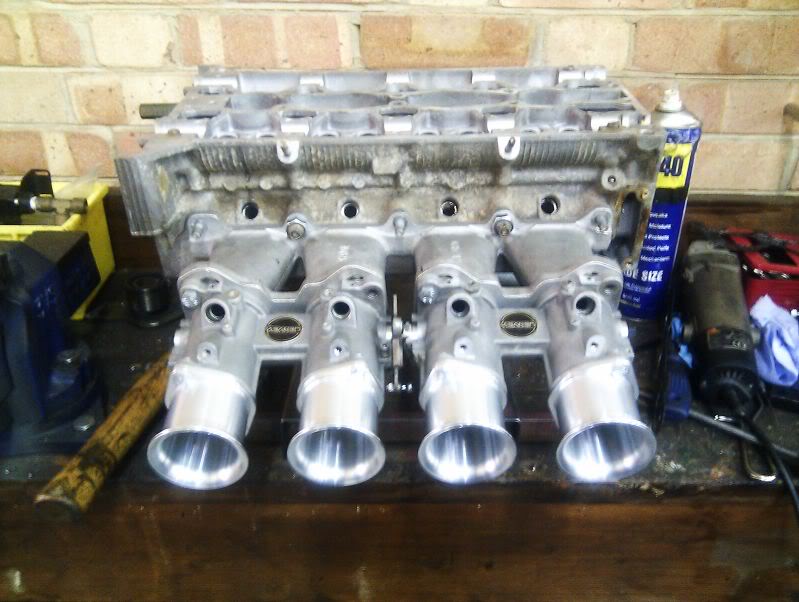

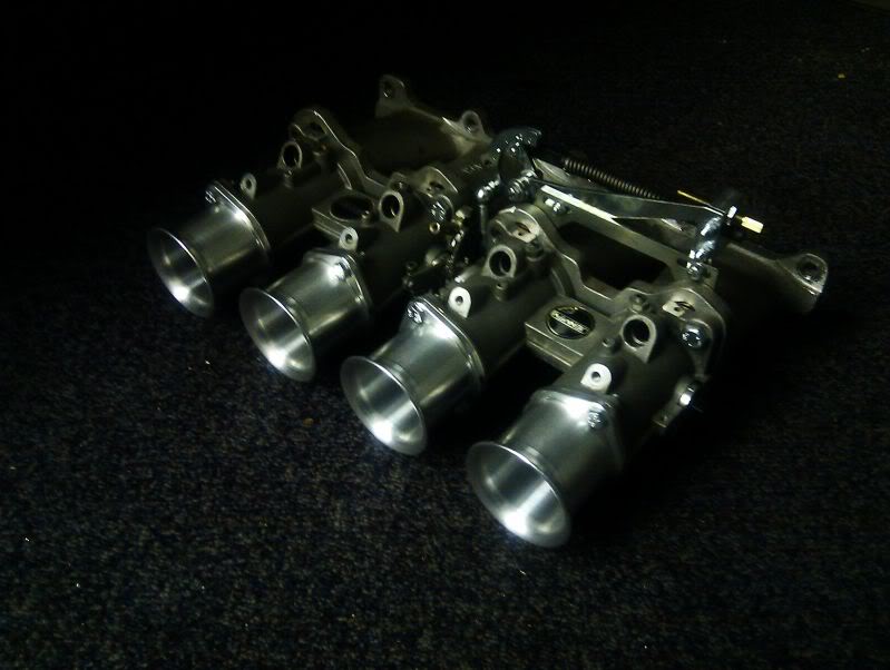

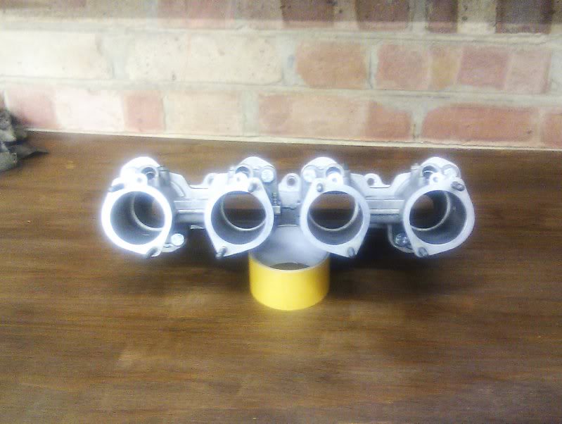

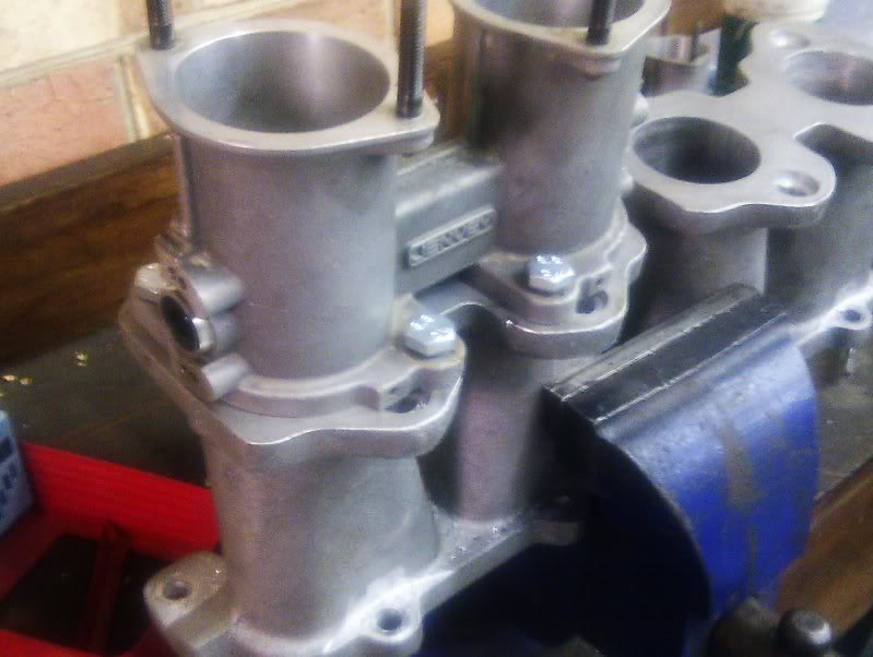

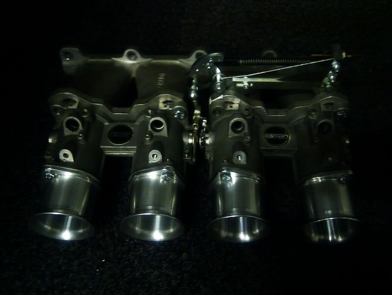

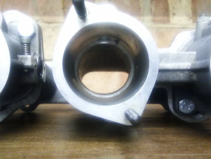

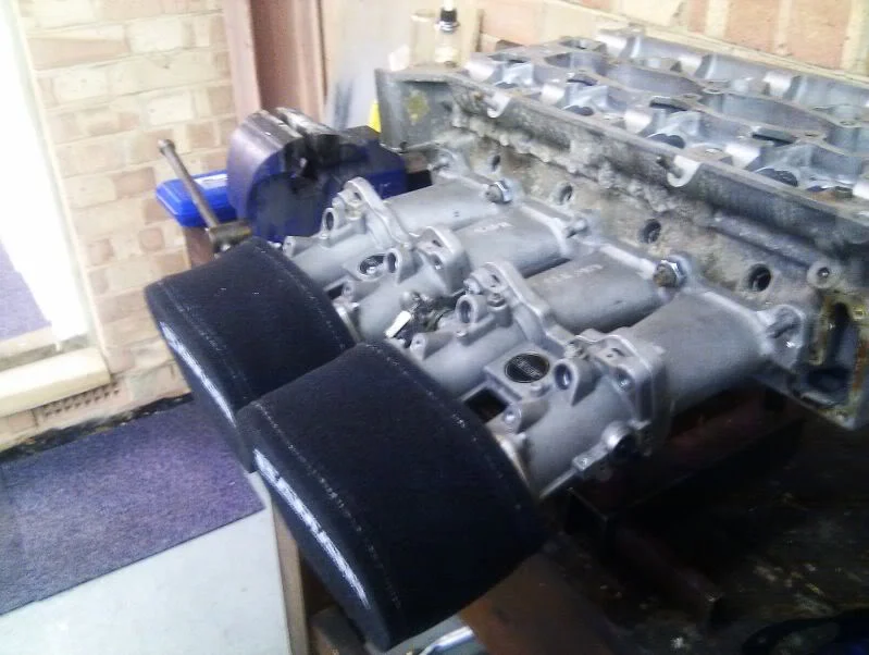

Now the latest with the car, thanks to the help of the legendary sideways danny from here http://www.519automotive.co.uk/ (and the traders section on here ;) ) these lovely 48mm things will be going onto the car :D
sideways danny said:

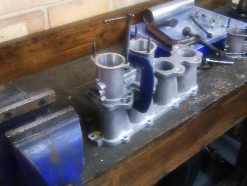

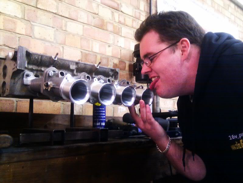

Paddy managed to source some very cheap jenvey throttle bodies recently. The first issue being they were a different mounting bolt pattern.
So yesterday I got my hands on the bits and set about a bit of re-engineering
so now we have bodies bolted on the manifold
And just need to do some matching as they're a little bigger than the manifold

They're coming together & I wanted to see what they looked like fitted to a head
I fcuking love these 2 pics :cool:
The words I'd use to describe them are OM,
NOM,
NOM
and NOM :approve:
