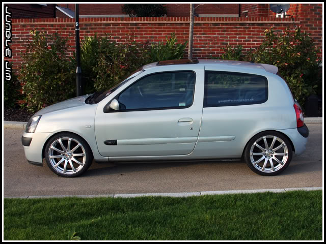

also my clio is the silver with like a blue pearl in it, is that due to the clear coat having a tint or is it just in the paint, ie if i bought colour matched paint would it look the same.

as for your paint colour as long as your colour isnt a three stage pearl (ground coat , top coat, clear coat, not nice to spray) then the pearl should be mixed in with the paint when you go to get a match on your car.
