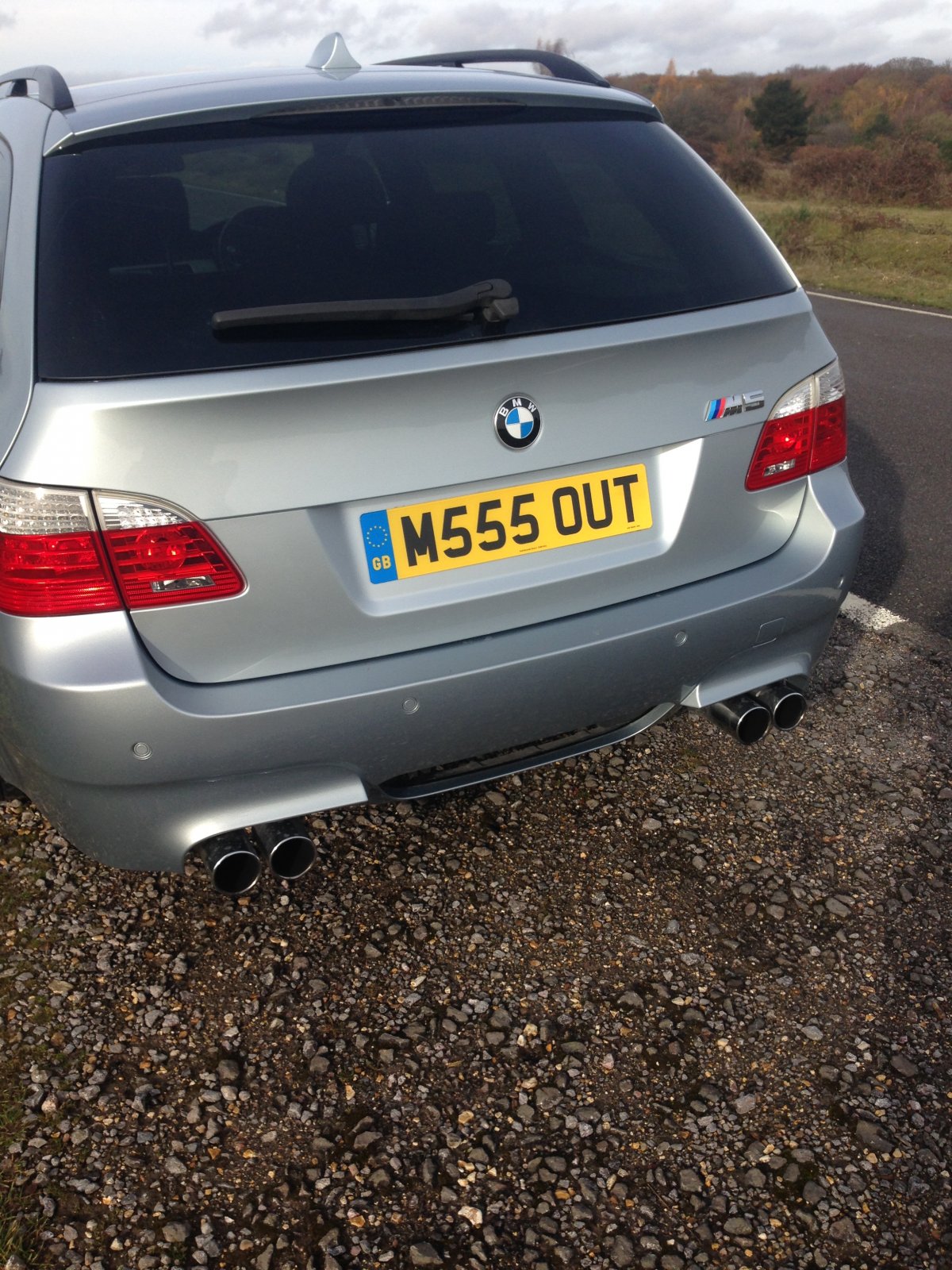

Well dropped the M5 off this morning and was given my loaner
Knock back down to earth somewhat.
Had to drive home with the heaters and radio off to make sure I didn't run out of battery lol.
I asked about prep on the front bumper, they told me they only strip the paint on the chipped areas, well that's all of it than!
I'm not worried, any issues they will be redoing it, simple really.
They need the car for three days so it can't be to bad a job.

Total work for mine after my little quibble with a bollard, and with the other work I want done is over £3,000. Hope that helps you get back into orbit with your bumper repair ;)

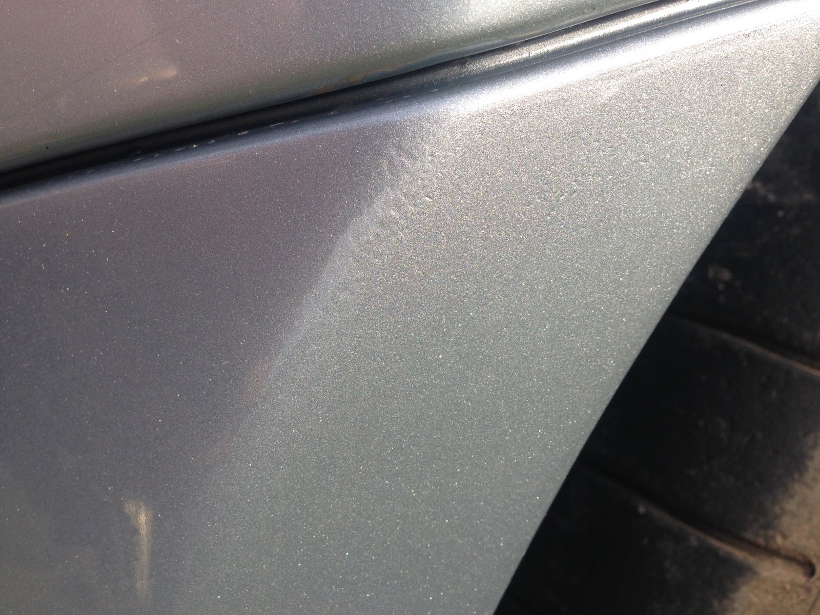

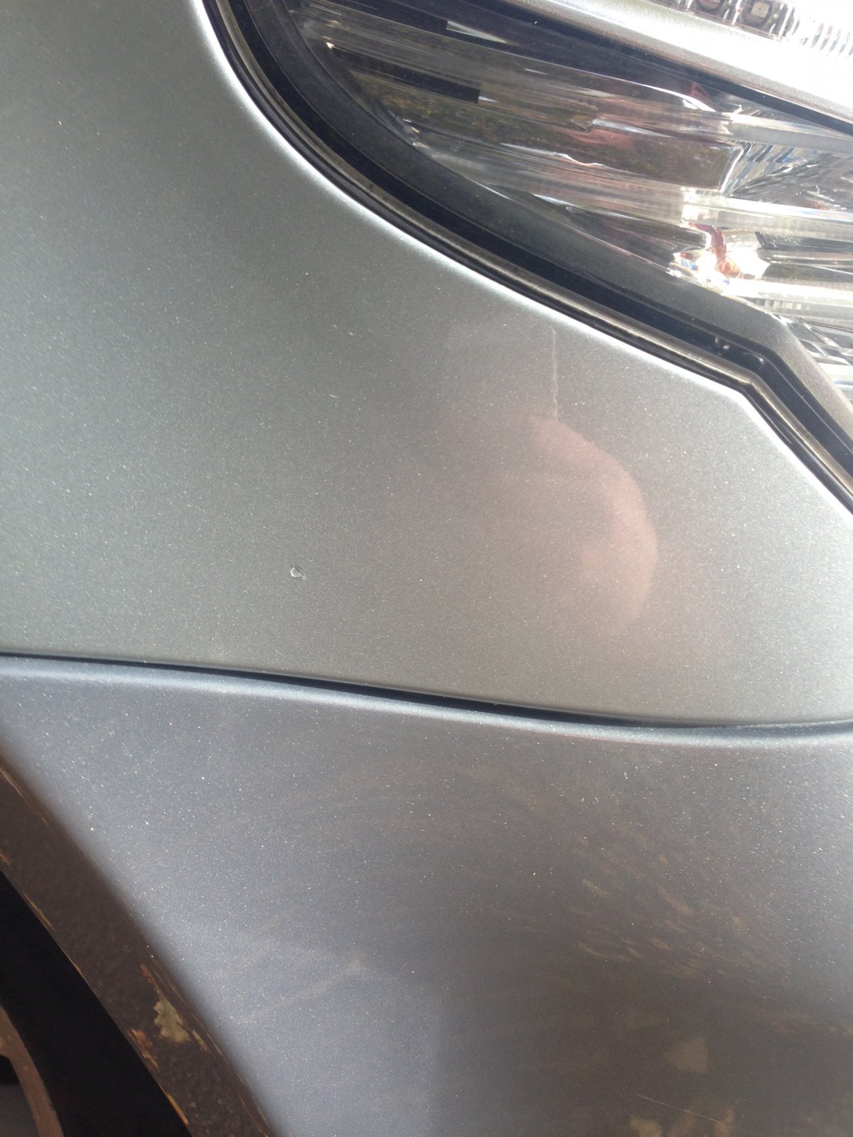

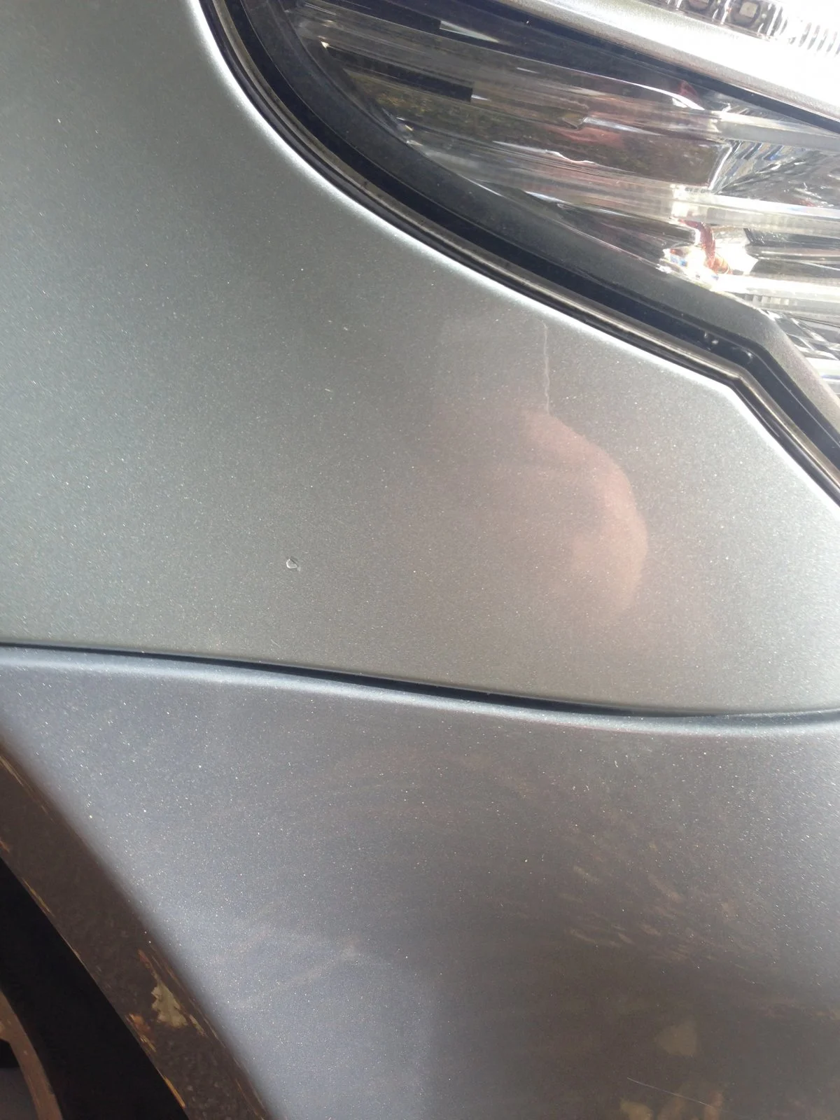

Picked up the car this morning, to say i got a tear in my eye (for the wrong reasons) is a understatement. Side of the car has bad orange peel, none of the chips where filled in before paint, various dust marks in the paint, front bumper colour is just silver not with the green tint you get from moonstone, same goes for the rear bumper, and to finish it off i have a 1 foot wide paint run on the lower corner of the rear bumper.
Yes they are re doing it all but I have little confidence.
The car had paint on the side before and it was flawless, feel like I have gone backwards....
Will post up pics I a bit :-(
Naughty Boy
Brembo! Brembo! Brembo!

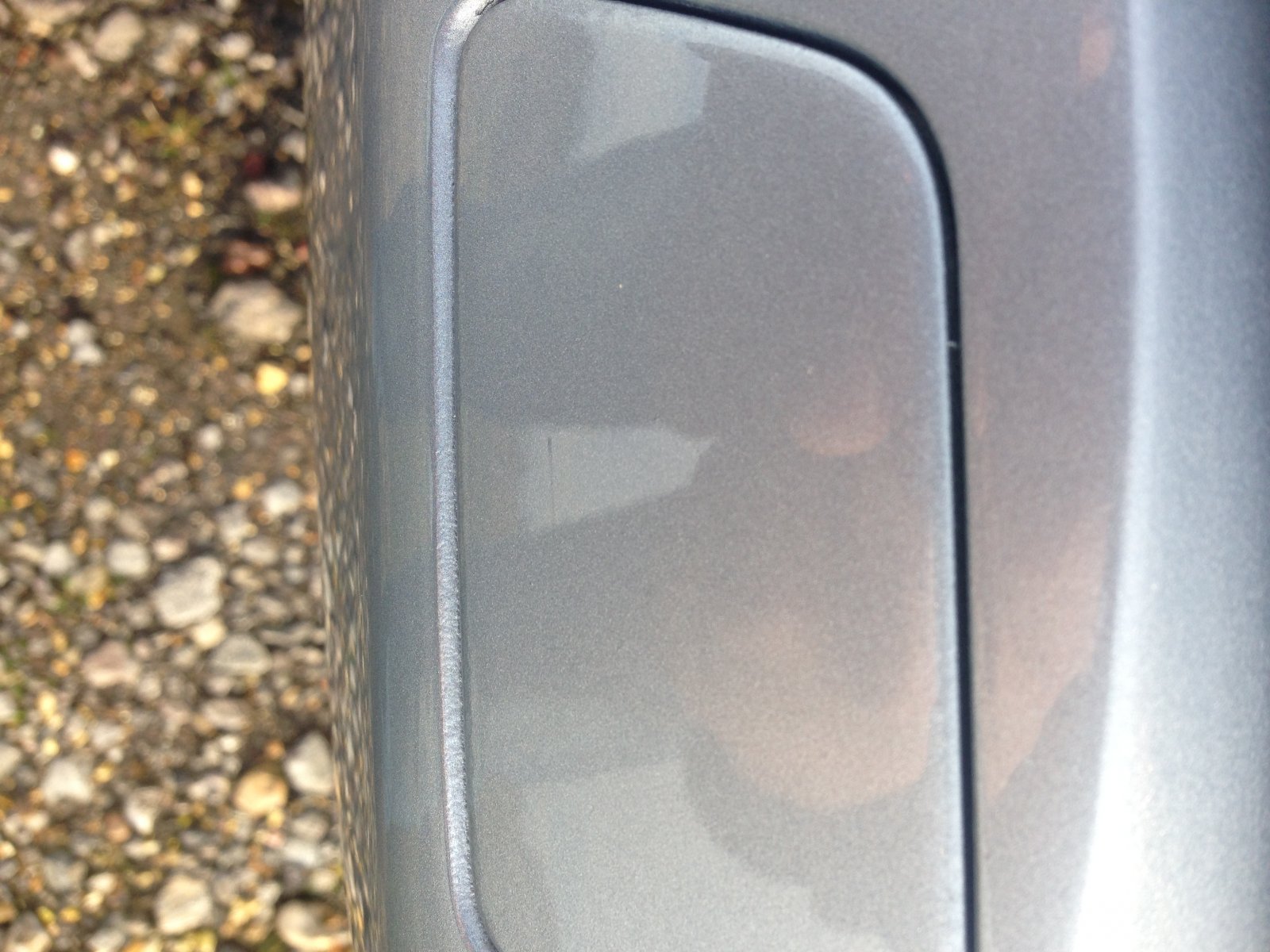

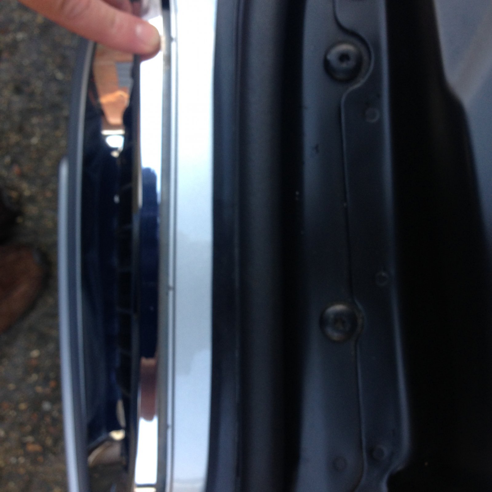

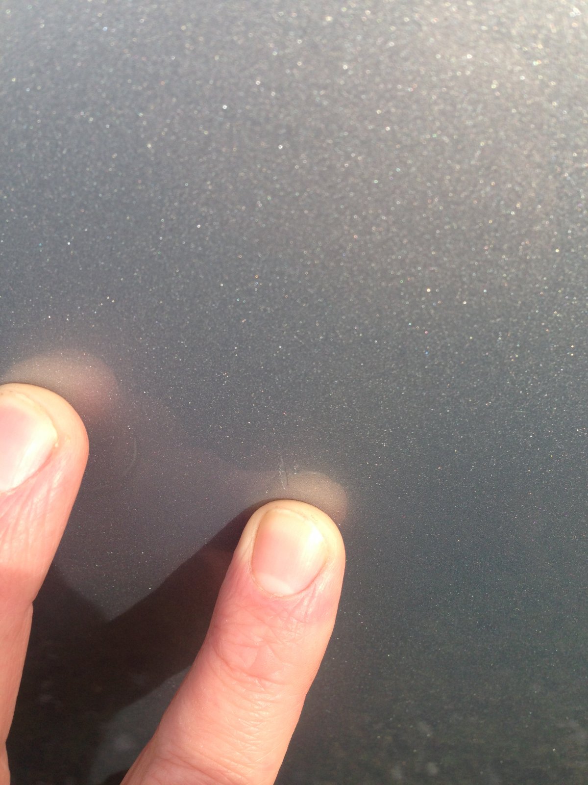

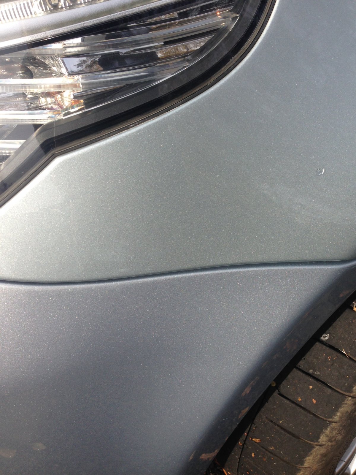

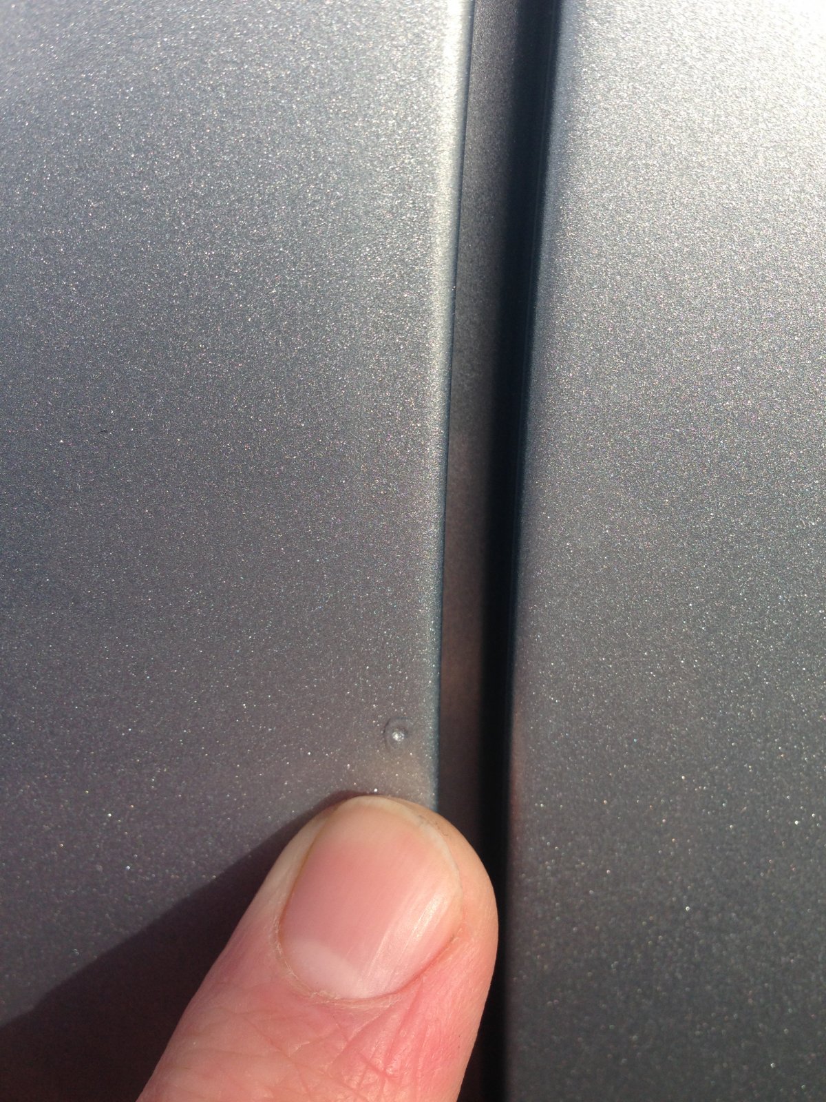

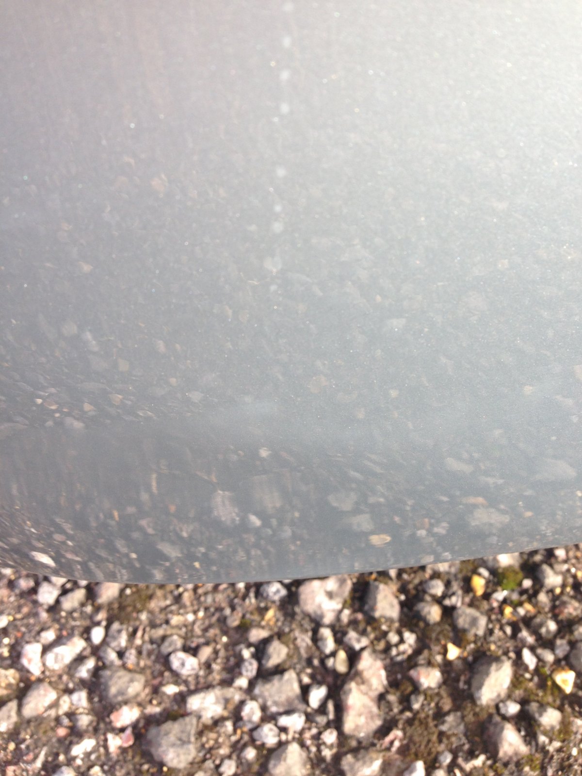

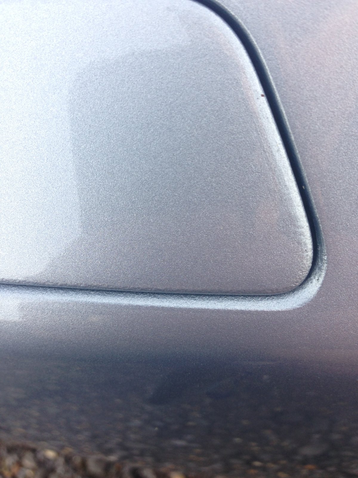

These are phone pics so not going to look like there is a issue to some, paint run is horrendous but hard to get on camera. These are just some of the issues, i loads of little chips in paint.

How the fcuk do they think that's good enough is bonkers mate.
Hope you get it sorted to your satisfaction.

That colour difference is laughable! How can they look at that and then think 'car is ready, ring the customer to collect..'

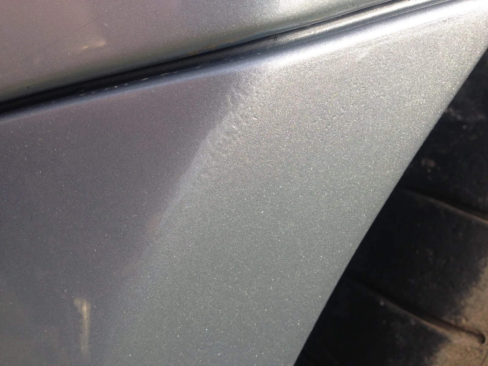

I though I had a dent in the rear 1/4 along the crease line, nope it's a large patch of what looks like paint run.... can't photograph it. Laquer is smooth but panels are covered in loads of these dimples in the paint by my finger, 50 plus, can only see them at angles. Is it dust in paint? Gally will know.

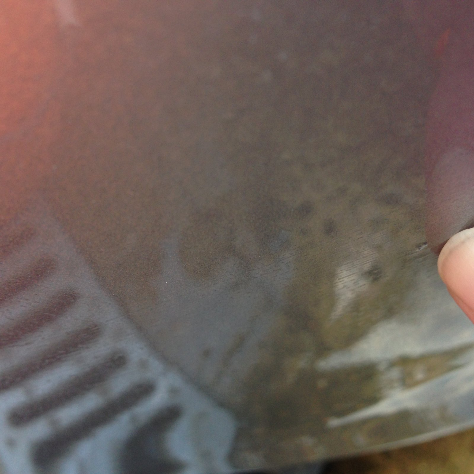

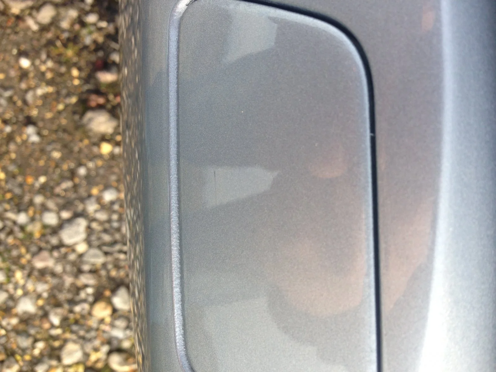

Damage to the front bumper which I assume is when the removed the kidney grills.

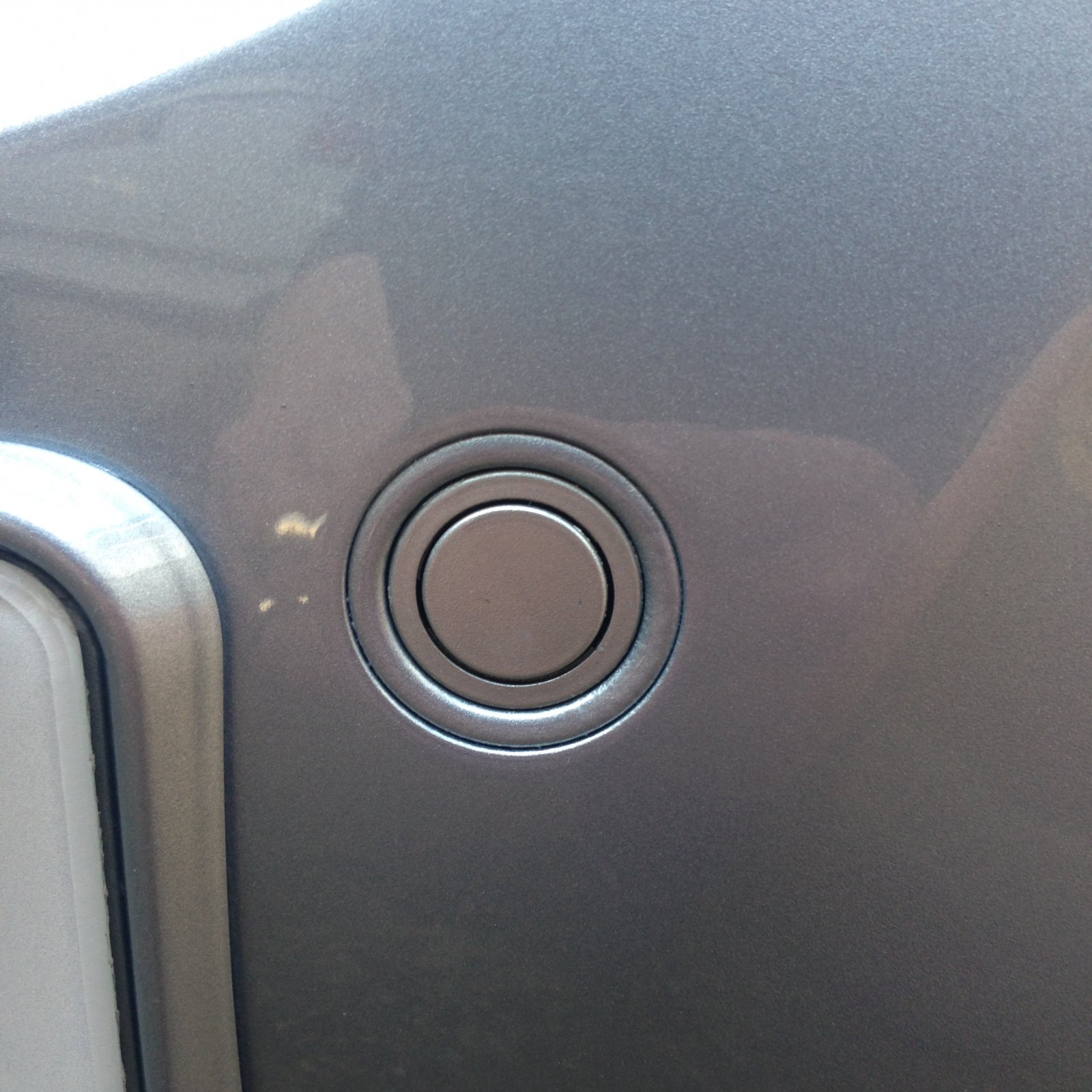

Front sensors not painted..

Other than two chunks on the front bumper, the car has come out worse than when it went in

f**k me that looks like they painted it in 2hrs!
Loos like they have rushed it to get it out the door.

I won't go on a rant mate. It's not even to do with the average person spotting it... A blind man could spot that.
I do really try to refrain from condemning other people's work where possible. Something I was always brought up with, every business can have an off day... What you've imaged is beyond shocking. You may think that is small issues... It's not. Those things are major issues that leads to bigger concerns. These aren't normal things that happen in body shops now and again and they can be forgiven. That there will be their usual standard barring a few good jobs. That is fact I'm afraid.
To give you an idea. I tell every customer that the idea of coming to my bodyshop is that the car should be returned to a condition where little or no one can tell it has been repaired or painted.
If you strive for the above... There is a chance you'll get close. I always think the bodyshop should choose what is acceptable, not what the customer will accept. That simply leads you down the road which you've ended up with.

Gotcha no they where supposed to paint the rear 1/4, rear door and than blend into the front door. There excuse for the front being out is due to painting the front wings to match....
All the little dimples on the paint he reckons flat and polishing would remove. Is that correct? The repair needed on the front and rear bumper itself was very good.

Can't edit my post, the said the front end was noticeable as the wings where not painted at the same time.
Silverstone is silver with a hint of green in the paint, the bumper was just silver with flake.
Gally
That's just stupid and why would it not all be painted at the same time? Even if you painted it 2 years later the mix should be the same. We're talking exact measurements here, point grams.
The colour matching there is no excuse, sometimes you can forgive plastic to metal but that's the wrong shade.
