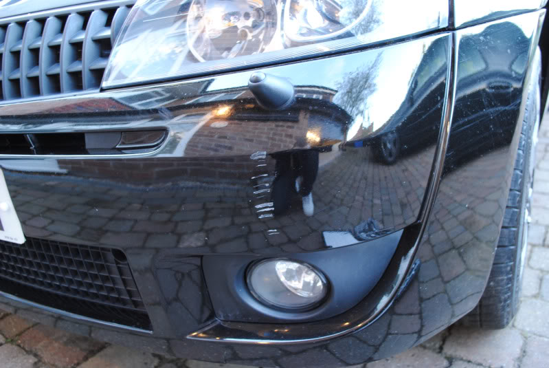

Painters please look: bumper scuff, after prep/paint advice.
Im hoping some painters or those that know there stuff can give me some pointers on this.
I've had this scuff since I bought the car, when I first got it I asked my local smart repair man for a quote, he said wait for me to add you to a job so I can sort you out a decent price, It will be around £80. Underneath the scuff is also a small crack at the bottom of the bumper, he said that as well would be £120.
Well its been nearly a year now, hes busy and I think im going to do it myself.
I have nearly all the equipment. Need a base thinner and possibly some better filler (please recommend)
Instead of the smart repair just being the odds and ends masked off and blown in, I would rather have the bumper off, take the fog lights, xenon jet out etc for a better finish hopefully.
I have a compressor, hvlp guns, basecoat, 2k clear, nearly everything for a home job, have done a lot of painting with it but only small items.
I just need some pointers on how to sand and fill, will a rub down of 1500 around the area then filler, primer, colour and then clear be ok?
Obviously im just looking to prep and paint the side with the scuff, so once im finished will the meeting point of old paint and new polish up together?
And what sort of process could I use to fix the crack? I might just leave it its only small.

My genuine advice as a painter, is take it to a proper bodyshop to get done. Mobile smart repairers are morons, so don't even entertain them.
You'd be less than £100 in my work place to have that done properly in a booth etc if you're happy with it being blown in halfway along the bumper. We're in Scotland so it's not as if you can use us mind. It's genuinely not worth the hassle of doing it yourself if you're not too sure on how to go about it.
Ok cheers mate, I would but the trouble is I dont want to lose the car or have the bumper off for more than a day, I can imagine the spot repair wouldnt be great but It would do for now.
I suppose ill have to find a cheap bumper and get it to a pro.
Oh and also, I've been meaning to ask someone for a while, could I use a touch up pen on the marks for now and it have no ill effect when it comes to fillering and spraying the bumper?
Can just be sanded out right?
Finding a cheap bumper and having it sprayed by somewhere decent is the best idea due to that crack, it could be sorted but there's no real guarantee it won't come back over time due to flexing etc. If you do decide to fix that bumper though touch up pen won't affect it come spraying time.
Excellent cheers, touched it in and tbh its miles better, wish I had done it from day one!
Will sort a bumper out in the future. Thanks.
