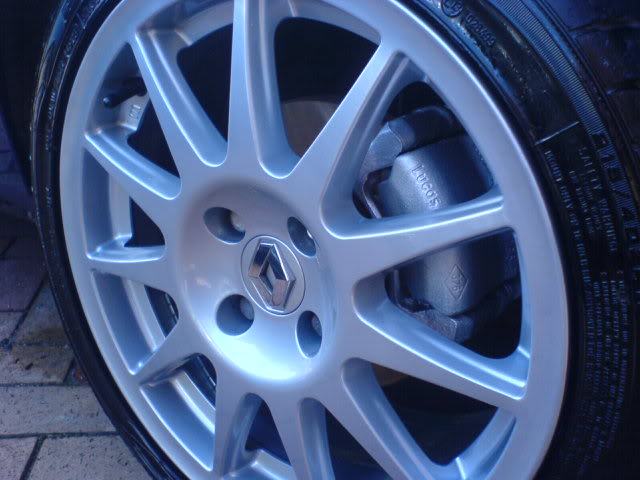

Or you could do a bit of a bodge job like myself. Still looks good enough.
All I did was wire brush them, wash them and paint the visible bits (while brakes still assembled).
I used Hammerite Smooth, silver. About £6 per small pot at B and Q.

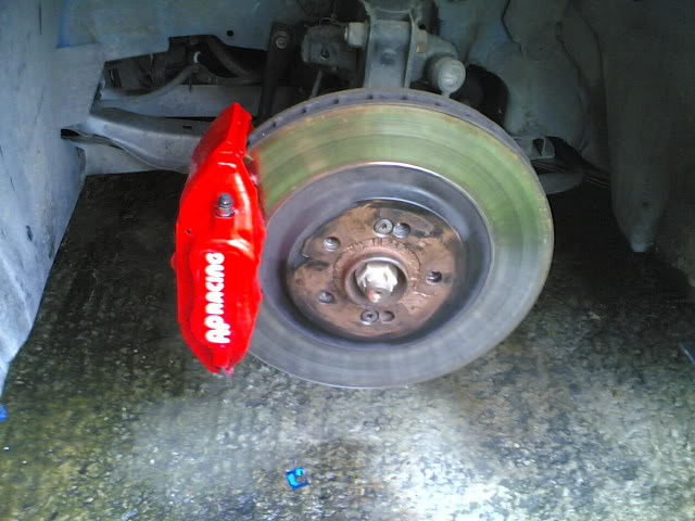

i used brake-cleaner wire brush and soapy water to clean them up with brakes still assembled .
i also used Hammerite Smooth (red )put two coats of paint for deap color
job done :)

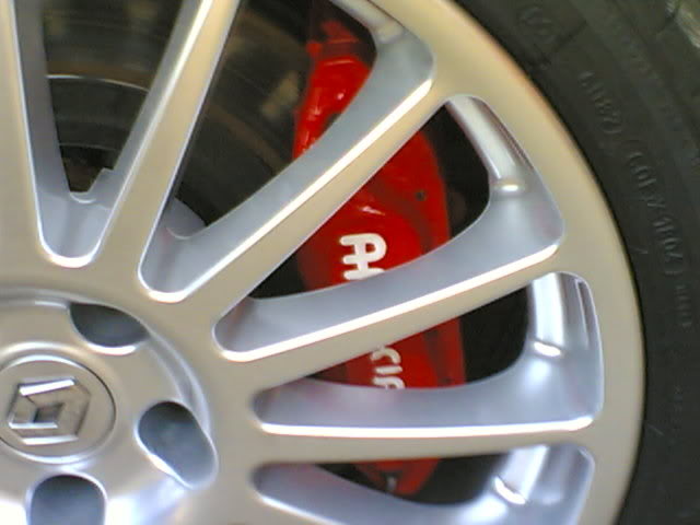

Hand painted by myself.

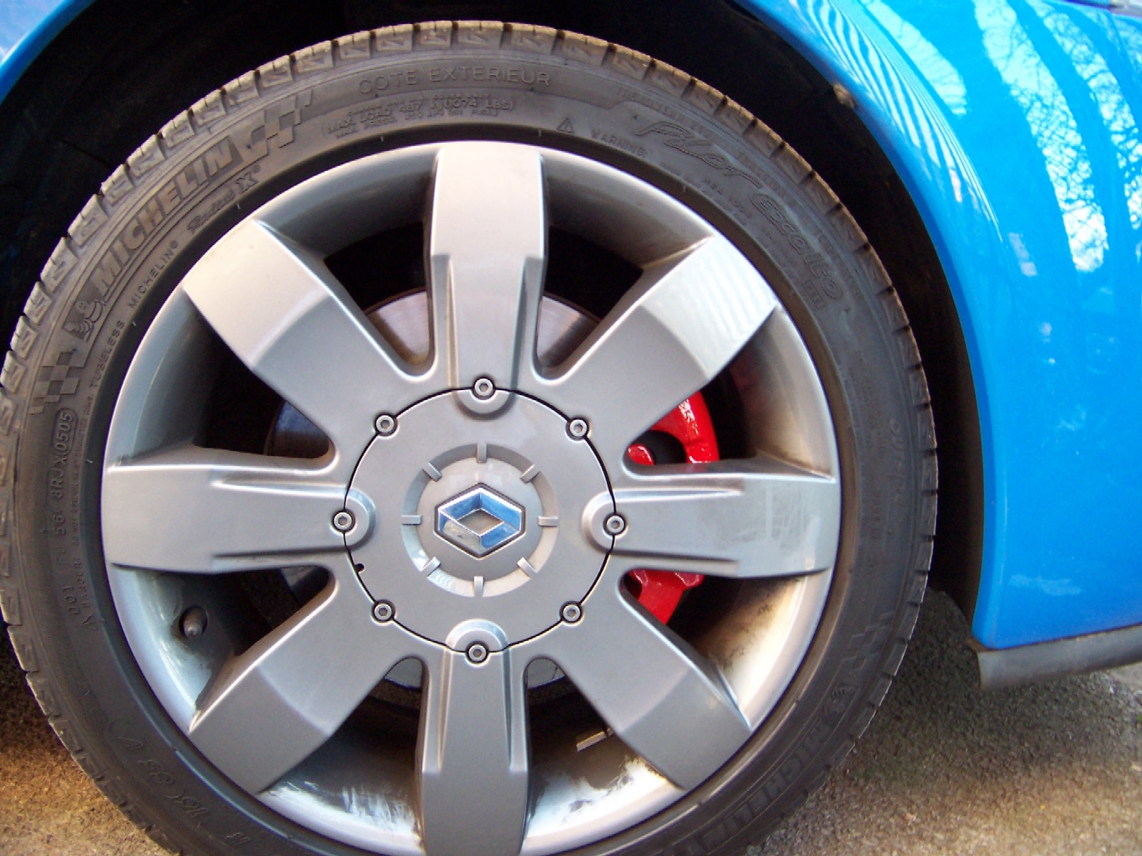

Here's my results.
