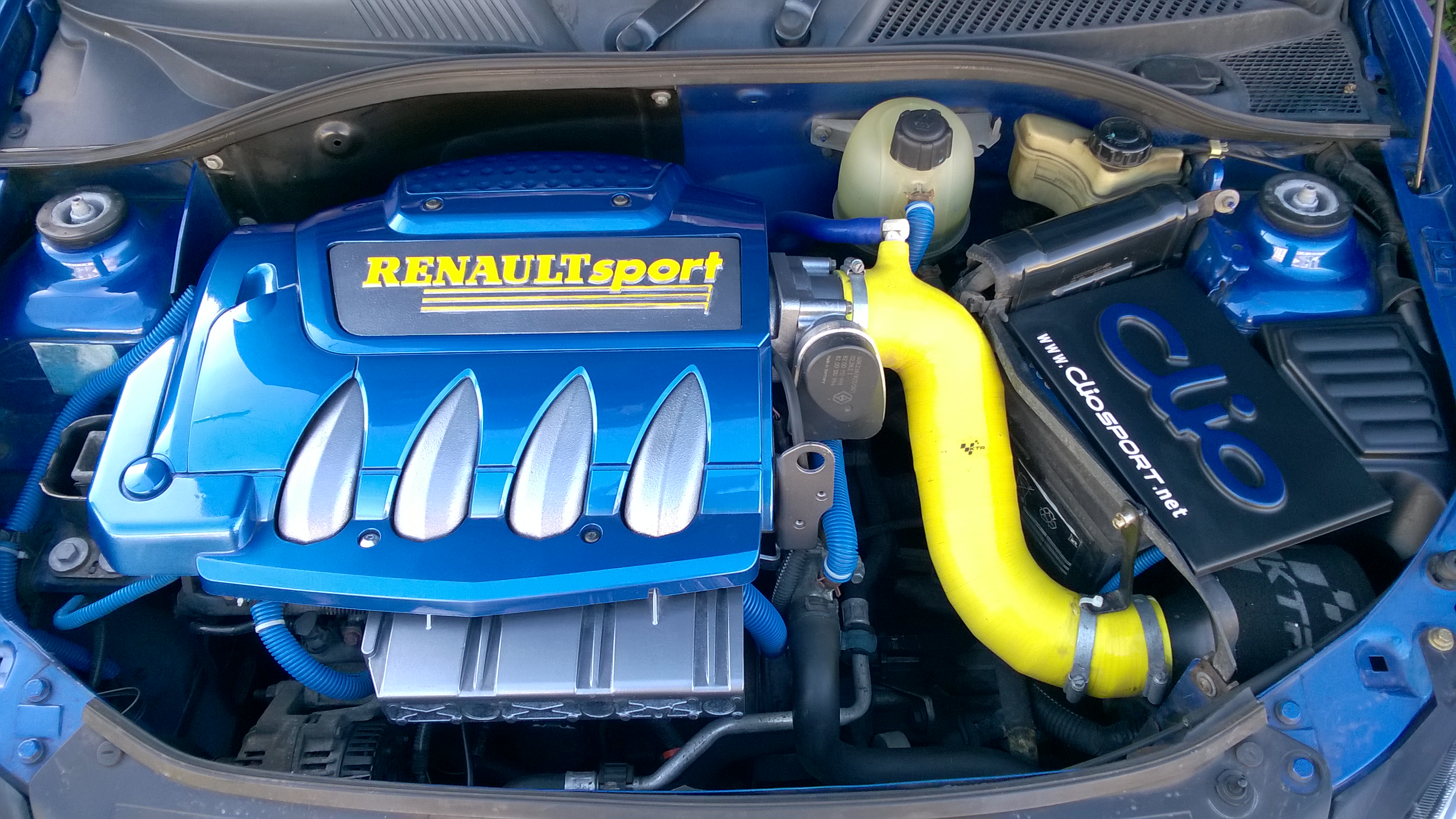

take it all off to paint, sooo much easier. Couple of connectors to take off. One on the coils pack, one each side of the upper inlet. One on the throttle body. Engine cover off if you have one. 4x10mm bolts to remove coil pack from the upper inlet. 4x10mmm bolts to remove upper inlet, might be a bit sticky at the front because of the gasket. 2x10mm bolts holding the fuel rail protector on. Go steady with these as they are prone to shearing off. As already mentioned take your time and if unsure take some pics along the way. Once its all off its just a bit of masking and spray away. Easy.

View attachment 136207 take it all off to paint, sooo much easier. Couple of connectors to take off. One on the coils pack, one each side of the upper inlet. One on the throttle body. Engine cover off if you have one. 4x10mmm bolts to remove upper inlet, might be a bit sticky at the front because of the gasket. 2x10mm bolts holding the fuel rail protector on. Go steady with these as they are prone to shearing off. As already mentioned take your time and if unsure take some pics along the way. Once its all off its just a bit of masking and spray away. Easy.
That looks good, probably go black with mine tbh
