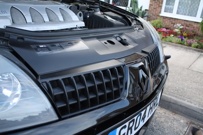

Neat job that ^ mate :)
Would never of thought of the brillo pad but is a good idea, rough enough to get the primer/paint to key.
Halfords Grey primer and satin Black I'm guessing?
did mine on both clio's .... rough up the grill, clean, prime then apply your chosen paint. Satin was my choice.
Cheers, but I can't take full credit!!
I used Hycote grey plastic primer and a satin black rattle can... Looks miles better!
Brillo pad is just enough to rough it up but doesn't key too deep, just be sure to wash off all the plastic filings/dust before spraying!
