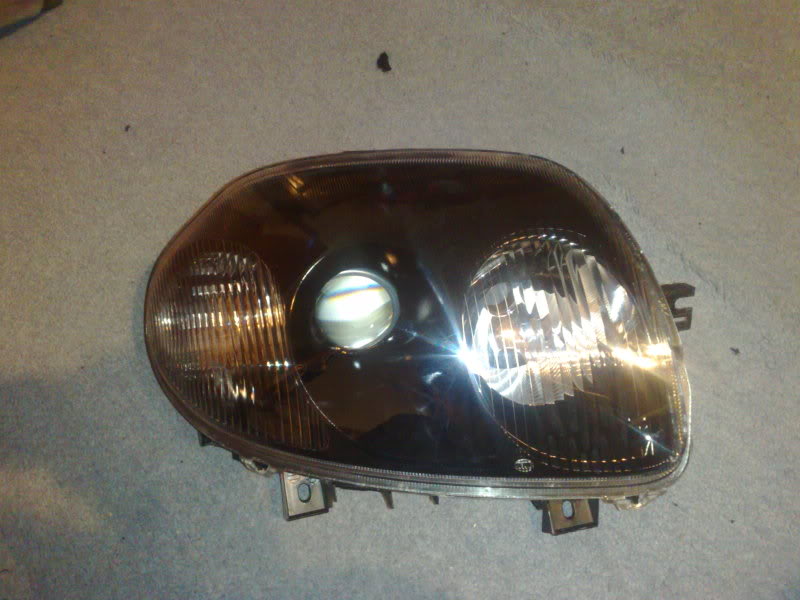

we have painted the inside of the headlights to black and also fit 2 xenon kits to headlights and fog lights
also take off the hats inside the foglights to get more light
finaly the fog lights gives twice of the headligths;)

we used black silicone to stick them
be sure that for now it is much more better from oem
there isint any risk to get inside the headlights water or dust

my friend want the same headlights and i made for him. the choice is himself

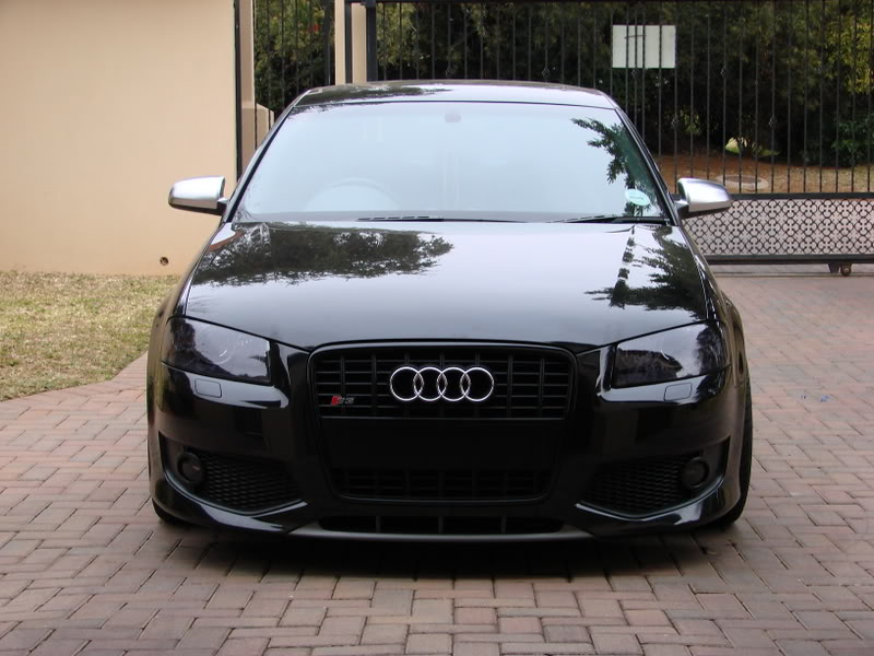

i did this to one of my spare headlights but wasnt too sure of it, i kept the reflective bits though -

there will be no issues with legality as long as the plastic outer lens is not painted over here. the chrome as standard is just there for decorative effect, the reflector is behind the light for the projector so will work just as normal.
looks pretty good imo
im waiting to do this to my headlights , was it difficult to take them apart?
its not difficult but not easy too.
you can use a knife and a thin iron part
put the iron betwwen the glass and headlight and while forcing back the glass cut the oem silicone inside the headlight
after you cut half of it you can pull a part the glass only using your hand.
someone uses hot air while doing this but i dont use because there is no electricity there:)
after that you have to sand the reflector before painting and you can stick them back with black silicone
