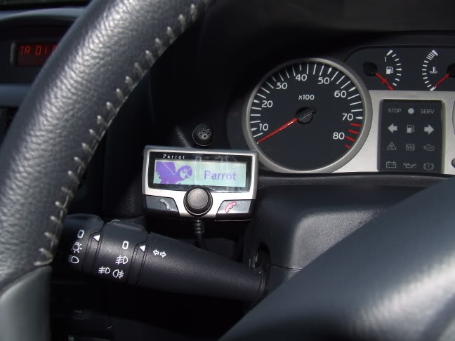

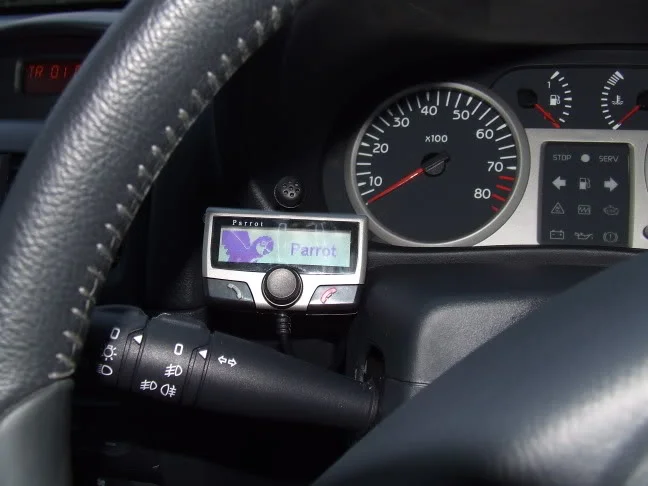

I have one. It is mounted near the indicator stalk.
I have never told my insurance. It plugs direct in the back of the stereo.
Good placement! I'm thinking now either that or right hand air vent, How'd you find the kit? Not even turned it on yet!
It is brilliant. Renault mounted it there. They said if it is too near the window the wind will affect it., It has been in 9 year. So far so good.

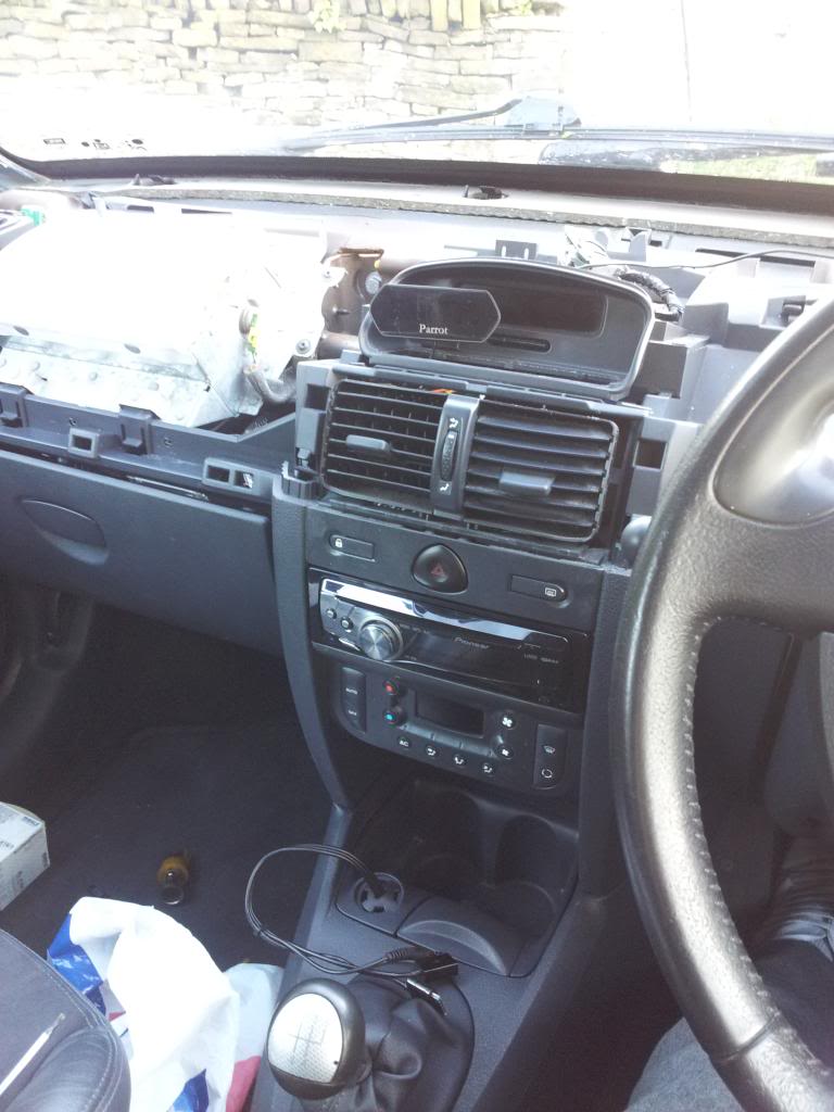

Ah I wasn't sure if you'd have to declare it because wouldn't it be appealing to theives? Also I've got a Mk3 so not too sure where to mount everything, might put it behind the hazard/lock buttons I think theres a compartment there you can use but not too sure! Just need to try it first and see if it works properly :)

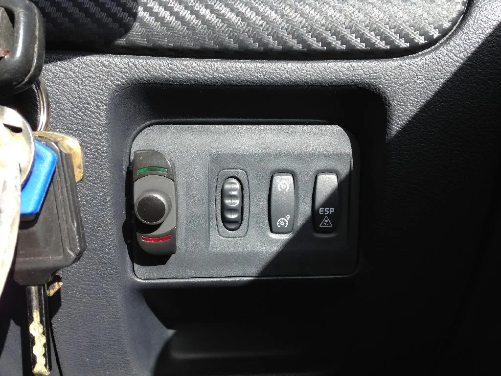

I know it's a PH2 but the mk3 has a similar panel. Mounted a couple of ck3000 kits like this
I mounted mine here, as that side of the display isn't used as aftermarket stereo
