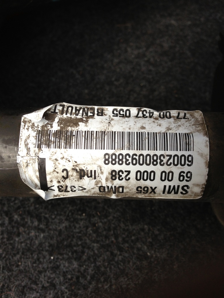

Phil, with the DCi rack, do you have to match it to the make you had previously, ie: SMI cup rack for an SMI DCi rack?
im looking at my factory rack and I have no indication if its SMI or the other, there is no sticker on it, I assume it has disappeared over the years.
no other markings on the rack other than the word 'Renault'.
i just want to get it correct when I speak to Kat to order one.

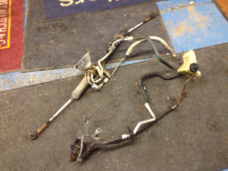

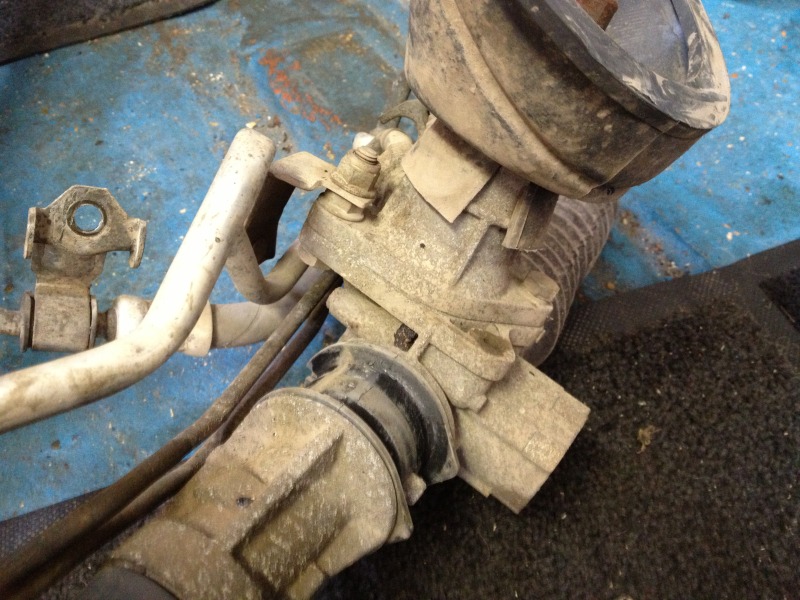

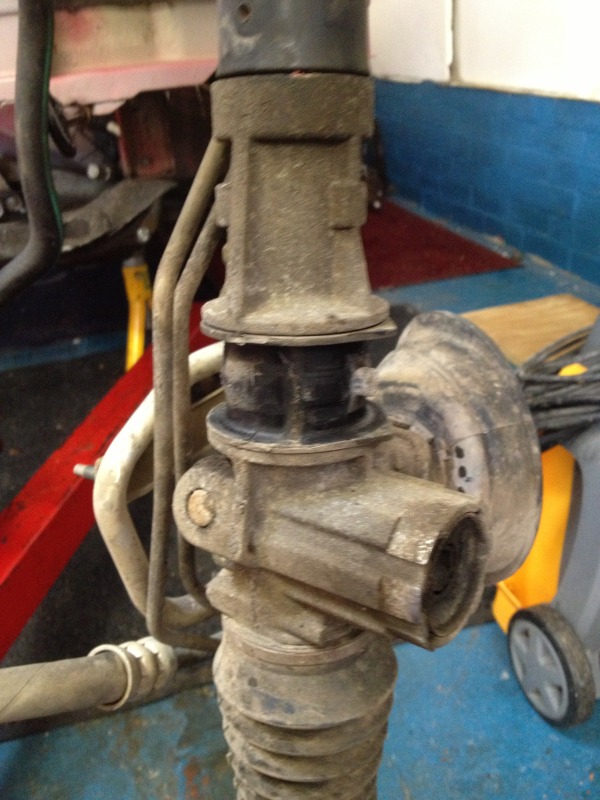

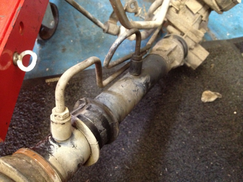

rack pics:
