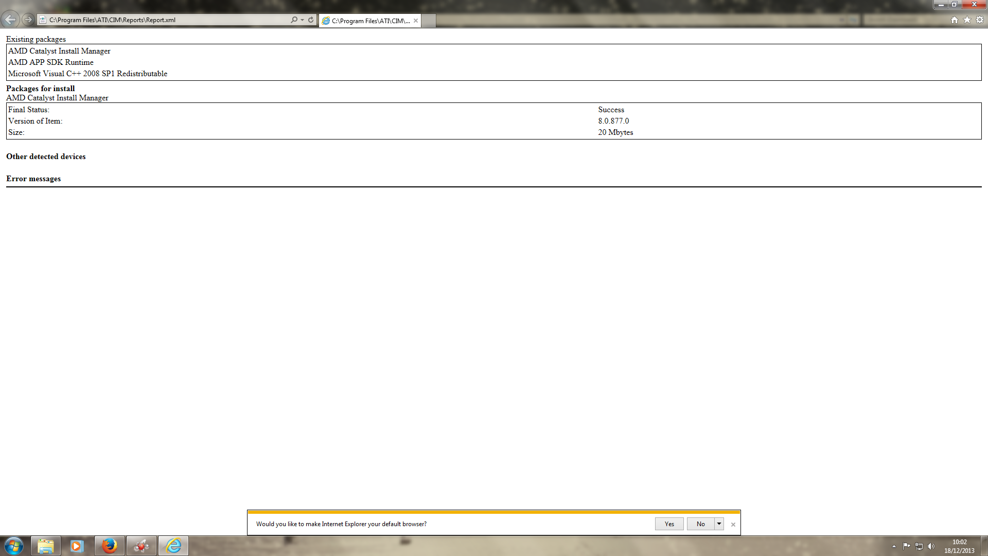

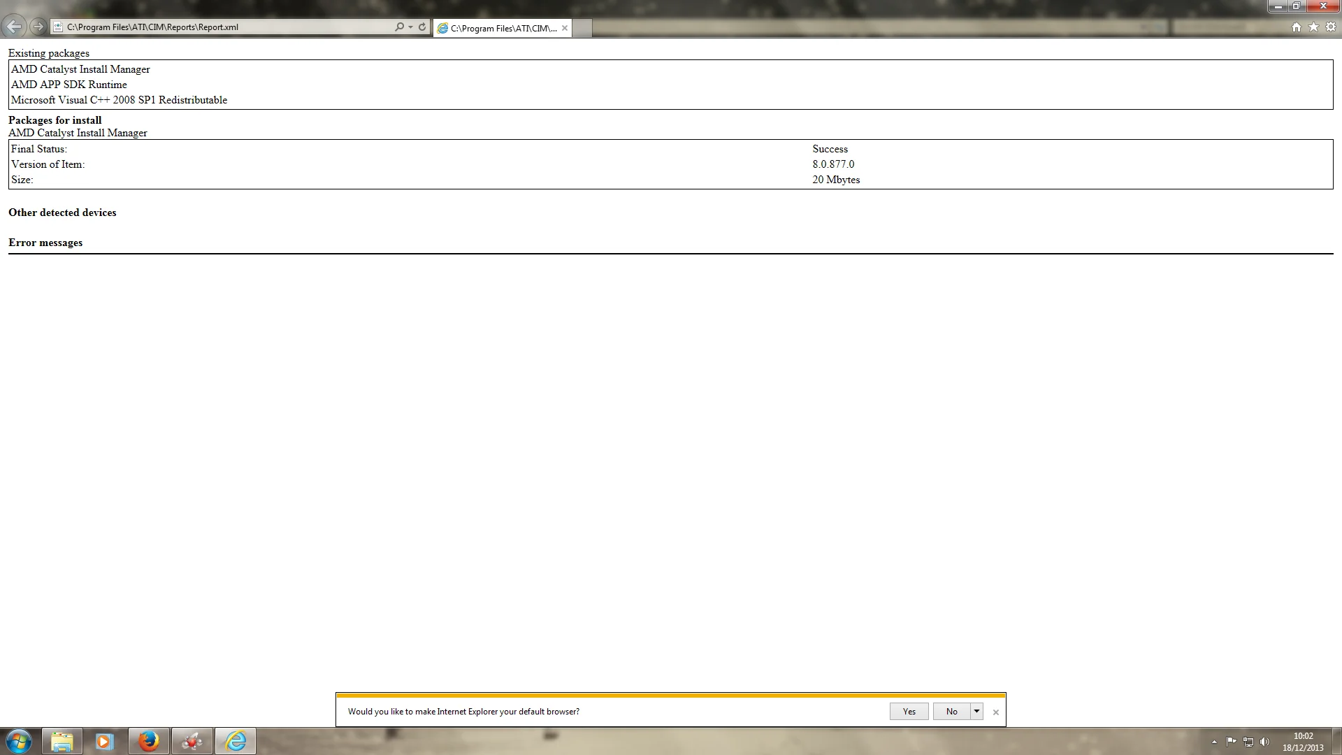

GFX image.webp tried to install it again and i get this message? does it look like it hasn't installed?
