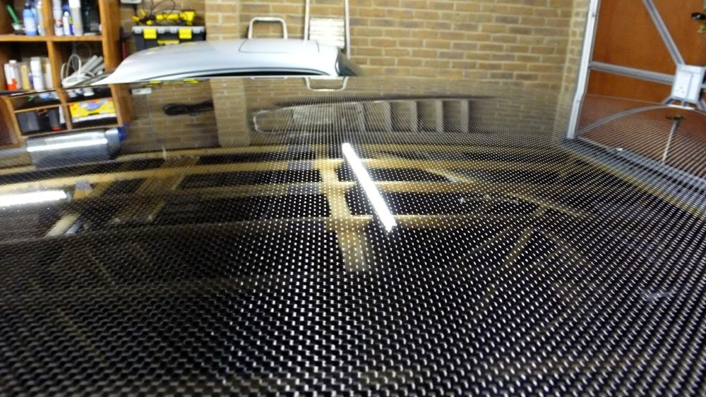

can you PC carbon fibre?? my mates carbon bonnet has a few swirl marks and could do with a good buffing.

its a buddyclub carbon bonnet on a CTR..
not sure if it has clearcoat spray or whether its just the standard gelcoat from the carbonfibre process though?
Even if you can't polish it with a abrasive compound, you could definately PC it with Klasse All In One/Carlack Systematic Care. That should clean shine and polish it safely.
ooh ok, cheers rich. never new wot to use on it, so never polished it, swirls ever where, will giv it ago 2moz
buddyclub say its clearcoated. say use polish but nothing abrasive?
im thinking megs speed glaze on a white sonus pad?
AIO has a more chemical cleaner type effect, where as the SRP some of the same but with some added abbrassive cut.
SRP got the marks out, slight swirls left which would prob come out with SSR 2.5 but i didnt wanna risk it.
its alot better than it was anyway.

yeah tries SRP and EGP, works a treat. I thought it never worked and always woundered wot pple used on CF bits in shows to make it so shiney. woohoo
