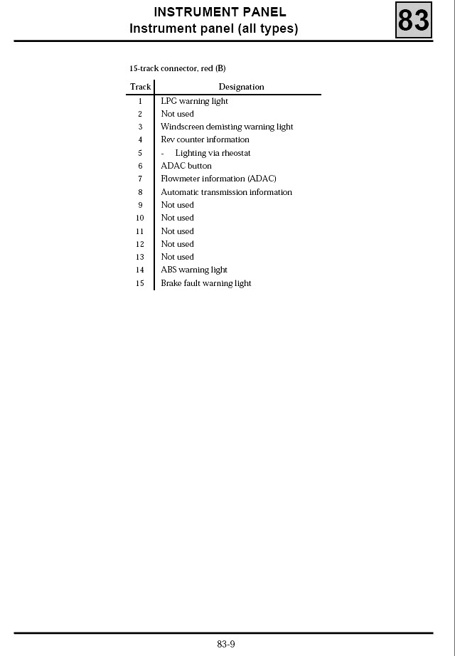

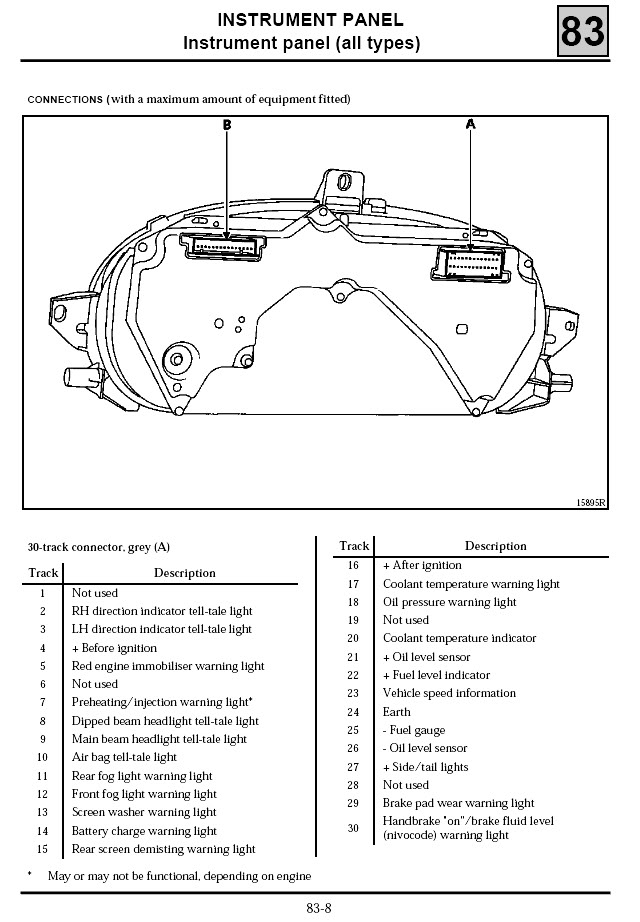

Hi there, last piece (hopefully) of my wiring jigsaw is to rewire the dash/interior on my ph1 172 but could do with a drawing/pinout diagram from the back of the instrument cluster. The haynes manual only shows the non sport dash so is different. I know the info is hard to come by but i know people have had it previously. Someone must be able to help out. I was sent a drawing by a member on here for the ecu pinouts and its been a godsend, hope you guys can help me out again.
Cheers
Russ
Sorry to bump an old thread, but is the same for ph1 non-sports? particularily concerned with track 4 of the red connector (REV COUNTER)
  Bumder With A Buffer
That's what you require, providing urs is the same of course. Only fear is tapping into that could cause issues with the signal being sent.
