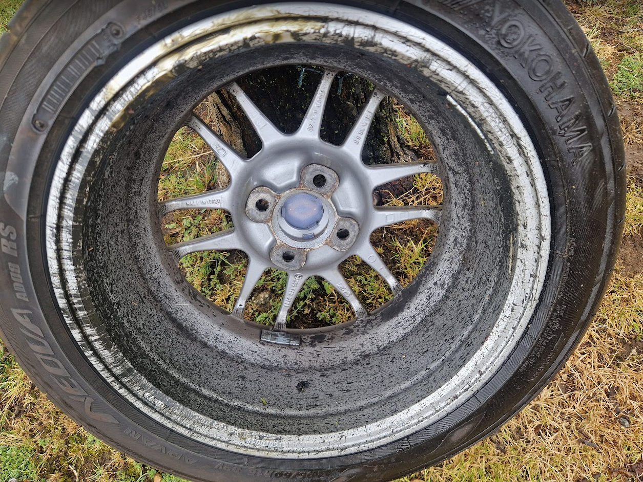

As per title I am after recommendation / advise as part no longer available from Renault and can't see any pattern parts listed on KAM or KTec, what brand CV boot are people fitting?
The O/S outside CV boot has split and I need to replace before it spills even more grease into my brakes, as you can see most of the grease is already out, clean up was atrocious, wheel, arch, brakes bloody everywhere

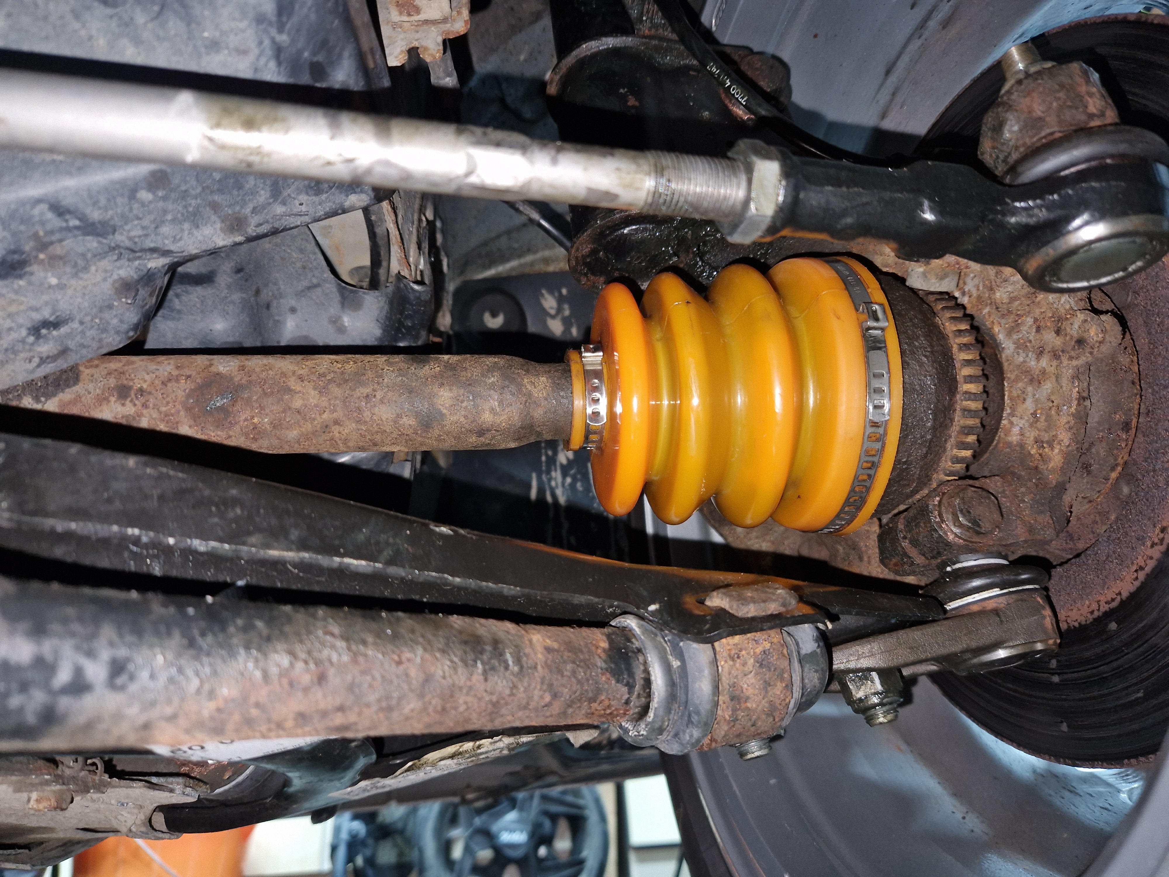

Finally got round to sorting this and thought would post for reference. Garage couldn't get what they thought was a good quality replacement as original part NLA. But did find that a 2015 Mitsubishi L200 boot is an exact fit for a 172 ph1 O/S outer boot, albeit it is brilliant orange 🍊
Mitsubishi > Nissan > Mercedes > Renault parts are compatible on some models. Particularly MK1 & MK2 Clios, as you found out. My son worked at Nissan and said they still use Renault, Mitsubishi and Mercedes parts on modern cars.
