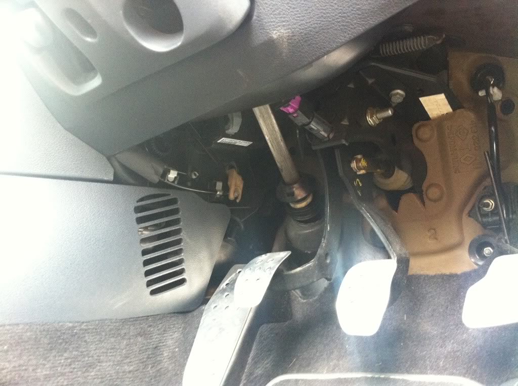

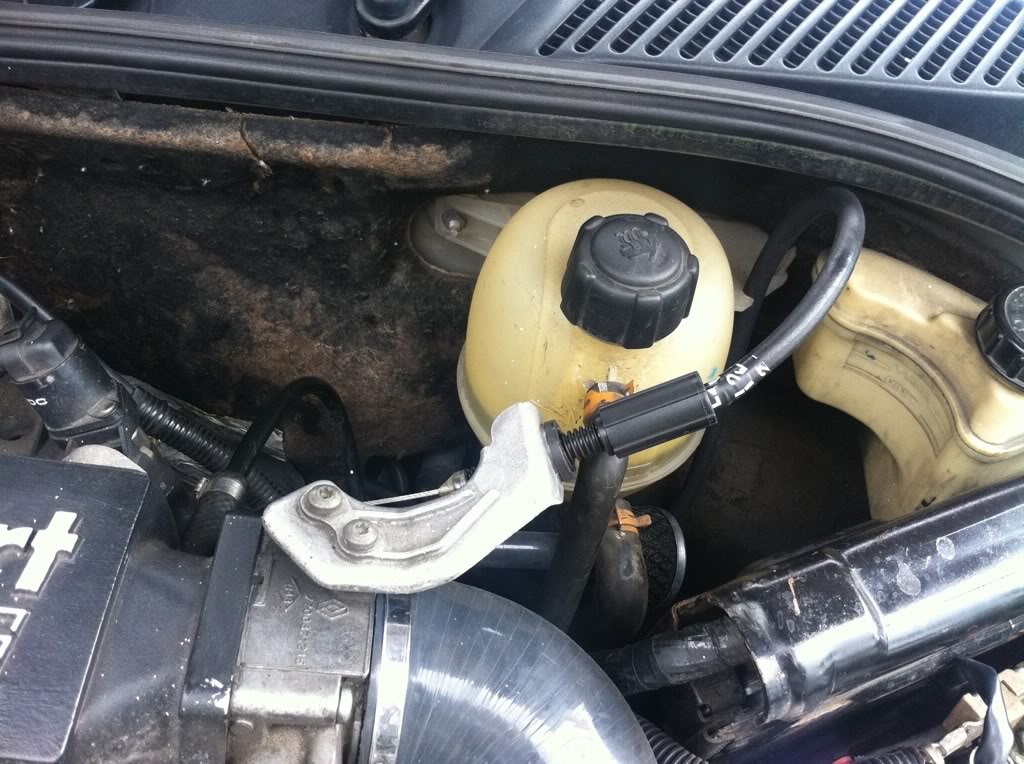

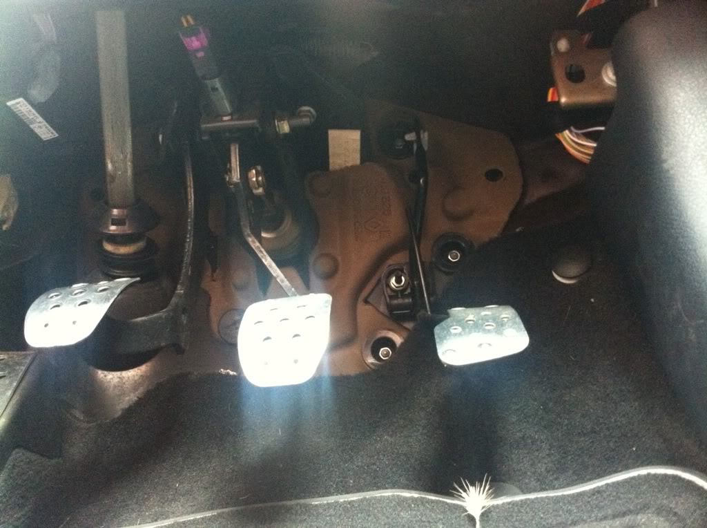

Does anyone have a photo of the ph1 172 throttle pedal so I can see how it attaches as I'm currently trying to convert my ph2 to cable and there doesnt seem to be anywhere to mount it to?
Thanks
Rob

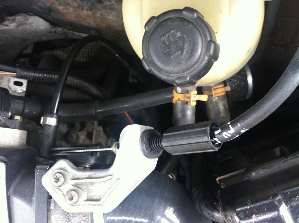

Right, here you go...
Pedal:
(in this one you can see where the cable clips on, it's the white bit)
To the throttle body:

Not sure if you are going itb's mate, but bear in mind ph2's dont have idle control valves, so fitting a ph1 tb will lave you with no icv
richard691
  Twingo RS133 & 172
No mate, I have a turbo conversion but have opted for cable TB and the ICV is already sorted, all been worked out by Omex. :)
