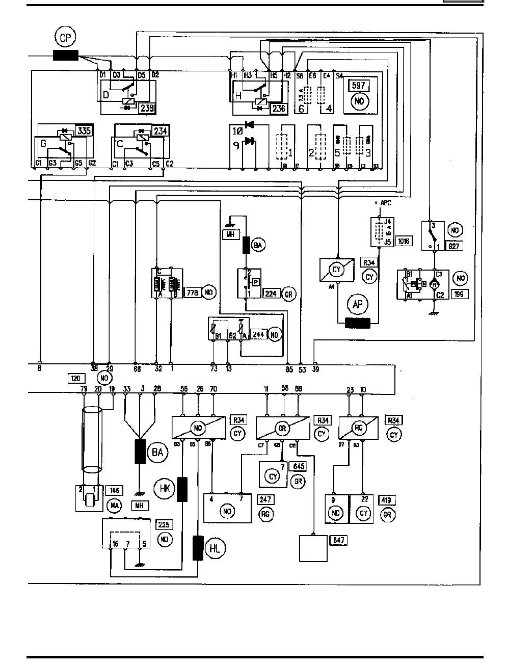

Has anyone got one or know where I can get one from? Having some issues and want to connect the fan up to a manual control, so as there is no A/C was hoping to wire it up to that.

yeah, but want the AC button to control it instead of having a switch hanging there. Want to tidy the wiring up as well and check which relay controls the fan, as not sure if that's at fault or a relay.

Should also point out that I have an Omex600 in the car too and the fan is controlled from that as for when it kicks in. It's all a bit of a wiring nightmare at the moment trying to go backwards at the moment to go forwards but my mate working on it has only previously worked on Mk1's.

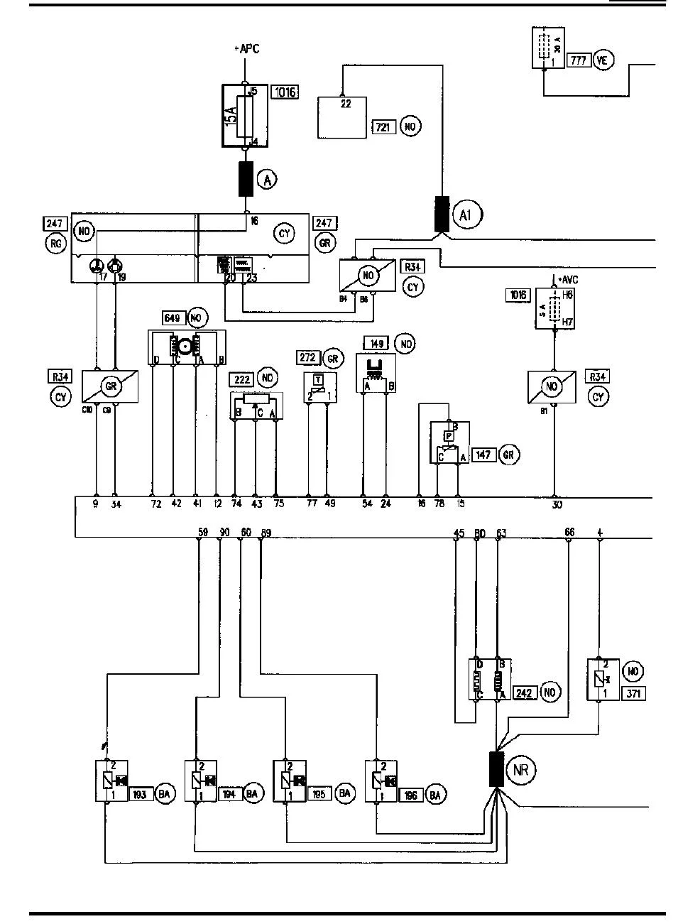

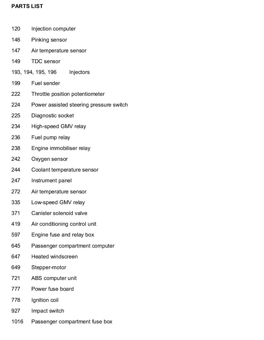

is this what your after ?
