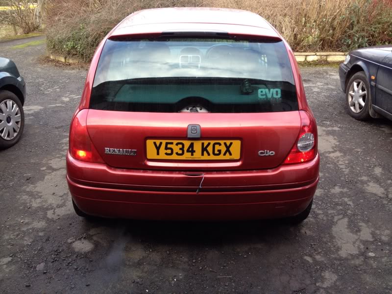

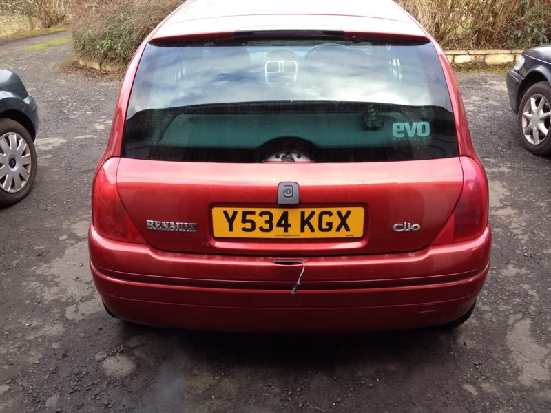

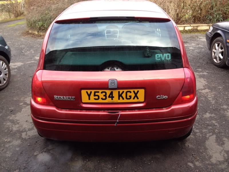

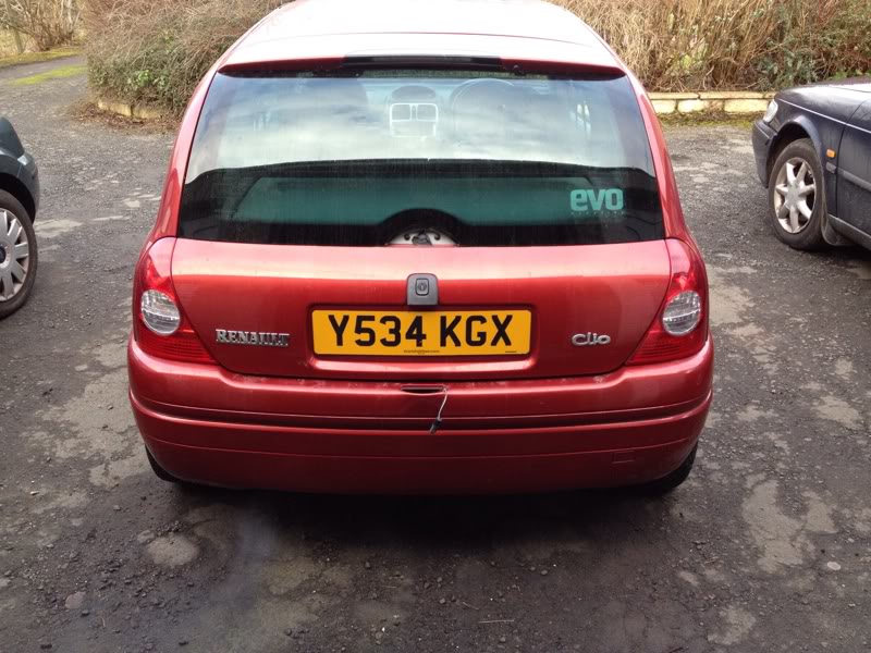

Decided that after several years of having the ph2 lights on my ph1s that I'd like to change back. But not completly!
So this is how it looked
midway through
and after with them on and off
Decided to use the ph2 holders so that they light up at the bottom instead of the top, a nice compromise I reckon.
C&C welcome obviously!
Cheers
John
