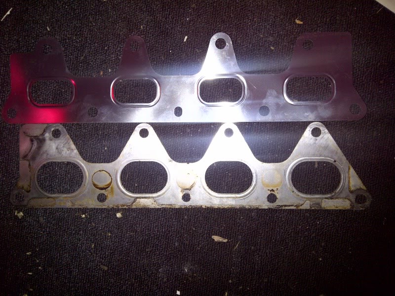

maybe not 30%, but its still a big difference!
  ITB'd MK1
they're not technically 30% bigger, that would be incredibly difficult to quantify, they have 30% better flow. I was there when they testing was done years ago ;)
  Astra coupe t, nova
Wow that is a fair difference. I hope the gasket I've ordered is the right one, if not i'll be using the old one.
