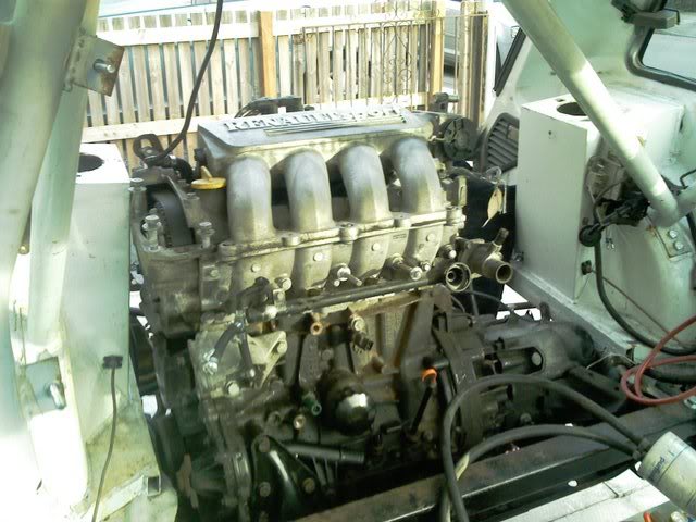

is this a ph2 rail?
If so can it be modified to run an fpr?
1. Yes it is
2. I think it can but its a bit hard to do it and easier to get the Ph1 rail, even though they are harder to find
How much do renault charge for fuel rails ?
Whiteley is selling one I think, ask him if it's from a ph1 or 2.
Mine's from a Ph1, but it's the later style Ph1 which is actually the same as a Ph2 with the blocked FPR port.
Hard to tell from the photo, could well be a ph1 as it looks to be open.If it's for sale then get him to blow down it if he can't otherwise tell. Ph1 will come out the other end, Ph2 he will go blue.
I'd guess it's a PH2 rail as it hasn't got the FPR fitted (unless they've removed it) But as Whiteley says they look identical in appearance its only when you look at the fpr area you can spot the difference.
If it is a PH1 rail there should be marks where the FPR was fitted and also on the far right (as were looking at it) where the return pipe is fitted.
