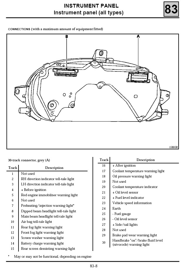

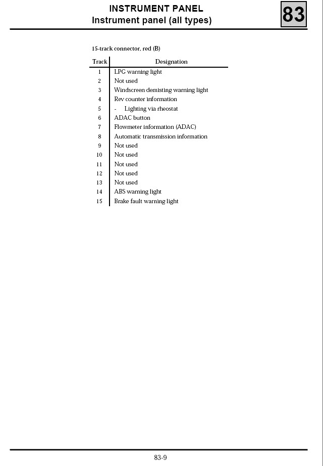

Does anybody know which pin on the back of the ph1 sport clocks is for rev counter and water temp?
​cheers!
Got some pinouts kicking around, gimme a sec.
Here:
