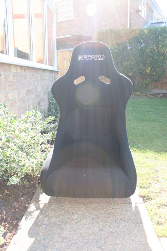

Picked up a pair of pole positions on Friday night.

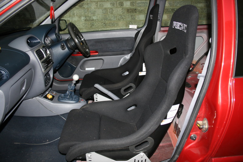

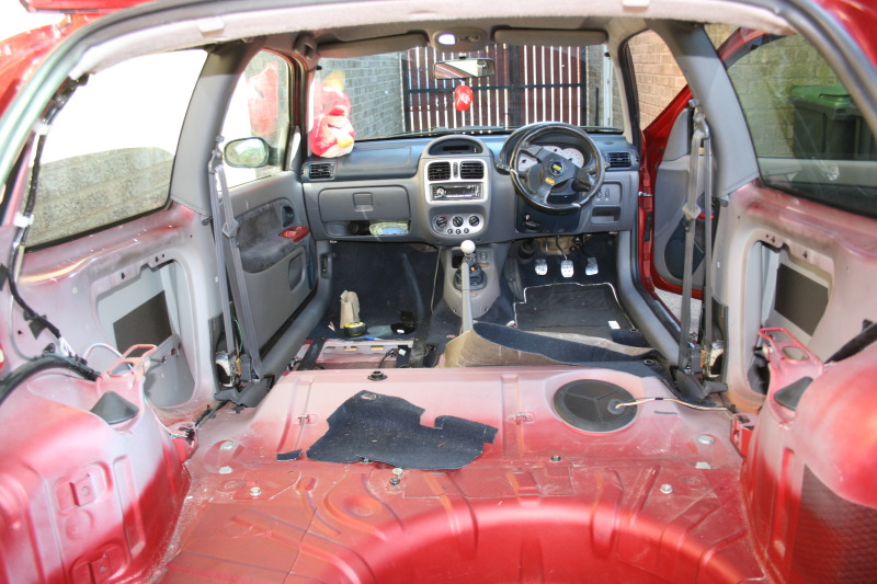

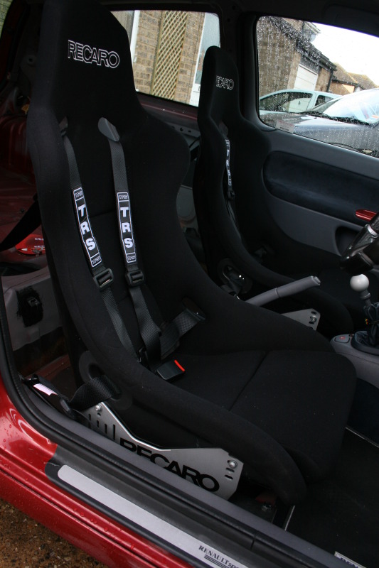

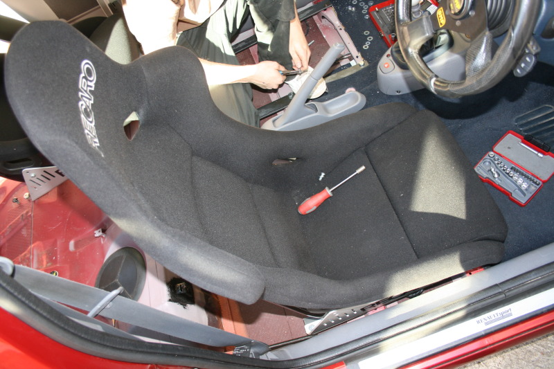

Saturday morning i set about getting them fitted, out with the old seats, carpets and other general crap.
Drivers side, in and fixed.
And finally the finished product. Before being hoovered ;)
Actually love the seats, so comfy! And give such a better supported drive and position.

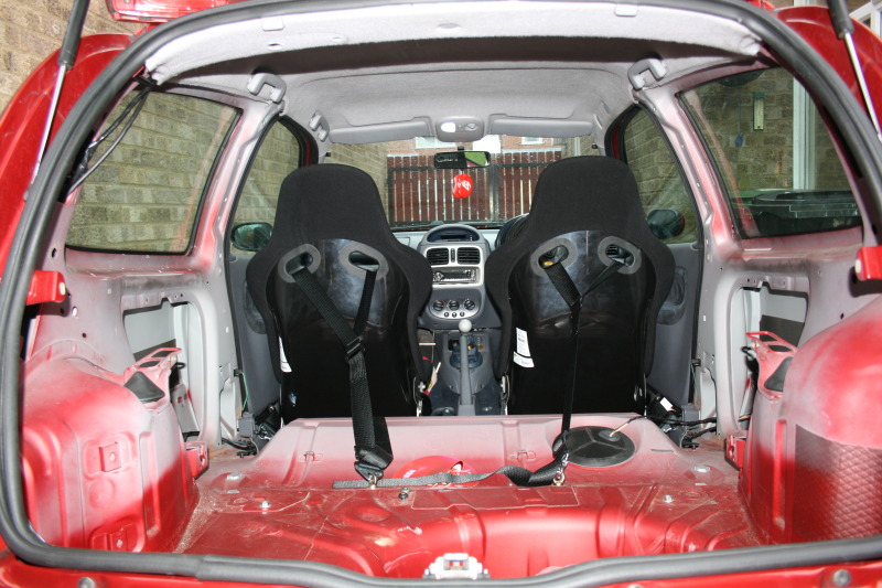

Got some 3 point harnesses on the way, so ill get them fixed in this week, and lose the seatbelts, that are temporarily held in!

Nice . . . . how did you mount them in the car?
Harnesses will set them off a treat. What colour you going for? Red????
Black, to keep it nice and subtle :)
As for the seats, put the side mounts onto some 6mm steel bar, then put some big bolts through the bar onto the exsisting floor plan.
Used high tensile bolts of course.
Probably not the best way, but seems plenty strong/sturdy enough to me. Though you do sit very low now!

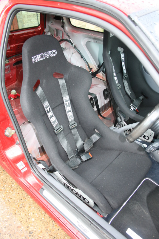

Got 2 TRS clubman harnesses at the weekend, got them off ebay pretty much two for the price of one compared to demontweeks :)
Seem alright, easy to get on and comfy so far (considering ive only done about 50miles since fitting the seats haha)
Fitted easy, eyelets in the original rear seat belt holes, hooked onto the original rail the existing seatbelts used.
Hardest bit was the eyelets near the handbrake, got some 6mm thick spreader plates made with a bolt welded on, dropped the eyelet through the old seat hole and tightened them up.
All worked realy well and seem secure enough to me :)
Few pics. (Apologies for the poor qaulity, quick snaps in between rain!)

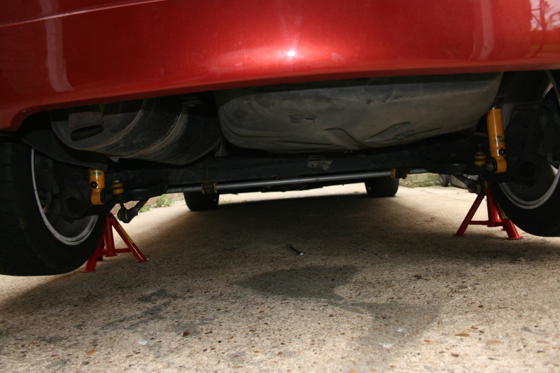

And one of the awful height the car is currently sitting at on apex springs :( roll on the 5th....

And worst of all i re-routed all of the wiring in the back of the car so its nice and clean, utter b**ch of a job to do. Looks awsome.

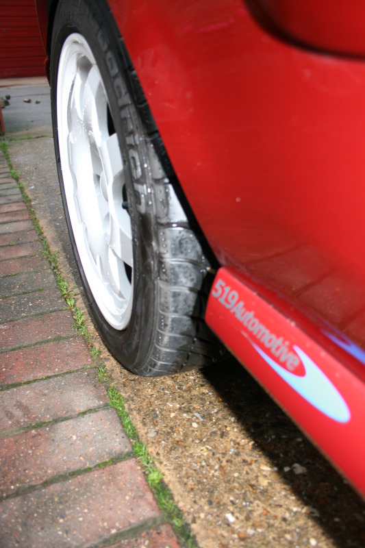

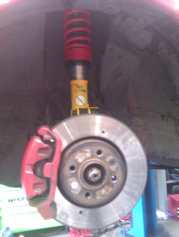

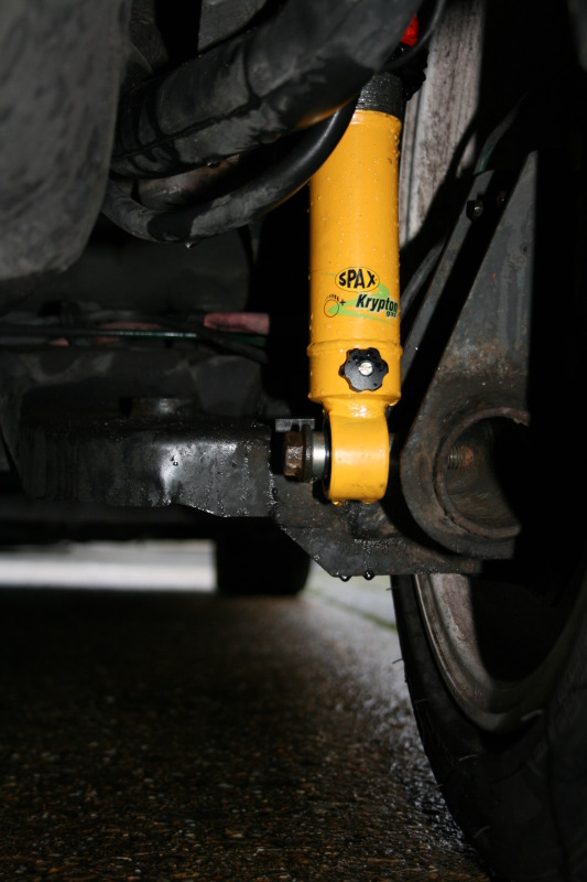

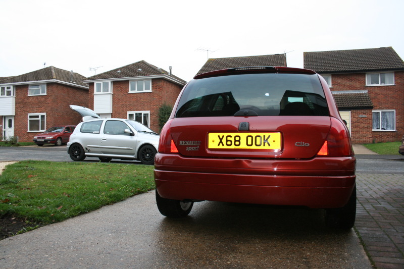

Went to 519 automotive today, got the spax RSX kit fitted :)
Pretty glad i decided to get them fitted, as at least i know theyre all on properly and i wont risk damaging them through my sloppy skills :o
Dan is a proper sound guy and had it done in no time, handles amazingly. So im very happy! No more bouncing all over the road.
Sitting fairly high atm, might lower it a tad, even though i know its not all about the lows.

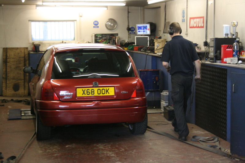

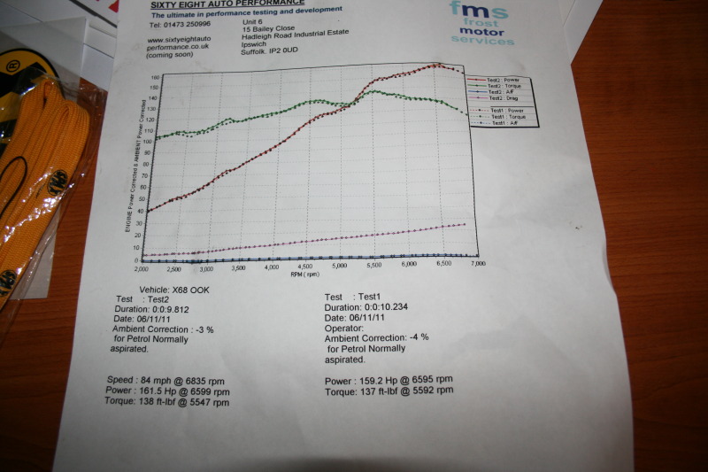

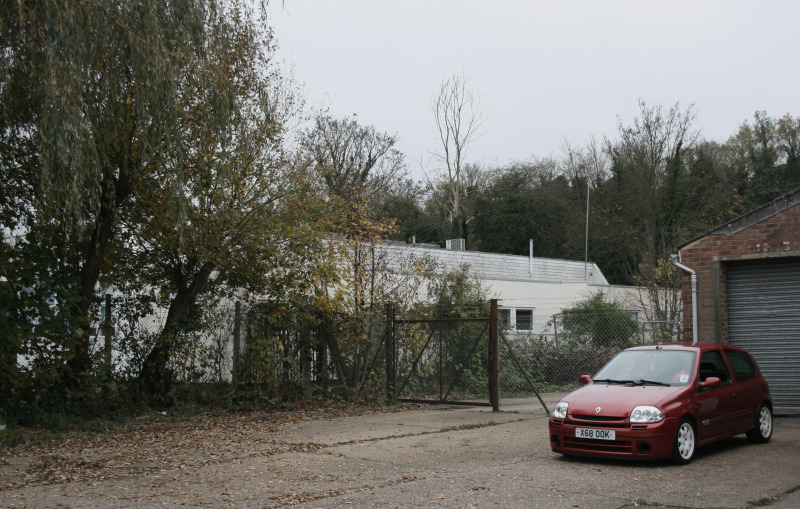

Few pics of the coilovers, and a few after i washed it ready for tomorrows RR if i make more than 160bhp I will be happy lol.

Few pics from the EA rolling road day, made 162bhp and 138lbft (or however you write it) Actually pretty happy with that, engine seems fairly healthy considering its 100% standard and over due a decent service :)
Oh and its only now running in at 70k ;)

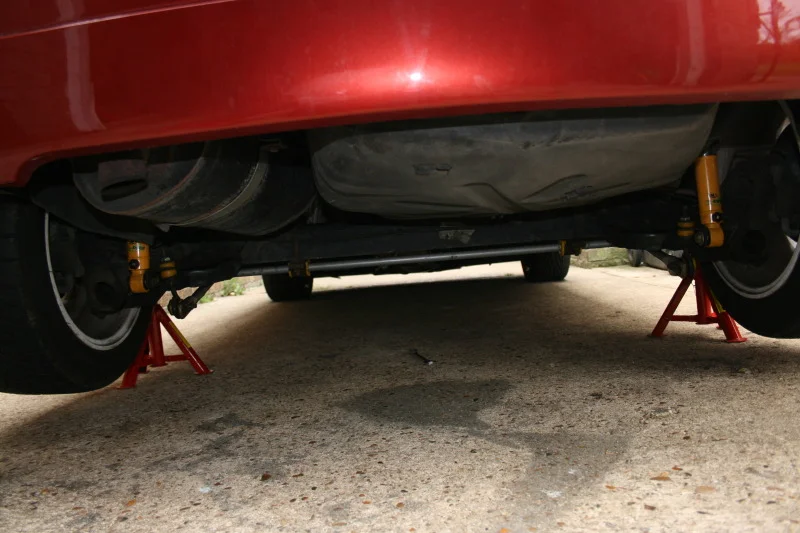

Whiteline ARB went on today :) handles even better than before, it actualy feels like a completely different car to drive than it did two weeks ago. Absolutely love this thing at the moment.
Also lowered it 10mm all round, think ill leave it there tbh.
Whiteline fitted.
Wires hidden and the general mess thats the back of my car.
