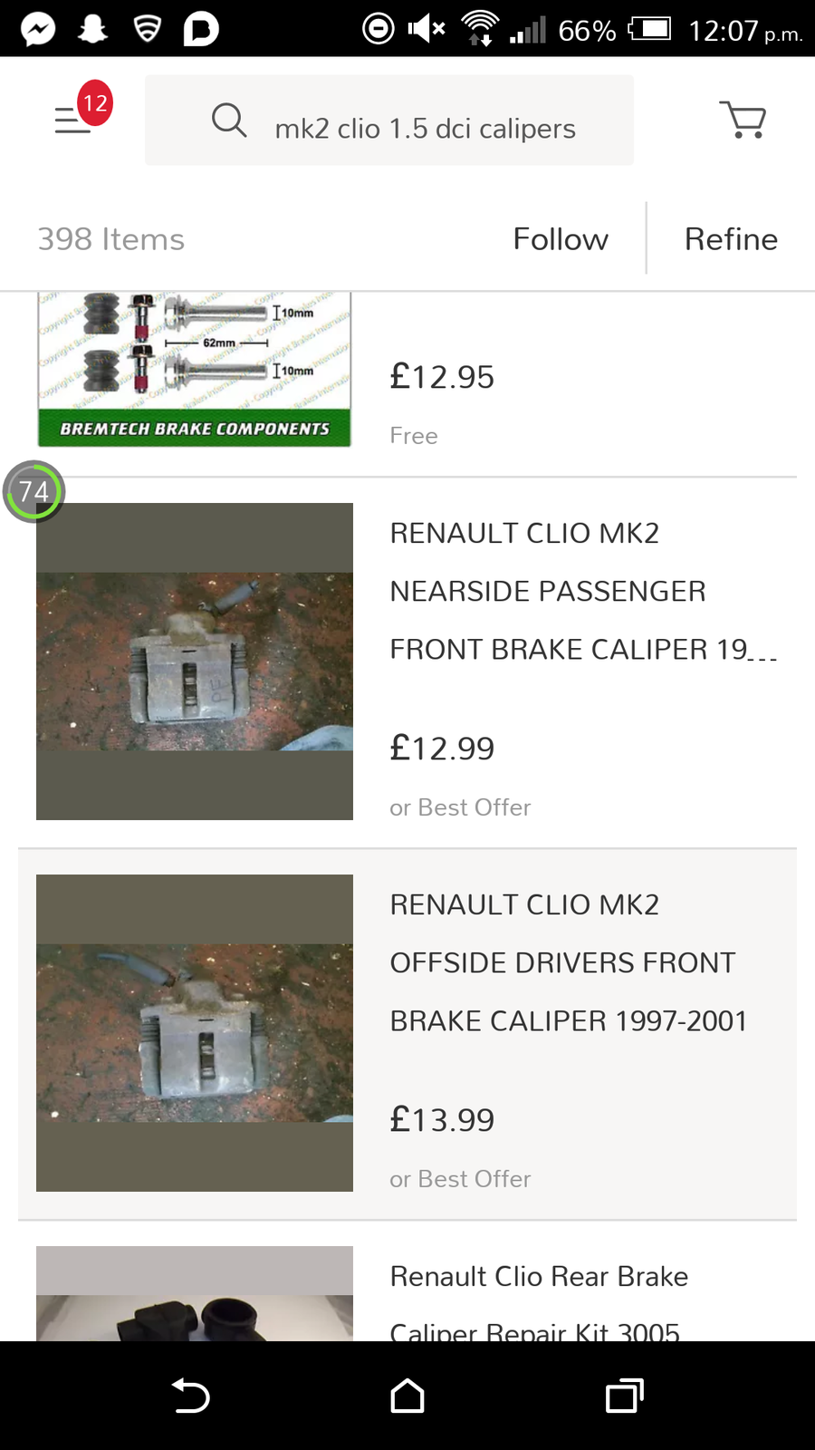

Should these fit ?

Yeah you can still upgrade then, any dynamique, 1.5 DCI ph2 brakes will all fit, you'll need the discs, calipers, pads and caliper holders. I think the hoses are interchangeable though can't guarantee it
I have heard Laguna calipers fit ?
