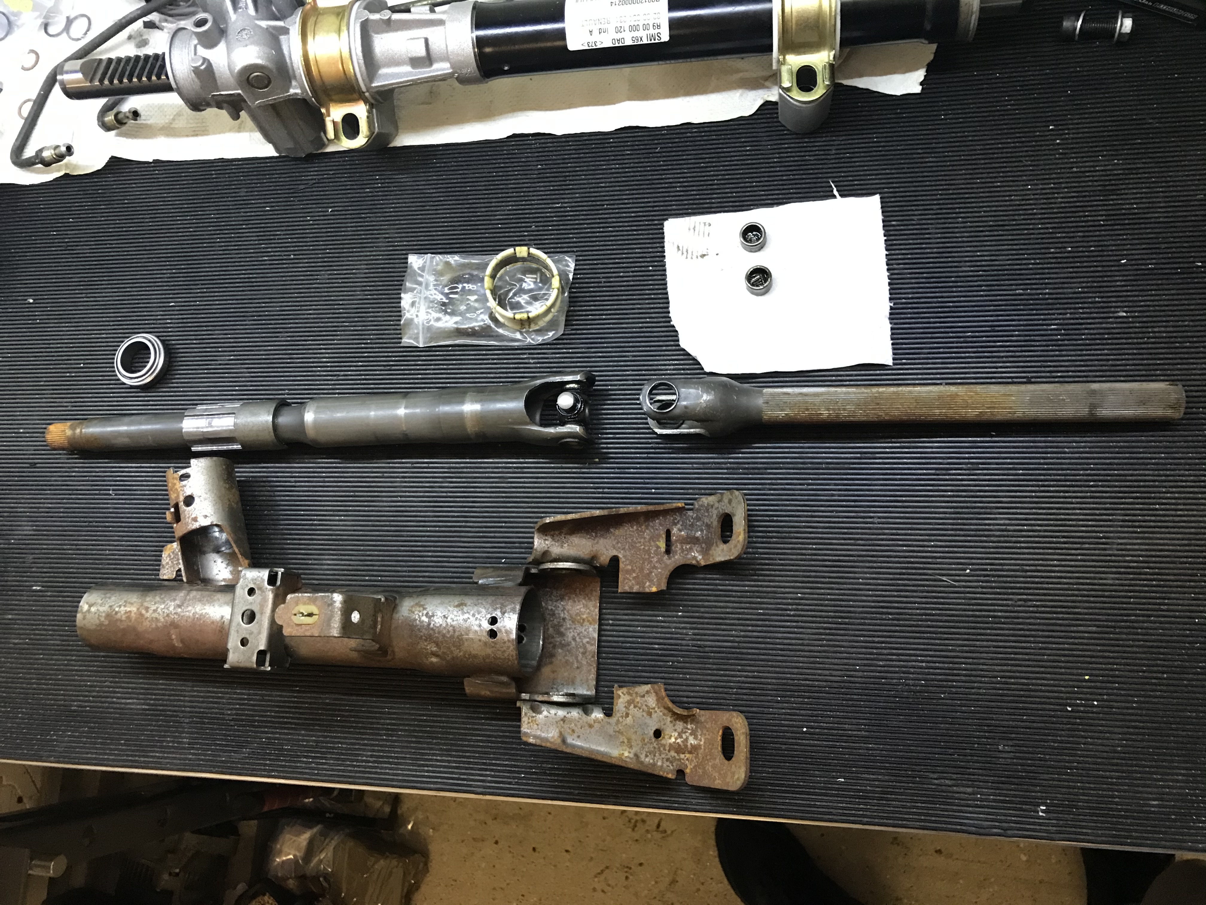

Its a been a while, but you may have to grind away tabs that stop the lower bearing from moving because the key lock mechanism wont fit through otherwise.

Edit: I think the column fits through the lower bearing. Found a picture of the shaft with bearings.
Thanks for all the info, how much do I need to remove in order to replace the bearing then?
