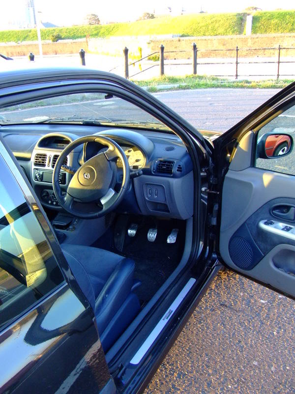

I found some info for you and a picture,
Apparently there's some "ESP" bars that need Grinding off for it to fit, this could well be what was catching on Jonff's
It looks quite good actually. No idea if the airbag would work though.
Airbag wouldn't work with mine, the plug wouldn't attach to the air bag properly so the airbag light was on permanently.
