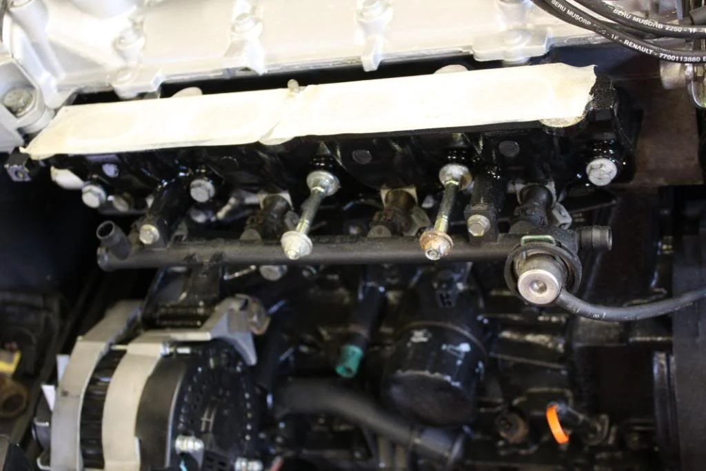

The silver round thing with the pipe coming off it to the right. This is an early Ph1 rail with the regulating being done at the rail:
A ph2 rail wouldn't have that silver thing there, the hole for it would be blocked off.

Ok, mine does have the silver thing. The new rail has the hole, but no silver job. In that case I'll re-use my rail, and just swap the injectors over. Is swapping the injectors fairly easy?
Yes, pop the circlip things off holding the injector to the rail and swap them to the other rail, then refit the circlips to hold them in place.
