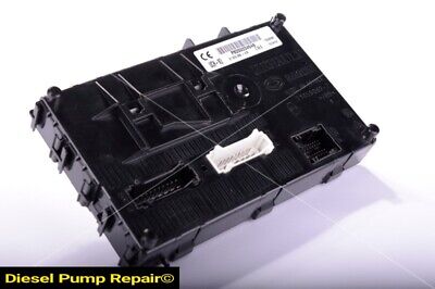

Thanks a lot for that @clio tyres . Pity I didn’t know that when the auto elec was here today as I’d have had him whip it out so I could send it off for repair. Any tips on removing myself or best to get the elec back? Thanks again
I took mine to BBA Reman as they are local to me, but I think they are quite a bit more expensive than the e-bay option.
I took the UCH out myself, just a load of plugs as far as I recall.
As my car is now stripped out it's just cable tied to the roll cage, so very easy to take photos of the connections if you think that would help
  mini cooper s
Thanks @banhama Think I might have a go myself looking at YouTube it says the dash top needs to come out but that looks easy enough
