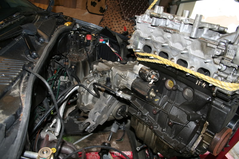

I was without tools when it happened to me , didnt know what the problem was so the AA man fixed mine. He did it all from the top. allowed the engine to cool and then went in.
location pic, its below the rope
in the pic below its the top spade
Is that viewed from the top or bottom? I really hope this is the fault!!!! and is it easy to get to?
The car has never struggled to start and has always been spot on too
Gus
  182Turbo,DCi90
mostly by feeling around and doing it blindly id imagine.
