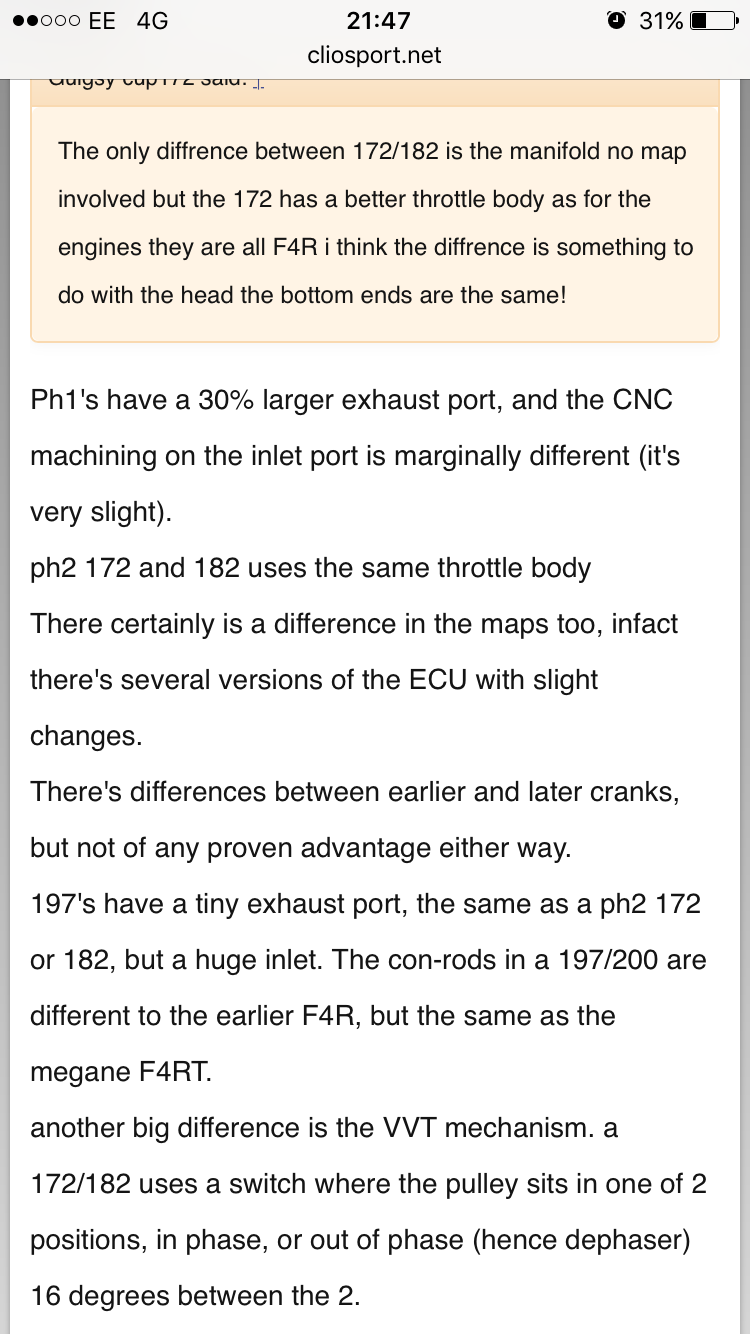

cs_dave West Midlands ClioSport Area Rep Car Artic 182 Dec 19, 2016 #1 Is there any reason that my ph2 172 would have a ph1 cat as ive found out today lol. Its getting decated but intrests me as 2 y

imprezaworks ClioSport Club Member Car Mk5 Golf GTI :) Dec 19, 2016 #2 The cats are the main difference of mixing exhausts? Phase 1 manifold?
Djw John Scotland - South ClioSport Area Rep Car Not a clio :( Dec 19, 2016 #3 Phase 1 cats are shorter if single lambda so I guess this is a twin lambda one. People used to swap to them cos they flow better but I'd be surprised if it was a noticeable difference.

Djw John Scotland - South ClioSport Area Rep Car Not a clio :( Dec 19, 2016 #5 Yeah the manifolds are the same.
imprezaworks ClioSport Club Member Car Mk5 Golf GTI :) Dec 19, 2016 #6 I thought there was a difference in flow? Phase 1 being better?

B barnesautos Car 172 Ph1 Dec 27, 2016 #9 I was told that the cells of a Ph1 were on par with a sports cat cell . That's the only reason I see it's fitted , or because it was cheaper .
