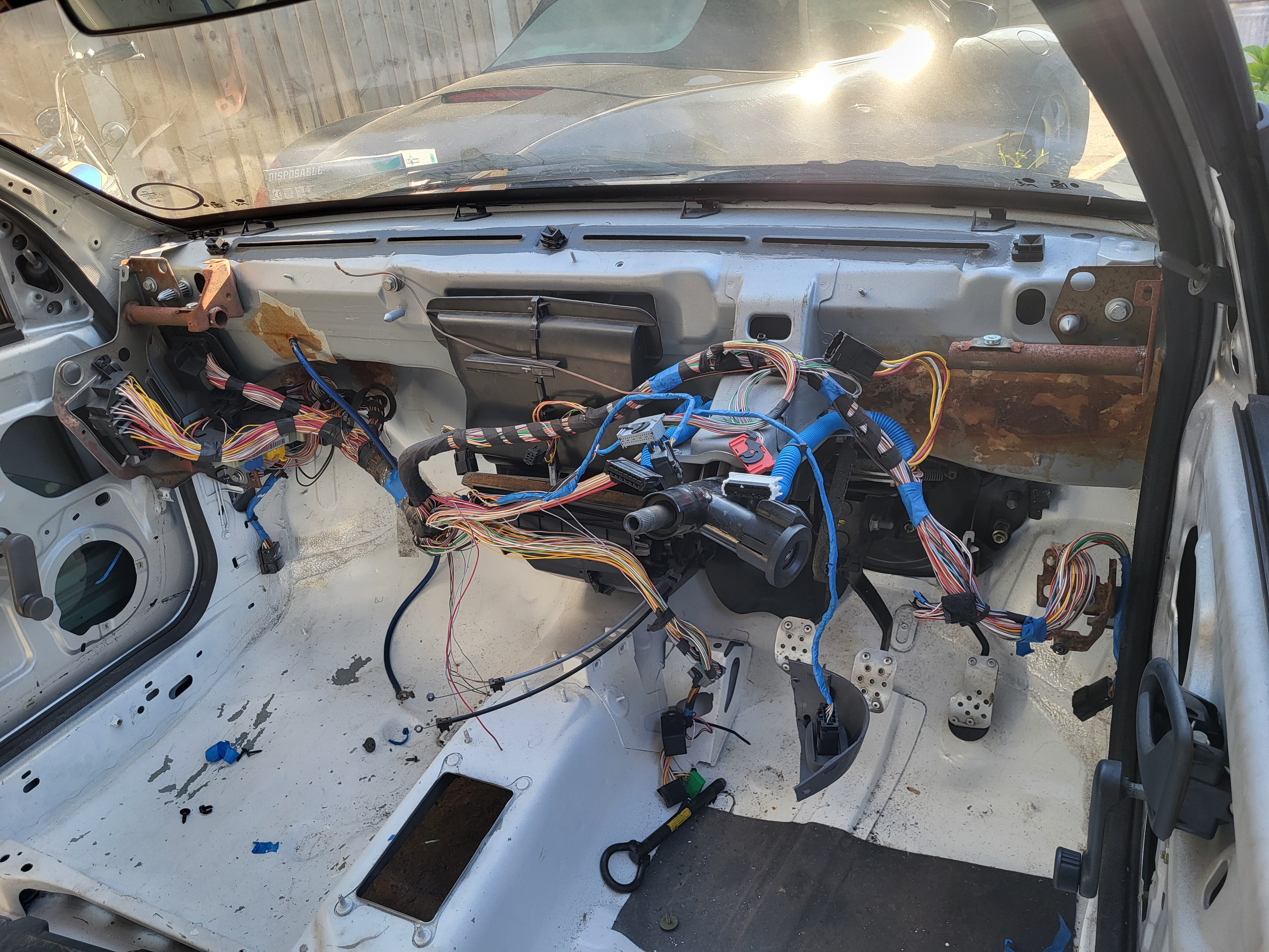

Small update today, decided to take the dash out to tidy up behind.
Id already made the following mods:
  • Cut down the mounting frame - I figured this is to hold the the airbags and the weight of the dash, but with the airbags this want really required. I kept the mounts at the ends and left it at that
  • Cut down all the HVAC ducting with the exception of the screen defog.
  • Fibreglass (badly) any unwanted holes, mainly the recirc
  • Chop down wiring

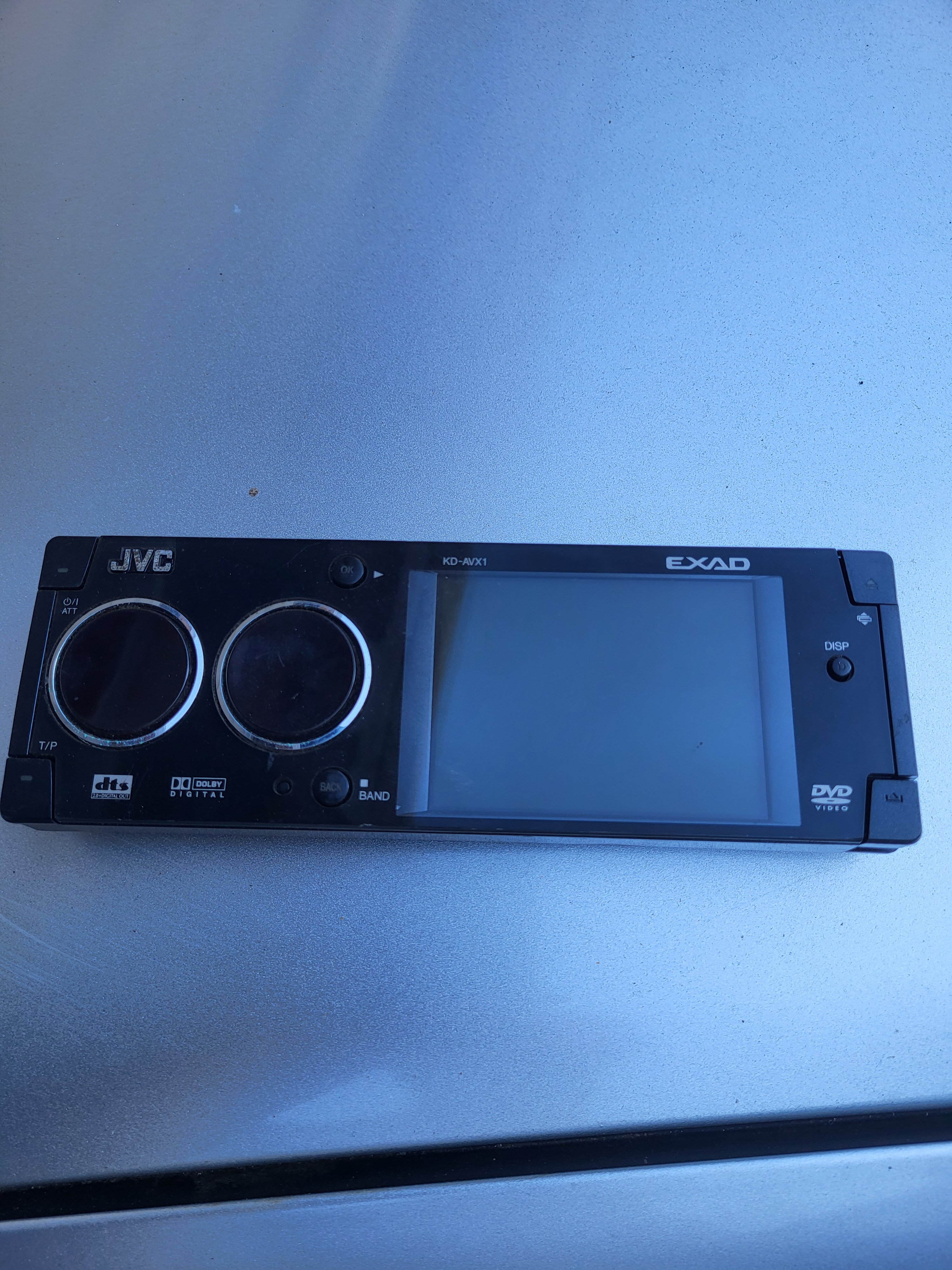

The want was to chop down the work g further. When I built it back in 2010, Bluetooth speakers hadn't really taken off yet so I retained the stereo in the glove box, this bad boy used to play dvds I'd you wanted

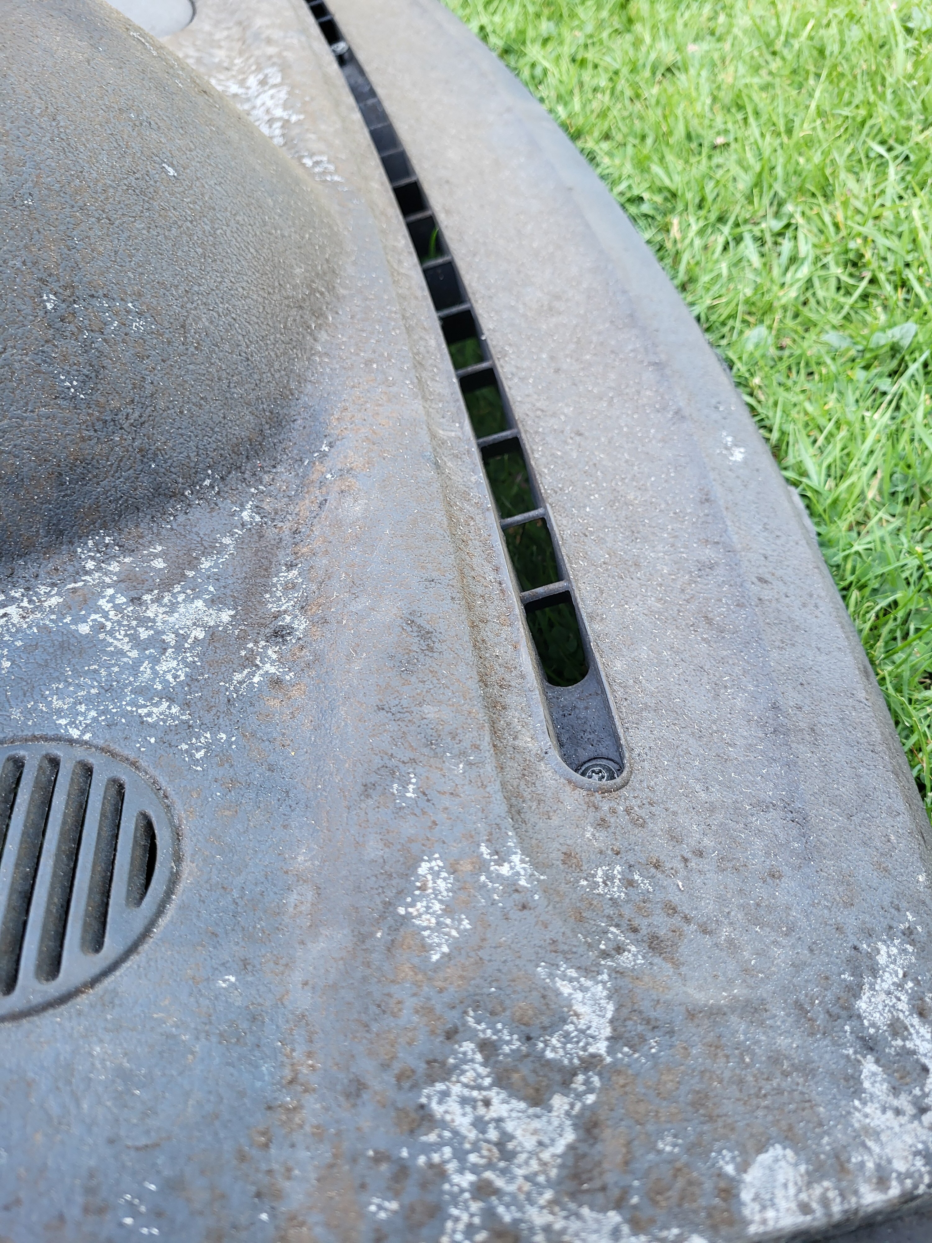

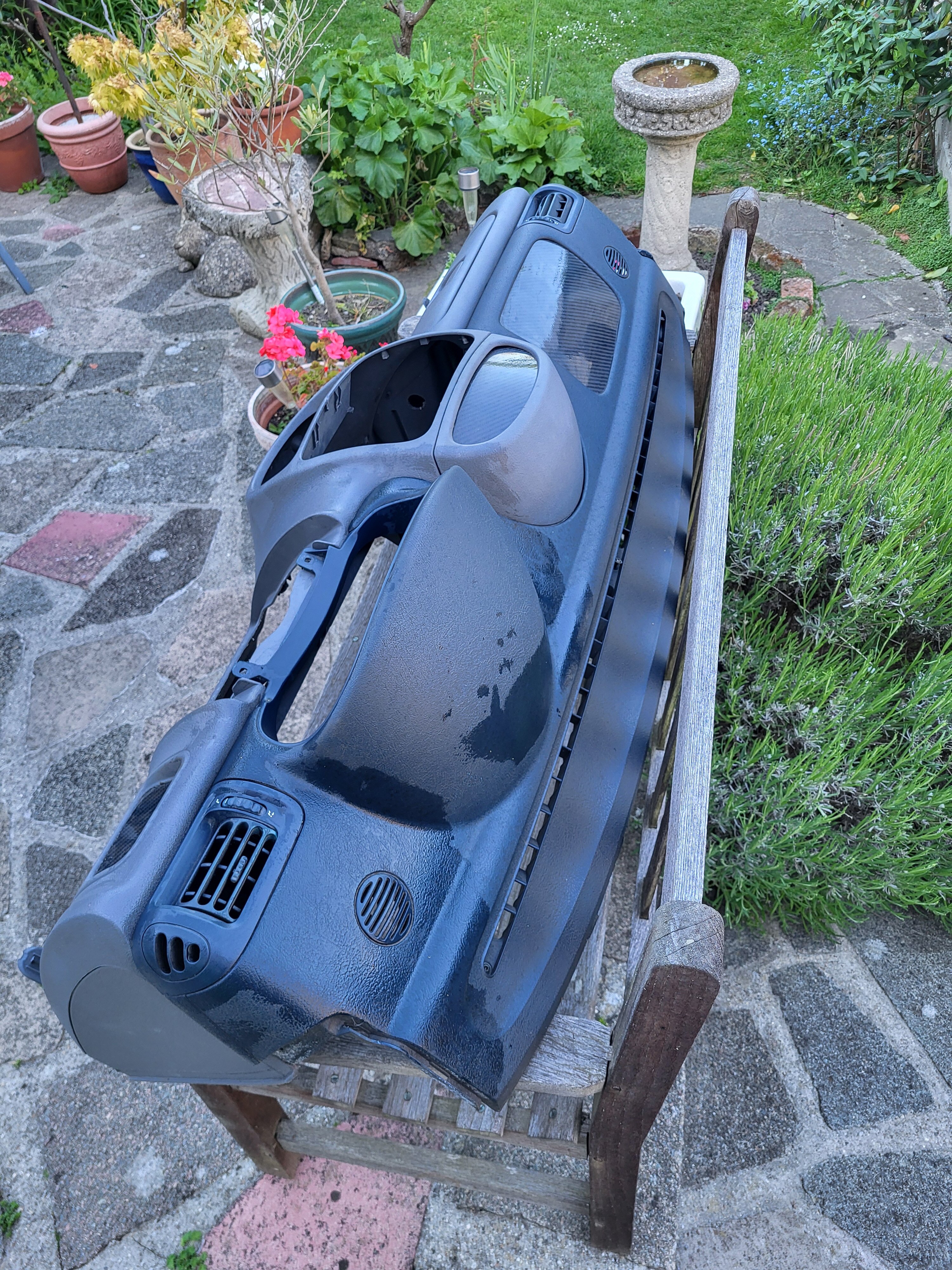

The years hadn't been that kind to the dash...
But it cleaned up ok in the end

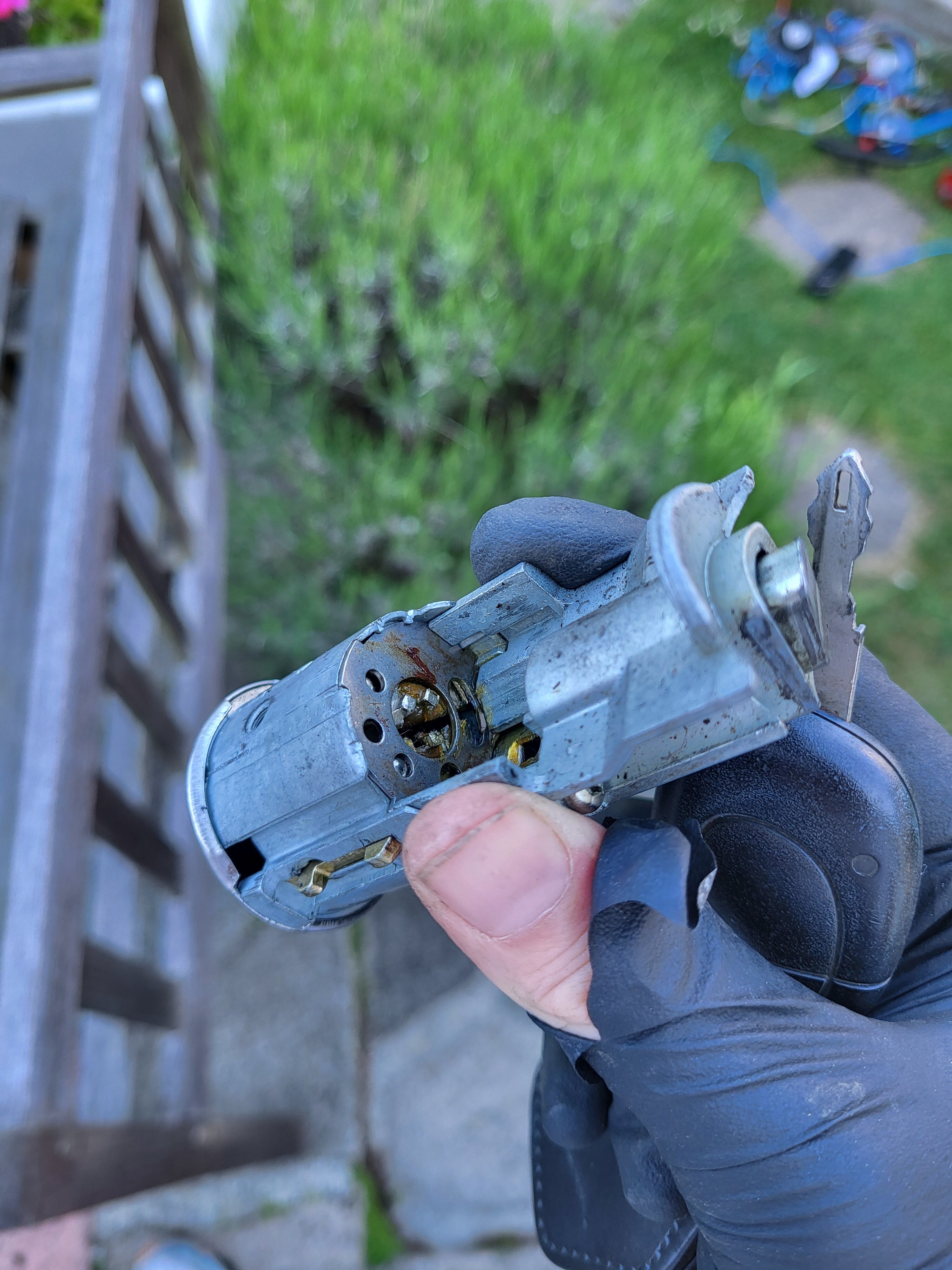

It also looks like muggins over here removed the electrical components from the ignition barrel (I had fitted switches to feel cool), I've ordered a new barrel from a breakers in the hope I can Frankenstein something together and keep the same key all around.

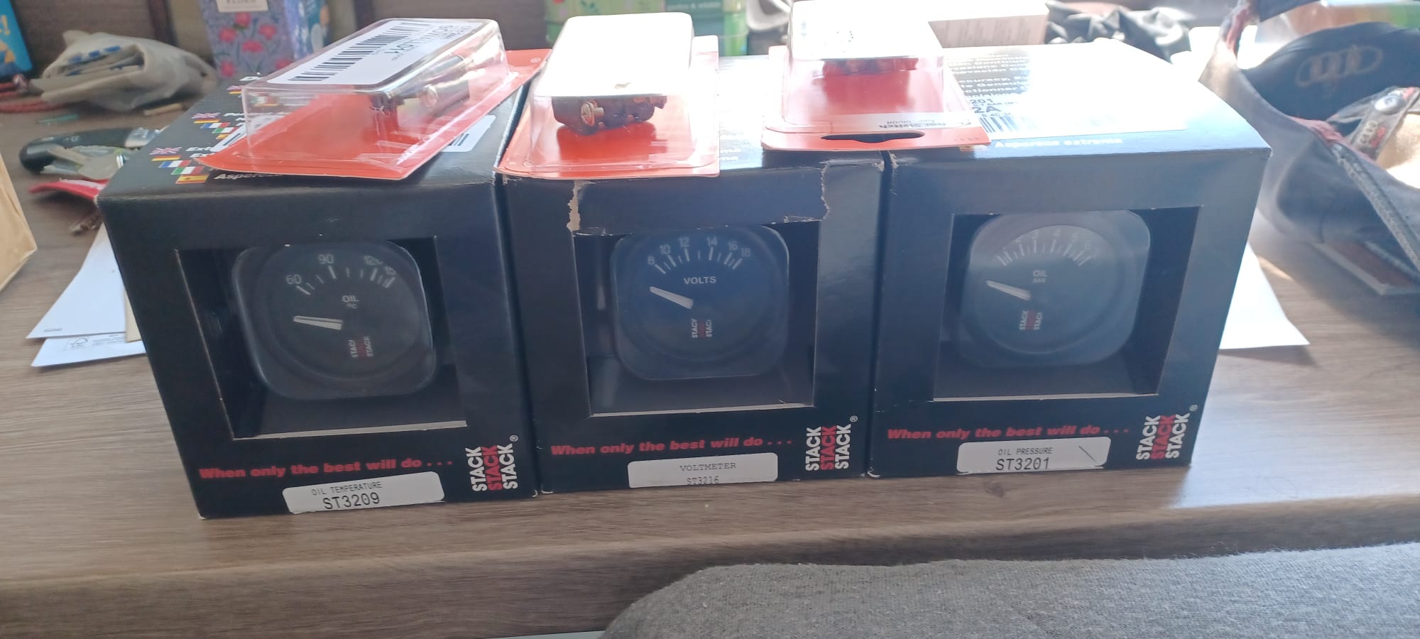

Yeh that's about it now, plan is to make a new centre console in the space where the vents/stereo used to be with a use charging port and some switches and gauges.
Which got delivered today! I really wish there was a race dash for the ph1 similar to the ph2, I don't want to change the whole dash but there isn't a good place to mount a clusters. If you had time and a 3D printer you could make an insert that replaces the hole where the vents and stereo was and screws on to make a smooth finish. Oh well!
