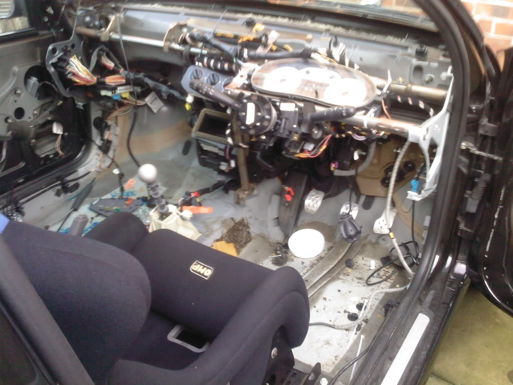

ph2 dash conversion on ph1
  audi a6 3.0tdi
Who has done it and what tips do you have? When taking the ph2 dash out there seemed to be far more screws holding it on than the ph1 dash. Also do the wiring connectors all interchange or will i have to cut and splice ph2 connectors onto the ph1 wires?
  audi a6 3.0tdi

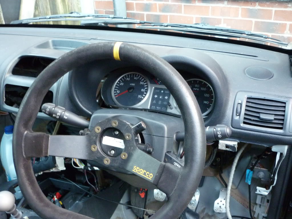

I've been playing about a bit today and it seems none of the screw holes line up for the dash on the ph1 mounting frame so to make my life easier i'm just going to fit the ph2 frame. also some of the wiring connectors are different so i'm going to get the connectors off the ph2 loom and splice them on to the ph1.
Also how come on the ph2 dials the rev counter doesn't work when plugged in? is it because the ph2 is fly by wire? the dials are out of a dynamique

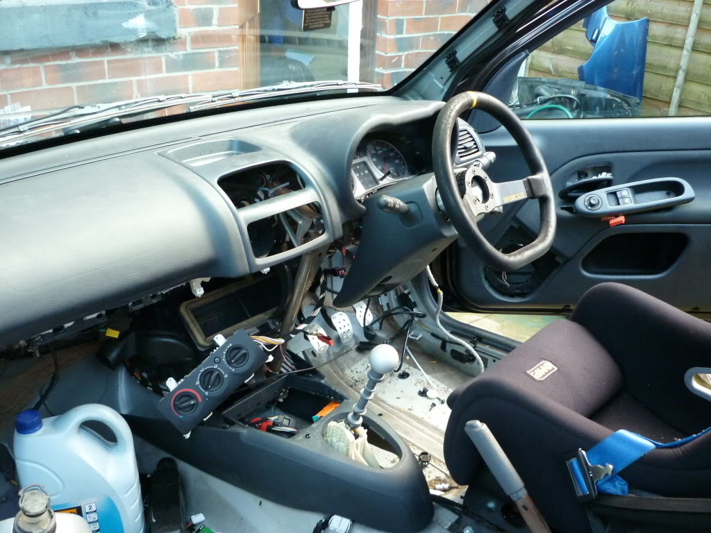

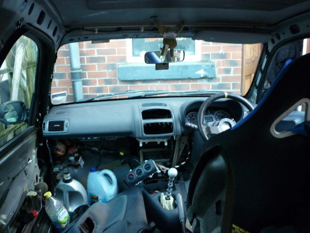

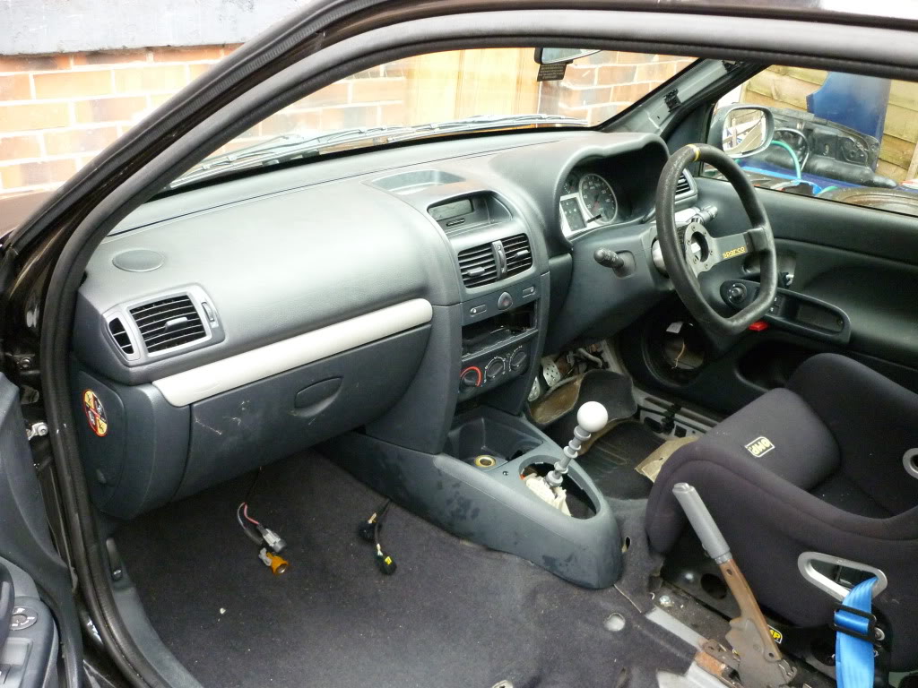

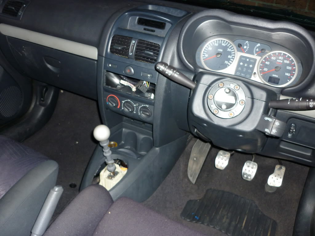

a couple of pics of the top dash in place
I'll keep updating this as and when i have done bits
  audi a6 3.0tdi
Well the dash is in i've got a few little bits to sort out yet but nearly finished. Also notice the black carpet :)

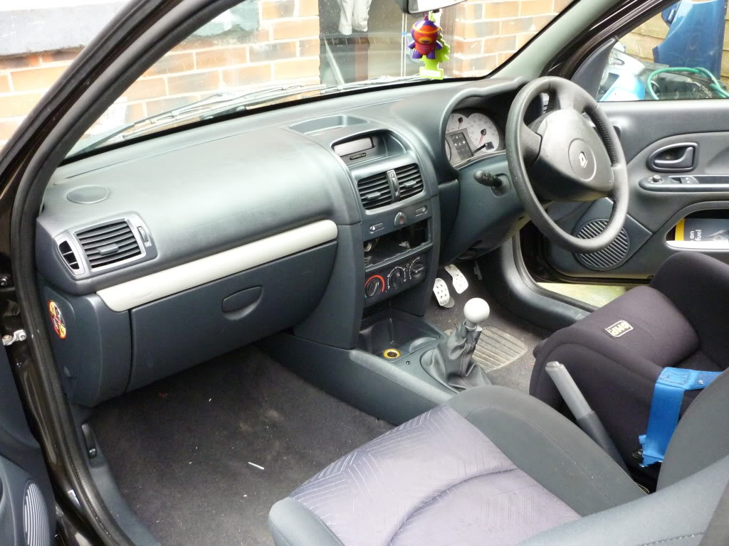

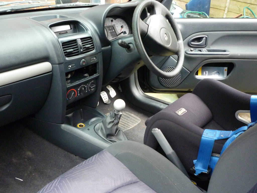

Right today all the carpets have been fitted i've sorted the heaters out fitted a passenger seat and seat belt. There are a couple of bits of plastics missing but hopefully i'll be able to get them of jamie tommorow. All thats left to do is to convert various bits of wiring including the electric window switches, hazard light switch and the internal door lock button as these are different on ph1 and ph2.
How it looked a couple of weeks back
and nearly finished
I'll miss it being stripped out for the extra speed but at least it won't feel like a shed now :)
  audi a6 3.0tdi
I've had to revert back to ph1 dials as none of the guages work on the ph2 ones as they must have different input sensors
Its because the Ph1 clocks work off direct wires to the sensors and ECU (thats how I can run Ph1 dials on my Mk1)....whereas the Mk2 most of it runs through the CAN-BUS and UCH systems, so cant be just put in and wired up :)

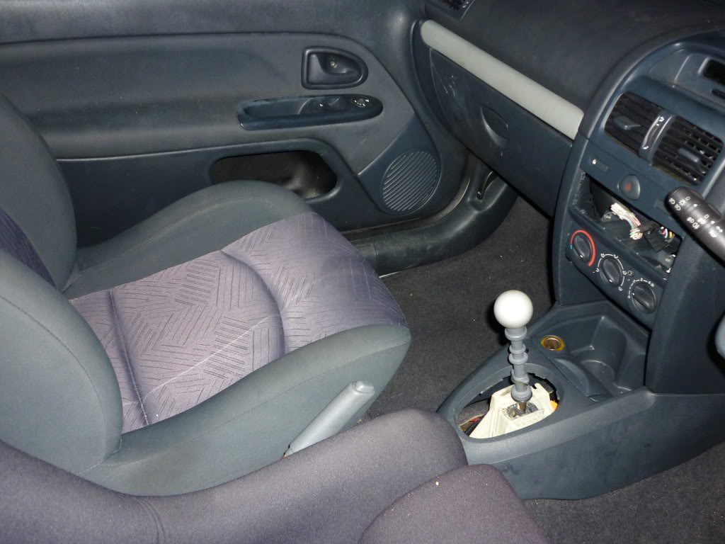

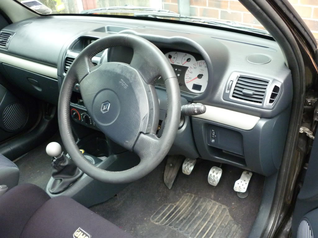

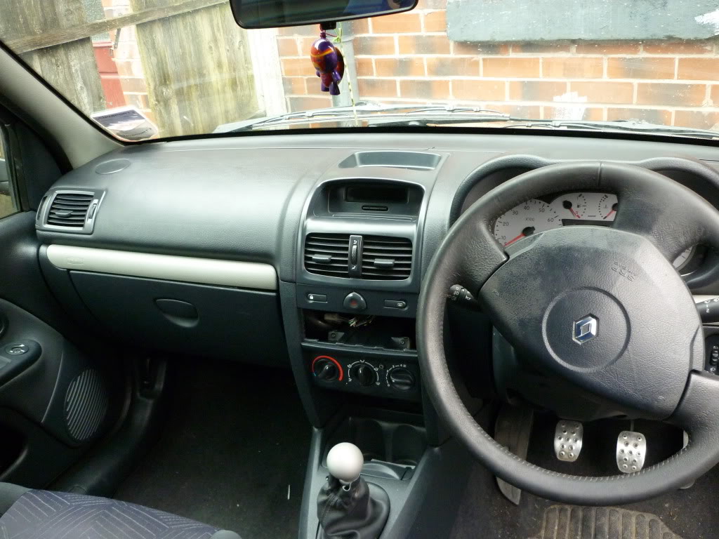

never did post up again so here are some pics now
just need door pulls off a ph1 172 so i can fit the standard electric window switches and to fit the drivers seat as the bucket seat is being removed.

Sorry i didn't go back in that thread.
i used the ph1 clocks as the ph2 are fly by wire and don't work. the heaters work and so do the fan settings. thhe things that don't work yet are as follows
interior door lock button
recuirculation button
hazzard switch
electric windows switches.

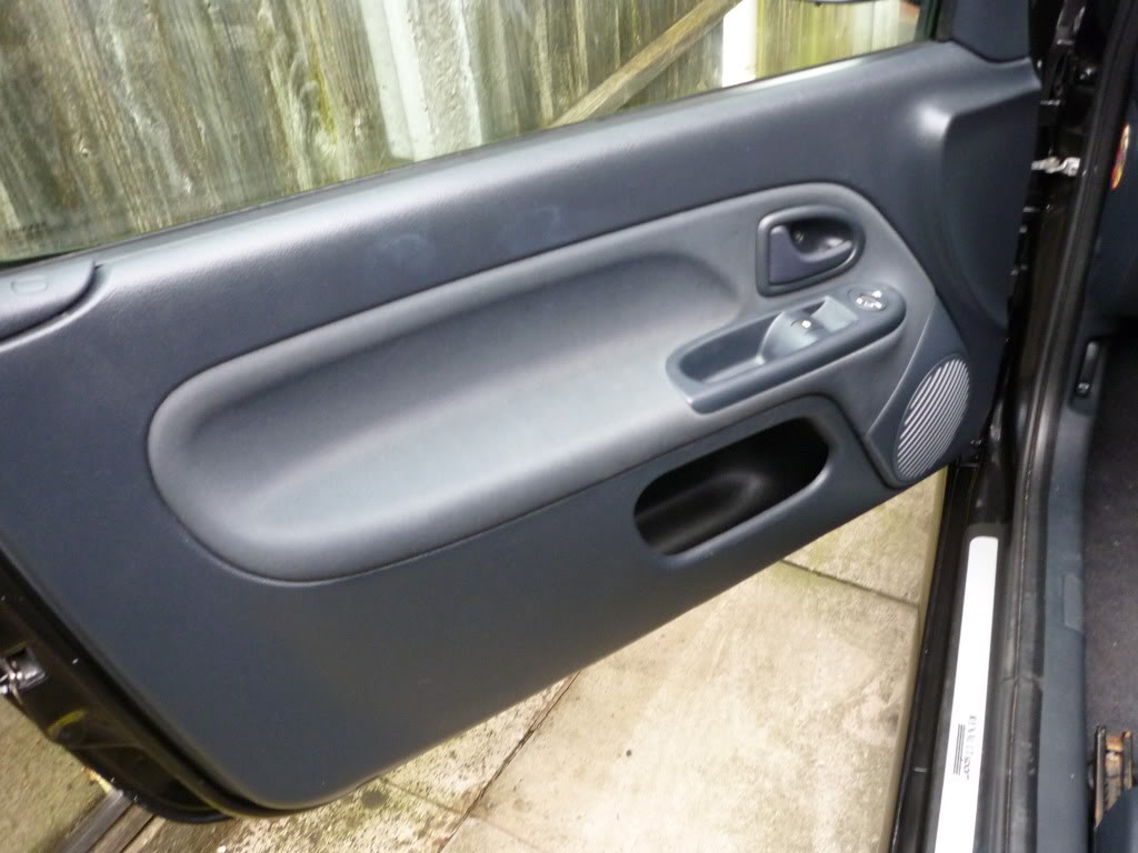

to solve the window switch problem i'm going to use the silver door grabs off a ph1 172 as the door cards are the same shape.
I was going to go for the motorsport look and use toggle switches for the other but now i've got a full interior i'm going to see if i can get the switches working normally.
the centre bit with the surround fits but is not best ever yet so i'm going to find a way of making some support brackets. I didn't need to swap frames i was wrong.

nope ph1 and ph2 electric window switches are completly different. one set has about 8 wires and the other about 11 and the way they fasten in the door is completly different too.
some of the wires will obviously do the same thing me and a mate had a play but couldn't solve it. my dad should be able to do it he makes amplifiers and modifies cd players so a couple of wires should be nothing to him.
