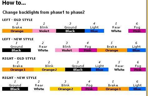

i know to change mk2 ph1 lights to ph2 you need to do some re-wiring, if i wanted to fit some aftermarket lights designed for a ph1 to my ph2 would i need to re-wire or not
  Ph-Sold!
It's not rewiring as such, just swap a couple of wires over in the plugs on the back of the lights, not even a job to get even slightly concerned about!
Djw John
Scotland - South
This may be useful to you. its for ph1 to ph2 so just do it in reverse ;)
