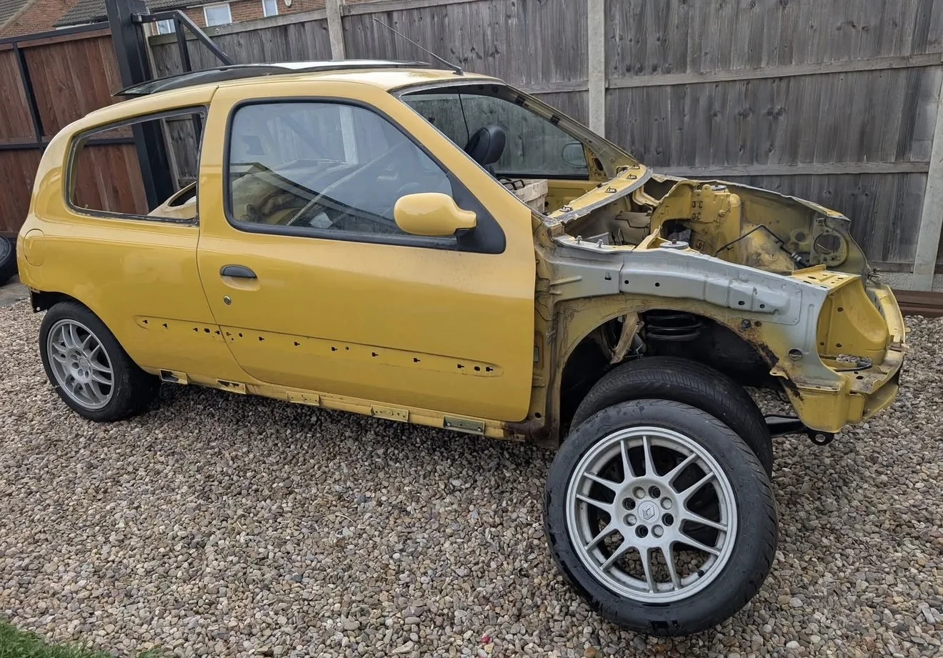

PH1 172 > 225 conversion.
Car  Clio 182
Who can help with wiring & shafts (mainly) for fitting a 225 to a PH1 172?
I pretty much got everything on the shelf/ coming in to make the swap happen I think. 🤔
