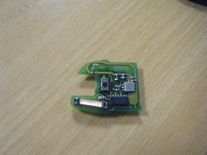

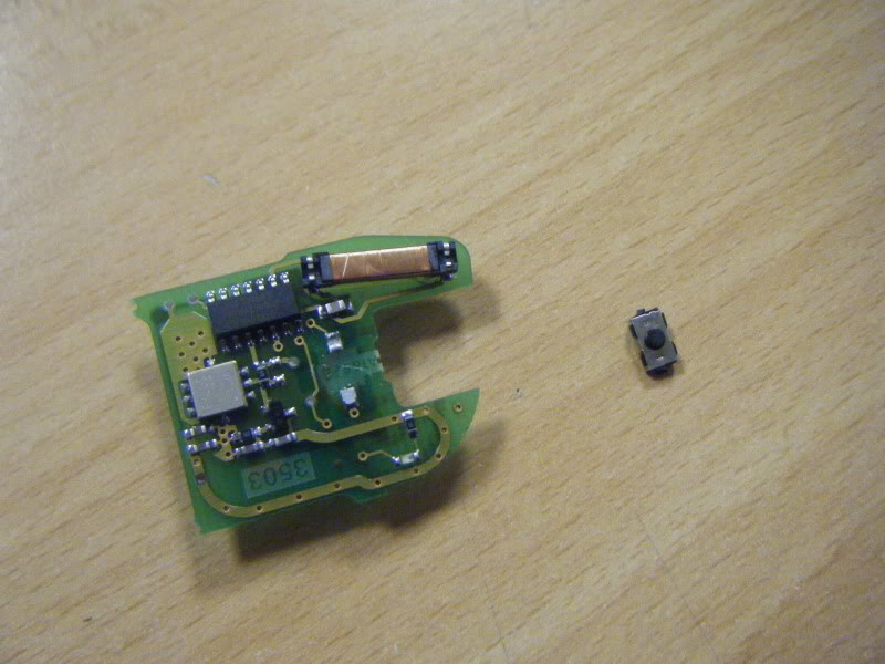

nope your spare key wont ever code to your car, you need a new one, you say the light isnt flashing, open the key up and make sure the button has not come away from the circuit board, slide the key apart and then prise the circuit board away from the casing

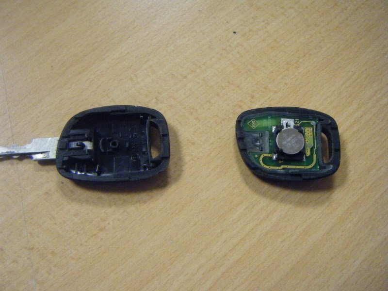

One of my keys doesn't unlock the door by remote, light isn't flashing, but does start the car. Key is different to the one above in that one half houses the battery and the other half everything else...I've changed the battery by the way.
