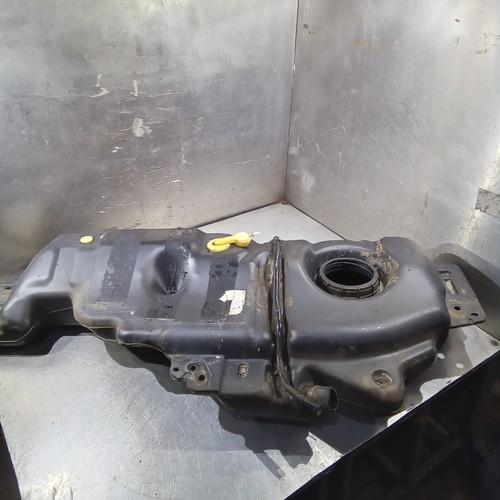

Also, comparing the phots in this eBay listing for a ph2 tank to the diagram linked they look identical, although I'm sure someone who's better on ph1s will be along to correct me if I'm wrong.

yooo, fitted the tank today. i bought the one linked on ebay at the top of this thread. i can 100% confirm it fits, the only difference was the cradle to hold the external fuel filter. nothing a cable tie couldn't sort. so that was a tank from a phase 2 fitted on the phase 1.
