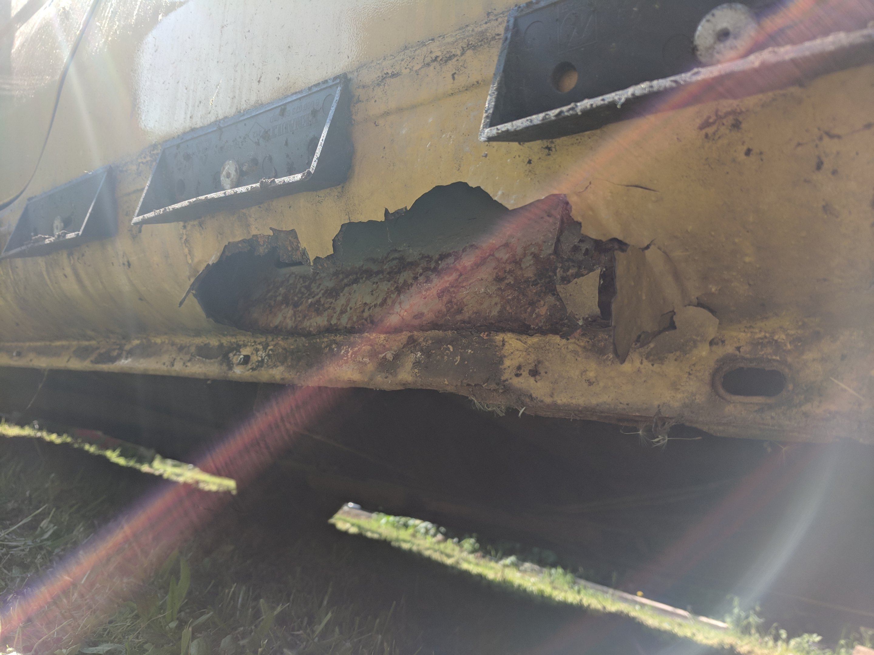

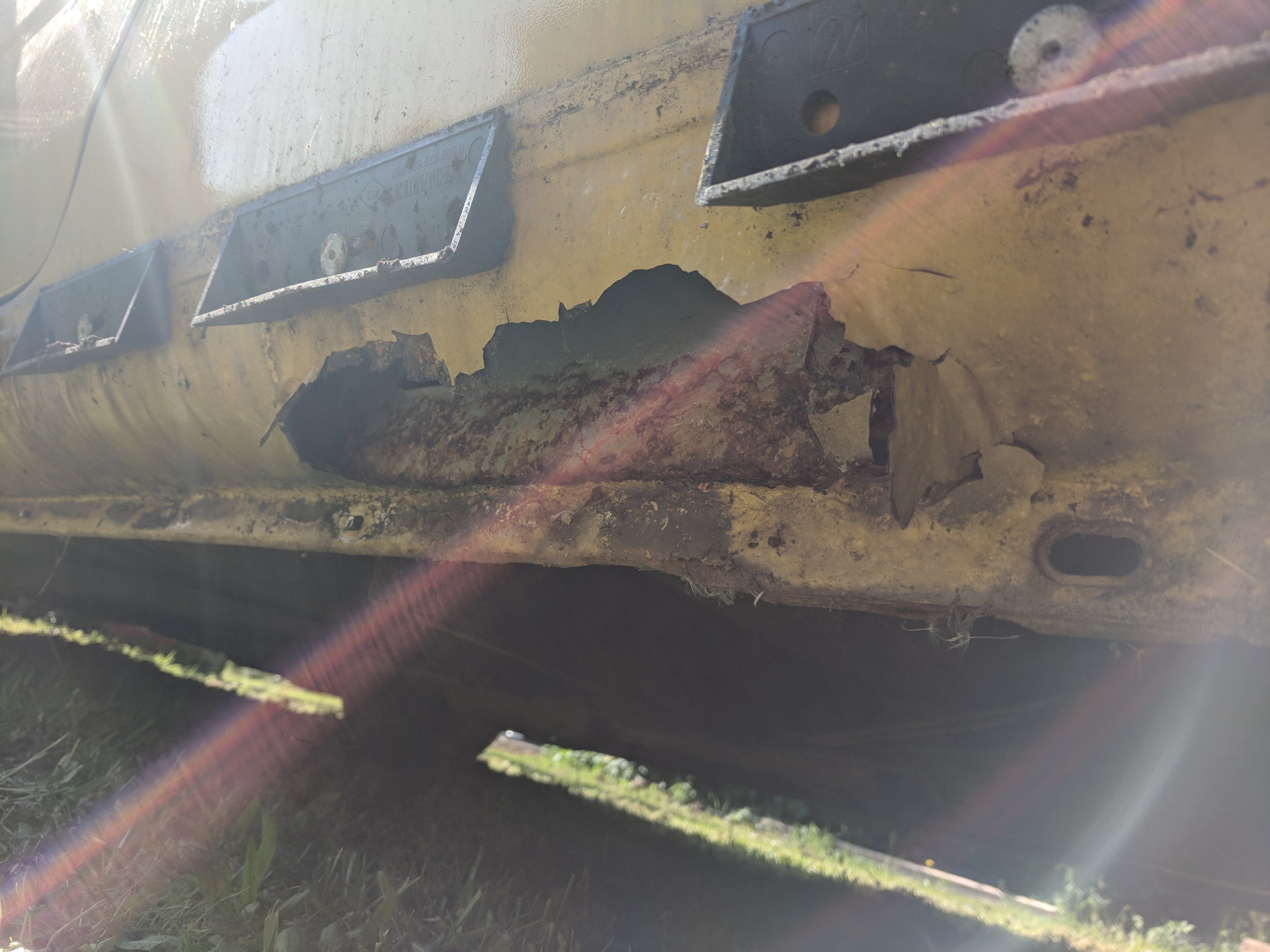

I found this
Louis
I Park Like a C**t
Easily repairable. Cut out the rust with a grinder until you get good metal. Coat everywhere else in rust preventative and then weld in a new panel.
It's not exactly an intricate area

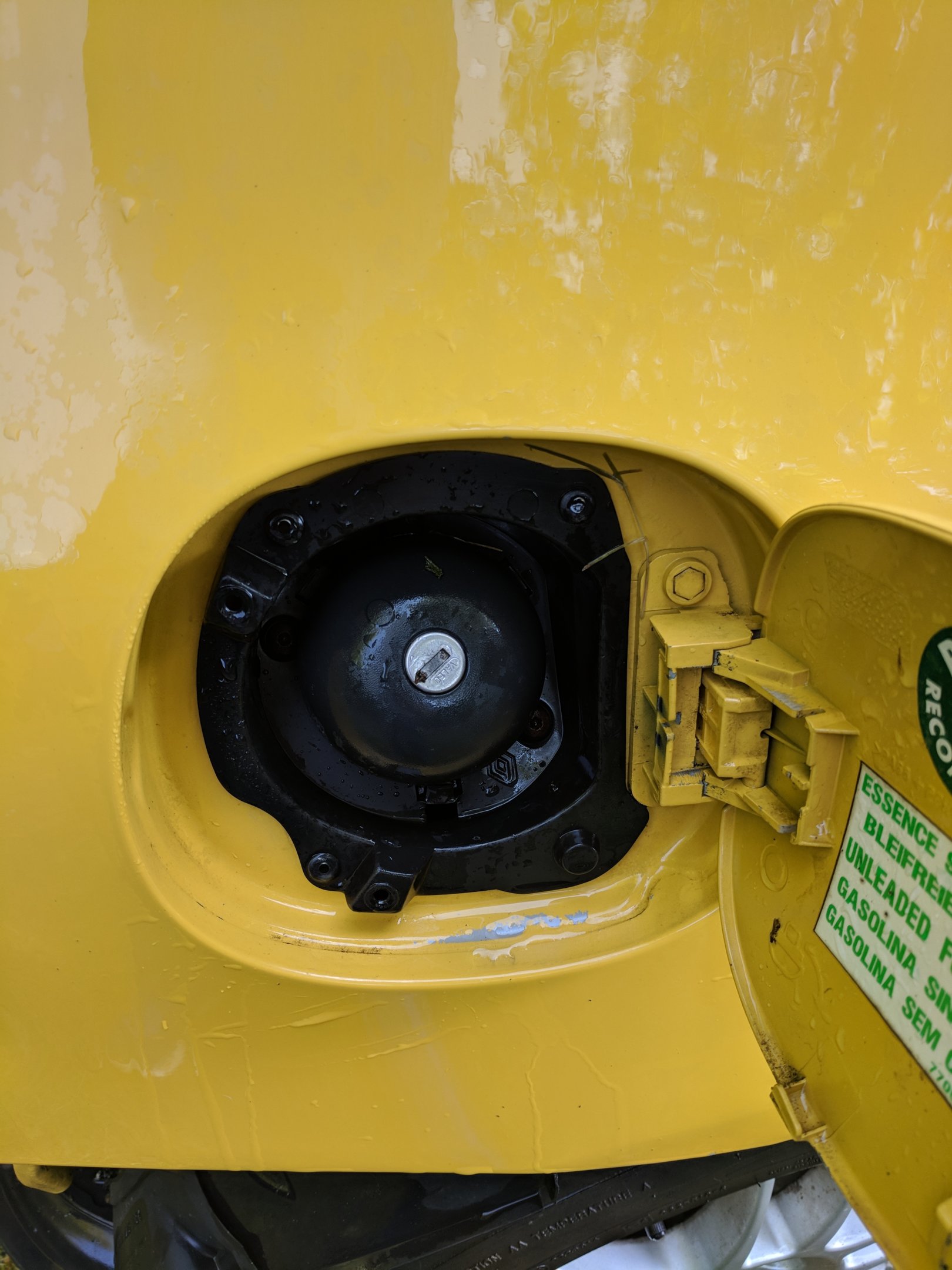

Yes they come away very easily, drill the rivets off. full of crap behind them. I expected mine to be much worse and around the filler cap it is perfect.

I was quite lucky because my old man has good fabrication skills and as the area is unseen he made a 3ft section of sill from steel sheet. I’ve painted/ undersealed it etc and it’s good to go. I was very close to ordering a new sill but as it worked out I got the job done for a few pints.

Whenever I clean my car I try and blast into the side skirts with the air gun or the jetwash to blow all the crap out. Filler cap is a common areas too because water and crud sits behind the arch liner on the filler neck
