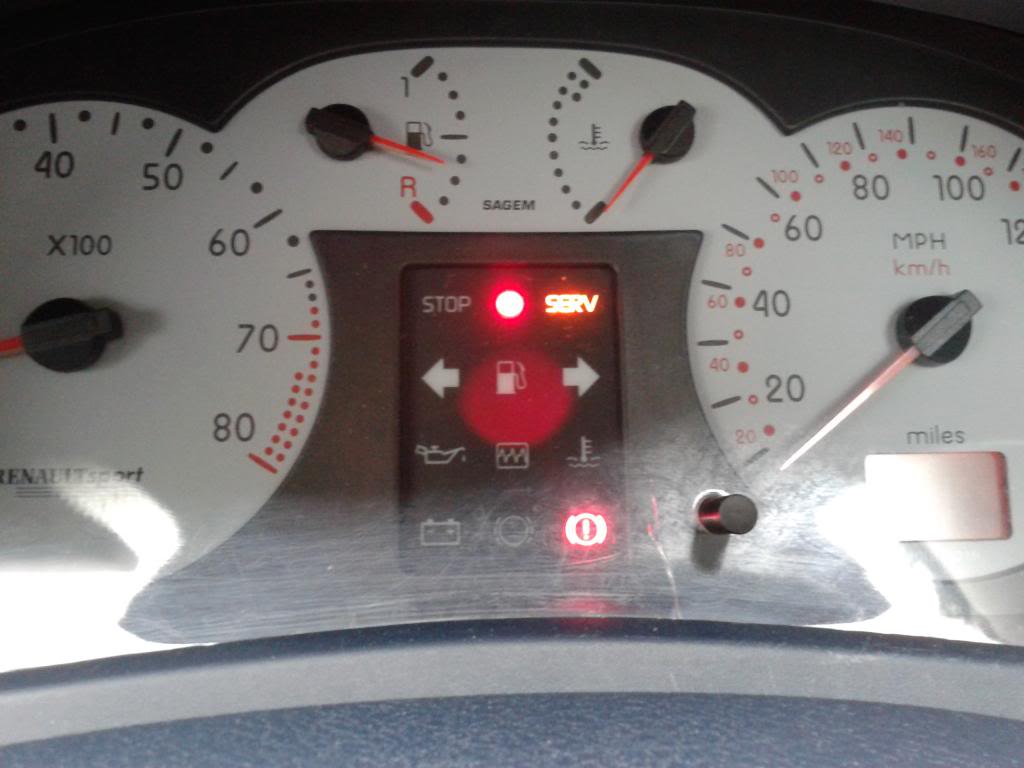

Looks like this! "SERV" light. Also the red light in the middle sometimes stays on. Something to do with the alarm? It flashes for a few seconds before start up. And actually wont wont start till its finished flashing.
if there red light is flashing then thats a bad sign
mines used to do it, slowly got worse and worse until one day it stopped working and i was stuck
new key required.
£100 from renault
better getting keycare added on to your insurance and saying you lost it

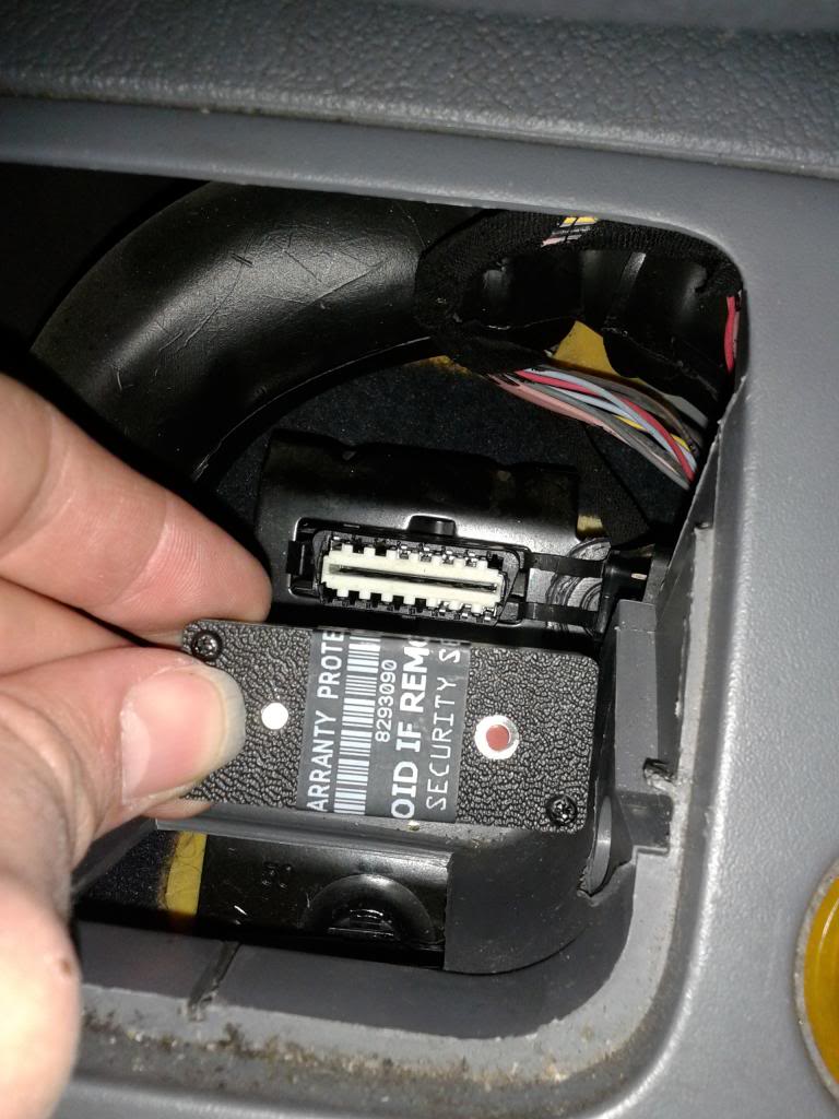

Has this anything to dowith it??
Found this plugged into my obd2 under ashtray. Think its something to do with the alarm? maybe a coder for the alarm? Has a button and a flashing blue led. Is this standard?
You'll need a renault specific code reader to read any codes from the system if its displaying the SERV light.
​Also, that thing plugged in to your OBD port is definitely not standard. Shouldn't have anything plugged in.
That unit is an aftermarket device which bypasses the immobiliser. It sends the code to the decoder rather than the key doing it. The cars obviously had a fault in the past!
