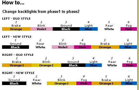

hi changing the rear lights on the 172 to phase 2 ones and need to know how to wire the holders as i only have the covers
If you mean changing Mk2 Phase 1 rear lights to Mk2 Phase 2 lights I have the diagram that show you :D
