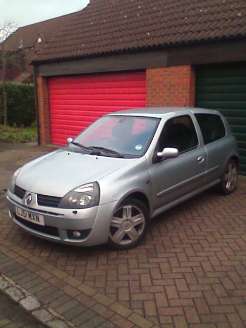

Hi,ive just got a clio 172 sport and am confused as to what all this phase one phase 2 etc etc is all about.
Can someone enlighten me:)

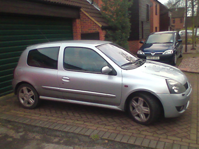

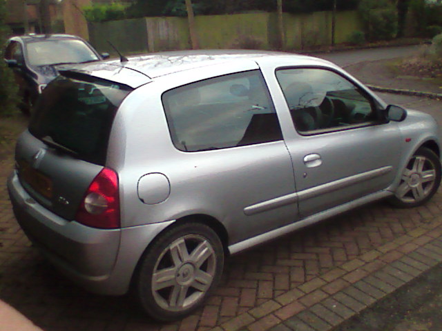

picture? what reg is it on?
51 mate,its going on a track so im not really bothered but id like to know the diffence for spaes etc etc!!

Ah so mine is a phase 2
any difference performance wise as im gonna get one or two more for my company when ive shifted a couple of the 205s or mx5s ive got.
