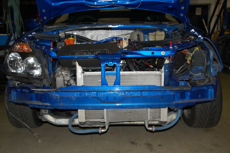

Has anyone got pictures of a 172 with an oil cooler fitted, looking for ideas on where/how to mount the cooler. Cheers

ta dar
ahh that looks cool, is that the ktec one? Can you see it through the bottom grill when you have the bumper on?
ktec one is mocal but they add £30 to the cost. You can buy the kit from merlin motorsport or even think auto complete with a thermostatic sandwich plate for around £140.
only really need for track cars, when oil temps start creeping upto 130degC you need to think about getting one
yozzasport are mocal stockists, i think they charge about £150 for the kit
