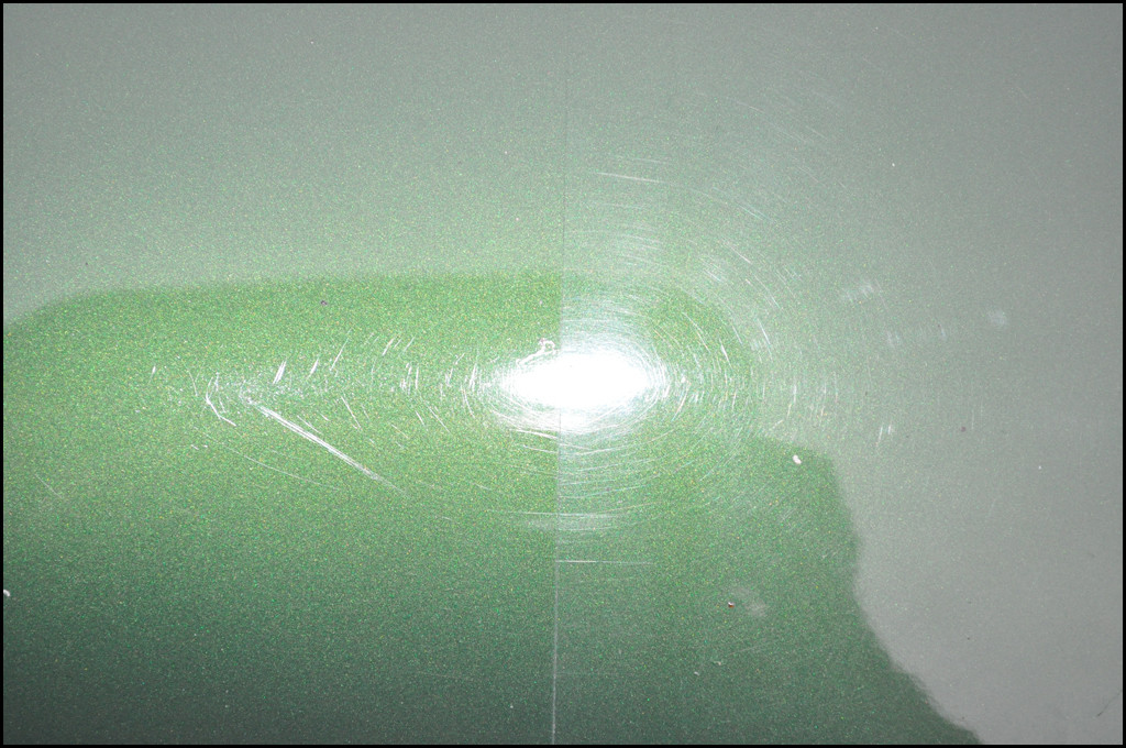

Any tips on this?
Was experimenting trying to get it decent before but I can't seem to do any consistently.
I got these;
Do people find using a torch or using flash better? Head on or at an angle?

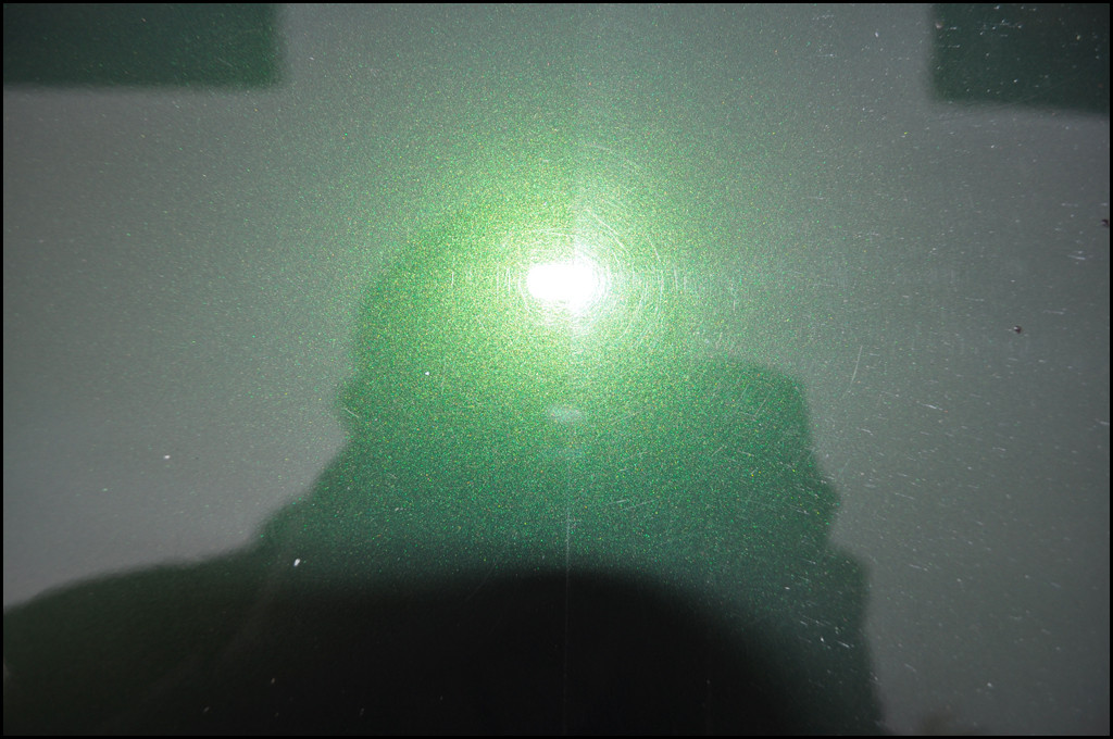

Outside does make it more difficult, but with the NW clouds pretty much here to stay, should be a little bit easier. The fun part is holding a camera, while trying to manually focus, while holding a torch as well lol!
Never used tardis, probably worth just buying some for future use as I'm only at the beginning of getting into detailing! Cheers though :)
Will try taping the torch to the bottom of the camera or something ;)
Might not get the flare on the light right though, going to see tomorrow when I do the rest of the bonnet.

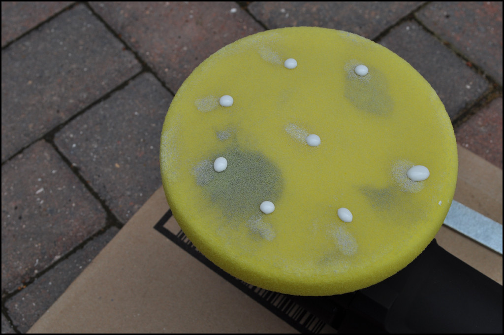

Trying to put the polish on the pad, then dab it around the masked off area just doesn't work for me though. I end up putting one big blob on the paint and a mash of it on the pad!

Alex, pea sized blobs of polish, max. 4/5 of them around the pad and on in the middle. Then dab the pad against the paint until it has a decent spread.
The stages of polishing depend on machine, but for a DA start on speed 2-4 for a decent number of passes to spread the polish. Then move up to 4-6 for correction. Zenith technique is great, but doesn't always work on DAs. In fact, barely ever works in my experiences with hard paint!
(zenith is speed 2, speed 4, speed 6 and back down again to correct any minor marring the major correcting has caused).

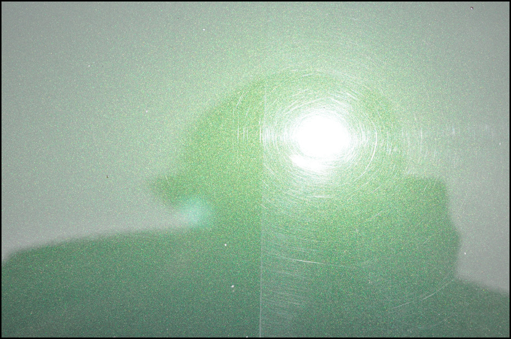

Polished the bottom half of the bonnet today which took me about two hours, spreading was miles easier, I have the slow speed stuff down now. Just getting the high speed correction done I reckon is my weakest point.
Ended up putting a pair of gloves on because it was killing my palms :o
It looked like someone put iceing sugar all over the parts I wasn't polishing after abit though, major major dustage! That's the polish drying up or is it actual paint coming off?
Even cutting hard into the paint it didn't seem like I was correcting much, I reckon it's down to not doing more than 3 or so passes on the highest speed.

Dusting is just a hazzard of the Menz polishes buddy. Some put up with it, find ways around it, or switch to other polishes like 3M (Ali has recently).
Re the passes, far more required buddy. Like 12. At least. Because the DA just does not provide the heat that a rotary does. I tend to find I'm doing 4 spreading, 12-16 cutting and 4 finishing (passes that is) with a DA to make Menz polishes break down. Also bare in mind how warm/cold the weather is will affect the break down. If it's a little on the chilly side, put the bottle of Menz in a water bath (hot water in a bucket) to ease useage.

Static light source, like a big yellow halogen light, and also, move your camera in such a way that the light from the halogen reflects in the middle of that 50/50 line.
