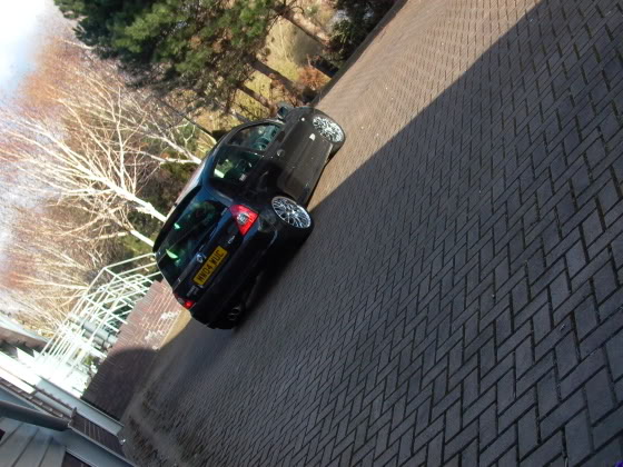

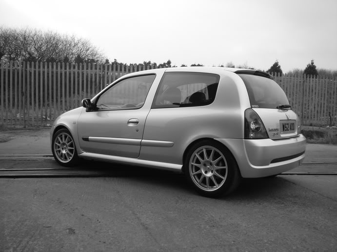

My Ph1 172 with Ph2 bumper...
  1.2 Power to the People..
easy peasy.
my 1.2 with rear 172 bumper. all bolts line up etc, best and easiest mod i've ever done.
